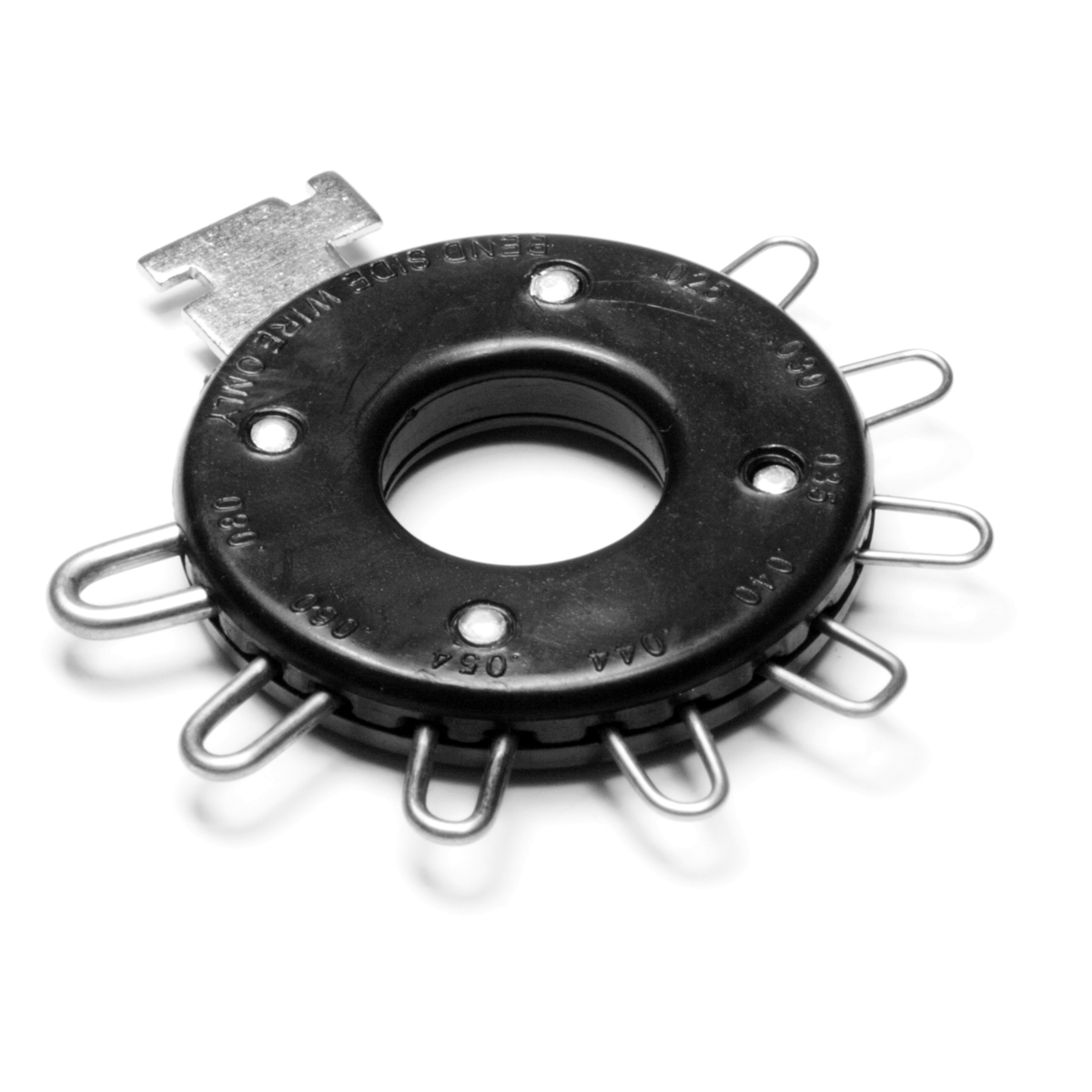

I’ve always gapped them to spec and just put the XP985 plugs in my 2005 4.0 this past weekend. Gapped them to .035 with a wire gap tool. They came with a way too small gap of .025.
Just be careful with them and you’ll be fine. My old turbo ST used to EAT plugs every 15k miles and the gap would widen significantly in that timeframe. Always replaced them with iridium and I have never heard they shouldn’t be gapped until I joined this forum lol. Any tuner would tell you to gap them
Round disc with a ramp is what I use.
Not with iridium plugs, that will destroy it. You need to use the wire tool. You hook that little notched blade on the strap and pull/leverage into position if needed.
