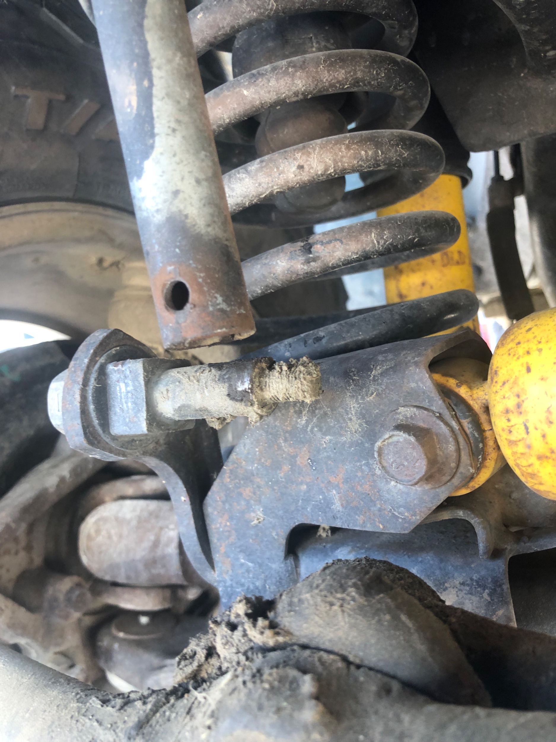

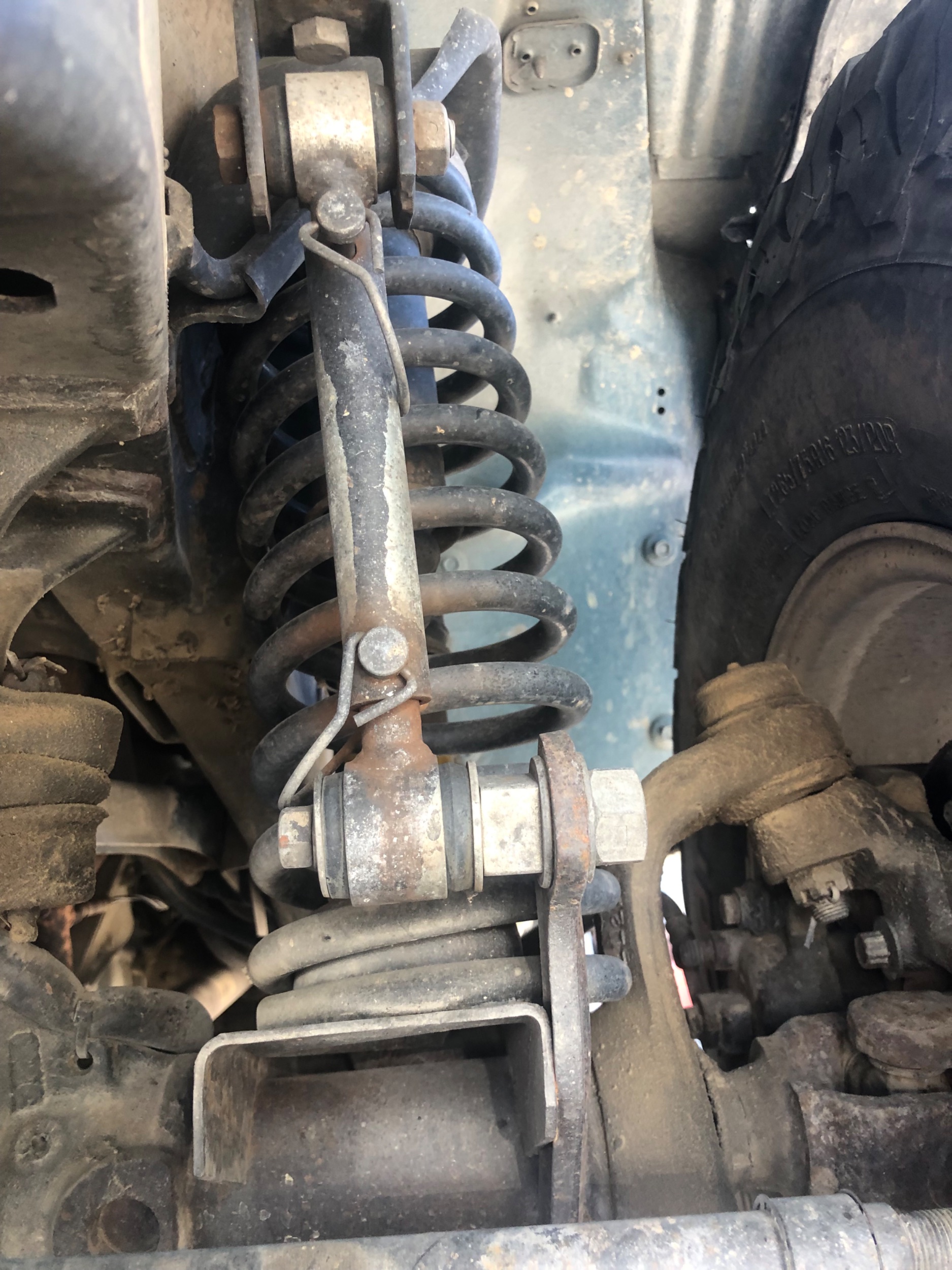

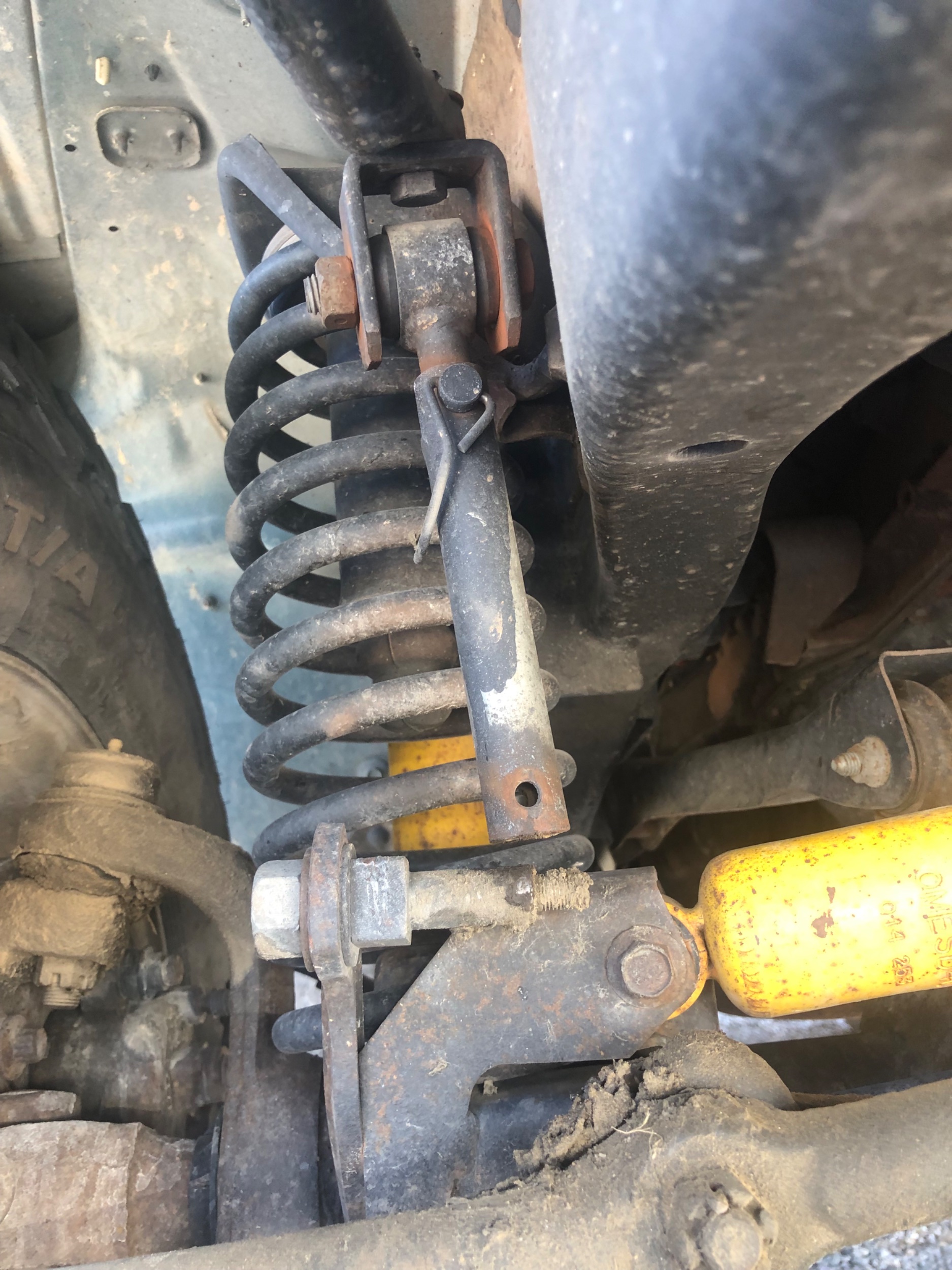

I did a post vehicle inspection after my 4 day run in the Mojave this weekend. I noticed that the right front sway bar connector is gone. I did a quick google search and I have some questions. Is there a difference between a TJ and my TJR Unlimited? I see options from $45 to $175. I don’t want to spend the money on a Rock Jock or similar. PO put the disconnects on and I don’t know what brand it was but it looks basic no frills. I have a 2.5” OME lift. I mainly do high speed desert running and old mining roads. I don't rock crawl . I do pull a teardrop trailer so I need the sway bar to be functional. Please point me in the right direction.

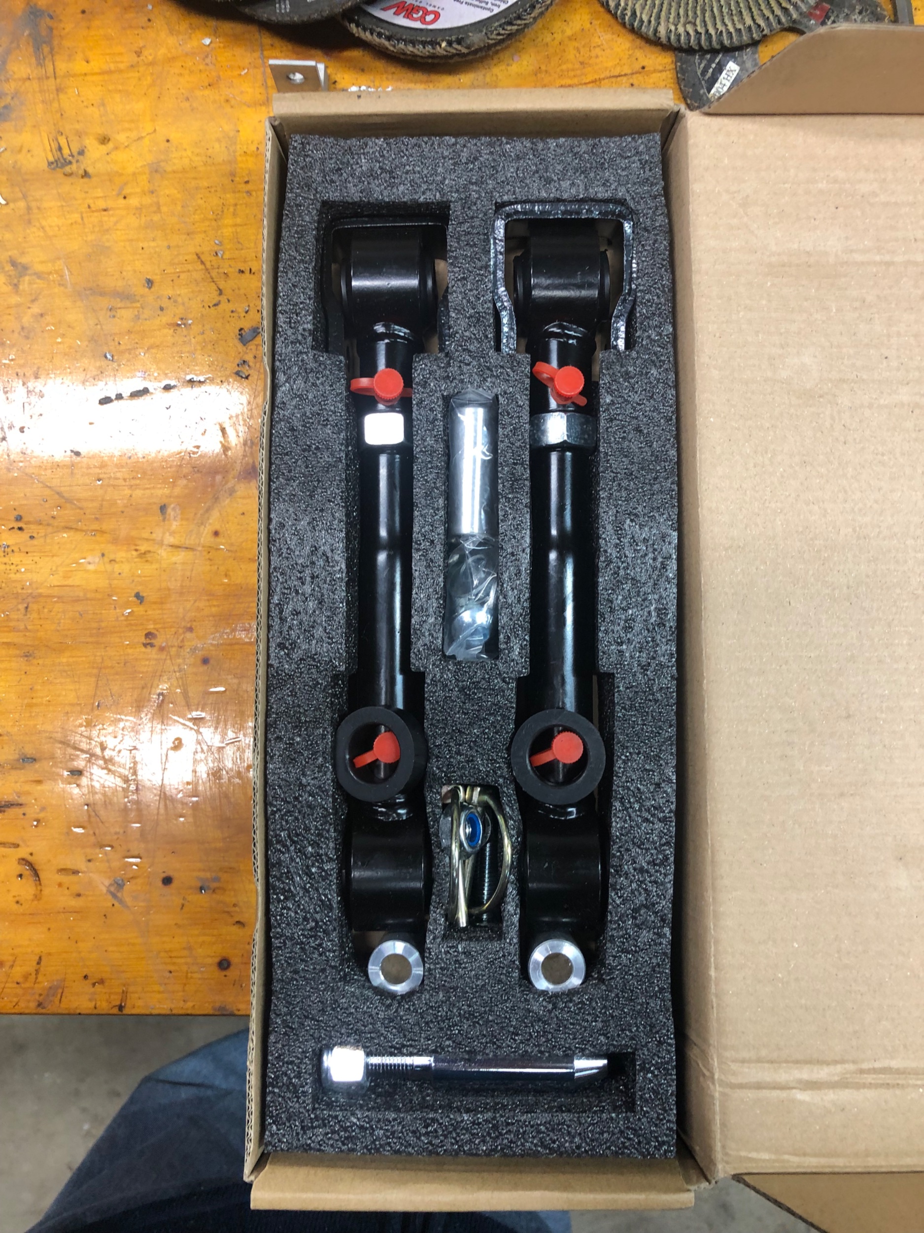

I got a set of Chinese JKS knockoffs from Amazon today. They seem well made. I’ll try to install them this week. Going on a 3 week trip Thurs so it my be a while if not done this week.

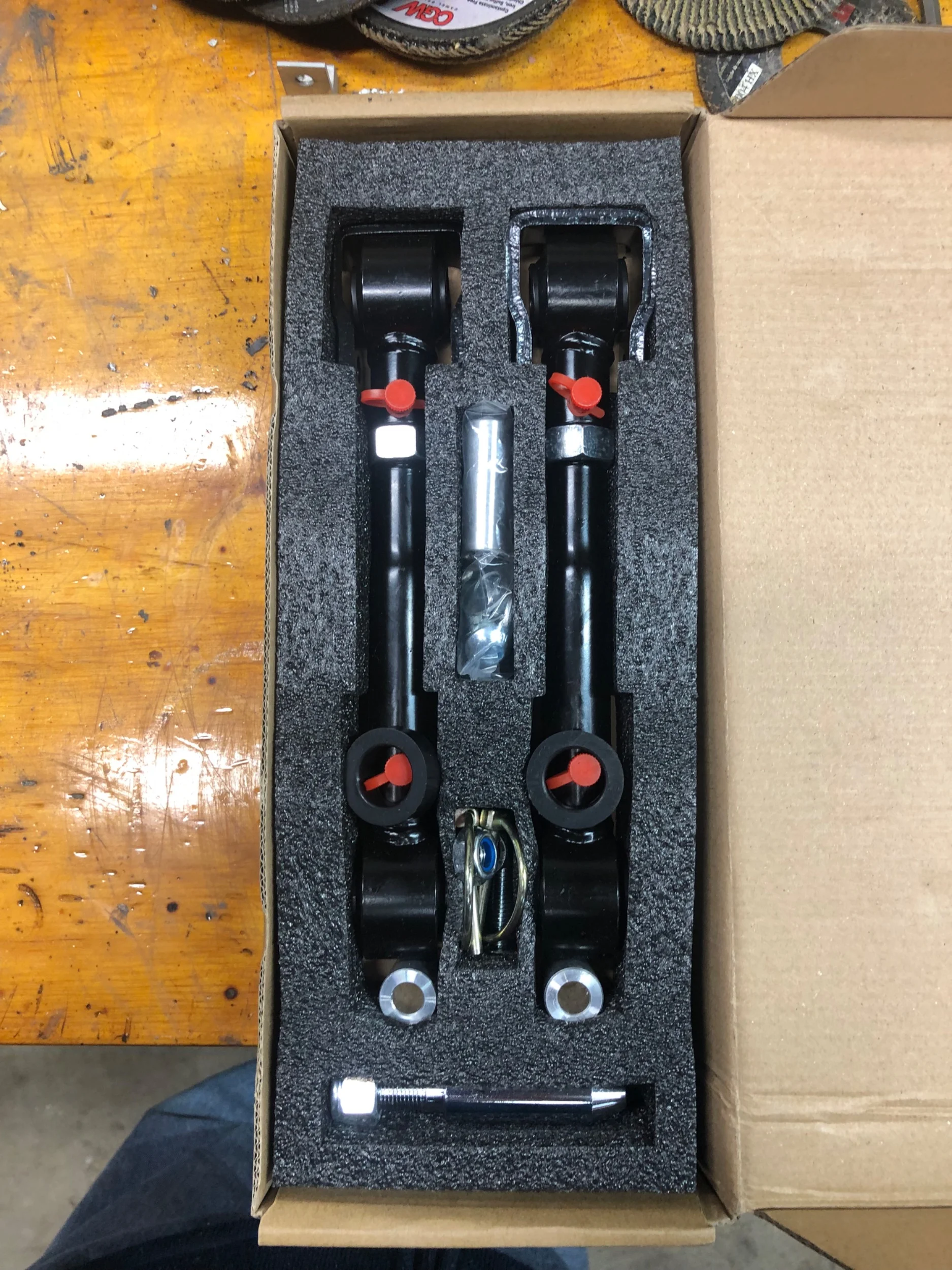

I've got the same set, they work just fine.
I will be replacing them in the future with a currie antirock.
