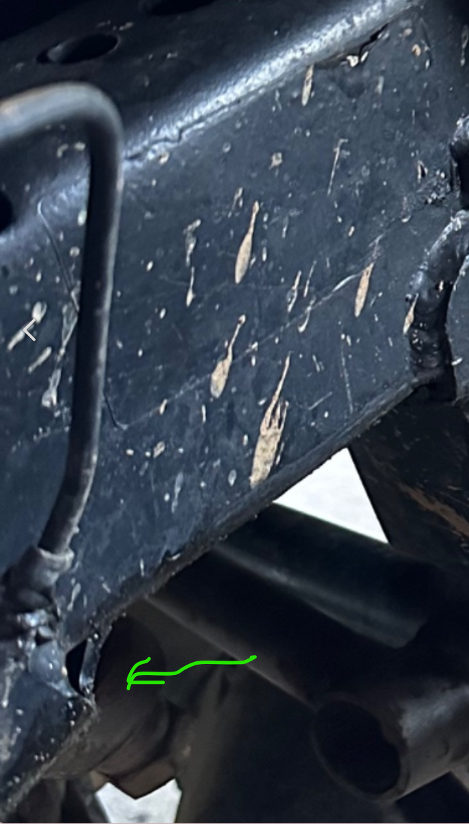

Front sway bar bracket for sway bar link 06 LJ

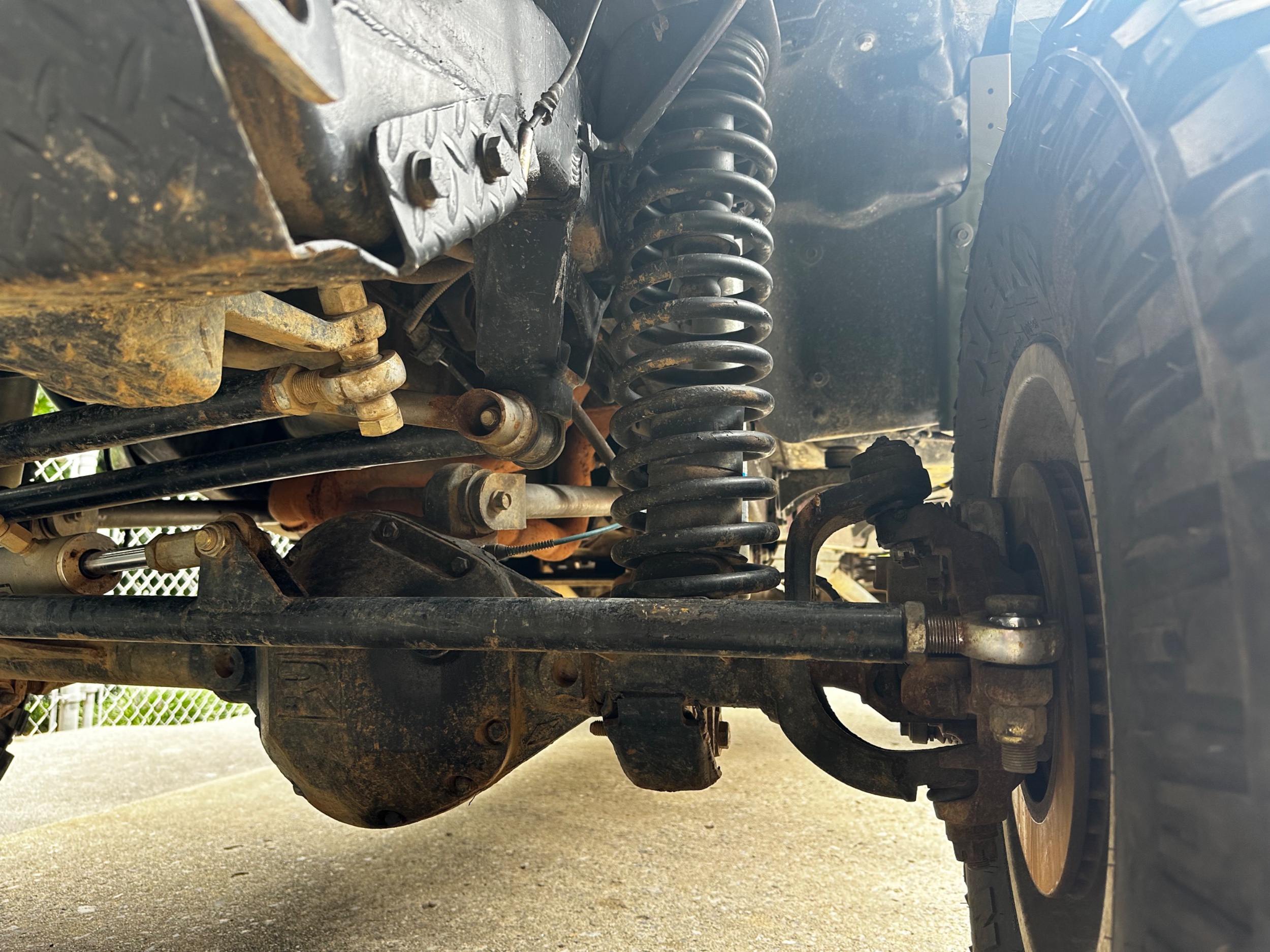

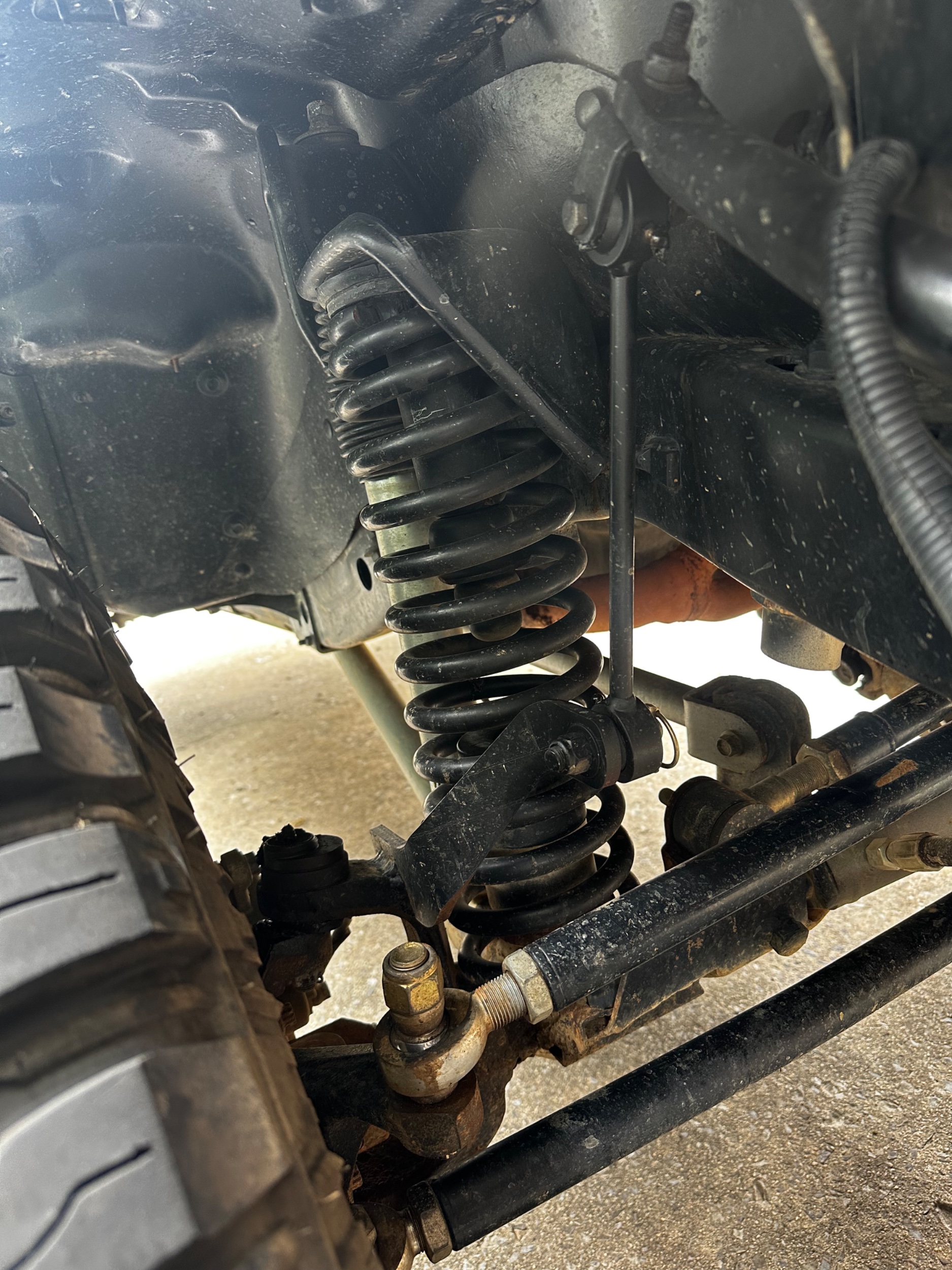

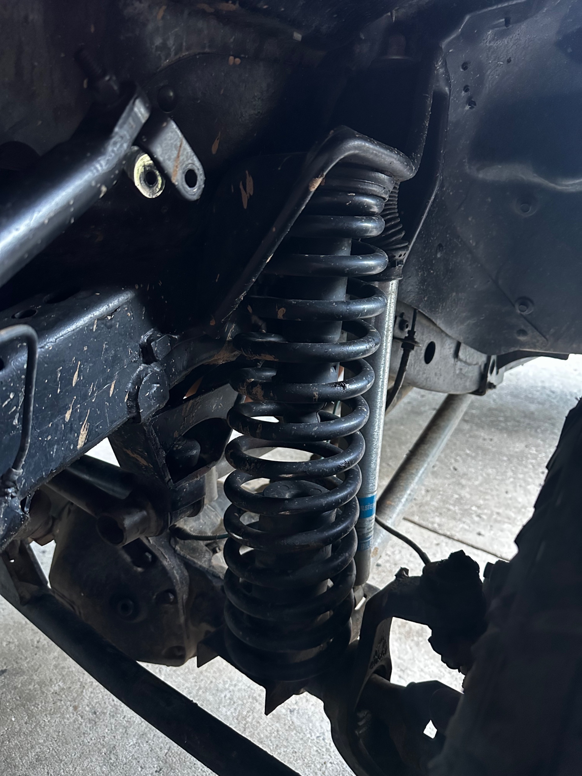

Thanks.. got the new brackets installed and ready to ride again👍🏻

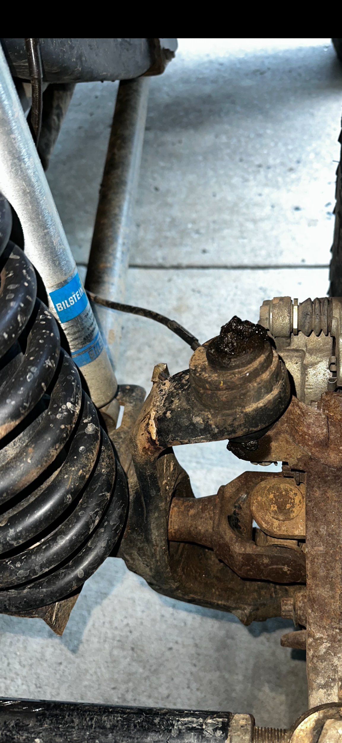

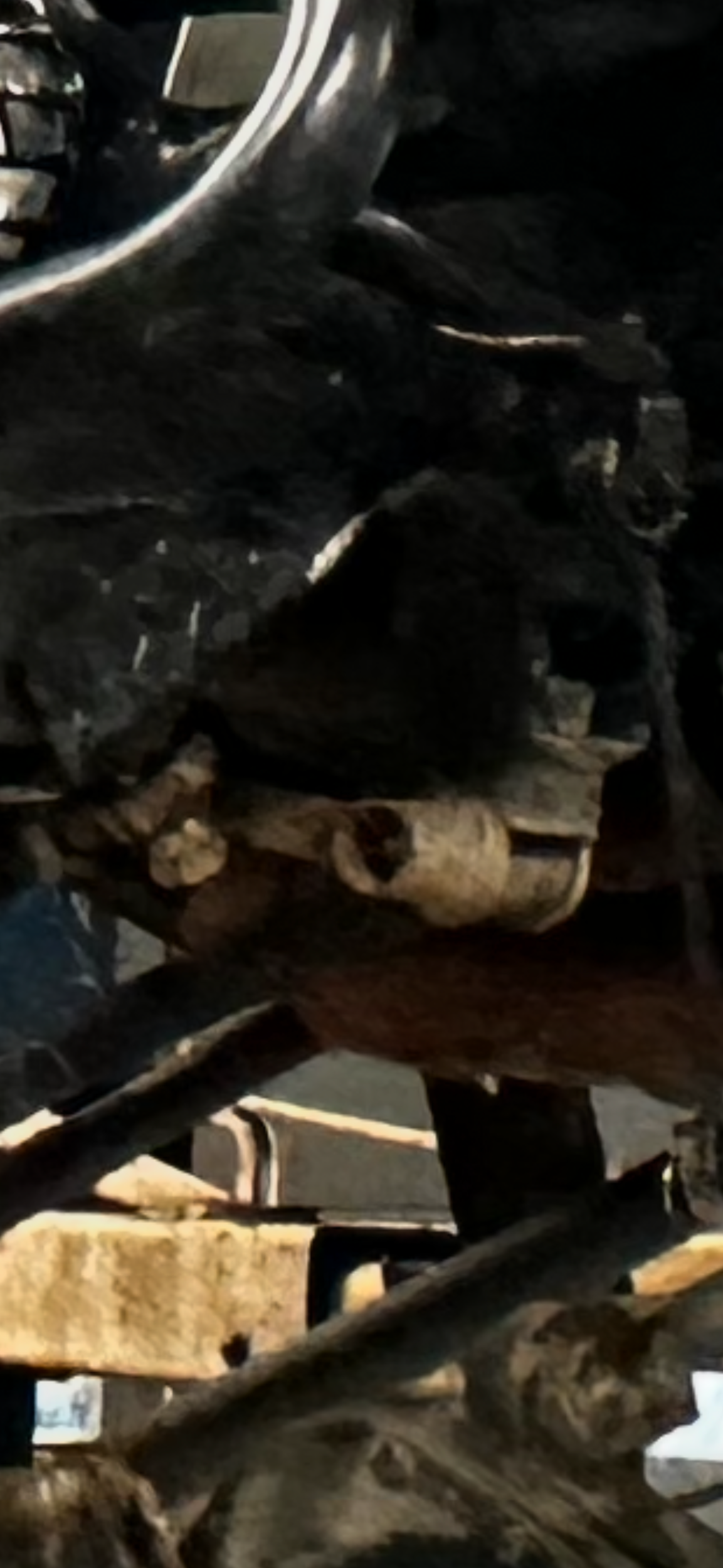

If you did a good job with the welds, you're probably in for an upper ball joint replacement soon since most of them have plastic races which melt pretty easily. We always pull the uppers to weld on raised swaybar link mounts.
The guy I had weld it is a guy that builds hot rods and motorcycles.. he was on the old tv show biker build off.. he is a genius with the welder… he mentioned the same thing …I ordered some ball joints.. going to replace the other bracket down the road and replace the ball joints eventually
