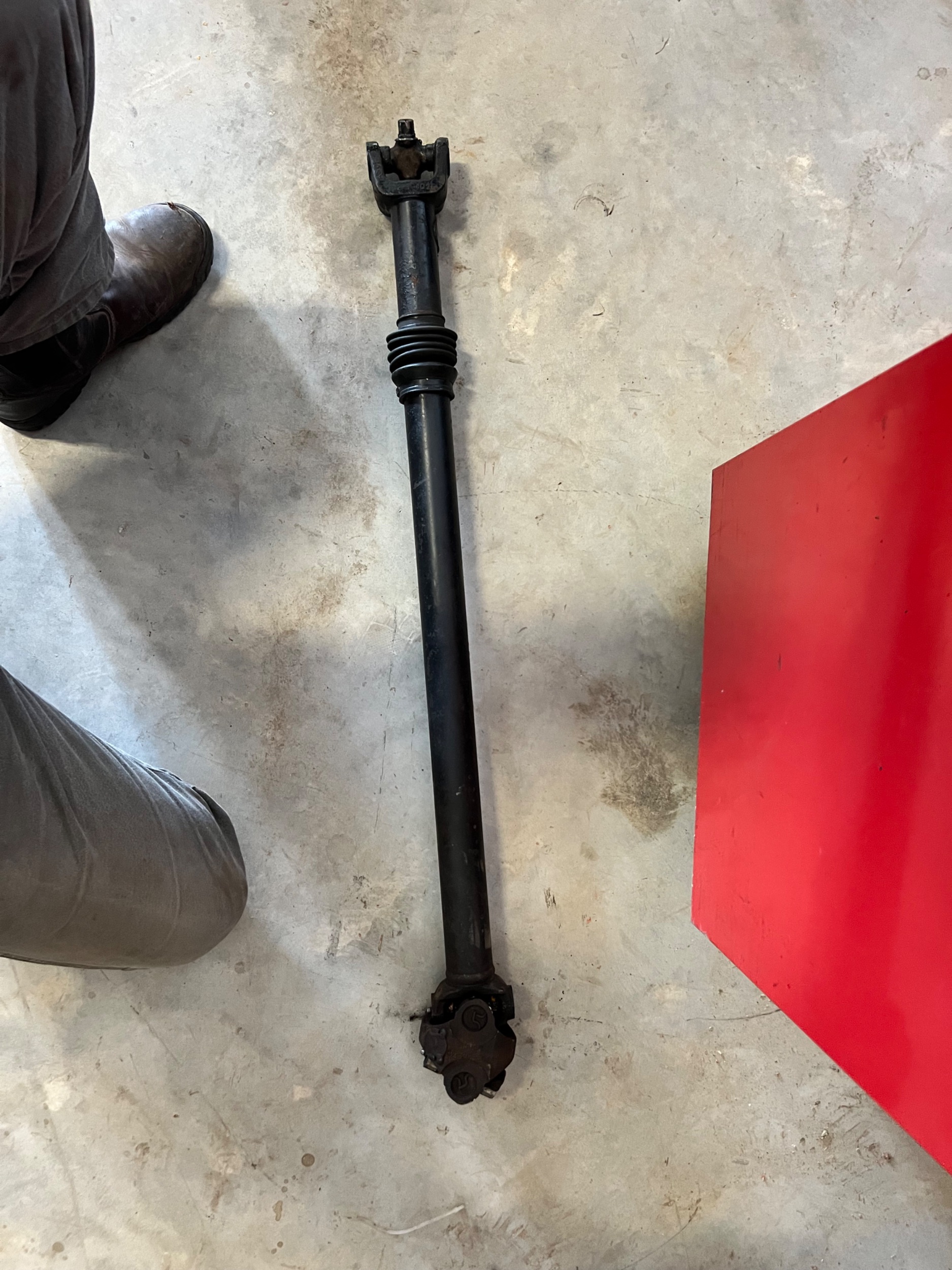

I'd guess the shaft is the wrong length. Best bet is to order a new shaft from Tom Woods. Give them the measurement between yokes and it will be made to the proper length.
The OEM front driveshaft is absolutely compatible with the RC LA 4-6" lift. You either don't have an OEM driveshaft or your alignment guy effed up.
Do you know how much collapse movement the driveshaft would normally have. I mean, sliding closed all the way till it’s bottom out, if the front axle is in the right position?
I think the drive shaft was always the wrong length and the journey you embarked upon by installing the lift led you to that discovery. Put the axle where you want it in the wheel well, the drive shaft should then be made or ordered to fit. The shaft you have looks like an aftermarket shaft, maybe it was never the right length. TJ front shafts are usually in the range of 39-41 inches, in their running position, maybe someone at some point got a shaft that "fits a TJ" but is on the longer end of that spectrum, too long for your TJ.

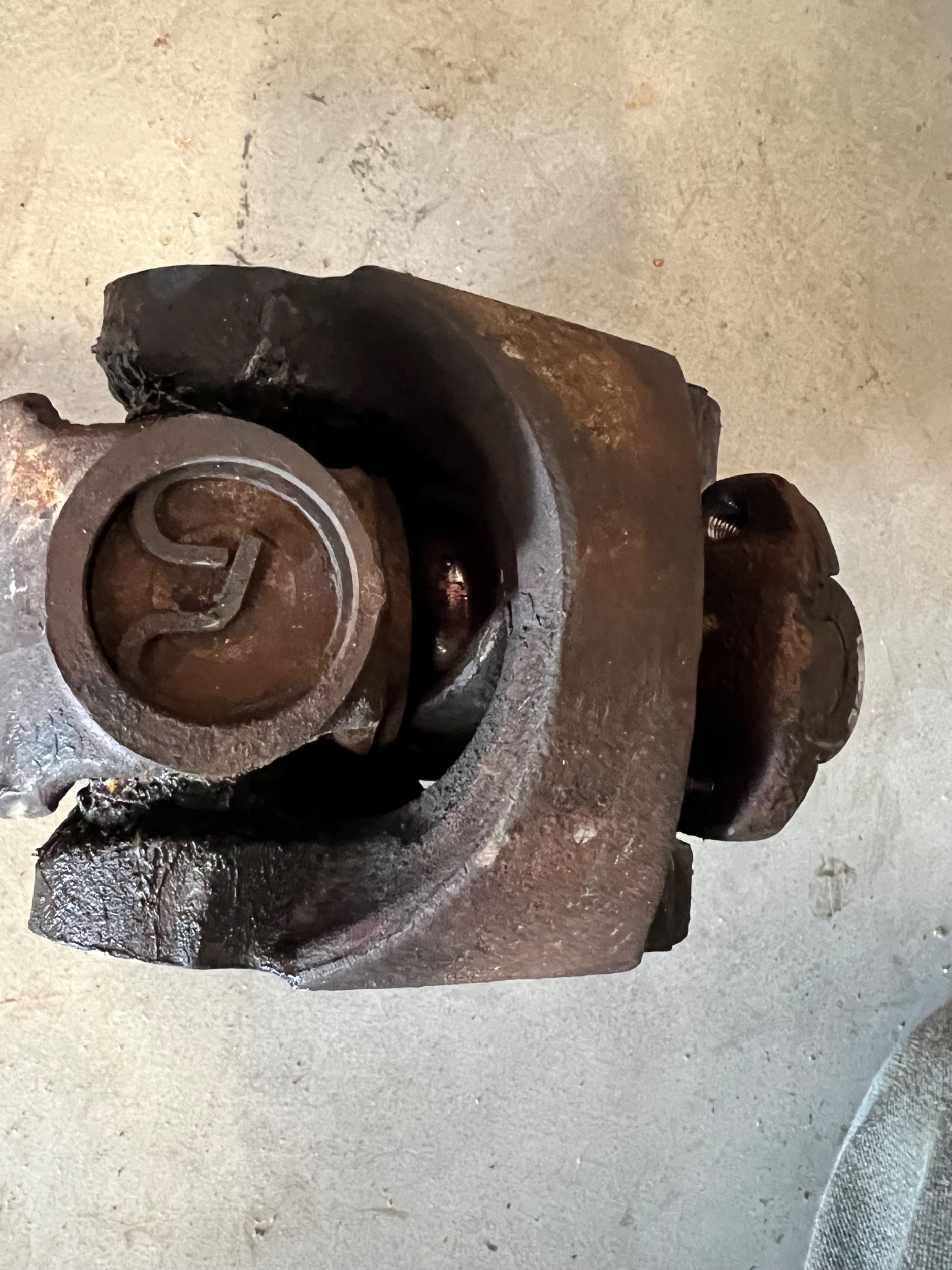

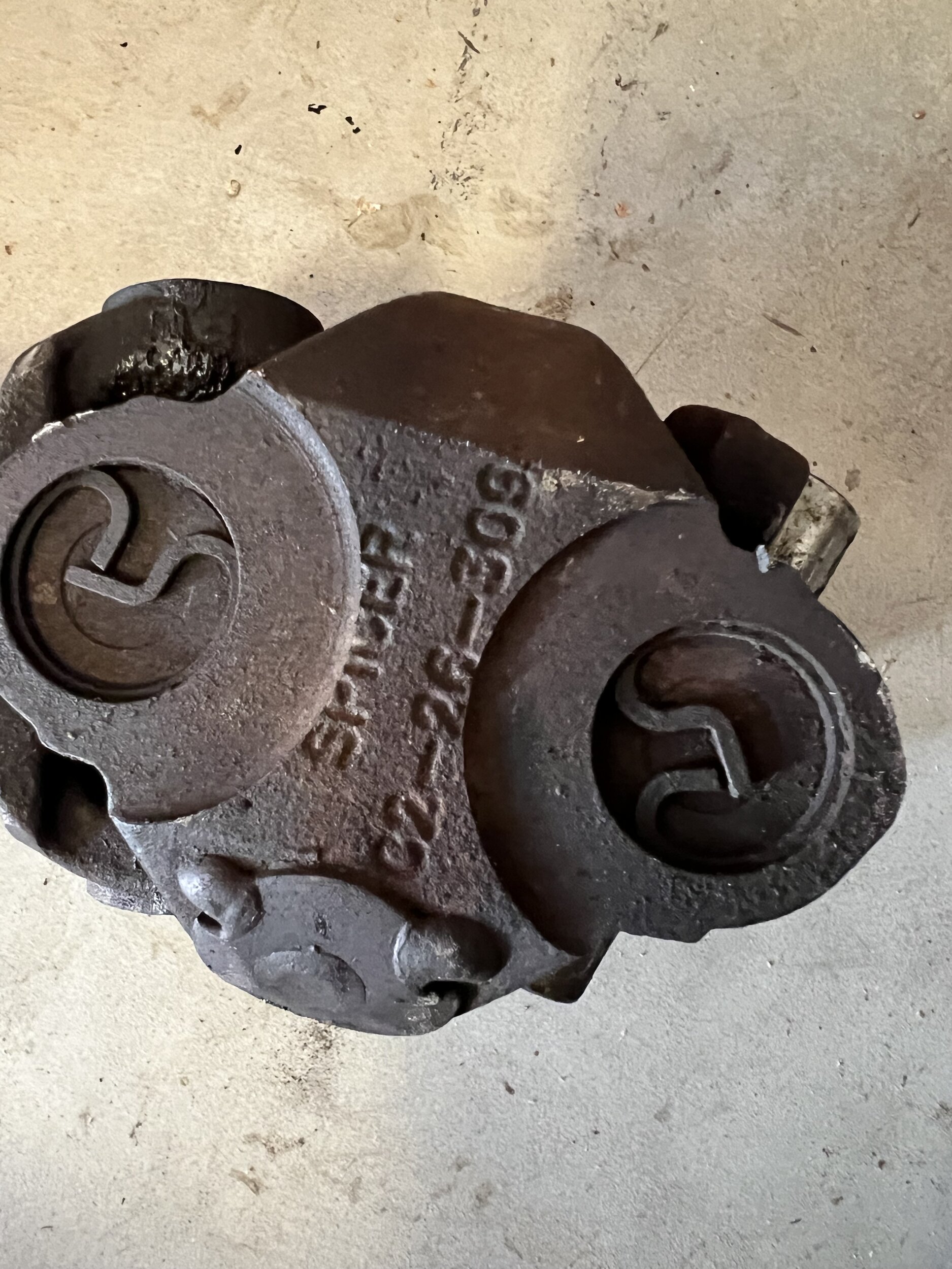

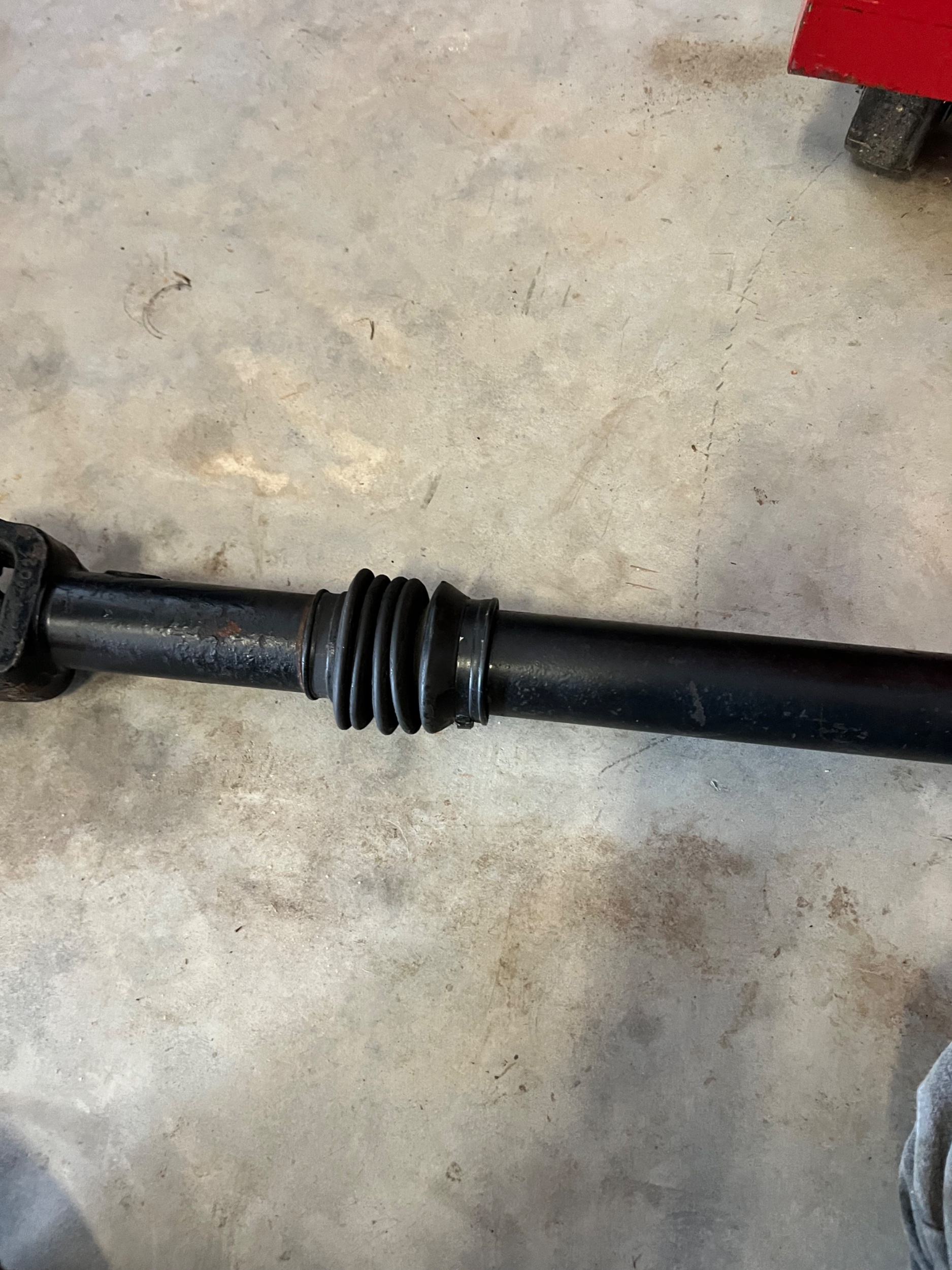

After a couple hundred miles started to get squeaking and binding noise. Dove into the problem today and the issue is the front driveshaft.
Questions I have is the front axle adjusted too far back, thus reducing the length of the driveshaft, wheels are centered in the wheel wells. Or is the driveshaft the wrong size for the now configured lift?
Is the driveshaft slip seized up or just bottomed out? You should check the pinion and tcase yokes for side to side and in out play. The bearings won't like what the driveshaft has been doing
Squeaking and chirping is pretty indicative that the double cardan joint is on its way out and in your picture the centering ball looks awfully dry...
Remove the springs, cycle your axle to full bump/droop. This will tell you a lot; 1) the amount of travel the driveshaft sees, 2) Whether or not your current driveshaft is too long or too short, 3) if your bumpstops are set correctly, 4) if your bumpstops line up at full stuff (don't look at if the wheels are centered in the wheel well or not)
It had maybe 3/16 of movement after unbolting the ujoints. Everything looks solid. I don’t know what to say.
