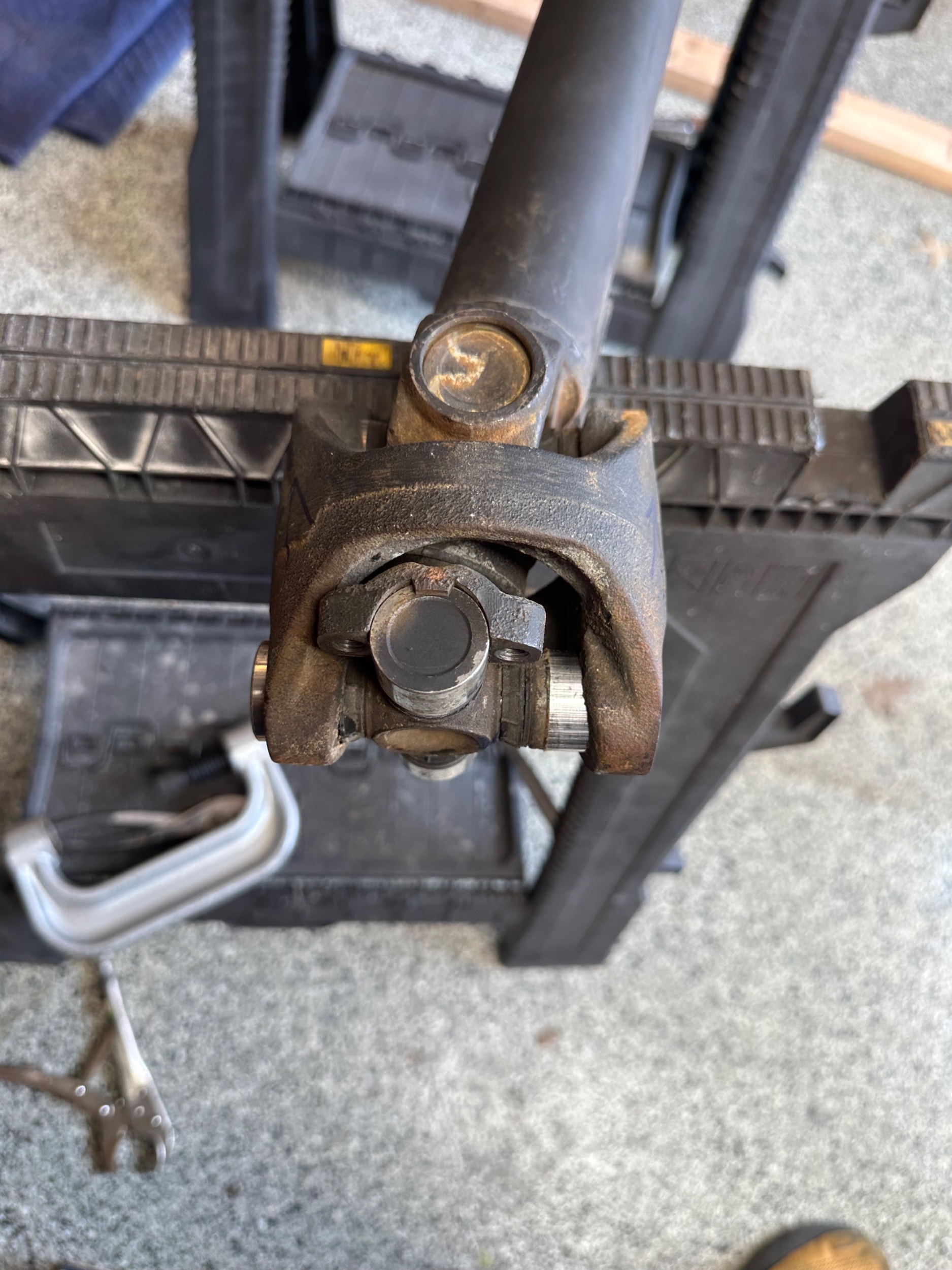

So I’ve found the two u joints at the double cardan are bad. I’m trying to push them out and idk why but I cannot get them to come out. The inner portion hits the flange of the double cardan before the cap is even close to coming out. I just did one for a Dana 30 front driveshaft and had no issues. Am I an idiot? Lol. I pivot it so the inner portion doesn’t hit the flange but while pressing it out it twists and hits the flange like in the picture
