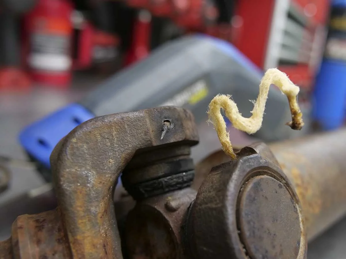

Measuring is super simple, just measure the distance from your transfer case yoke to your pinion yoke as shown below. Yes, the lengths can be fairly standard but a couple minutes of your time measuring will ensure that you get the right thing the first time around. You'll hear a lot of people say "center to center" when referring to drive shaft measurements. Center is a matter of perspective so it's important to clarify what that means, it's center of joint to center of joint, or centerline of the bearing cap. Measuring to the edges of the yoke as shown below will give you that number. The reason we tell people to measure from yoke to yoke is because if we tell people to measure center of joint to center of joint they'll often take the shaft out, lay it on a bench, and measure it. But because the shaft compresses and extends it is very important that the measurement is the "running length" the normal installed length.
From there, just make sure that whoever you order a shaft from understands how you ordered. I always say that there is not a right way and a wrong way to measure as long as we are both talking about the same way. There is no official industry standard for the proper way to measure drive shafts. Most companies will measure similarly to us though.
