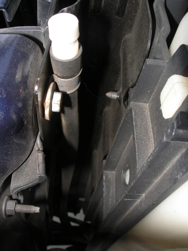

I read it attaches up on the drivers side of the radiator but I see no clip, and the vent is broken off the end of the hose now.
Does anyone know where I can source the clip and vent?

Or you could just use a ziptie which is what i did, It doesn't bother me enough to change over a to a clip even though i have em
Also it doesn't necessarily need to be on the radiator unless you go deep in water.....but yeah i digress,The links are in the underlined words 😄

Mines ziptied too. Not exactly a lot of force on it lol

Usually bolted on.
