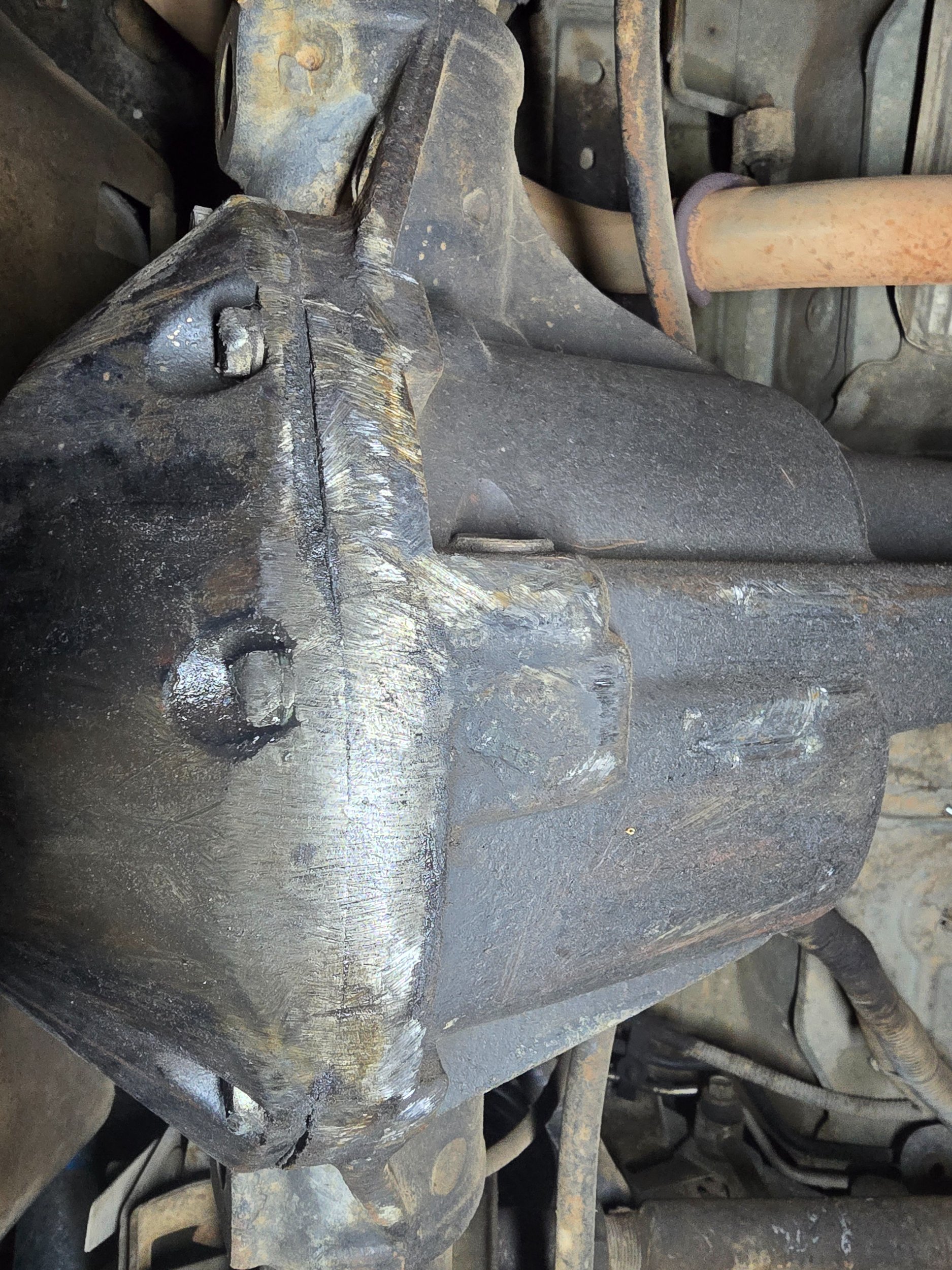

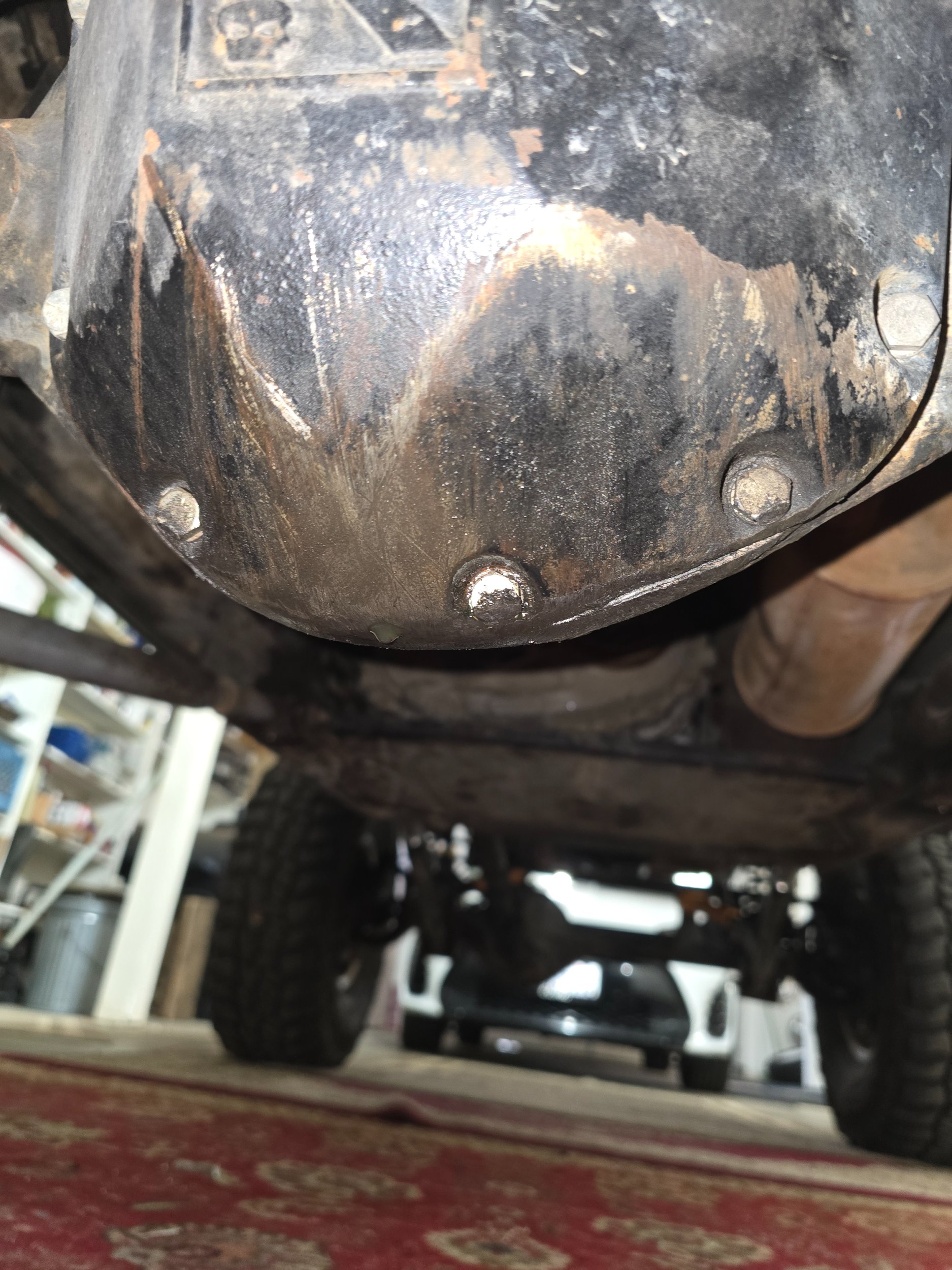

I've noticed that my rear diff is getting eroded or shaved or ground or whatever term you prefer that describes what's happening. Seems I'm slowly wearing away at it from sliding along granite. You can see the bottom bolt has been affected and im almost sure thats where the slow drip is seeping from. I thought I'd toss the situation out to see if there are any good ideas out there. This condition developed over 5 or 6 Rubicon trips.
I can get a skid. I can just let it go and band aid it along until later. I can weld a sacrificial bead or two along the bottom. Thats the end of my ideas.
I dont think a new diff cover is wise, the cover will have an exposed edge at the bottom amd surely that will get peeled right off. I would love to find an nth degree skid. I can make a Metalcloak or Rough Country JK skid work. I'm a crap welder on plain metal but I have equipment, the cast iron part is my hold up.
Anyone have a similar problem they've solved?
Im believing thats the route to go. But welding on cast iron? Can I use my 110 lincoln and just lay booger welds all over?
I'll probably just have a shop do it for me. Two things I don't do (or do well). Weld, change ring and pinion.
You could preheat it and use flux core wire and get a decent layer built up.

IMO, it doesn't look bad enough to worry about yet.
The cover sits pretty flush towards the bottom, but the sides need more wear (my apologies for being picky).

That's the other half of my thinking. Let it be, perhaps replace the bottom bolt. I guess stopping the drip is part of the goal. Preventing it from getting worse is the rest of the idea.

If you are going to keep dragging the housing, weld facing to it to slow down the erosion.

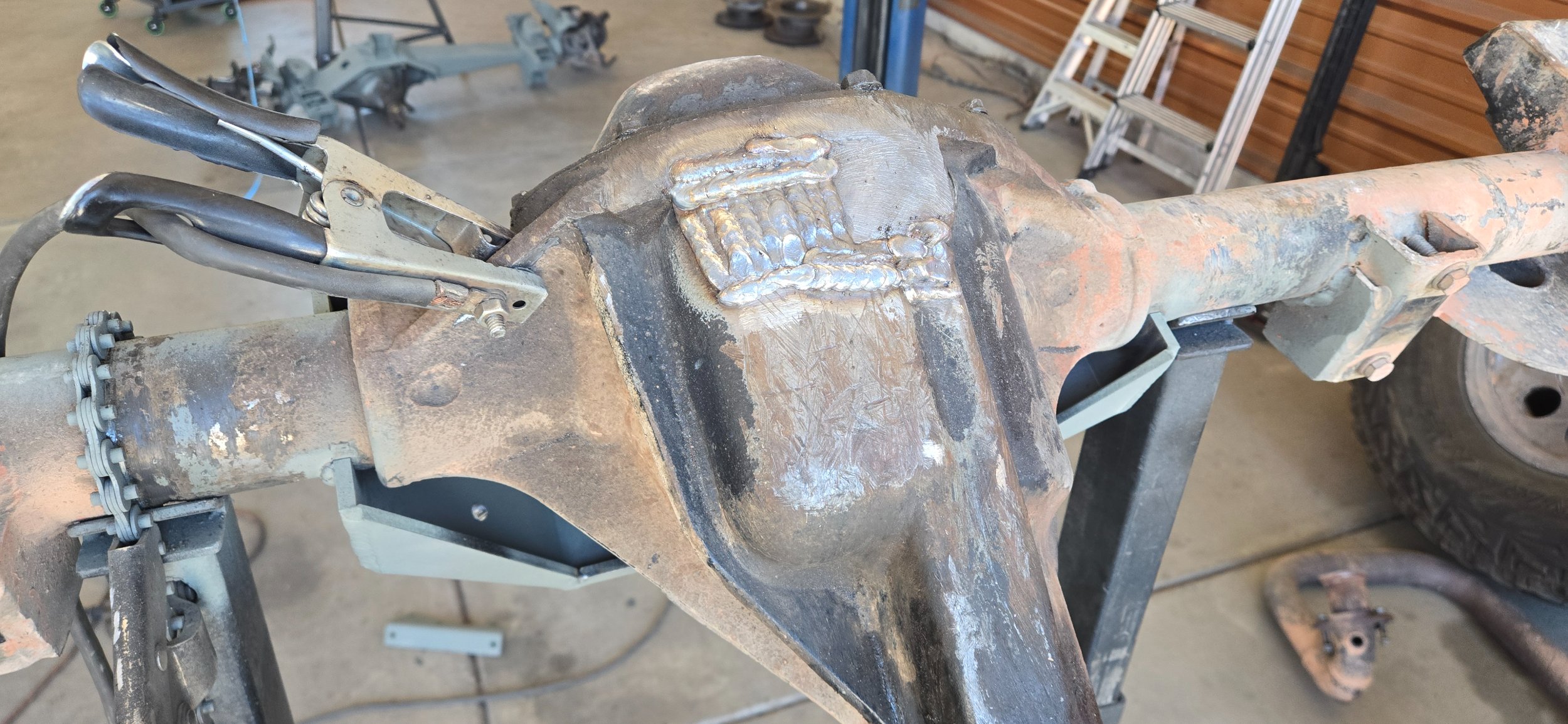

When I had the Dana 44 in the rear I ended up first adding a plate and ended up eroding through that and ripping it off. I then just added some beads of weld with the mig and then hard faced with some Blue Demon Hard Face rods I got from Amazon. That worked until I got rid of the Dana 44 in the back. Before I ran the beads with the mig I did heat the diff up with a torch but not to preheat the diff but just to try and get as much gear oil burnt off as possible and to clean it, I cleaned it really well with brake clean but was afraid that there was still some gear oil in some scrapes that I just ruffed up and didn't grind down completely. I think building up the surface with the regular wire or rod first gives a good surface for the hard face to stick to.
