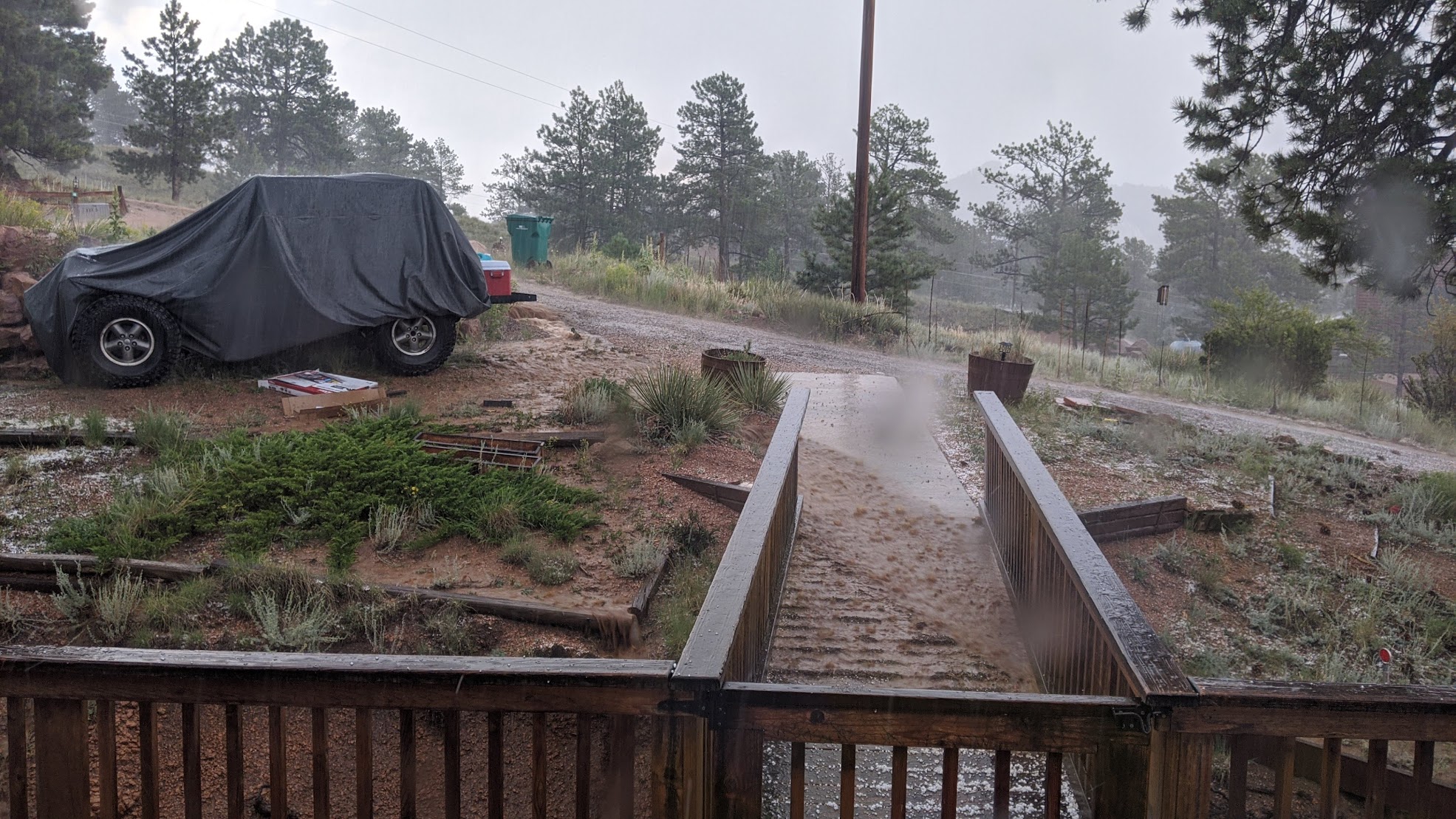

Yesterday it rained super crazy. The water normally comes down the driveway and either runs along the driveway, or turns and runs along my jeep and a retaining wall around the side of the house.
You can see in the picture that the water overflowed where it makes the turn behind the jeep to go alongside it and around the house, and instead ran down my walkway and deck.

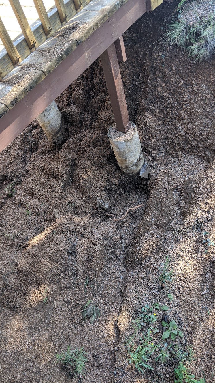

It poured off the deck directly next to one of the footings:

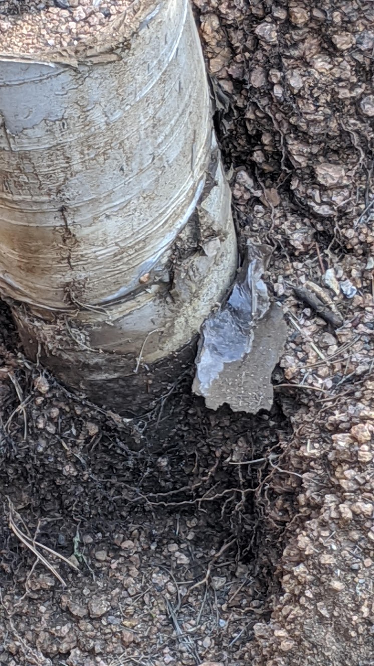

I've checked and the bottom of the footing is NOT exposed, so luckily whoever built this deck had the foresight to put the footing deep AF.

If it didn’t wash out all the way to the bottom, pile the dirt back up and send it. Grading the grounds around the posts can help prevent that in the future. Also, if you deck sheds water like that, a gutter off the edge might not be the worst thing in the world to divert the water where you want it.

I'd look into a load of crushed stone to compact around the deck footings rather than dirt.
Yesss thank goodness, this is what I was hoping to hear! So glad the footings are so deep lol.
