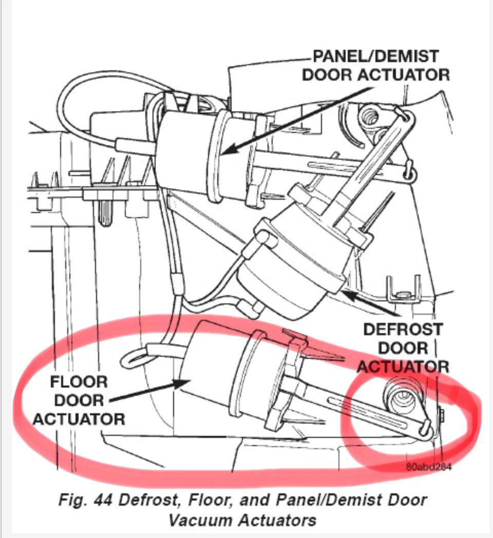

The Floor Door Blend arm broke. Is there a correct blend arm for it, and as far as removing the broken one, Do I just yank it out?
My Defrost arm was broken too, but I drilled a screw into it and yanked it out can I do the same for floor arm?
Quadratec and extreme terrain have lower blend arms but don’t seem to be the right ones, or am I wrong?
Appreciate the feed back 🤙🏾
If i remember correctly 2 of those 3 arms are the same part number. Pretty sure dorman or Crown makes replacements. I ordered them for my 97. Look at the parts list for yours under the resources section.
