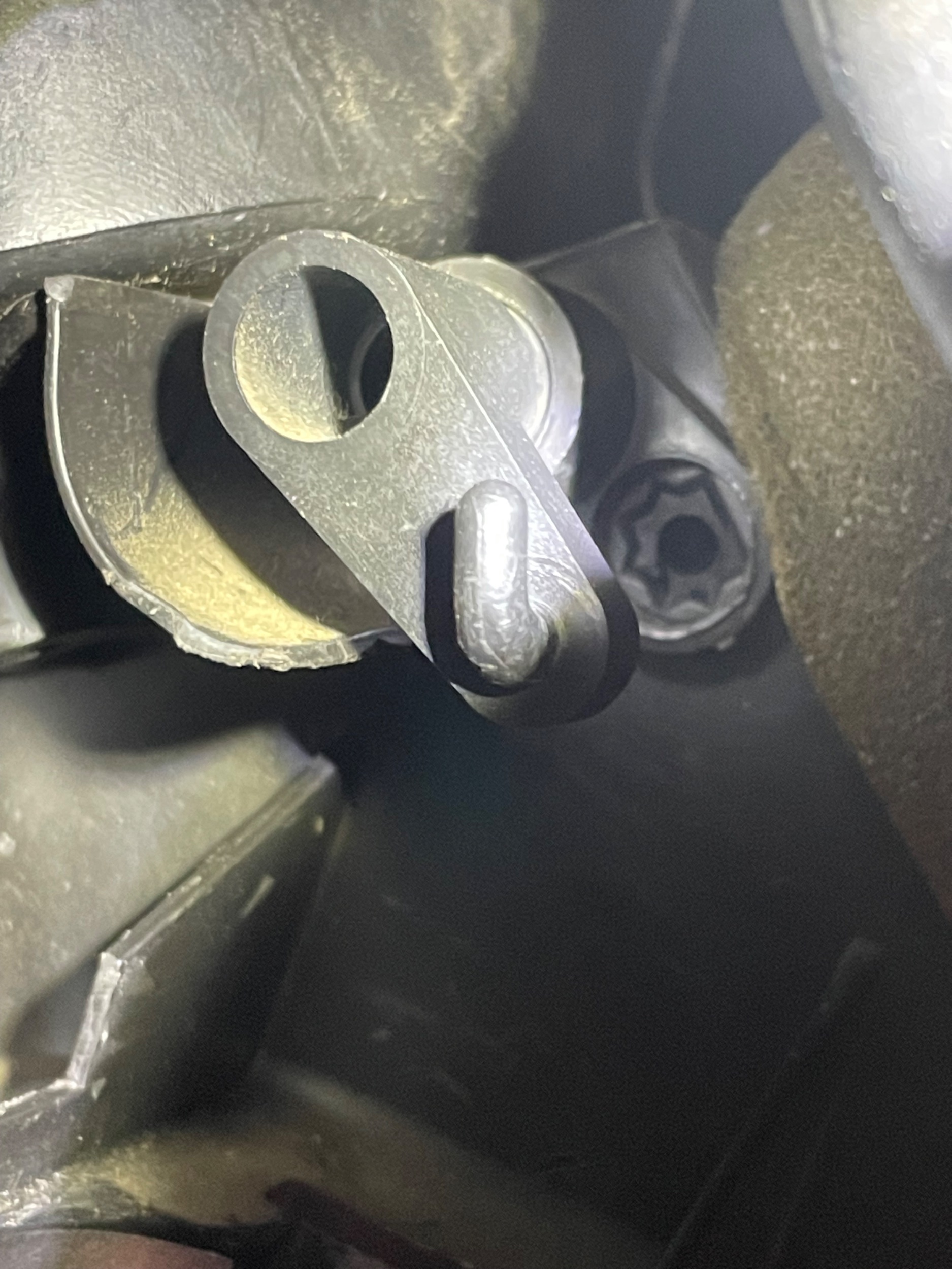

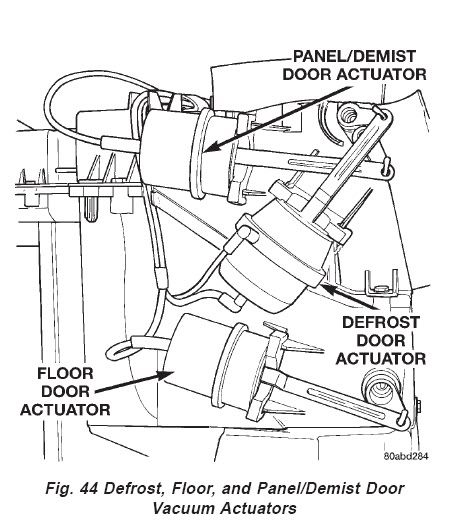

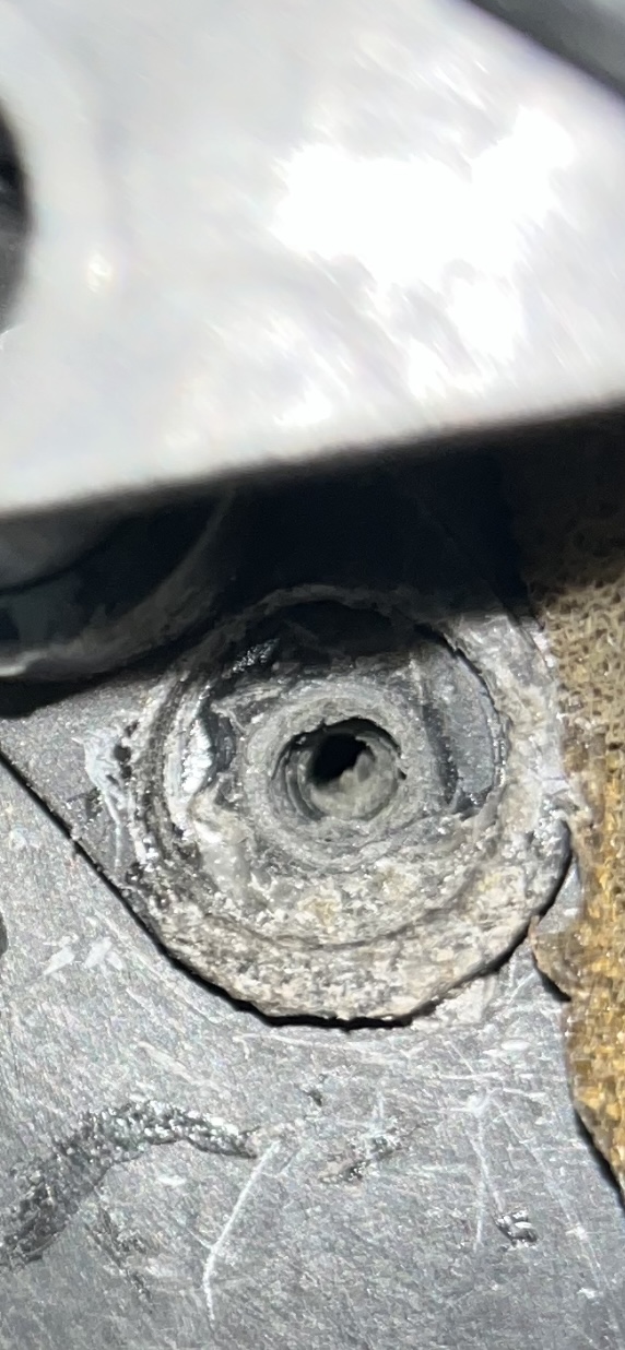

Hope everyone’s doing well! Working through previous owners issues on my sons TJ and hoping for solution on how to get the face/panel vents to open position. We’re in Florida and really have no need for heat/defrost but could use a/c during hot rainy season. Floor and defrost actuators work fine. Panel/face black plastic lever that connects to the actuator arm broke off…based on how gnarly the opening looks it seems PO tried to glue the arm back on and screwed into it. Posting pic of ours, what the star key opening should look like based on other posts. Anyone run into this problem and figure out a way to get the face vents open regardless of the selector position? Really appreciate the support!!
