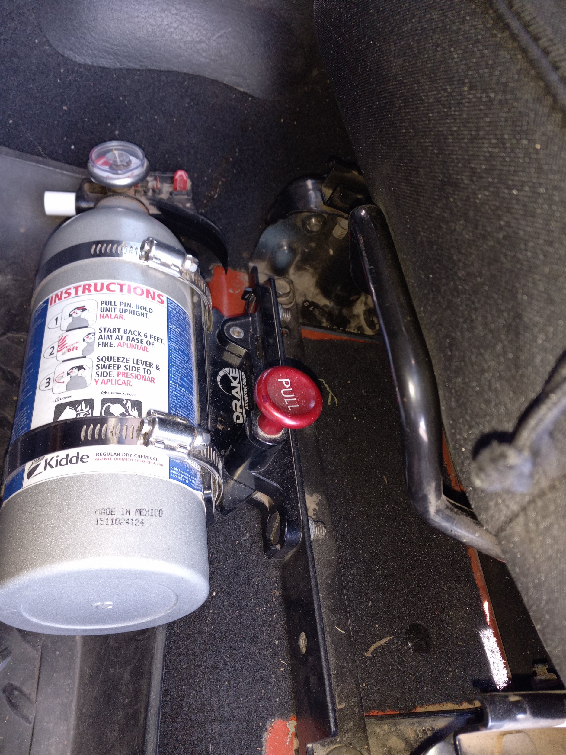

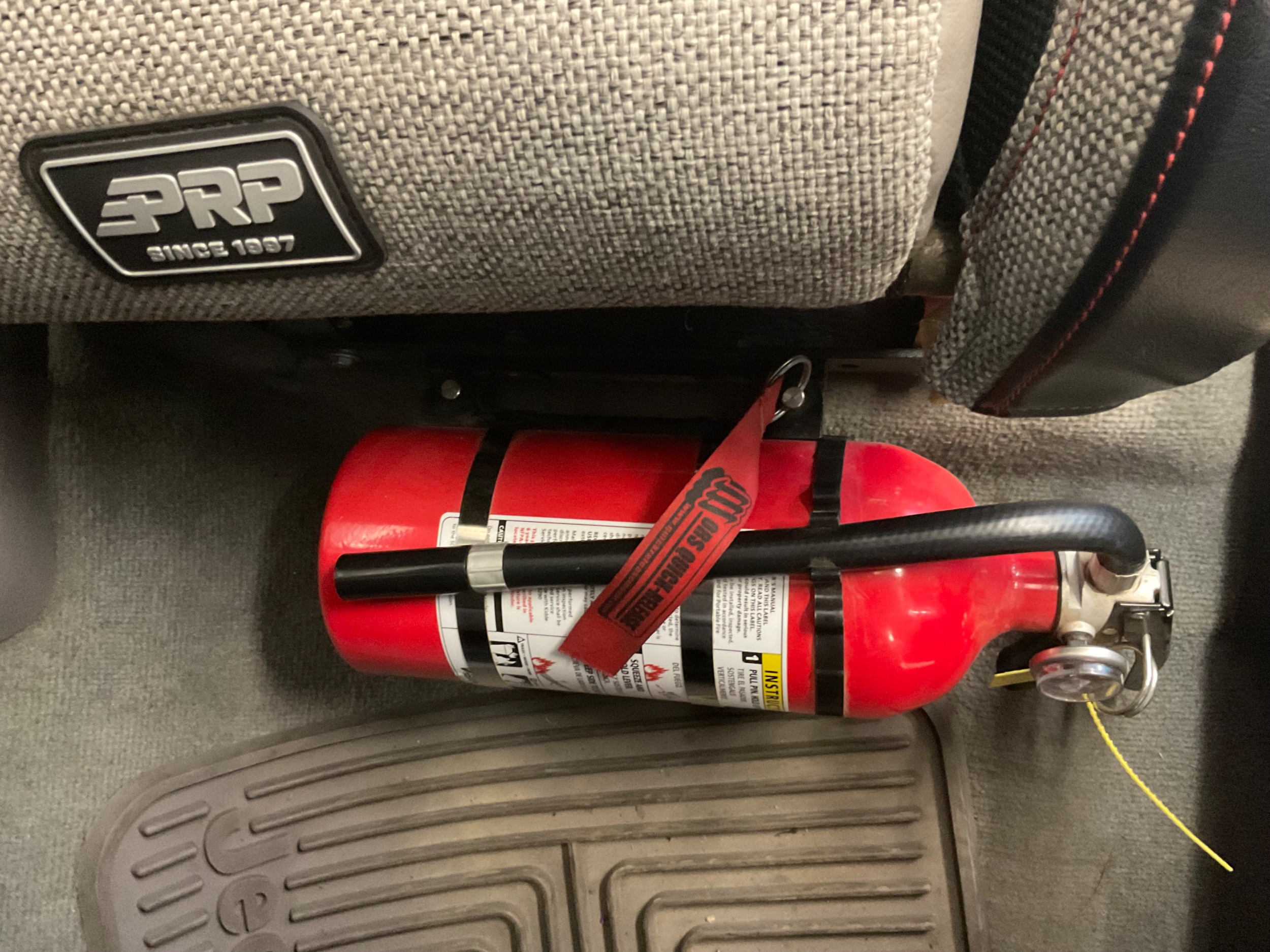

I am eyeing the spot in front of the driver seat - if the fold/tilt capability isn't impacted. The brackets that have the 'pull here' plug seems to add too much length and could/would bind against the front of the seat when pulled

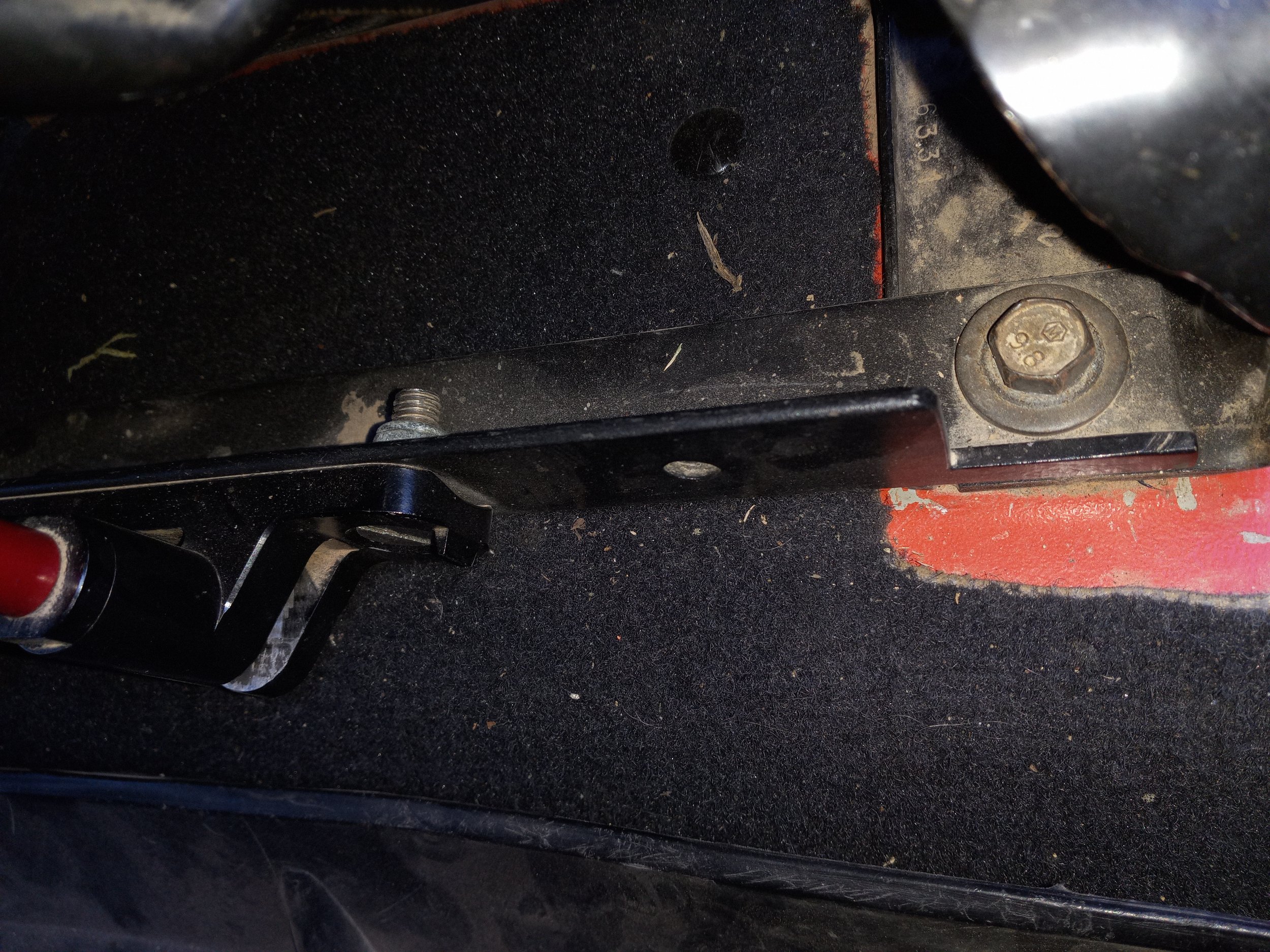

I like this. It doesn't effect the tumble feature?Mount bolted to angle iron bolted to seat mount.
Doesn't affect the slide or flip n fold.
Your the first that said it didn't. I will have to try this. I'm sure I've got some angle iron laying around.Not that I've ever noticed.
Keep in mind that the driver side doesn't fold as far forward as the passenger side.
What size did you use? I think I'll go get some aluminum and rig this up.

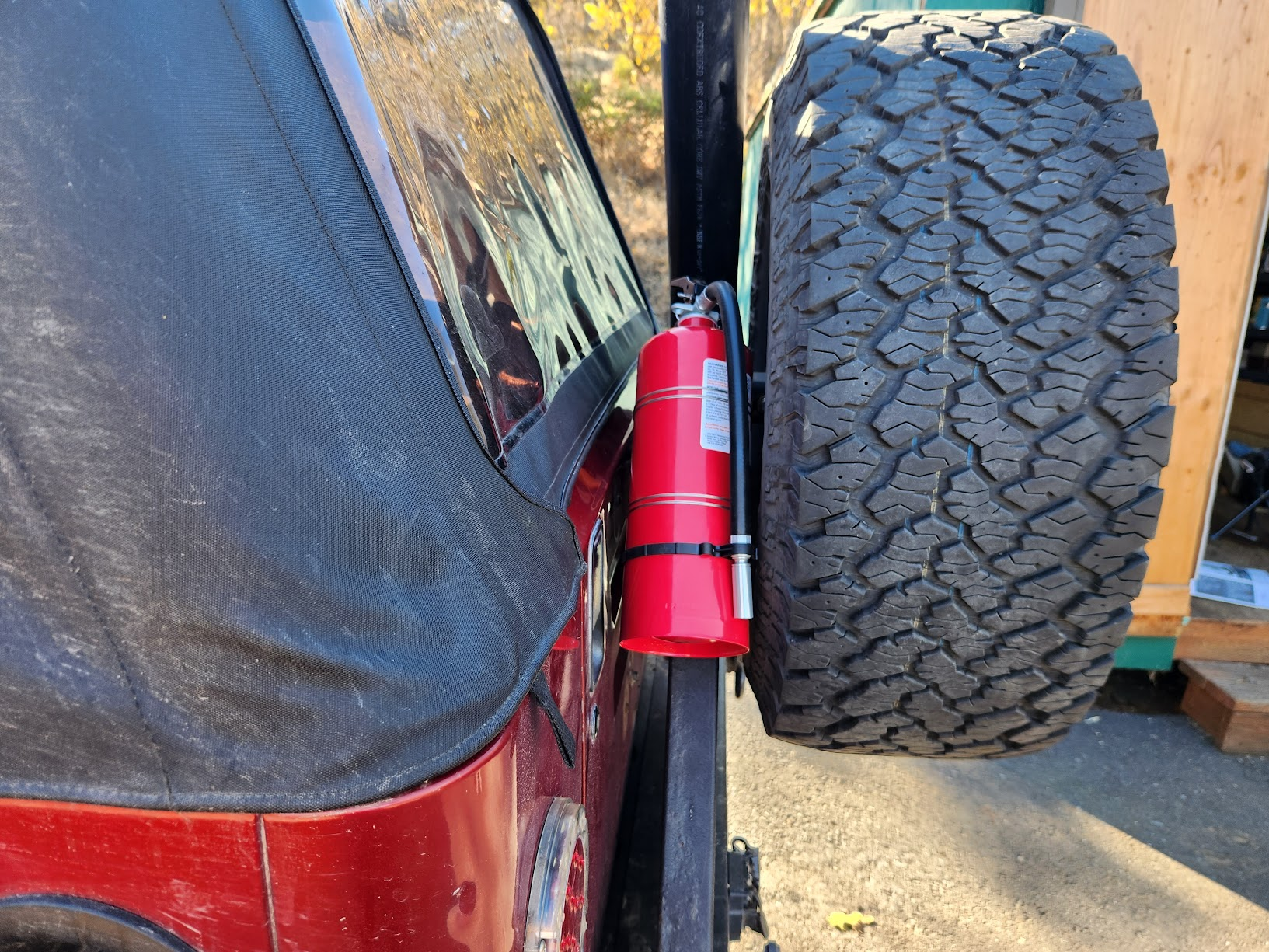

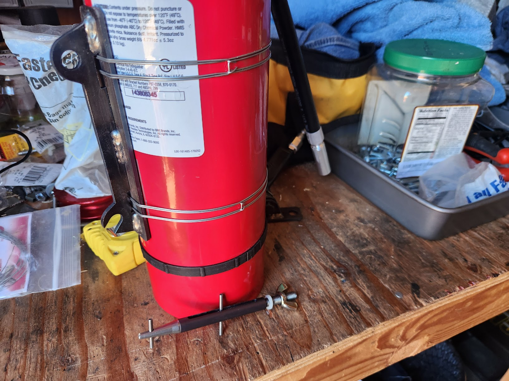

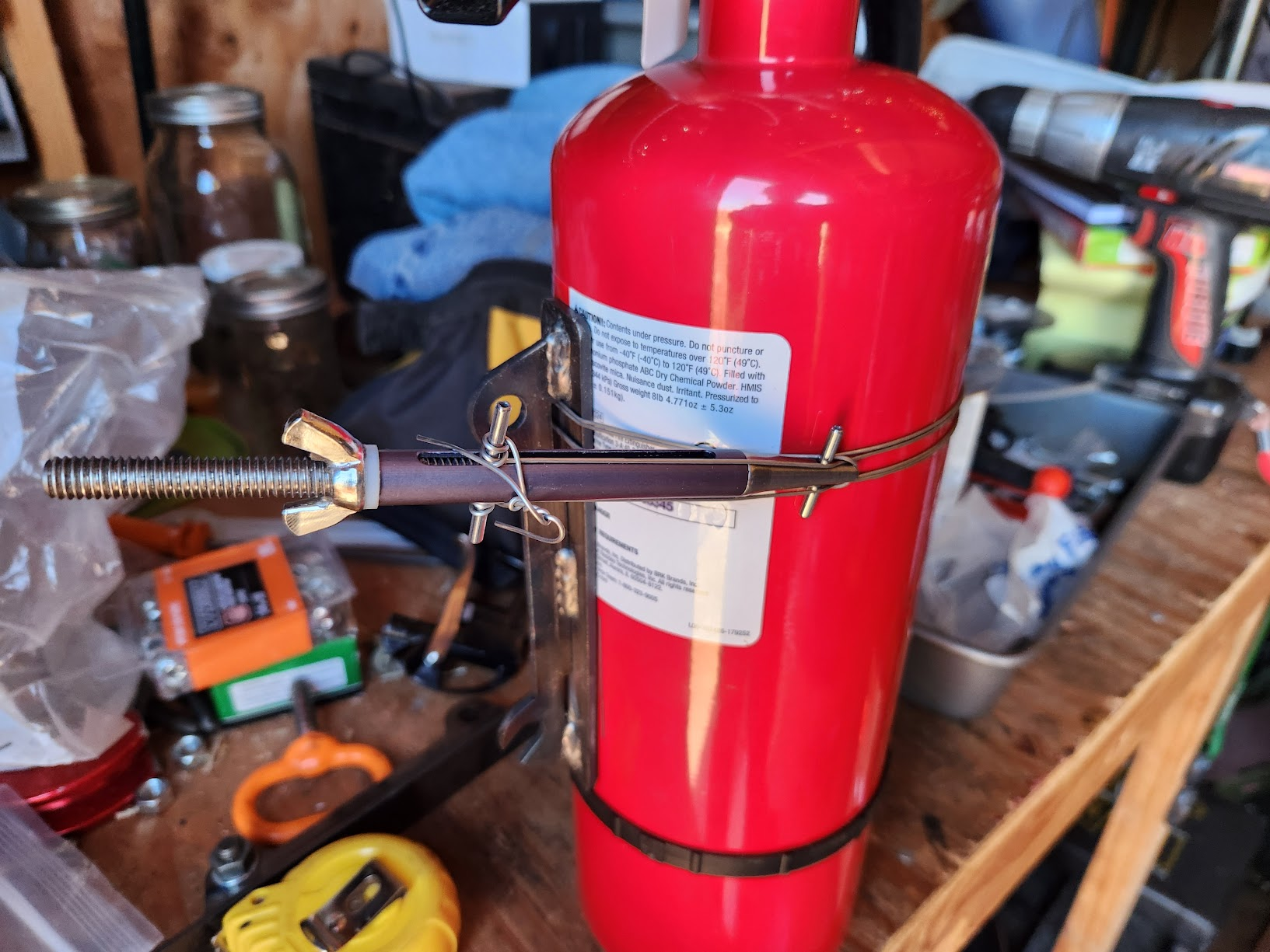

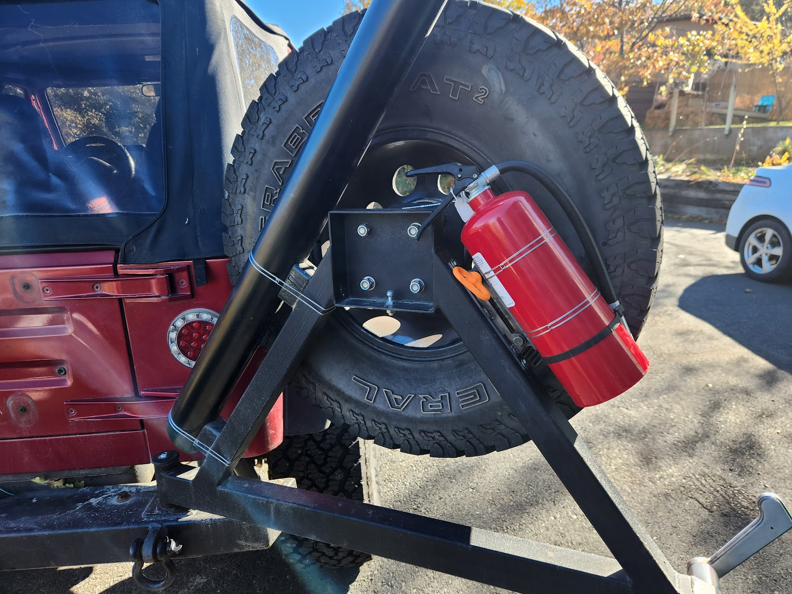

I finally got a 5 lb extinguisher mounted to my tire carrier, with a bracket I won in a raffle 15 years ago. About time i got that round tuit!

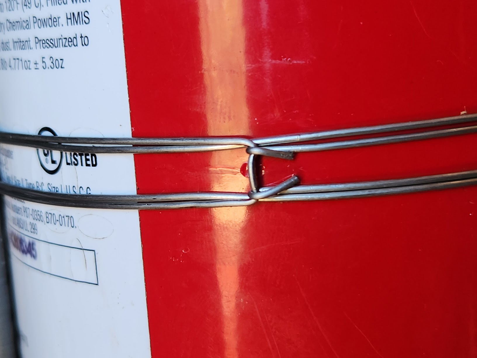

Instead of hose clamps I wired it on with a ClampTite, which is a pretty cool tool. It's more fiddly than a hose clamp but make a much cleaner bands, without sharp edges. I have a nice scare on my knuckle from a hose clamp. These are stronger, too.

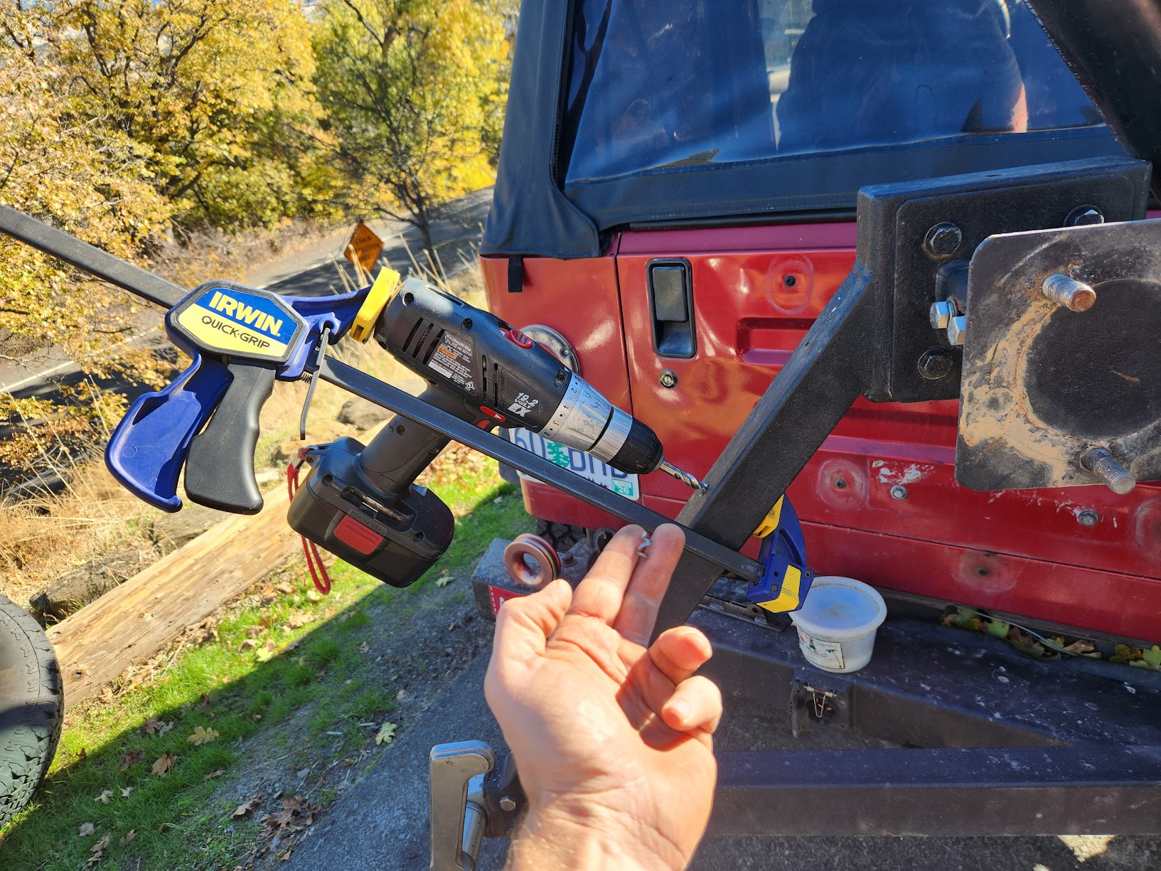

Drilled for nutserts. Quick clamp provides good pressure and makes nice chips
I can release it without opening the carrier, if I have to.

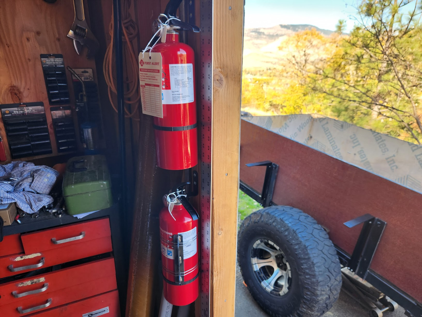

I put a hook in the shed for when I don't want to leave it on the jeep, right below the one that stays there.
