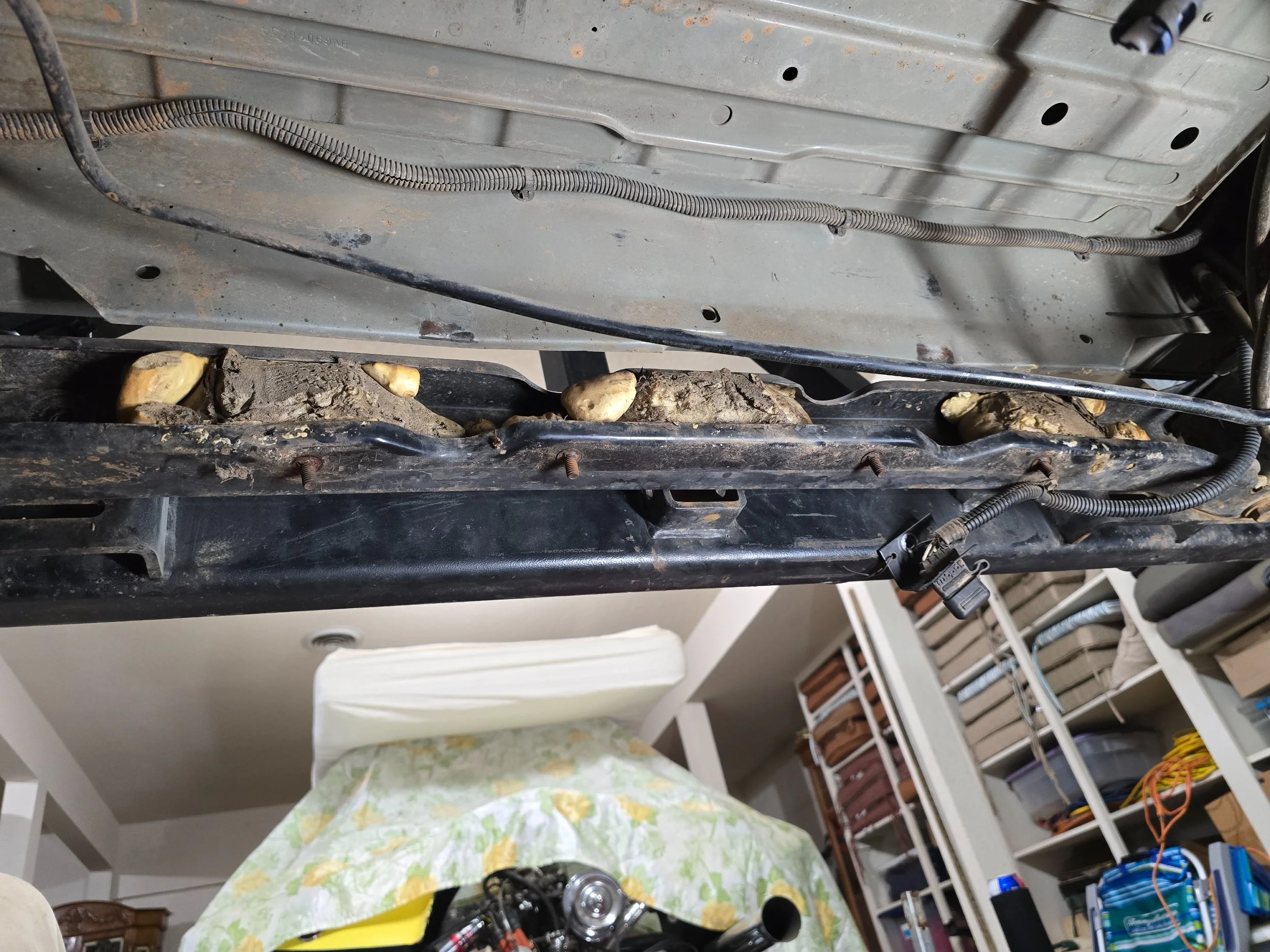

Long story short, I pulled my tank and discovered what seems to be expanding foam in the rear frame cross member.
Anyone else have that? If its factory its a poor decision if rust avoidance matters. If its from the PO im not sure why it was used. Not hiding damage, not for sound deadening, not for any reason I can fathom.
Thoughts?
I never had the tank out of my 99 TJ to see back there, but my 06 definitely did not have that. If a TJ came that way from factory i'm pretty sure I'd have seen posts about how dumb of an idea that is.
As to why...I find it is usually a fruitless endeavor trying to figure out why people do some things.
I have an 89 Grand Wagoneer with a floor that can tell us about the results of holding water against a steel surface and I don't think it would favor foam.

Jeep definitely used expanding foam on the newer jeeps , I’ve found it in multiple places on my 2012 jk that I bought new,
I haven’t seen it on my tj , that looks like the po tried to Jerry rig something

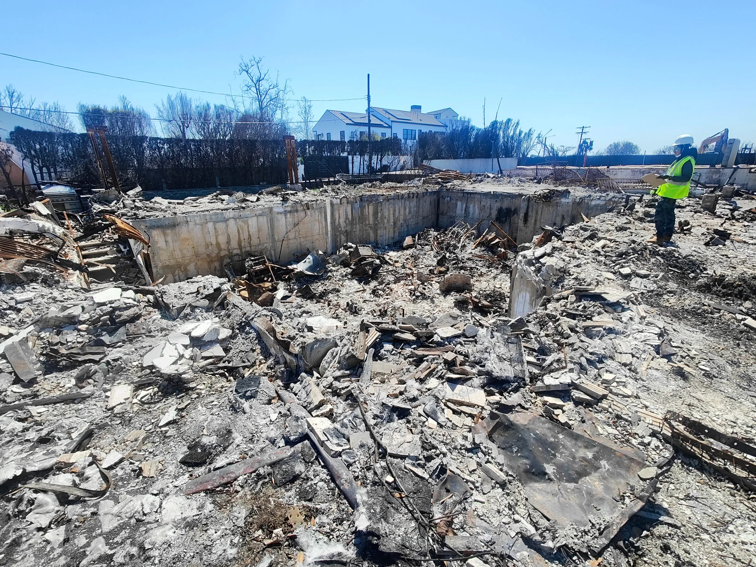

If your fire burns for more than 1-2 hours you've lost the house or building. Soda ash glass windows fail quickly in wildfire heat. Lots of other things will go before you lose that foam.

For those that have been unable to sleep at night wondering what the expanding foam was for I sluethed it out.
Finished installing the Barnes4wd tank skid. Which also included such surprises as a new fuel pump, housing, radiator, t stat, fan clutch... all a chapter of "while its apart i might as well" The skid is CHOICE. Good business, good product. I might go for their link kit over metalcloak arms in the future. I need to learn to weld and just might take a night class to do so first.
Back to the foam. The carriage bolts that the skid mounts run a little loose in their seat. I knew the PO changed the pump and housing because it wasn't Mopar. Adding the foam stopped the carriage bolts from unseating upon reinstall. One popped free from the forward most mounts and getting it back in place about gave me arthritis. That was all the A-HA! I needed to conclude my belief.
So, rest easy all. Mystery solved.
