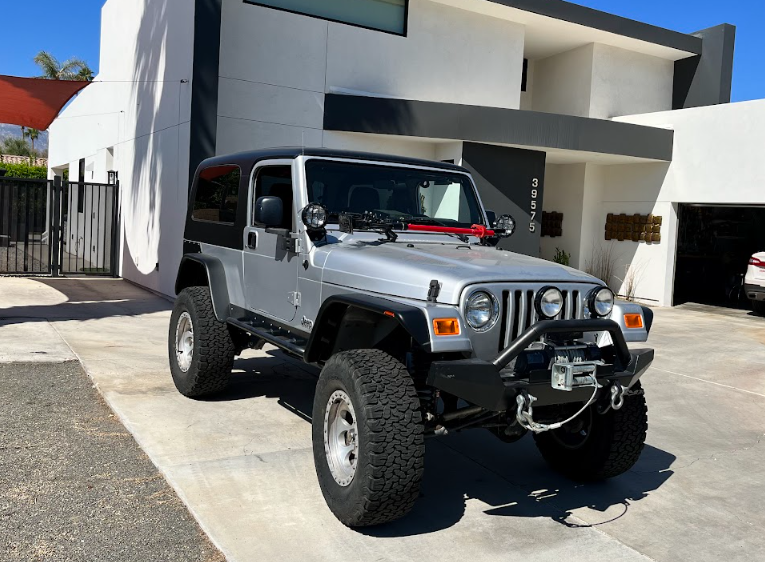

Here it is as I bought it. Horrible DW and a lot of 50% correct work done on it by his local 'Jeep Guy', but I was ready for a new vehicle project.
It had 89k on the ODO, Dana 44's w/ 4.88 gearing from a Rubicon with the lockers as well. Blown out rough stuff shocks, unknown springs and spacers for 6" of lift, 35's on 17" MT rims and an interior full of dog hair.

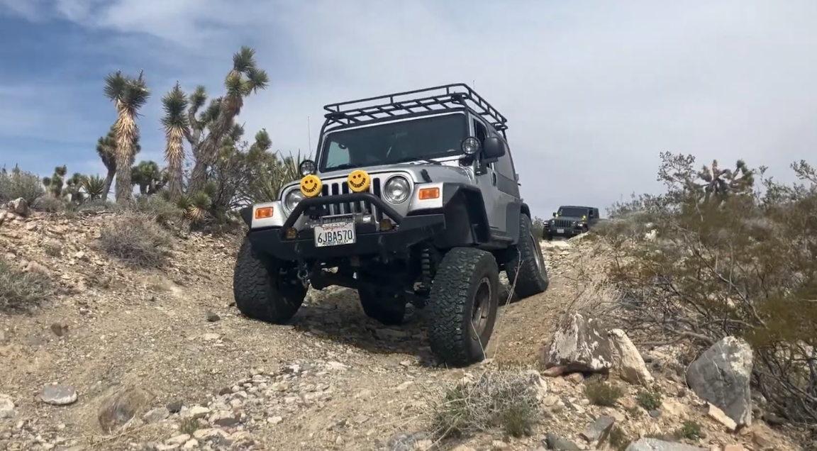

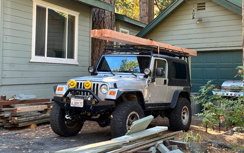

I use it as a daily, haul a small trailer for yard waste as I live in the woods, use the roof rack in place of my pickup I sold to buy it, and for exploring the deserts of Southern California.
I have run Gold Mountain so far in it, but that's about the most 'technical' crawling I've done. Trying to find some balance of not breaking it all the time as I need to get to work and afford gas and a mortgage.
Some shots of my use in the last 2 years of ownership;

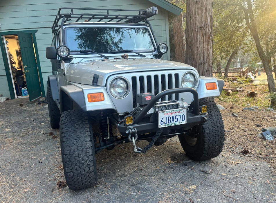

Currently as it sits

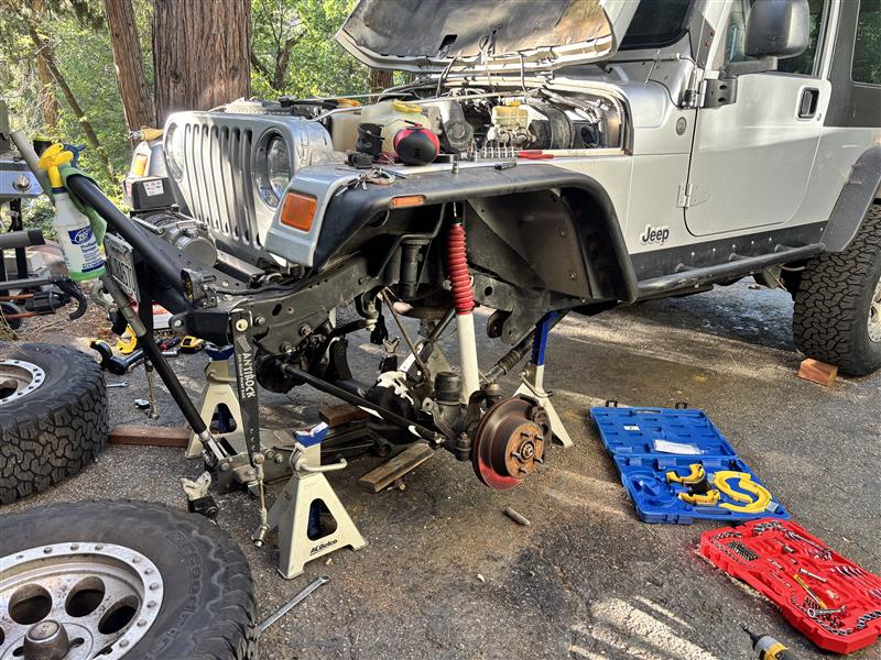

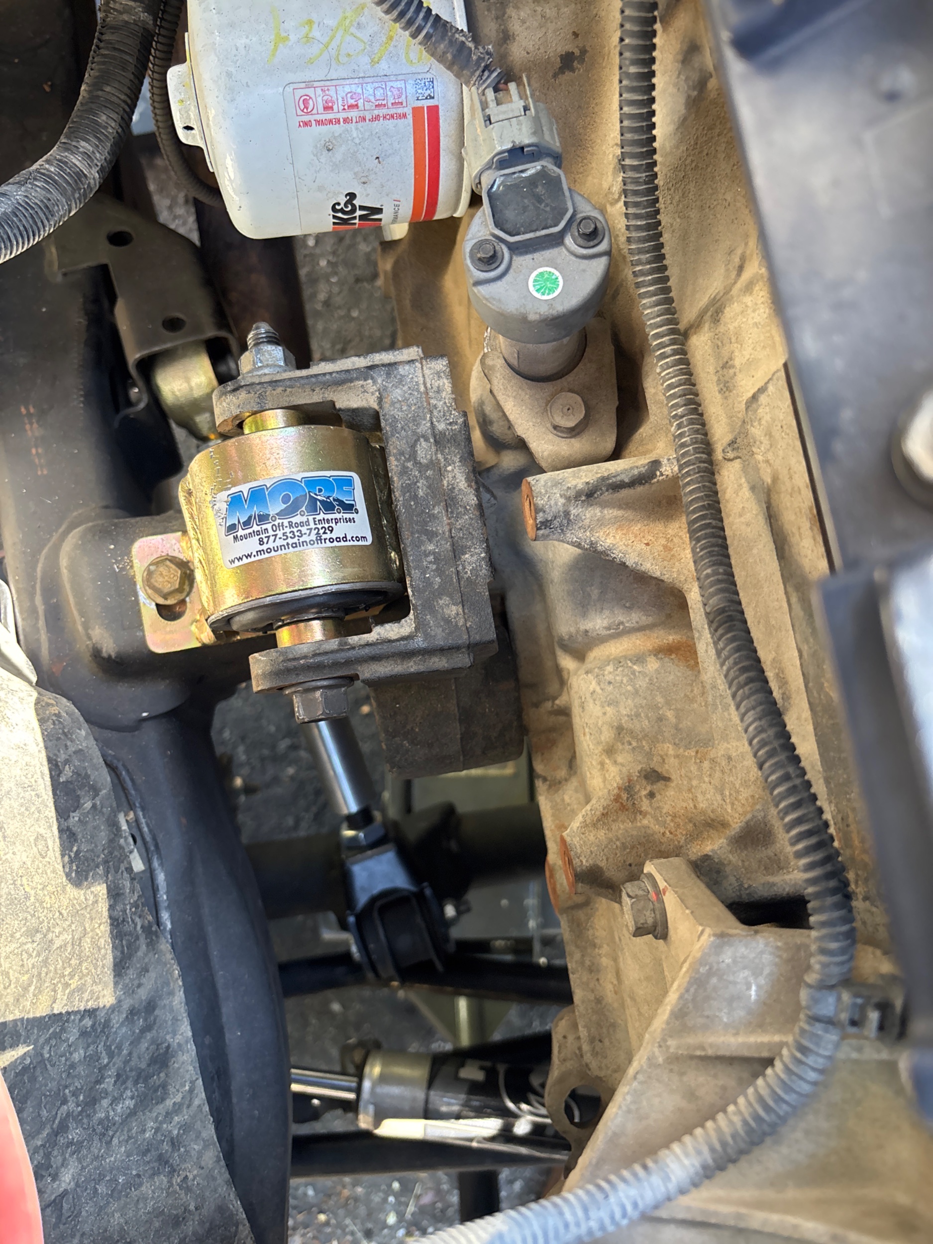

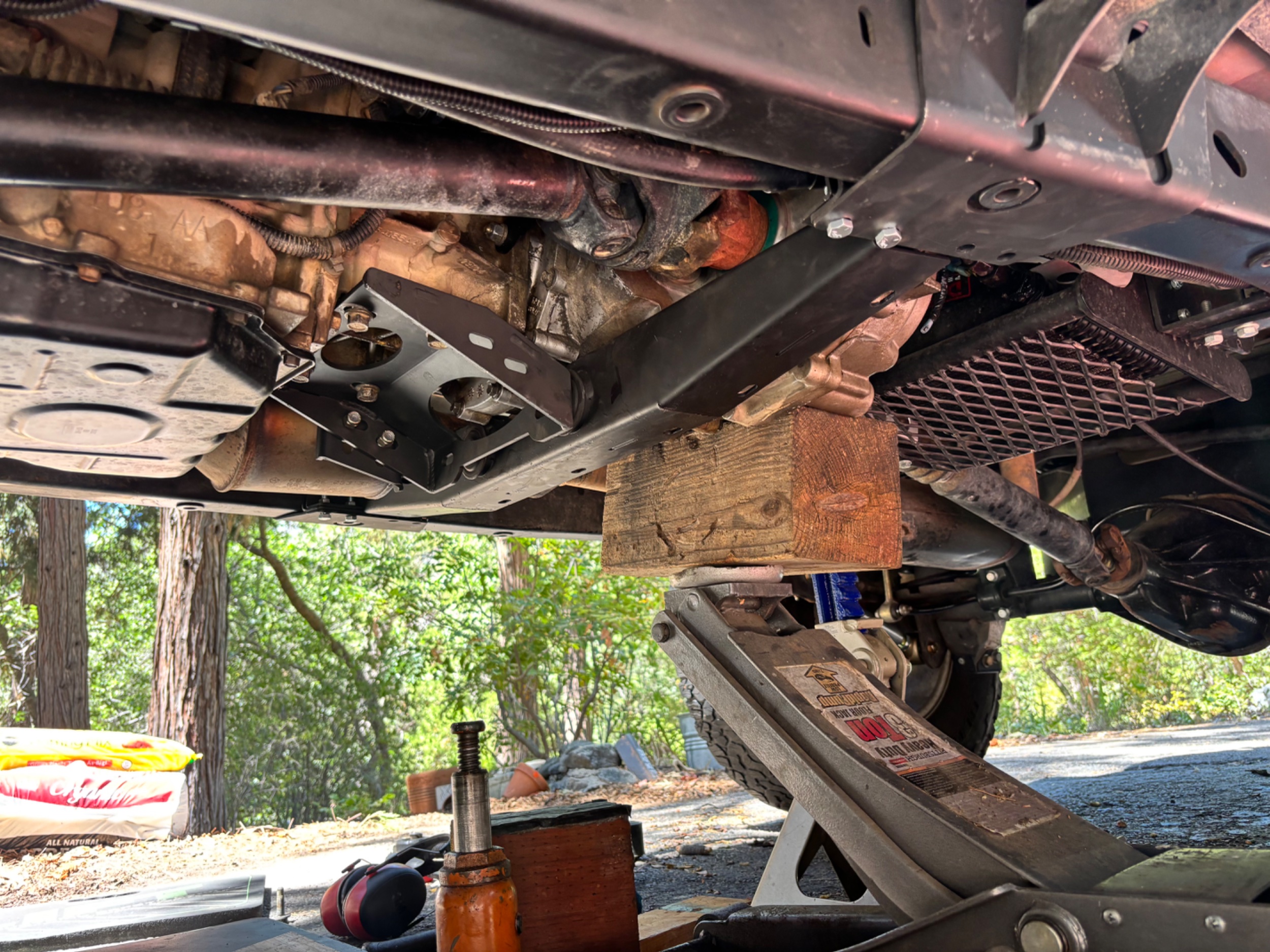

Still working my way through the install,
So far have all the new short arms in, t case cable shifter in, and I’m working on the skid plate. Need to get the arms and shifter adjusted still, and get a new driveshaft ordered after all this fun.
