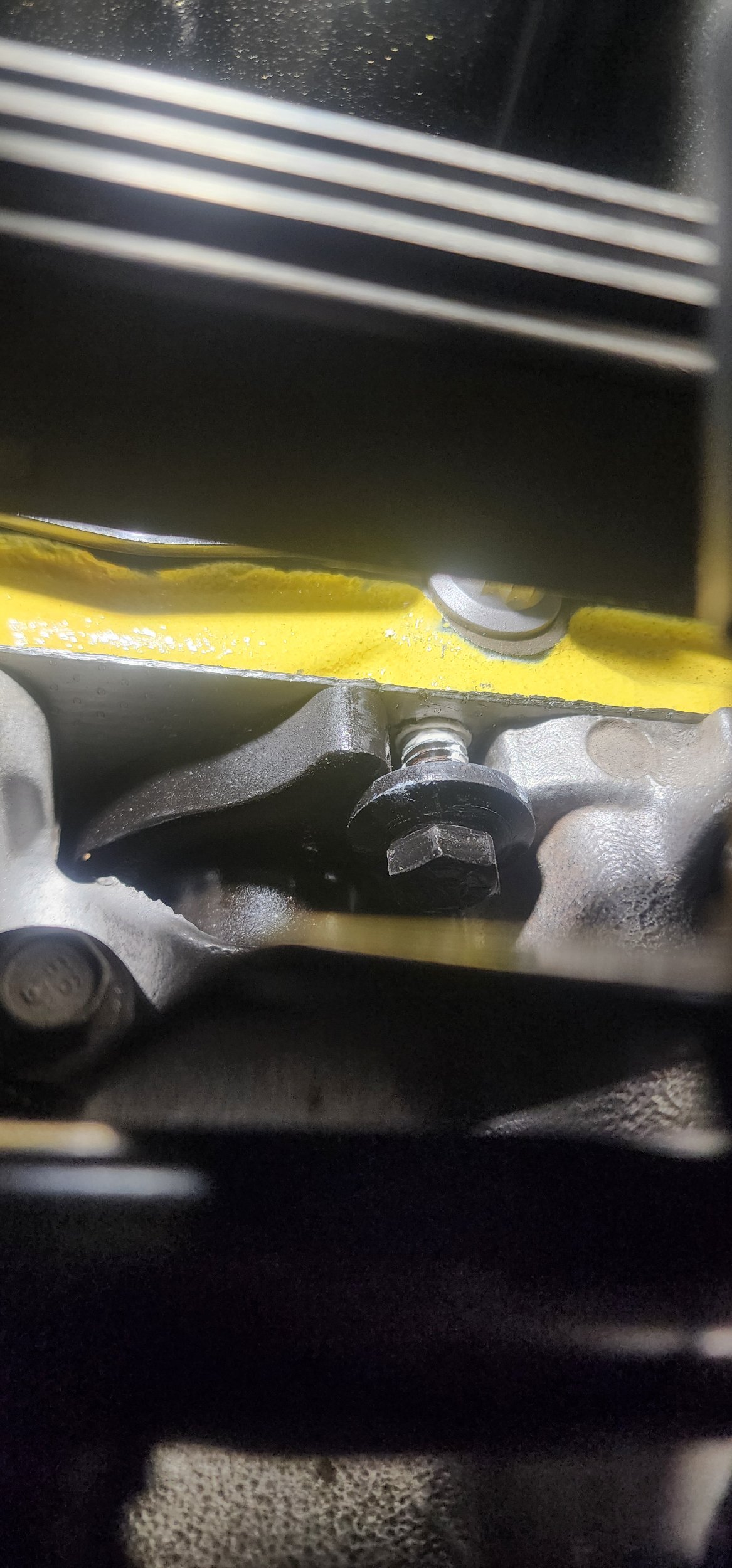

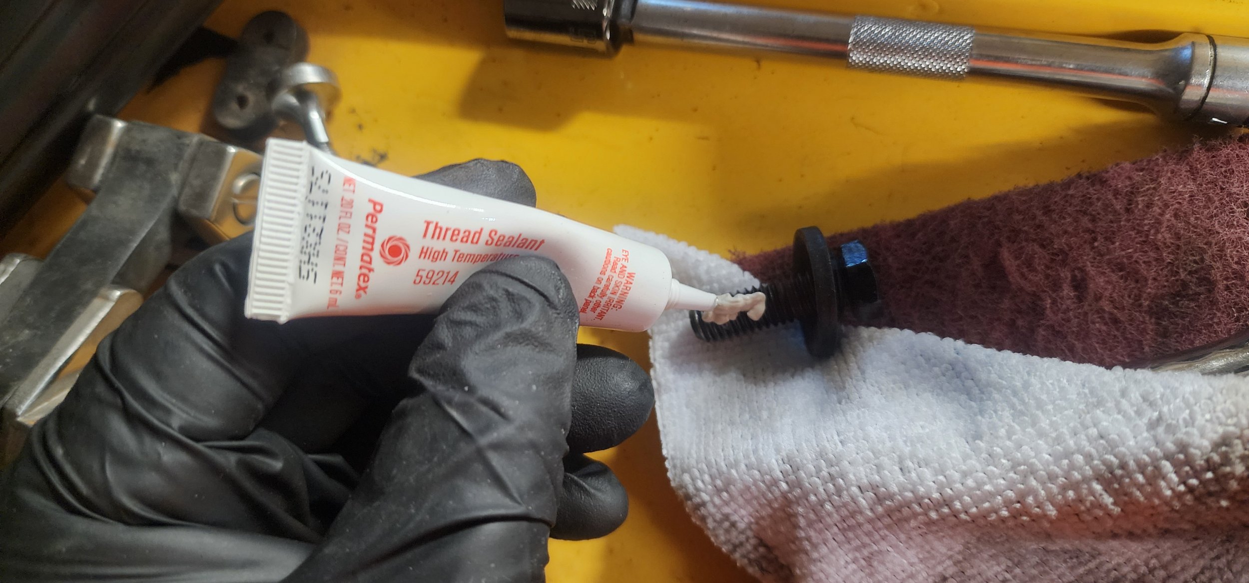

Hi all, I have this wierd issue I haven't run across. Just finished rebuilding my 4.0 with 0630 head, bored 20 over and Installed stage one cam. When inspecting block and head for cracks after back from.machine shop I didn't notice the bolt holes for the exhaust/ intake run through on any. It appears I have a very slight coolant hiss coming from the 3 intake runner bolt next to a head studs. Did i need to apply sealer to the bolt also? Let me know you thoughts.
