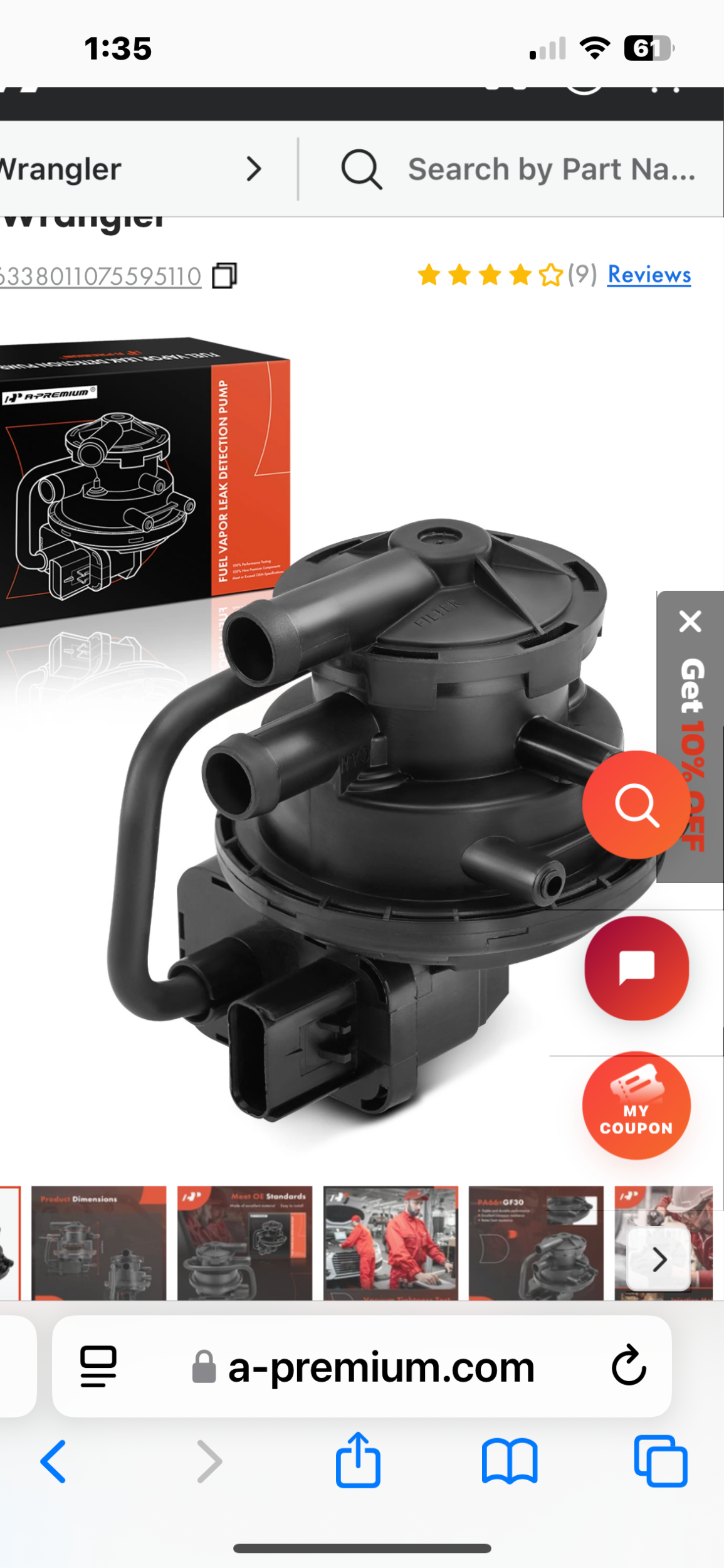

Were is the evap leak detection pump located on an 04 tj
That part is located under the hood on the drivers side. I did a smoke test when I had the same issue and I just had to replace a clip because even tho it snaps into place there was just a bit too much play in the worn clip.
