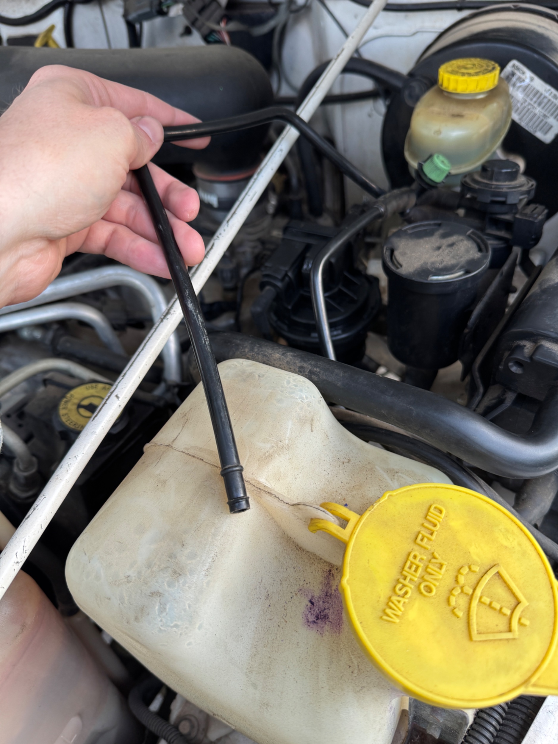

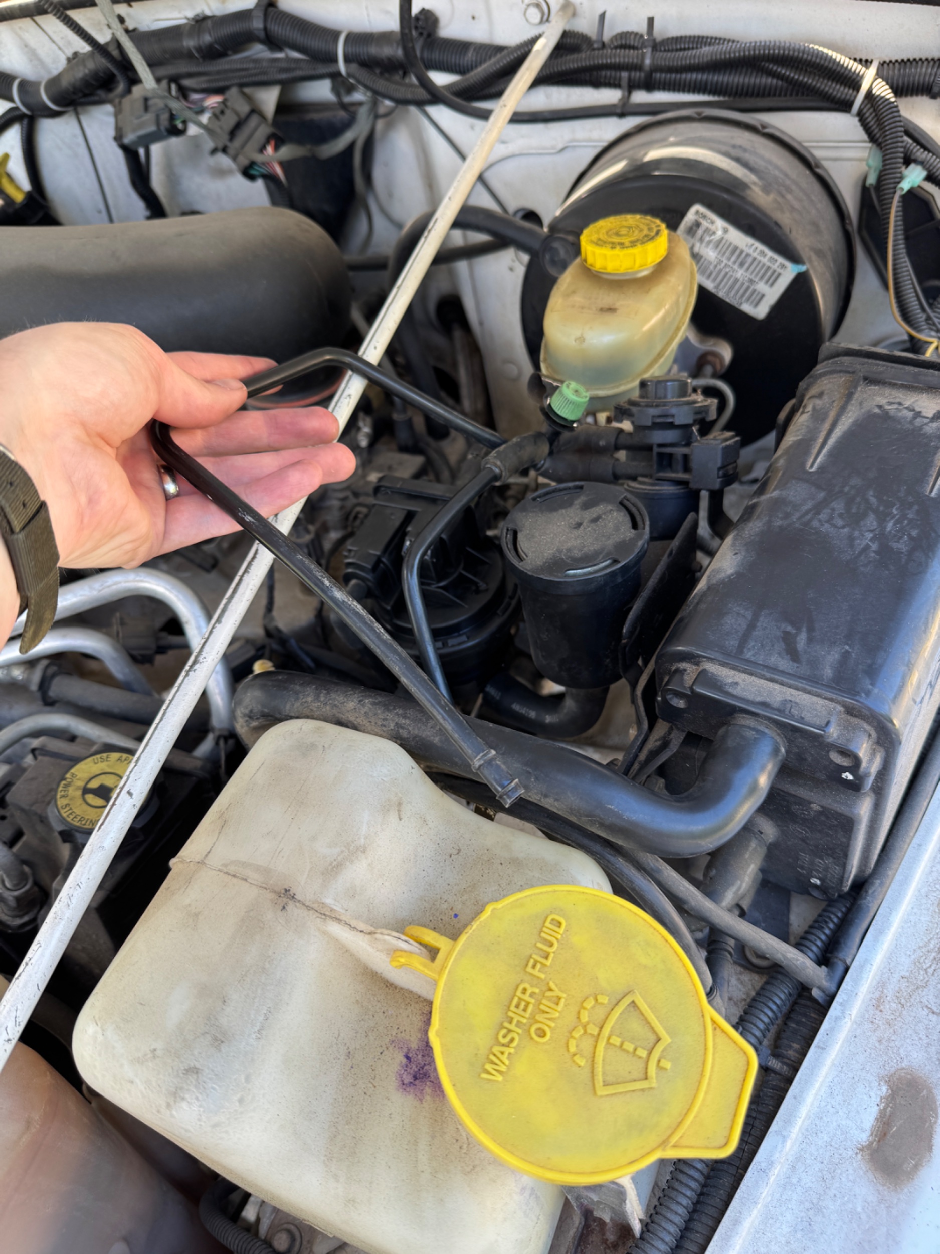

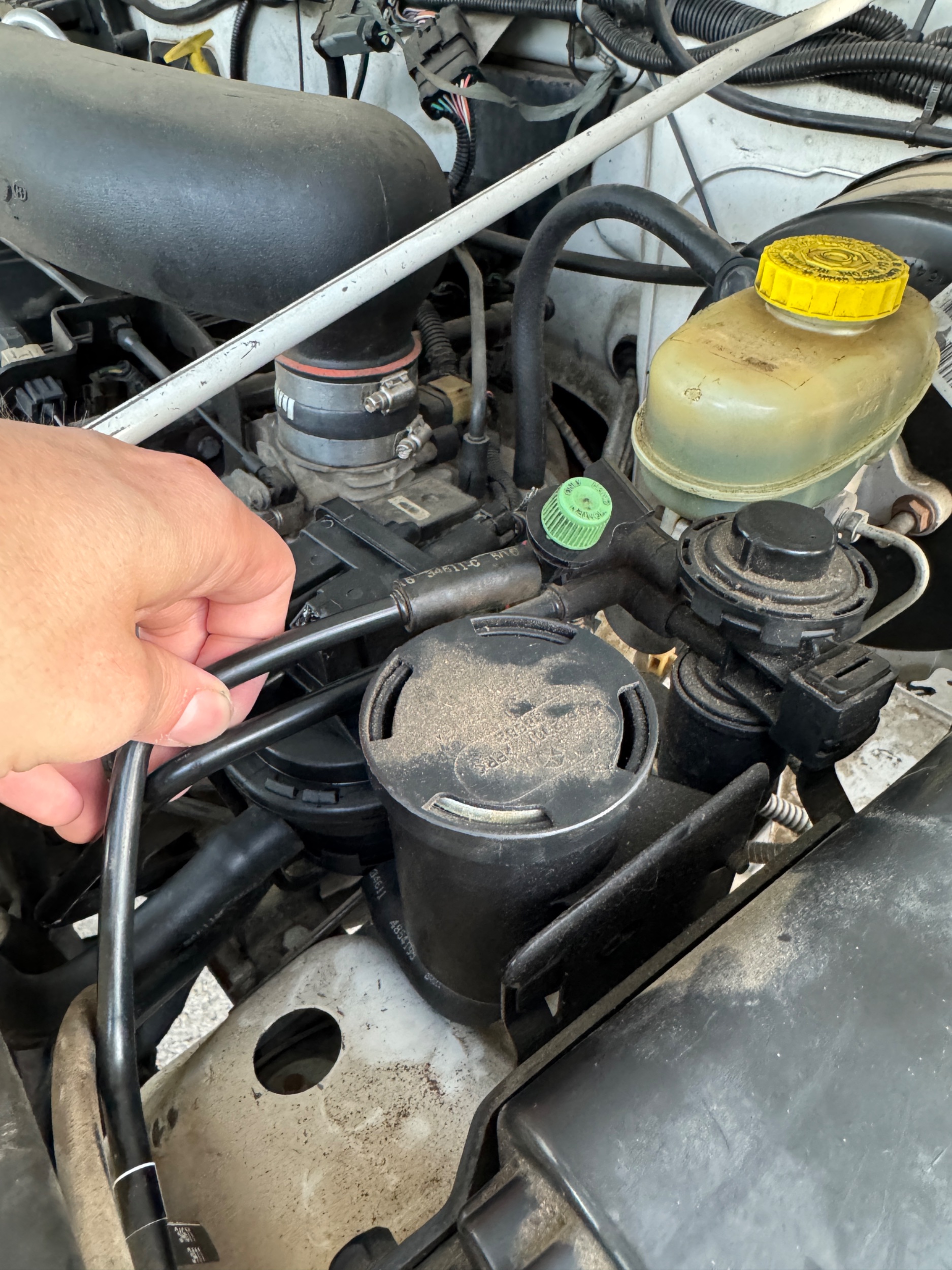

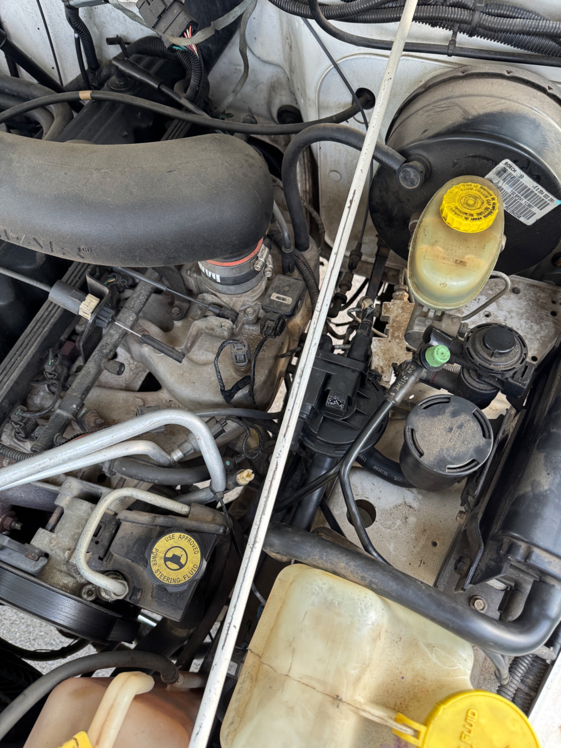

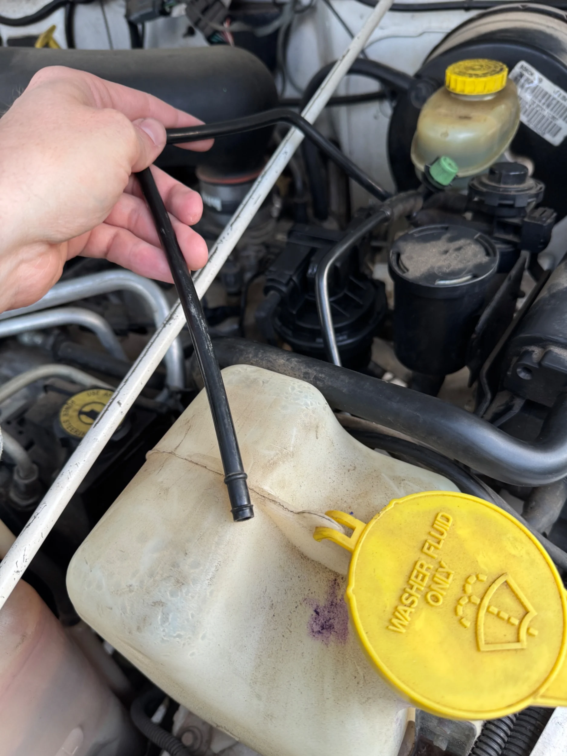

morning folks - I was able to get some pictures.
CJ with a TJ asked the right question, it is bent : but there is no obvious receiver or connection point for the end.
The first picture: It comes from the second hose off the canister.
The second picture - it naturally splits, with both ends going near the charcoal bit, just under the green part.
The third picture - you can see the natural curve to it.
The fourth picture - overhead shot, with me confused as to where it goes.
any help is appreciated.

Thanks everyone! I was able to get it. There was a black rubber receiver off the silver intake manifold at an angle.
I still have to trip the Check Engine light, but I at least have completed my attempt at a fix.
