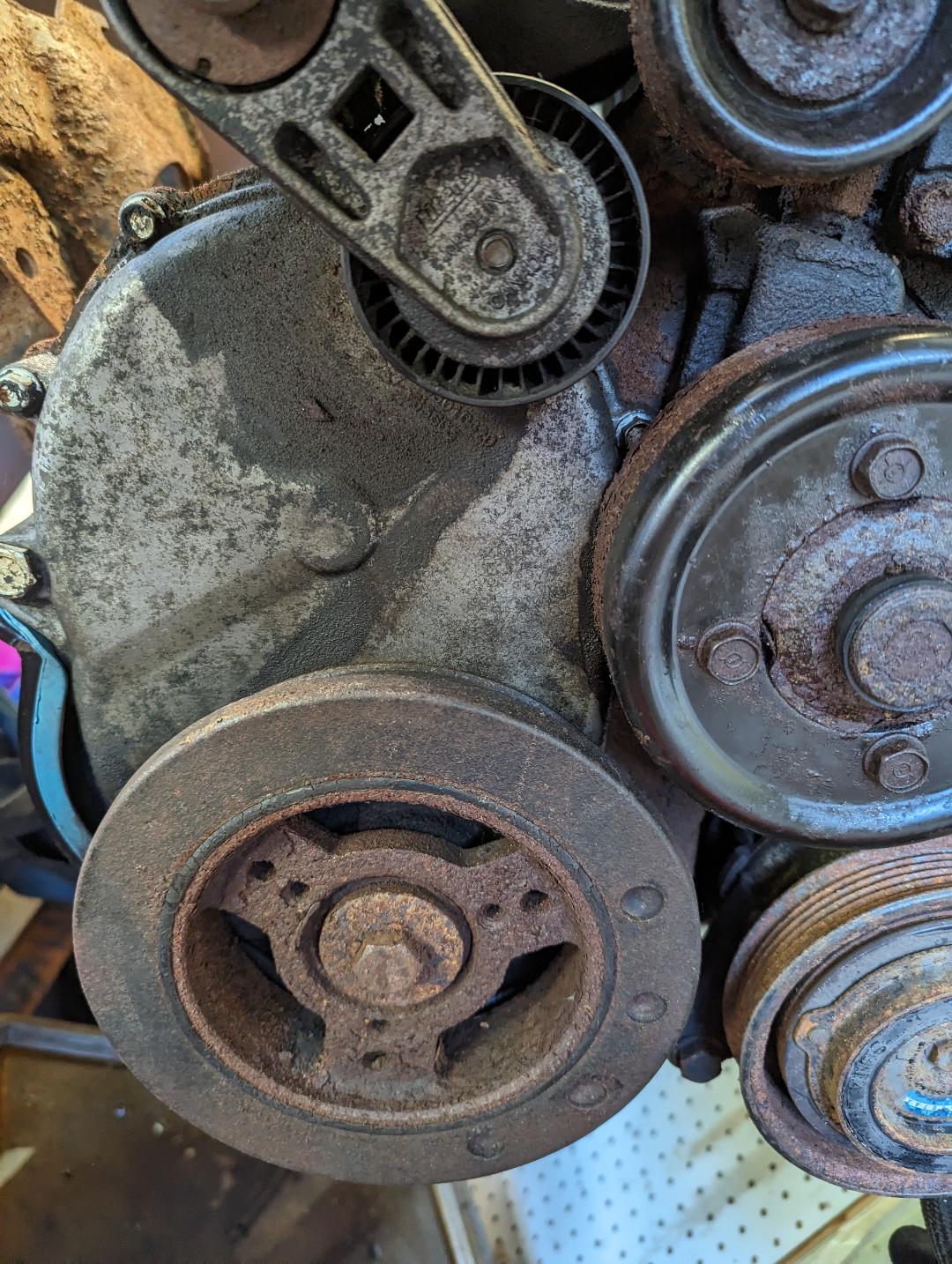

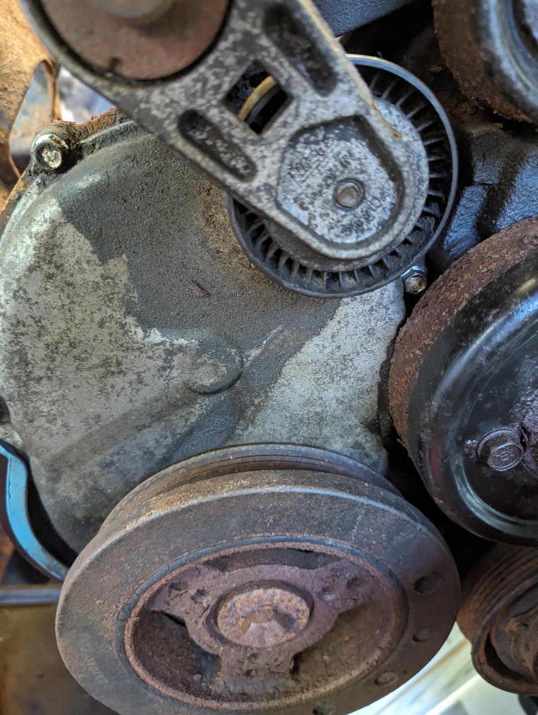

LOL, I don't know if you can pull the cover w/o pulling the water pump. I've got a '02 4.0 sitting on an engine stand in my shop so I can go have a look. I'm a bit hung over so that's kind of a long walk for me today, but I'll try to get out there soon :)
I would really appreciate that, will make the difference between buttoning it up today or attempting the timing cover. Might take a thin wall 10mm socket between the 2 but more likely just shy of possible...
OK< I just walked out. I'll post a pic in a minute, but yes, you should have no problem pulling the timing cover w/o pulling the water pump. You will have to pull the pulley off of the water pump from what I can see tho. It looks like removing the tensioner assembly would make things easier as well, but not required.
Let me know if you need a different angle or need to see something else.
Edit: Damn those came out small! Let me know if you can blow em' up good enough or I can do something else...
Damn I really appreciate that. Looks like a possibility... I think that fan pulley might be hiding one last bolt but it looks possible if you pulled the fan pulley.
Always glad to help....
Yeah, that's the issue, the fan pulley is hiding a bolt. You could get to it with a box end wrench, but i don't know if you could finagle the pump with impeller out from behind that pulley. Maybe, but for 4 bolts to remove the pulley, I'd just pull it.
Let us know what you decide, and what you find.
EDIT: Oh and if you mean there's another bolt that I didn't take a pic of? No, its the one on the edge of the pulley. I couldn't really take a pic behind that pulley, but I shined the flashlight back there, I didn't see a timing cover bolt hiding back there. You could always google a pic of a timing cover and compare it the pic I sent to see if there's a bolt there, but I didn't see one.

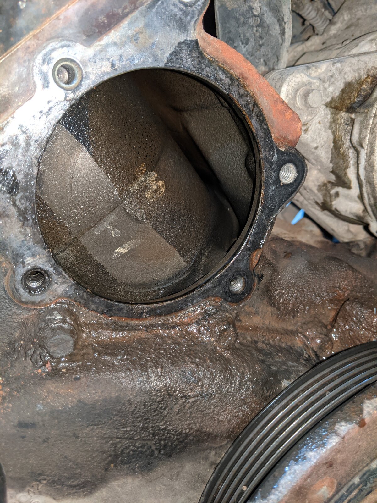

I have this photo from my water pump change out, looks like there's two bolts right next to the water pump, I think you could get a socket on them with the pulley out of the way.
Yesssss very helpful. Now, here's the kicker... If the brand new timing chain isn't making any noise do I bother...?
Wow, super clean block, did you just fill with antifreeze and roll with it or embark on a month long journey of cleaners, distilled water, and sadness like me? Just kidding of course, I already know you are equally frustrated.
