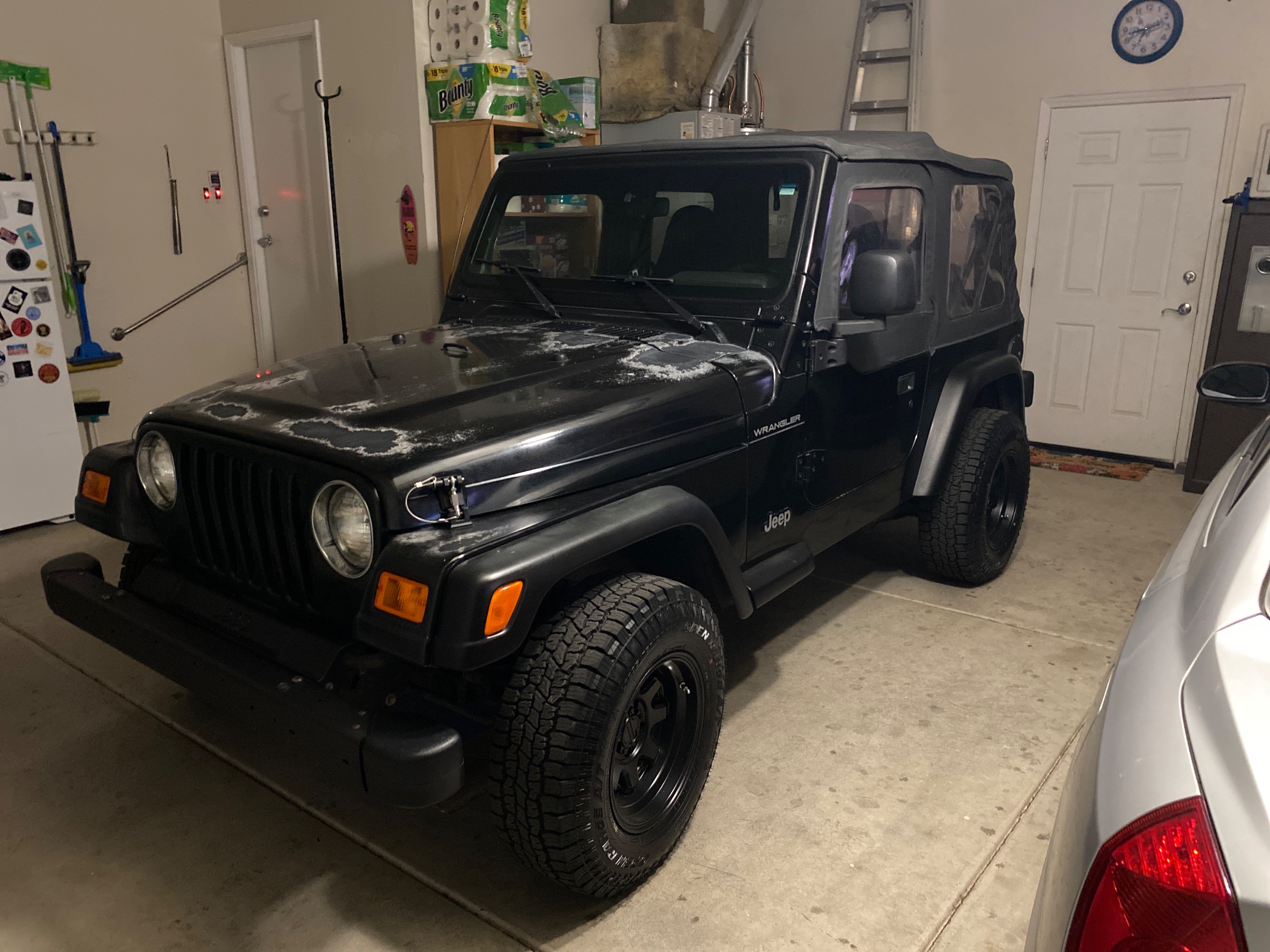

Hi everyone- My 1997 TJ went i to thw shop with a low idle speed when engone warmed up. Jeep guy at the shopsaid ECU’s on this model are notorius for ECU reset issues if batteries are changed/disconnected (said they usually reset withon 50 miles). Evidently mine didn’t, so he reset it and she runs prisitine now. He mentioned there is a process you can do at home……anyone have a link to that process? Cant find it on my own, any help greatly appreciated!
