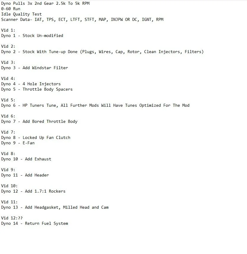

Start simple, oversized throttle body, cold air from the cowl, lockout hubs?
So far here is my schedule list. I'm hoping to release a new video each week with my schedule and weather permitting.
