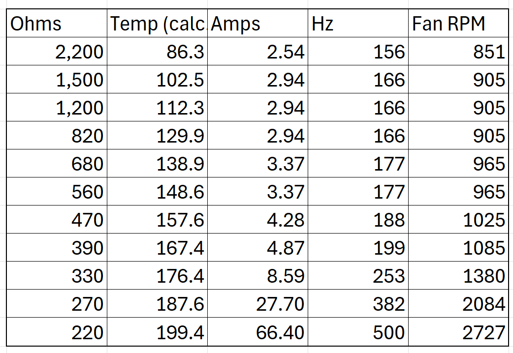

Man, you must have some powerful headlights - my SPAL draws something like 40 amps at full blast…
he did say medium power...fan power increases with the cube of speed, and airflow increases linearly with speed. So your 40A fan would only pull 5A at 50% airflow.
@freedom_in_4low got it correct.
The fan affinity laws state that if you double shaft RPM, you get double the flow, 4X the static pressure, and 8X the power consumption (and also 8X the air watts as well).
In my other thread, I actually did a test that shows this:
For this, simply compare the fan RPM to the amperage draw. Note that 1,380 RPM is about half the 2,727 RPM peak in this test, but the corresponding amperage for full speed is 7.7X (approximately 8X) the half speed amperage.
Note these tests are done with the engine off, so actual engine-on running amperages at these speeds are about 86% of the amperages seen here. The fan automatically compensates for voltage to keep constant power. It also can’t quite reach top speed (2,850 RPM) with the engine off.
If we’re looking to approximate 50% fan speed here, we need a load of about 107 watts, or very close to a pair of 55-watt halogen headlights.
The more I think about it though, this electrical load is still so small it probably will be lost in the noise for dyno testing. We’re talking 1/7 horsepower at the alternator and maybe 2/7 horsepower at the engine.
Edit: Another way we can approximate this power draw instead of headlights is the HVAC fan at high speed, which draws around 7.5 amps with the engine on, or around 108 watts.

Wow. Incredible how the amp draw jumps from 1380 rpm to 2727 rpm.
When you need more airflow, it is way easier to increase fan diameter rather than spin a fan faster.
At a given shaft speed, air flow is proportional to the cube of fan diameter (but only linear with shaft speed). Meanwhile, static pressure increases with the square of fan diameter, meaning that a doubling of fan diameter results in 8X the flow at 32X the power given a constant shaft speed.
If we want to compare efficiency, if we assume power is constant, then airflow is proportional to the diameter to the 4/3 power. Meaning if we double fan diameter, we also get 2.52X the airflow at the same power at 31.5% shaft speed, largely because static pressure is only 39.6% of what it was.

That is completely new info for me, so I'm trying to wrap my mind around it. I think I just assumed a linear relationship, i.e. double the speed required double the power. As freedom stated, "fan power increases with the cube of speed", is that assuming a stationary fan only? How does that play with push vs pull fan? Would movement forward or reverse, like in a vehicle, change that power requirement accordingly? Thinking out loud here, as a vehicle moves forward air pressure increases in front of the radiator/fan, so the fan should require less power to move a given volume of air at speed X. I'm spiraling at 1/4 the power of my mind here. :LOL:
