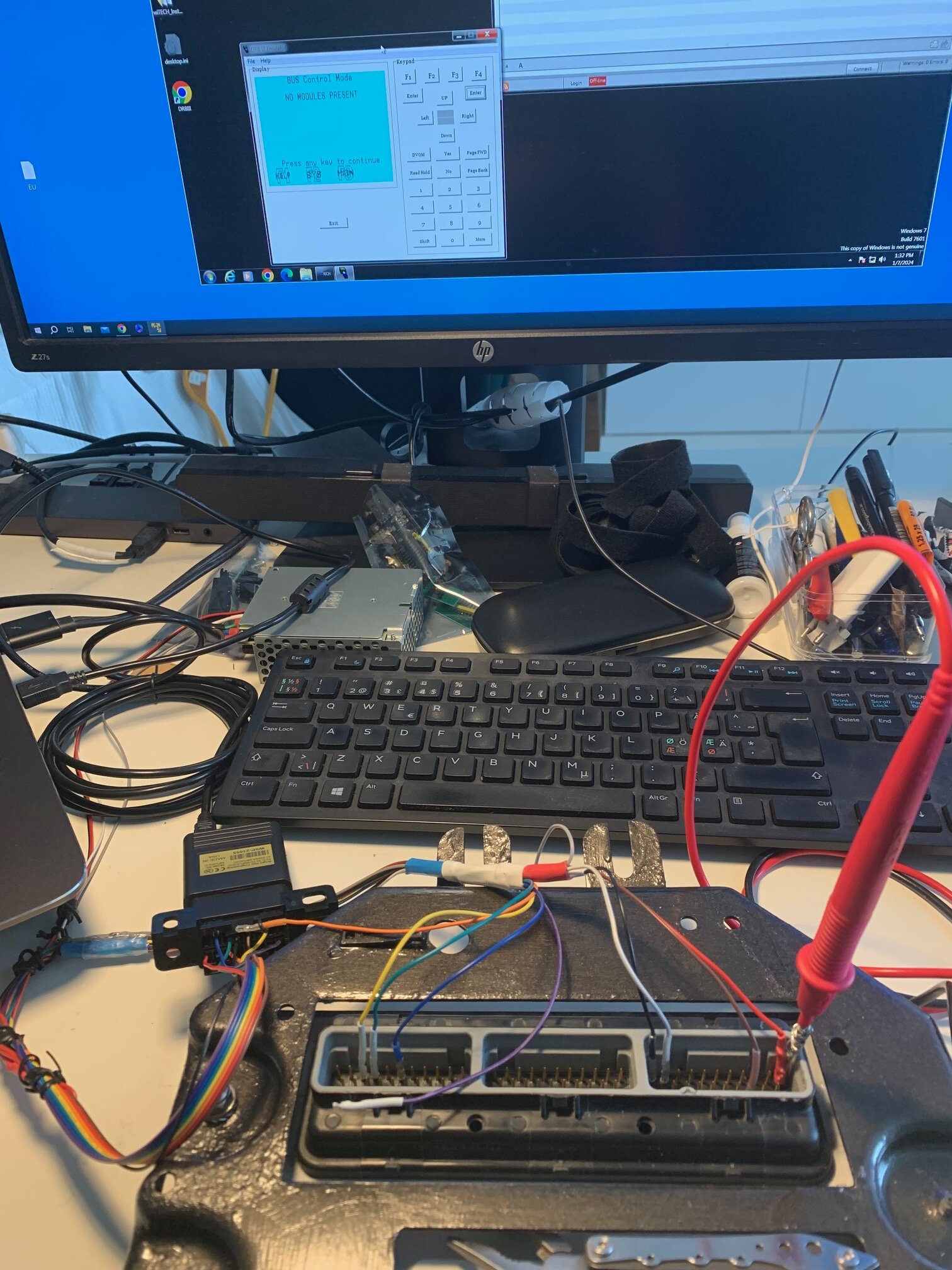

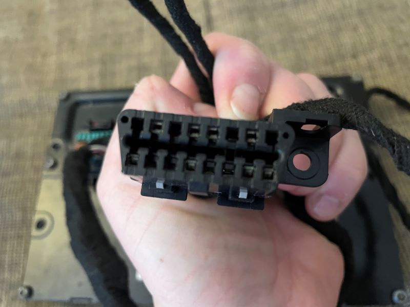

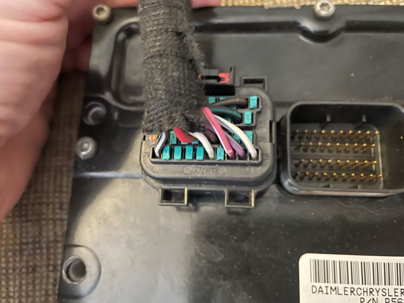

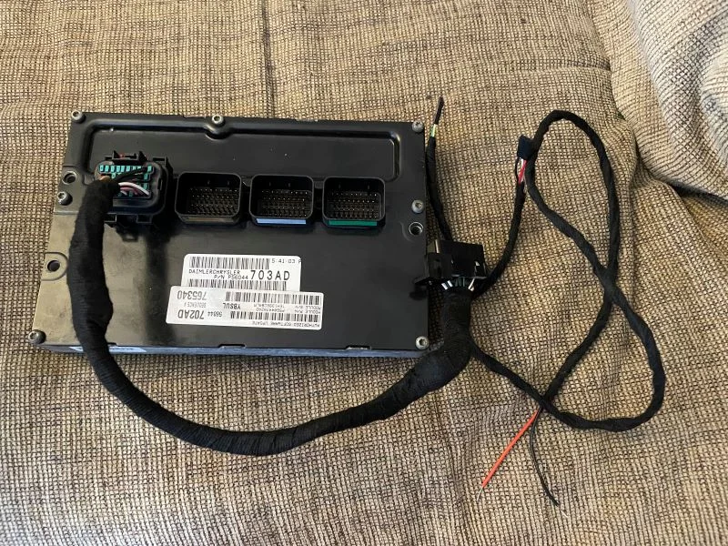

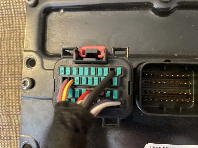

Hi, I got the DRB3 emulator running in a fashion-sorry to that it doesn’t find any modules. Alright, I have my PCM on my workbench and probably have missed some connection that is neccessary. Now this is from a 2000 Jeep WJ so I’m not familliar with the differences between TJ and WJ.
Someone hopefully is and can explain what I have missed. My diy harness is as follow.
DLC pin 2 (PCI) goes to C3 pin 30
DLC pins 4,5 (ground) goes to C1 pins 4,31,32
DLC pins 6,14 (SCI receive) goes to C3 pin 29
DLC pin 7 (SCI transmit) goes to C3 pin 27
DLC pin.9 (BMC flash enable) NC
DLC pin 16 (Fused B+) goes to C1 pin 22
So, what else is needed? I reckon that connectin B+ is the same as power on (ignition on?) - or maybe I missunderstod that. Well, I might have understod wrongly how to interpret the connector pin drawings and have connected it all backwards! So please feel free to correct me…

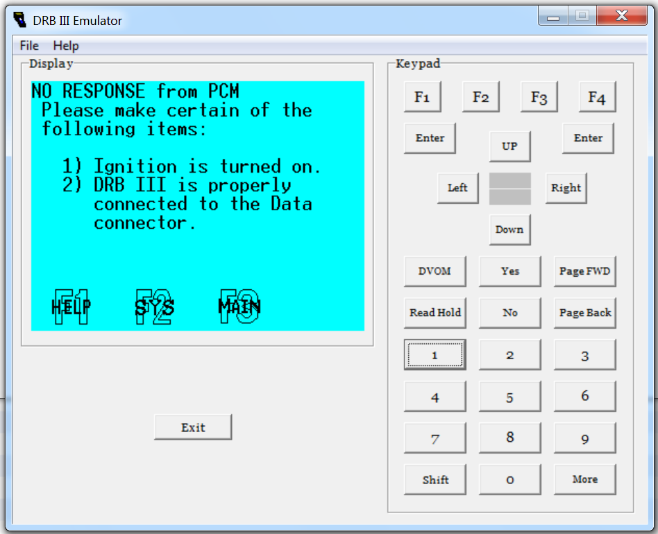

I keep getting this:
Maybe my donator PCM is either dead or my connections are totally out of scheme... How can I tell that ignition is on tinkering with it on my workbench? Do I need to put +5v on some pin to awaking it?
Post a diagram of all of your connections. I wired up an OBDII connector to a PCM on my workbench and got it to work - just required the data bus connections (there are more than one) and 12V power. Andy
Right andya - I have described my connections in both text and hires picture - your turn to show your working setup.
Regards / Turbon
I looked but I can't find my wiring diagram, all I have is the wiring harness I made. I only used connector C1 and I took the connections from the factory manual wiring diagrams. For communicating with the PCM all that is needed is the PCI bus. My PCM is a known working PCM. Andy

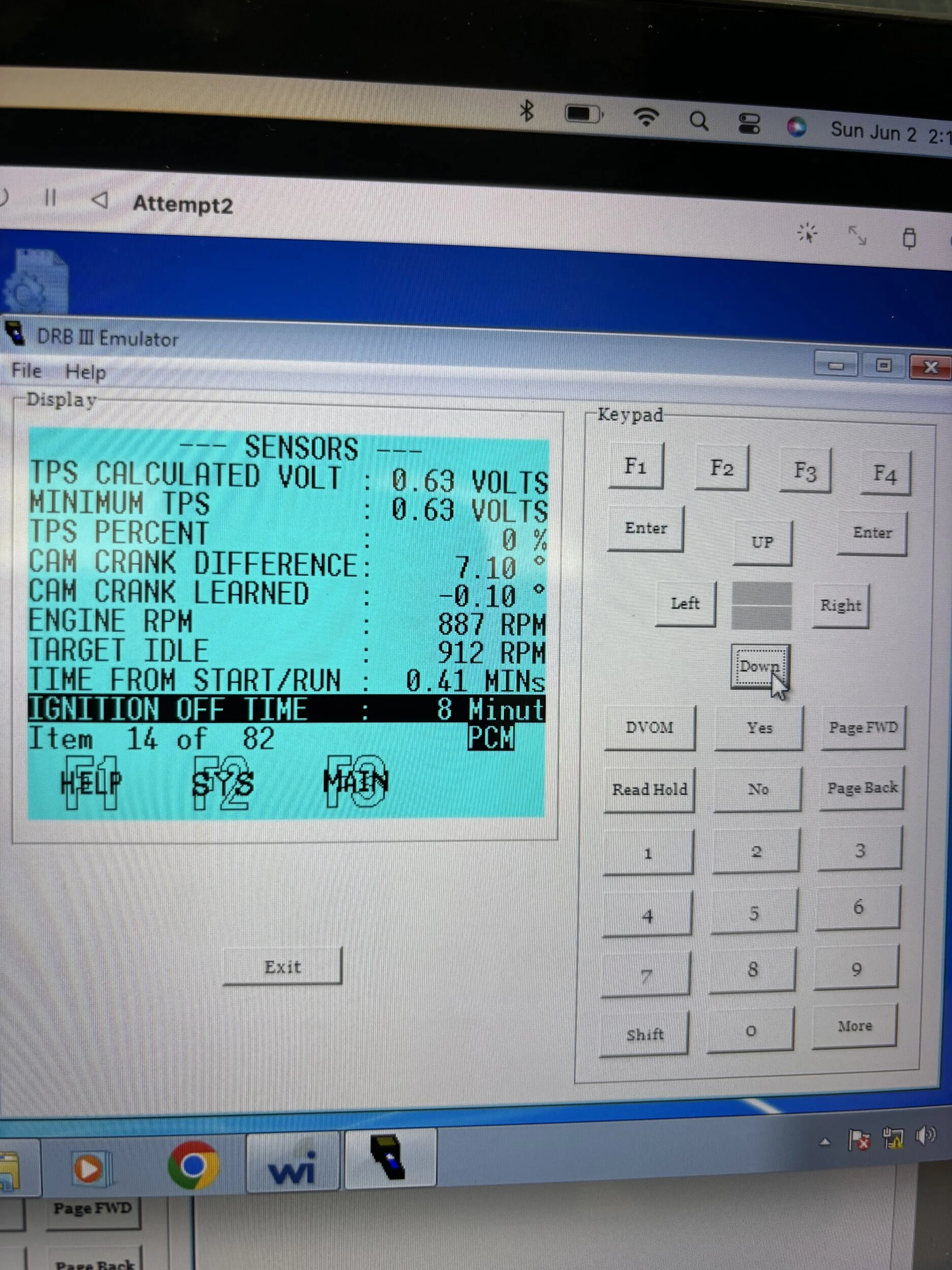

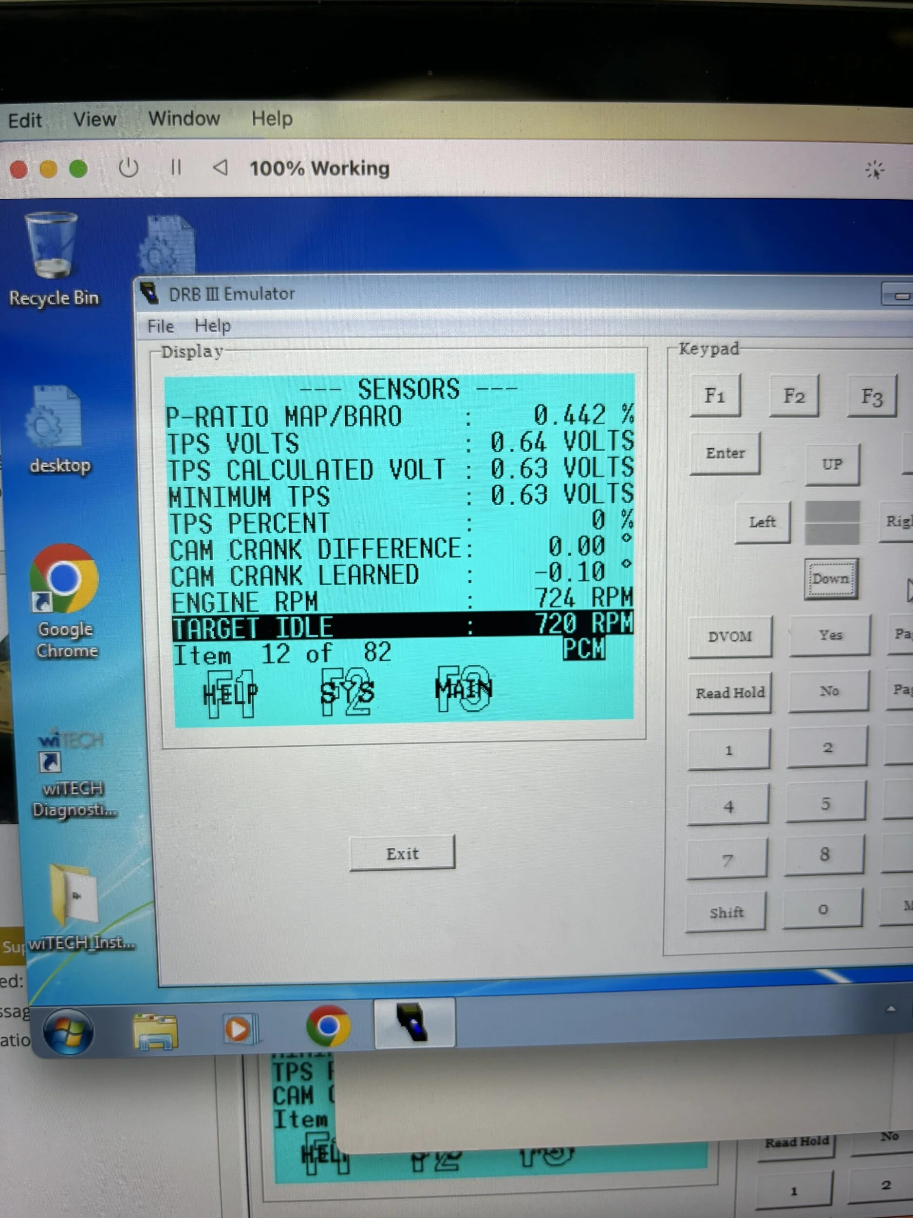

AndyA, thank you very much for this writeup. This helped me solve the cam/crank misalignment issue I have been experiencing on my 06 TJ.
I used the UTM software on my intel-based MacBook Pro, this was because VMWare seemed to be having some issues and it was a tad simpler to use. Downloaded the same windows 7 iso. Everything worked great, except my VM would crash occasionally due to my Mac overheating in the Florida heat.
I was able to monitor the sensor readings and twist my OPDA until the alignment was dead on 0.0 degrees. I loosened the bolt that seats the OPDA into the engine while it was running - only enough for it to rotate. The adjustment is very minimal. For a fine adjustment, I tightened the bolt and then lightly tapped the CAM sensor housing for the final +/- 0.1 degrees of adjustment, then secured the bolt the rest of the way. Jeep starts up immediately now, before it would take a few seconds of cranking.
I have not tried to connect the chip you mention to a ground, it seems that I may have to in order to see the other readings from the transmission etc.
Attached before/after pictures where you can see the change in the CAM/CRANK DIFFERENCE reading.
Reactions: AndyA
