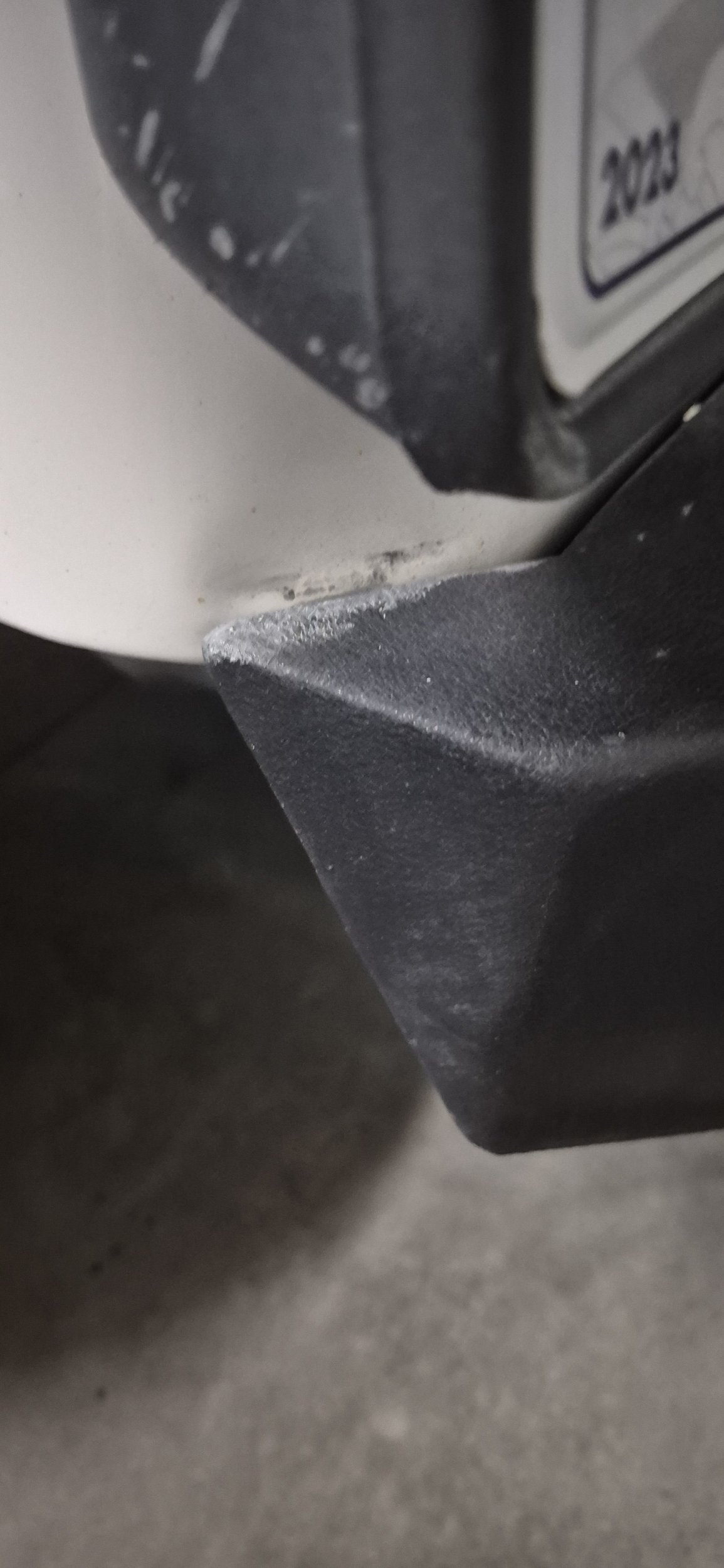

I got this at Moab. I thought the bumper would protect the corners but it flexed into the tub and backed out to the normal positiin. No rust after 3 years. That's wax on the bumper.
I got a dent in the gas tank skid later. I dragged the bumper off an overhang at a different place a year later.
I'll probably find a different bumper and look at different tank options to gain some rear height and clearance in the future.

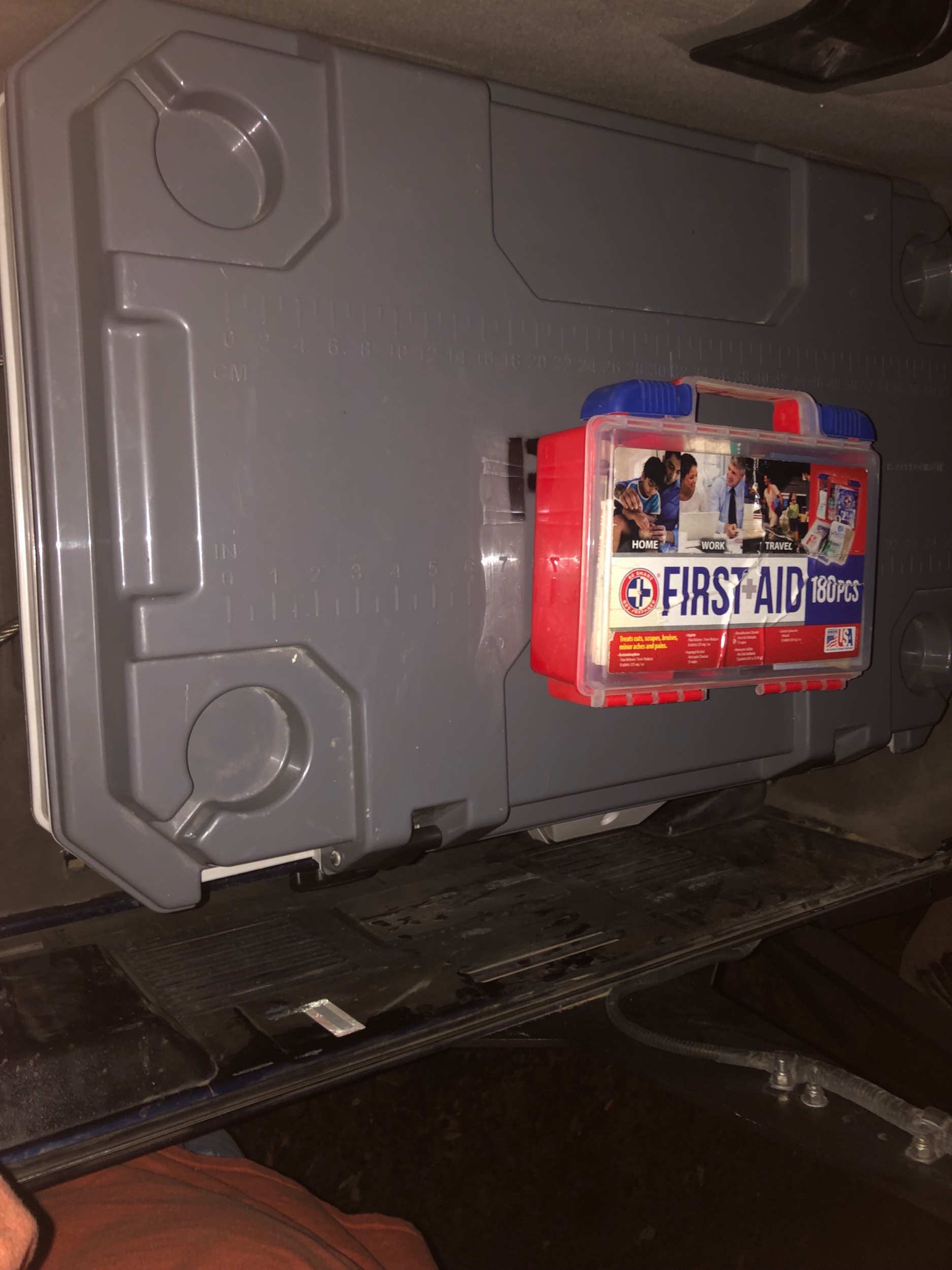

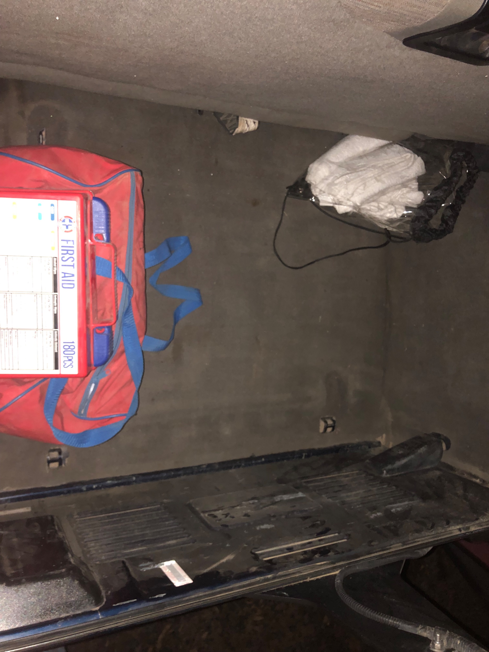

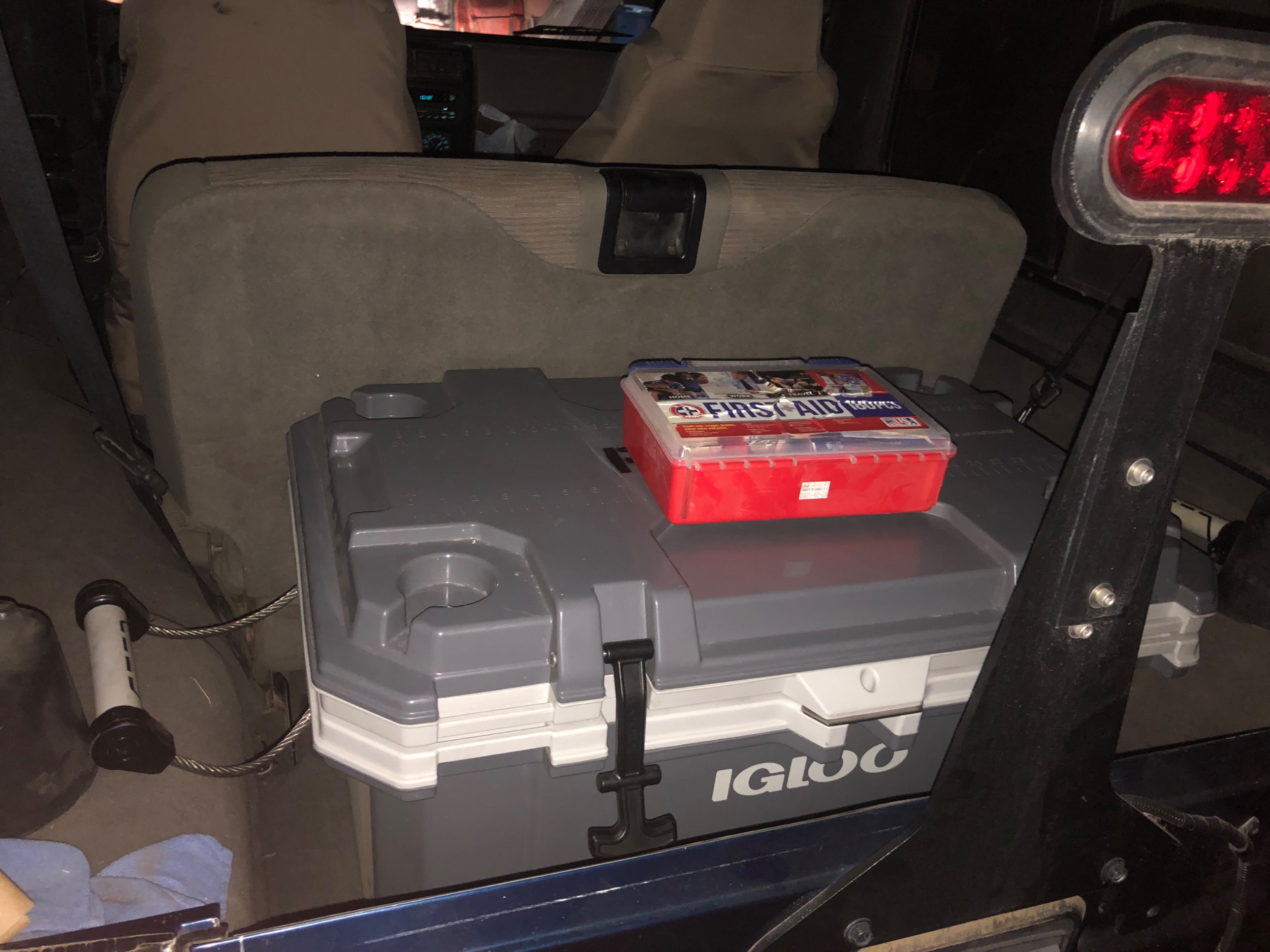

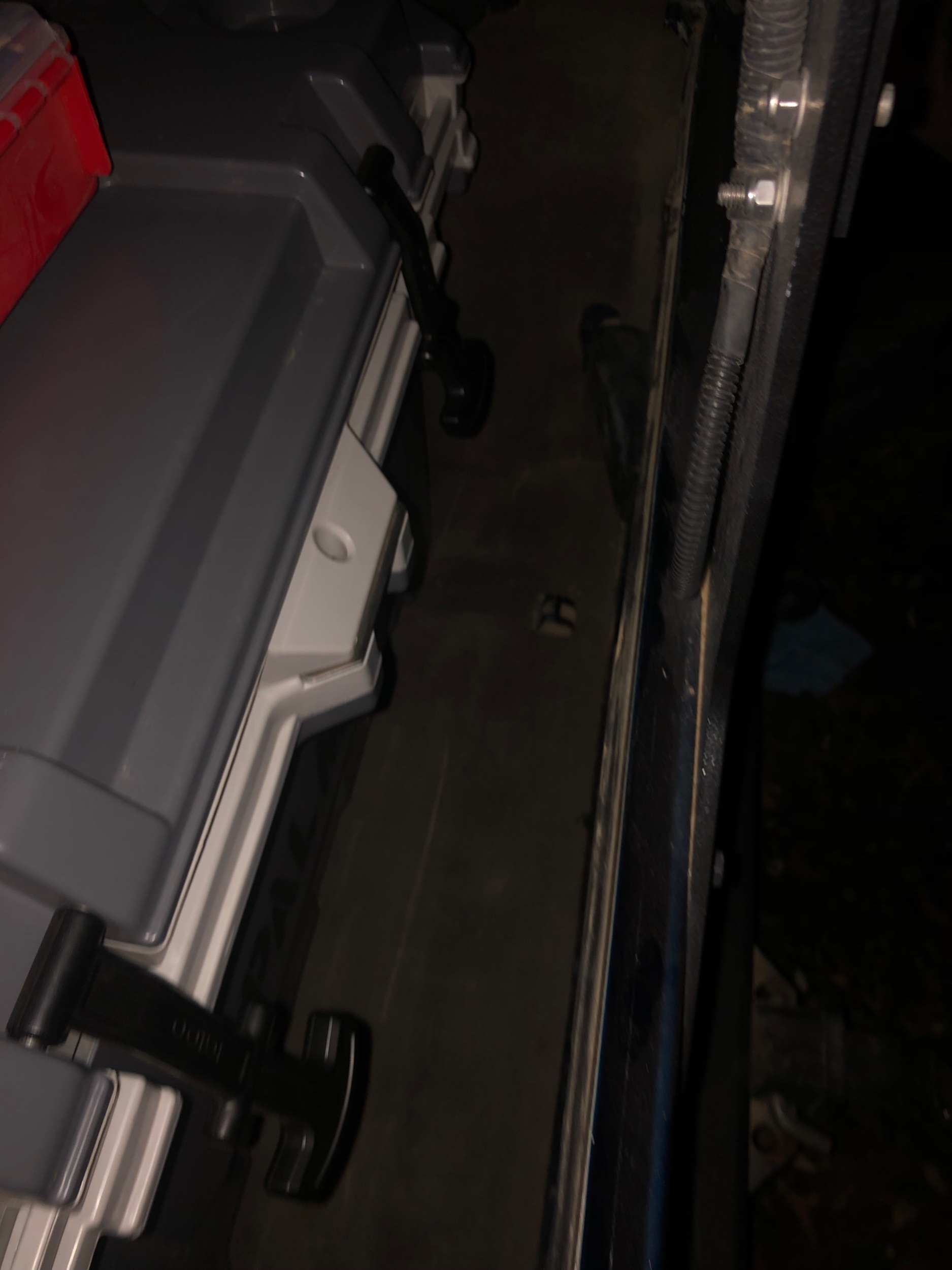

24” top of tailgate to back of seat. You lose some in the right corner with the door strap.
The cooler is 32”x22”x18” and has 3.5” to spare.

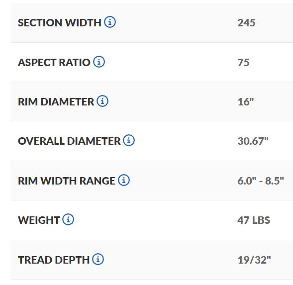

245/75/16
So call them 31" 29.67".
To get greater accuracy with GrimmJeeper you need to subtract 1" from the listed tire diameter or preferably measure from the center of the hub to the ground and double it to account for squish. Using the easiest method subtracting 1":

Better accuracy comes when they post up a given highway speed and RPM as accurately as possible. If they will do that, we can figure out the exact tire size.
