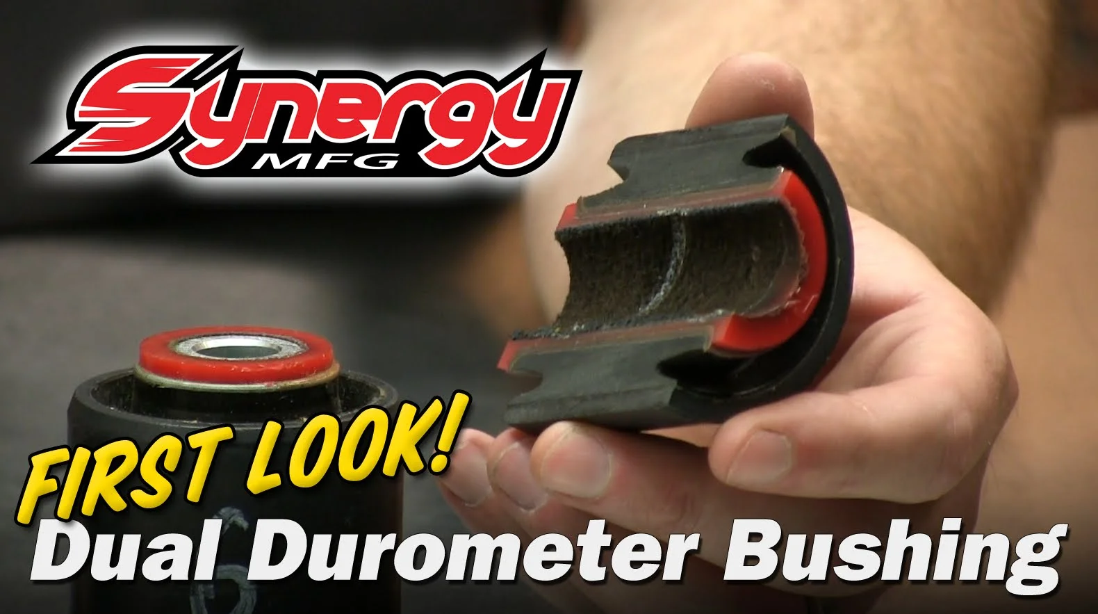

Are there any bushings or joints available for our Jeeps that have cut outs? Everything I've seen is effectively solid.
I would say the Synergy Dual Durometer Bushing (DDB) meets that description.
https://www.synergymfg.com/synergy-dual-durometer-bushing-ddb-series.html?category_id=4970
With the information gained from this thread, I also noticed that they call it a 'bushing' and not a flex joint. Hmm, differences in marketing or differences in product.
Also look at their trackbar.
https://www.synergymfg.com/synergy-...ustable-front-track-bar.html?category_id=4056
They use their own DDB bushing in the axle end to replace the OEM Clevite. On the frame end they use the same OEM setup. You don't even need to drill out the tapered hole as Currie and most others have you do. So you are sure to maintain that positive connection that the OEM tapered hole provides at the frame. (I really like this). This leads me to believe the DDB may be more similar to OEM Clevite in some of its alignment and NVH characteristics than other bushings or flex joints. However, I did note that the rear trackbar (apparently for Dana 35 only???) appears to have a flex joint on one end. I could be wrong, but in the picture it looks different than the DDB in the bushing on the other side.

The simple reason Synergy cannot use their DDB on the frame side of the front track bar is the very same reason Metalcloak cannot use their Duroflex bushing. Neither bushing can be held in a permanent state of misalignment. This is one fundamental difference between a bushing and the ball and socket type connection we call a flex joint.
On the Synergy rear track bar, the frame side looks like a traditional heim joint. As with Metalcloak, it would be interesting to know why Synergy is not using their bushing on both sides of the rear bar. OEM does. Currie uses a Johnny Joint on both ends of theirs.
What does it mean that Synergy is using their DDB on one side of their track bars, but MC is not doing the same on either theirs?
The Synergy DDB looks like a more complex competitor to the Duroflex bushing. I personally do not see what real world problem either is solving that isn't already done better than the Johnny Joint.

Sunny D and I were having a bit of a discussion concerning the synergy joint and Rancho's D2 joint. Lot of similarities between the two. The dual durometer bit seems kind of gimmicky to me. After watching both videos of the two joints I'm still trying to figure out how the inner sleeve can rotate once a clamping force is imposed.
The D2 is suspiciously similar to the DDB. They even have the same number of D's!

My understanding is that a bushing in this context is designed to stretch and deflect from misalignment, where a flex joint is a ball and socket type connection.
Yeah, I don't disagree that its a bushing. Its just interesting that Metal Cloak calls theirs a FlexJoint and Synergy calls it a bushing. They perform in a very similar manor. Maybe because the Metalcloak has a ball encased in that rubber somewhere. I just found it interesting that they used different terminology for something very similar. That was all.
I understand this. I was just pointing out that Synergy, like Currie, uses their own existing product where its appropriate. Unlike MetalCloak that created a new product for that axle location. Begging the question of why Metalcloak didn't use the same bushing there. I actually prefer that Synergy uses the factory style ball joint at the frame. I'd rather not drill out that tapered hole.
That is exactly what I was wondering too.
That really is the question of the thread isn't it? Is it NVH? Durability (of the joint and other components). Maintenance free?
Something else to consider... Why does Mopar use a Dual Durometer Bushing in their 2" lift kit for the new Wrangler JL? OME also chose a DDB bushing for their control arms. http://arbusa.com/Uploads/PDF/newProductAdvice/2016/ARBJKControlArms_Retail.pdf What did Jeep and OME see in the DDB bushing that they chose to use a DDB instead of Clevite or a JJ.
