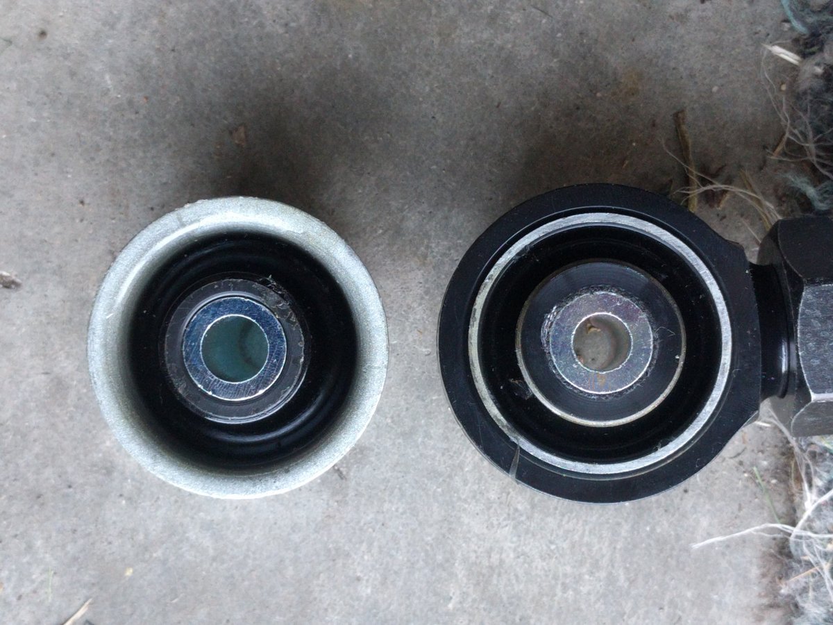

I just got the Synergy DDB bushings about an hour ago for the front upper axle. Here is a picture of the Synergy next to the Rancho D2 control arms. Obviuosly they are different bushing locations so some differences in design. The DDB also has a larger bolt hole because it is for a JK. I will just drill out my control arm yoke to fit the bigger bolt.
The material feels pretty similar to the touch and the sleeve also looks pretty similar in material. I don't really have a way to test the resistance to see how they feel in that respect. But just looking at them and feeling the materials, they feel like they are likely the same thing. So they could be the same mfg, but its still really hard to say.
One big difference that I noticed was the bolt sleeve inside Rancho D2 bushing sleeve fit really tight. They Synergy DDB bolt sleeve pops in and out easily with a little pressure from my thumb. Its interstesting that it kind of snaps in and out, but I don't see any kind of grove that it is snapping into.
Who was it again that had the Giiro joint? Did that sleeve kind of snap in and out or did it slide really easy? It makes me wonder if the Giiro joint and Synergy are indeed the same bushing. Along with the Rancho D2. They seem to have some similar characteristices. It may be just be a quality control issue that some slide in and out where others fit tight.
Anyway, I was disappointed that they are not a tight sleeve. This makes me question if I will have wear issues down the road and leaves me wondering if maybe I should have just gone with a JJ but we'll see. At this point it really depends on how durable that Teflon liner is.
Some advice from a fellow DDB convert ... throw them in and enjoy the ride !!! They’re great, they tighten up the Jeep. I am confidant they will do so until they don’t, I won’t stress about their durability until they fail which I hope is a long time from now. Until then enjoy the ride ...
BTW: I noticed that some bushings are tight and some are lose (like you said). I wouldn’t worry too much about contamination as I assume the “soft” bushing material makes a decent seal... again, we will soon see ...
