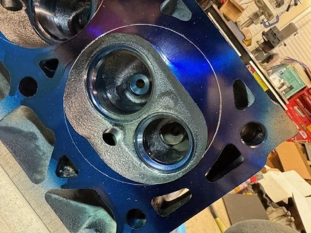

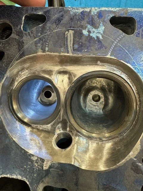

Port & polish is almost done, just need to finish the detail work on the combustion chambers:

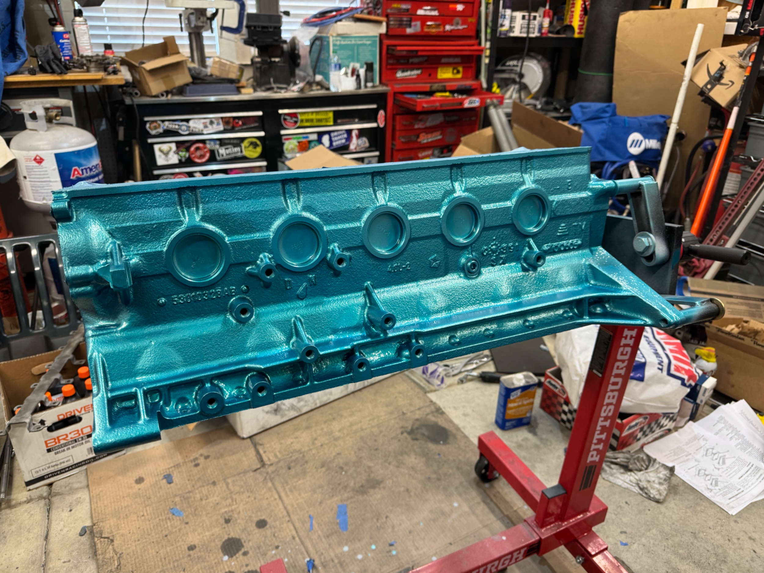

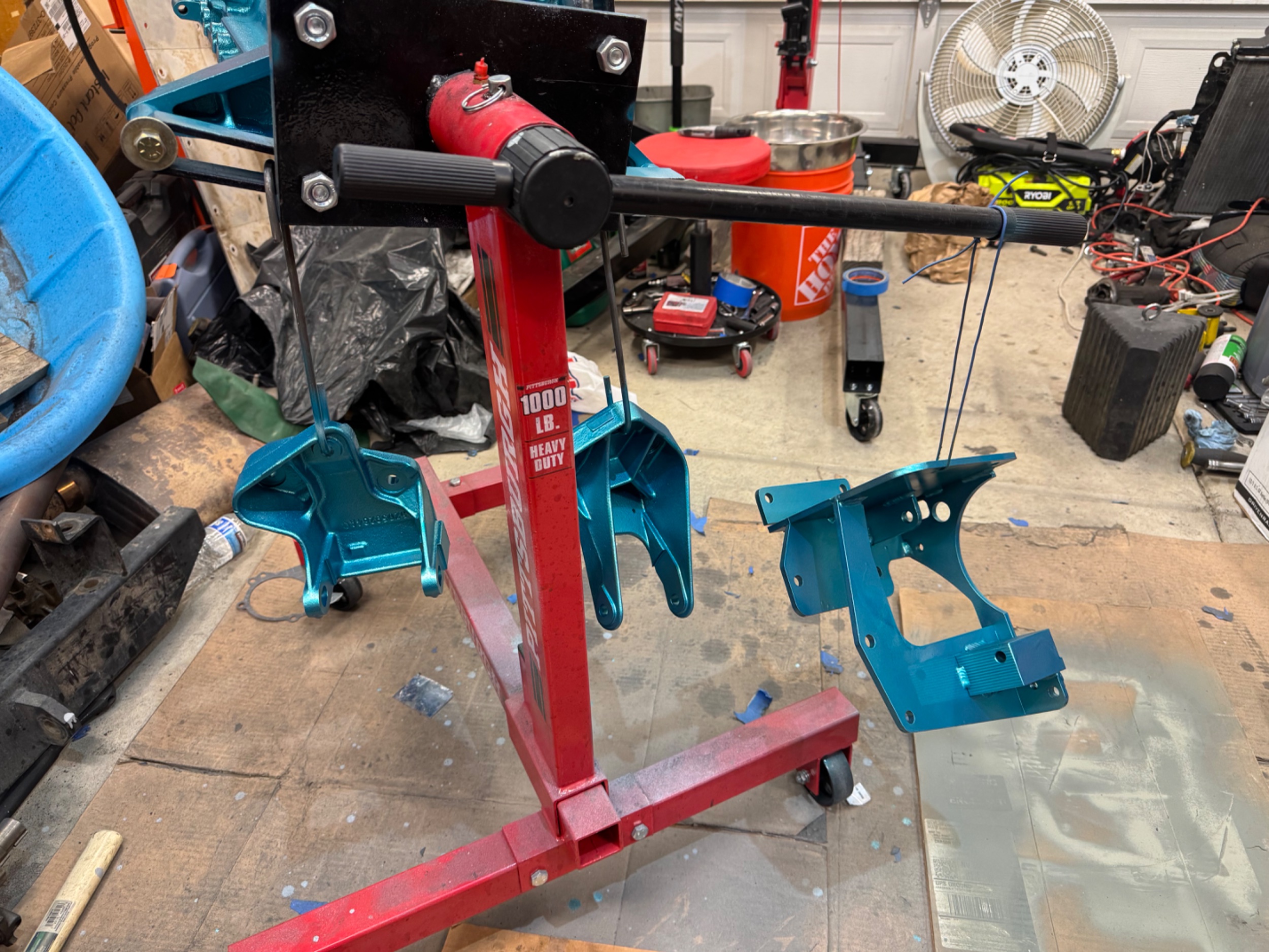

Seymour. Decent price, seems like high-quality paint.
From reviews I’ve read they look like a good product. Thinking about repainting my block the same color since my dad loved that color on a small boat with a 400 Pontiac that was nitrous charged. My grandpa / his dad built it so I’m doing it as in memory for him once I stroke mine

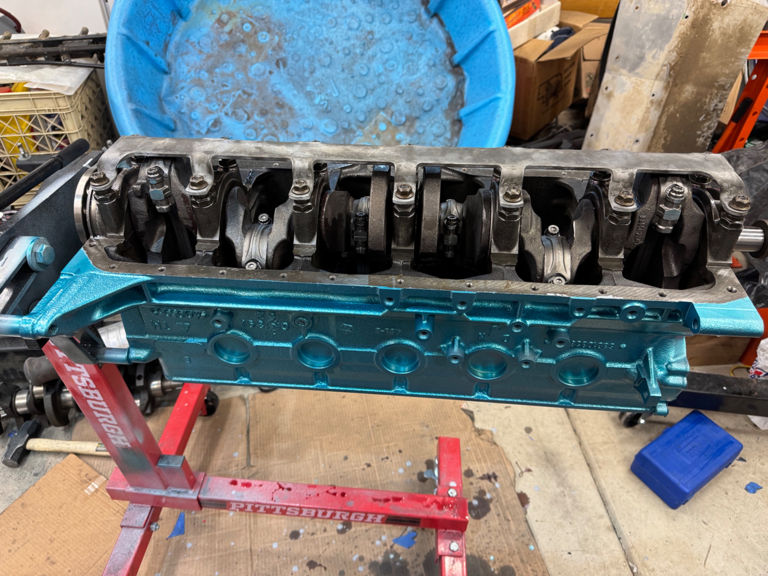

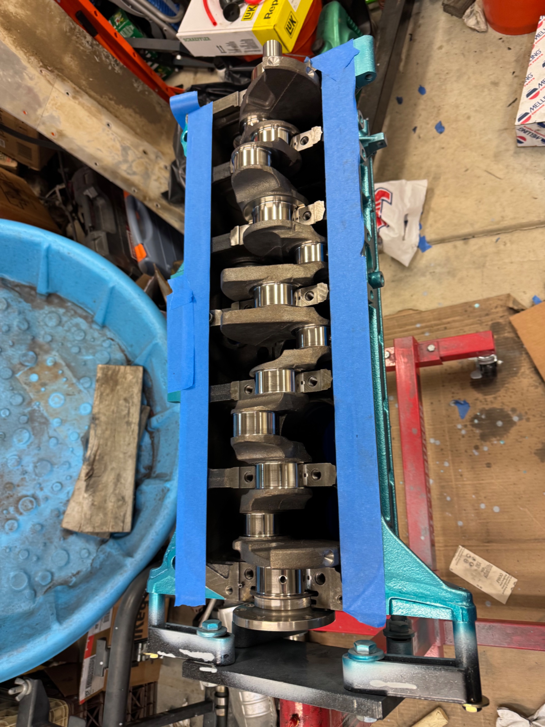

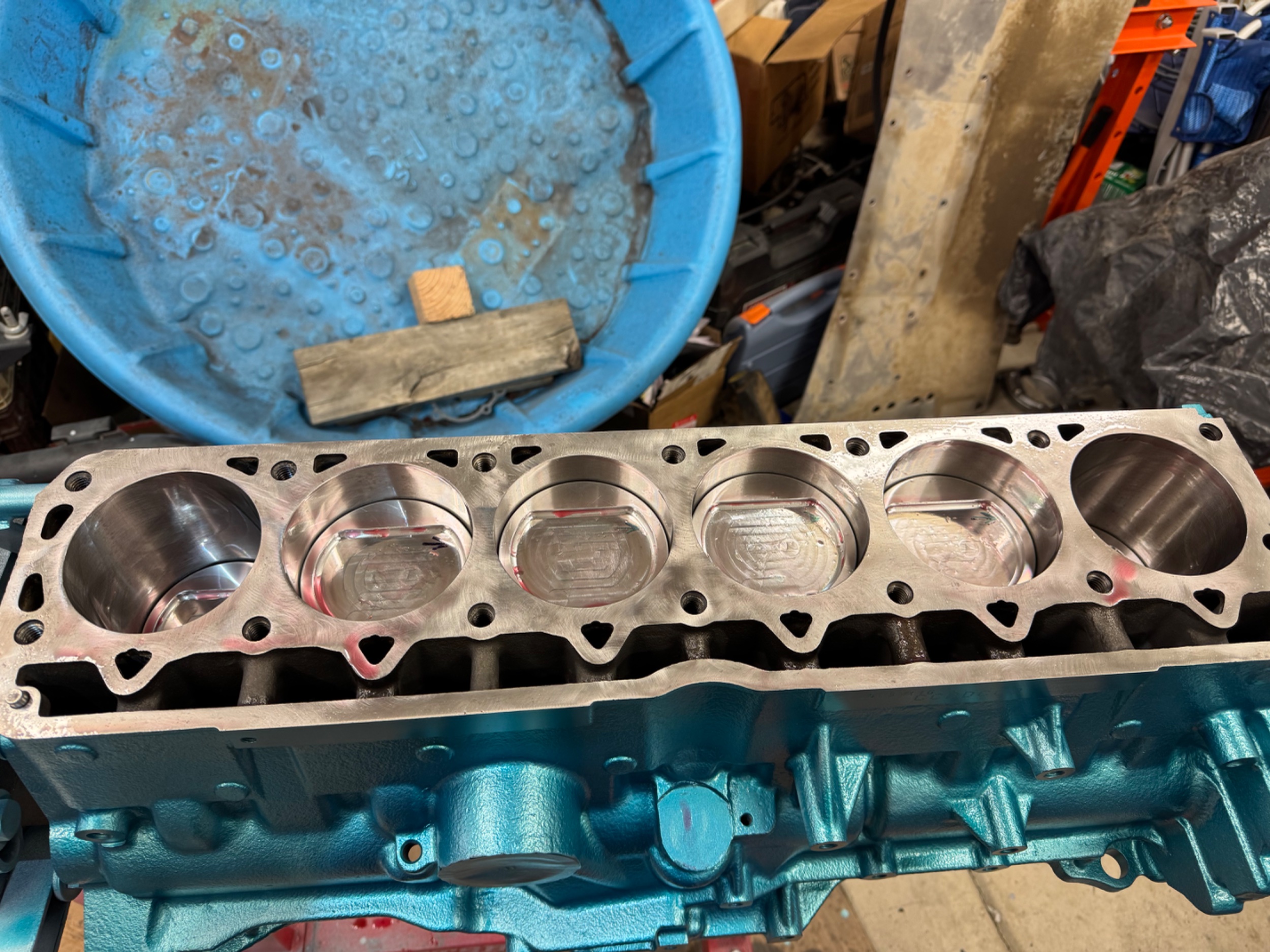

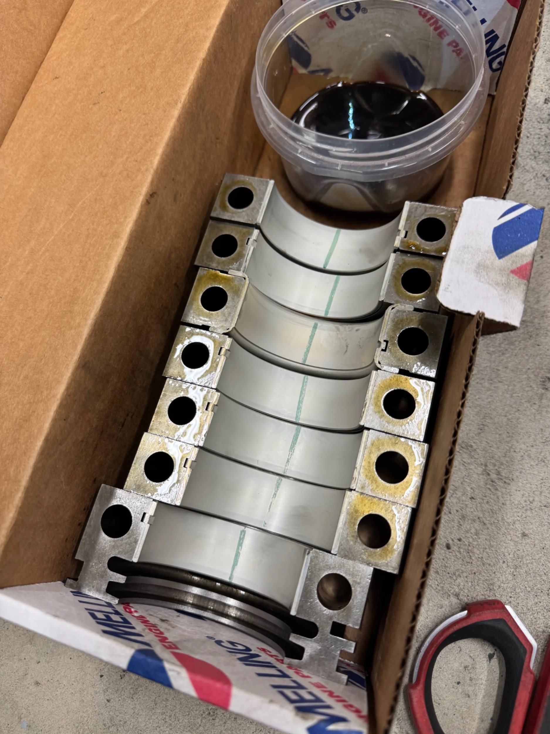

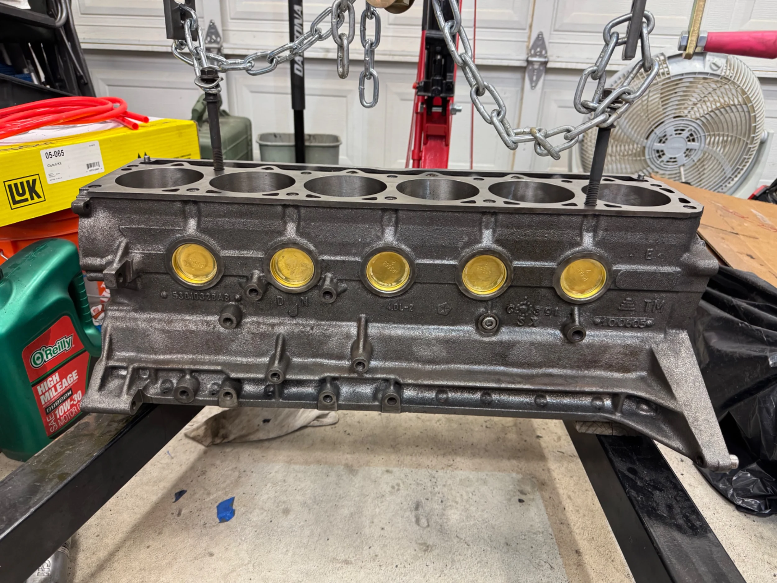

Crank and pistons are installed! The rebuild has officially begun.
Scat rods and racetec pistons right?
Also scat crank?
My scat crank has rear main seal surface that is knurled(?). Grooves at a 45* angle. I've read that is for a rope style rear seal. If a scat crank, is yours the same? What are your thoughts on seal types?
