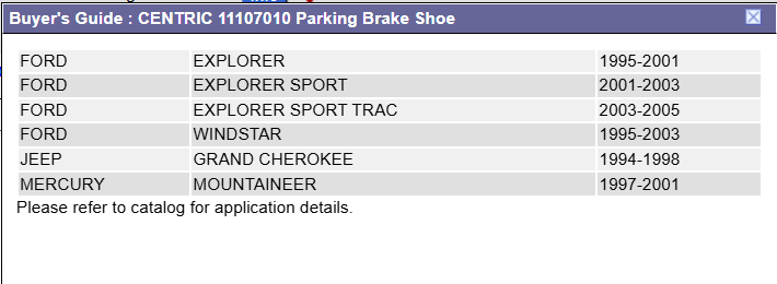

So, does this mean when I am going to need replacement e-brake shoes, I will look for ones for a 2003 Ford Explorer?
What about the disc brake pads? Are the calipers also from a 2003 Ford Explorer rear axle?
Not according to the Buyer's Guide.
The pads should be the 667 for the same years as the Buyer's Guide. Larger rose clip to fit into the steel pistons.
95-01 is what I see.
