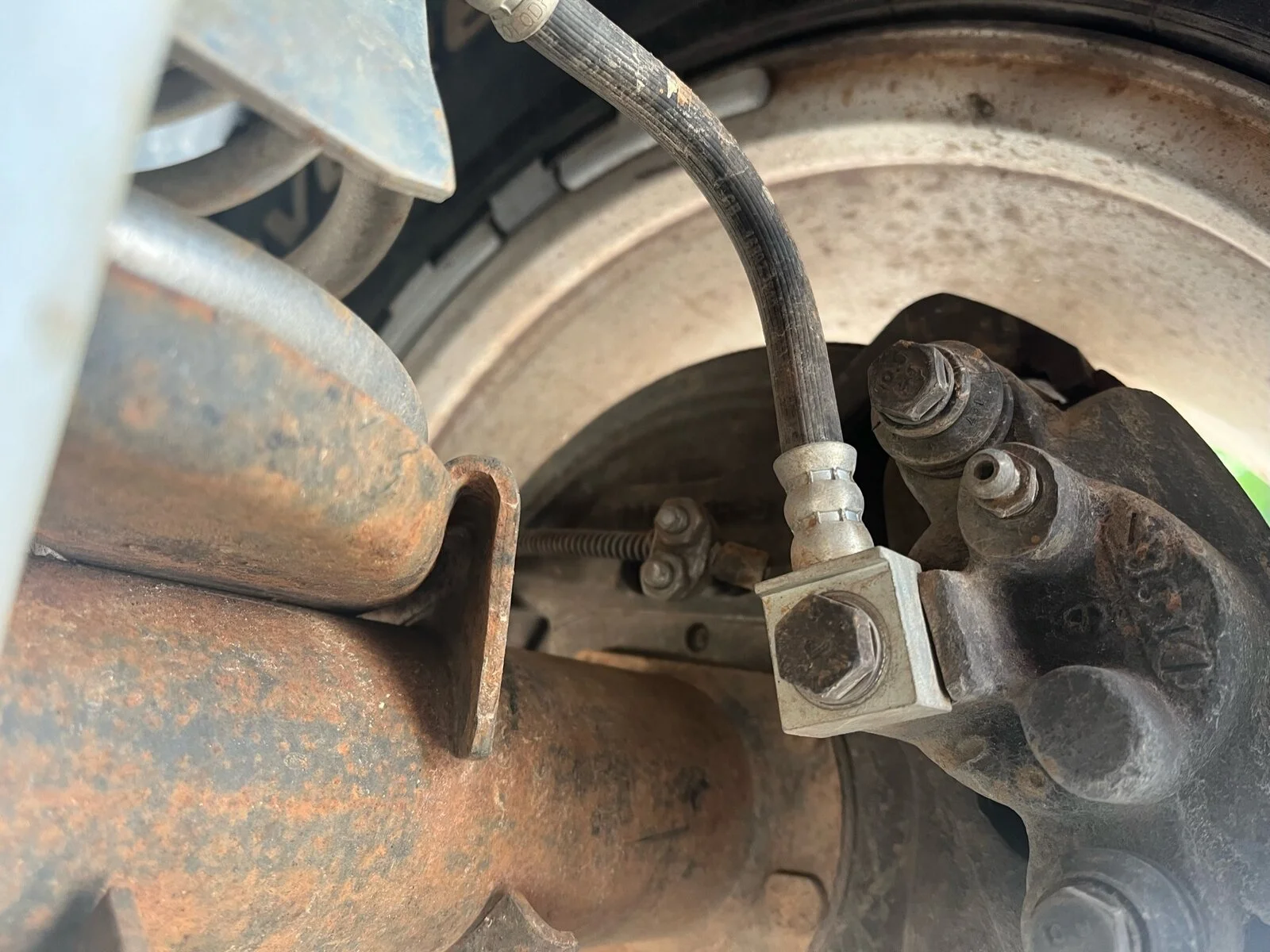

Correct. Go with the ZJ soft line to plumb the caliper to the TJ hard line - it's a bolt on deal.
For my parking brake cable, I used a hardware store 3/8" cable clamp to clamp the TJ cable to the lever on the ZJ backing plate. It's worked fine for the 3+ years it's been on my TJ.
Reactions: AndyA
Thanks Dan! The hard lines go right into the drums so there is room to add the soft lines? Is it possible for you to post a picture of your soft lines and cable clamp?
Thanks, Andy
Thanks, Andy
Certainly. This is the best I can get at the moment, but hopefully this helps to show the clamp. The hard lines on my 97 stopped short of the drum and had a section of soft line. I removed TJ soft line and installed the ZJ soft line. Ignore the dangling bracket in the left hand corner.
Reactions: AndyA
