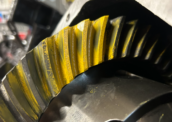

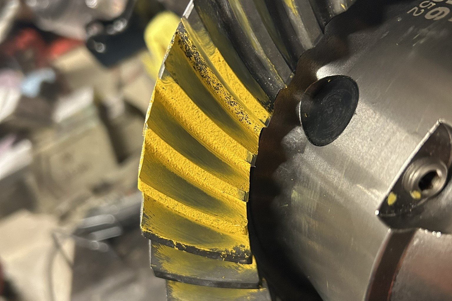

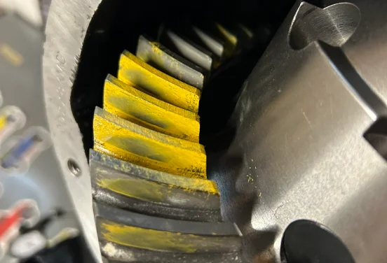

Gear Wear Patterns:
(I have already been told these are not the greatest pictures, and I will be working on getting better ones today that show more of the face of the tooth).
My main questions are...
1. Does the gear wear pattern look acceptable?
2. Is it okay that I have no shim pack on the right side of the carrier?
3. Pinion Depth seems far, is .040" a normal number to be reading?
4. Any other lesser known pointers that I should know?
I wanted to get this posted here now to begin the discussion, but I will be working on this today more. I plan to get better pictures of the wear pattern and check my measurements on shim thickness sizes. Also I found this link last night that seems to outline a really good way to get to a starting point, I will probably save the above measurements in case feedback is good, but also play with some new ones to see if I can get better wear / numbers. Any advice on this is super appreciated and I look forward to discussing! :)

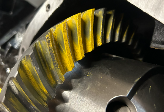

First, when taking pictures, try to get your angle looking more at the face of the tooth rather than straight down at it from the top. Be sure to include the bottom side of the pattern too so we can see if it's too deep or not.
Right SIde Shims: None
This will probably change as you make depth adjustments.
Looking at your current pattern, it looks a little deep to me but hard to say 100% because of the angle the pic was taken at. I would probably remove 7-10 thou and see if it will show the shallow side.

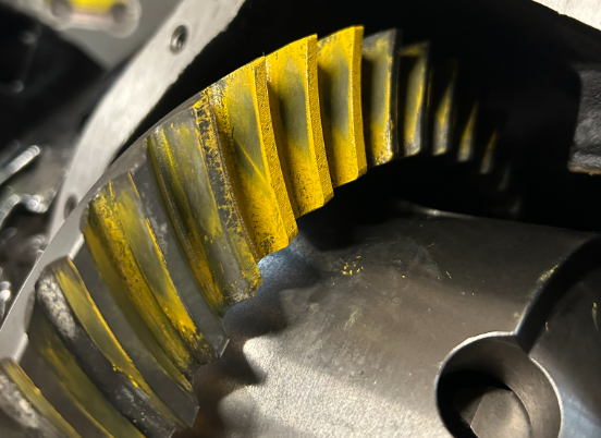

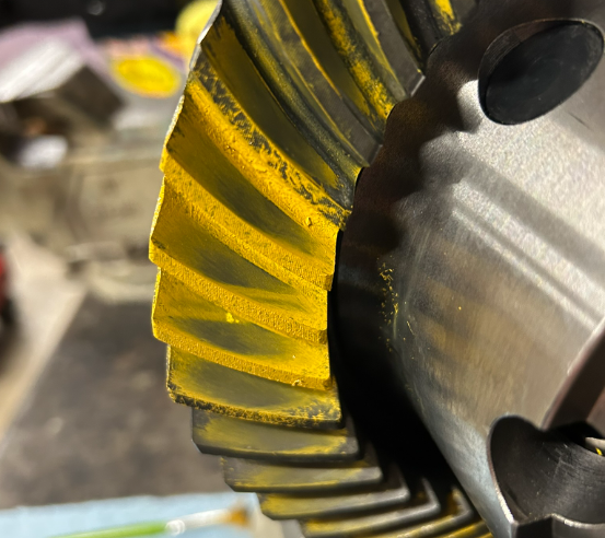

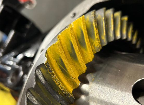

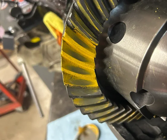

Okay was able to make some progress today and have some more information to provide / receive feedback on!
1. Pictures
, the below should be better now, tried to get all of the tooth face showing, let me know if another angle would be better.
2. Shim sizes, I was using a digital caliper to measure shim thickness - bad idea... I switched to a Starrett analog caliper and have gotten much more accurate measurements for shim thickness.
I basically started over from scratch after having to re-measure all my shims since the old values were inaccurate. Below is an outline of that process...

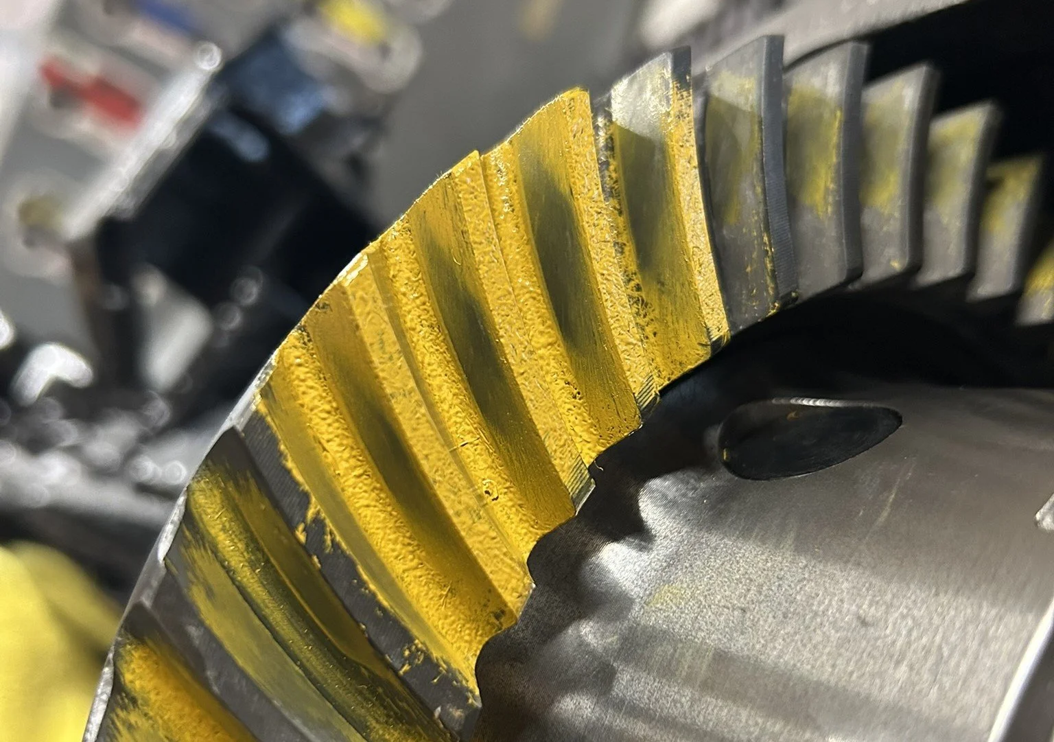

PINION IS GOOD? (Extra pics to be sure)

Making progress for sure and learning a lot as I go! Trying to share the entire experience here so more can learn.
Your third and fifth attempts were best.
But nothing matters if your backlash isn't in spec. Bring your backlash in spec with those same PD numbers and let's have a look.
By the way, I absolutely love the way you present your progress. People should use this as a template for gear setup! The only thing I'd change is to add your backlash number to each setup.

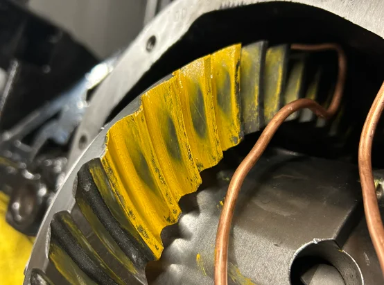

Agreed 3rd and 5th was the best, and makes sense on the backlash. Turns out all I needed was to take a break and grab something to eat. Came back and inserted the carrier a little higher into the case instead of rolling it in from the bottom and found it was sliding right in. Then in 3 more attempts was able to get the backlash into spec. Here's how that process went...
ATTEMPT 1:
PD
: .045
Left Side Shims:
OE Master Shim, ARB Master Shim, ARB Seal Housing, .012 Shim Pack (.012)
Right SIde Shims: OE Master Shim, ARB Master Shim, No Shim Pack.
Backlash: .015
ATTEMPT 2:
PD
: .045
Left Side Shims:
OE Master Shim, ARB Master Shim, ARB Seal Housing, .018 Shim Pack (.012 + .006)
Backlash: .012
ATTEMPT 3:
PD
: .045
Left Side Shims:
OE Master Shim, ARB Master Shim, ARB Seal Housing, .022 Shim Pack (.012 + .006 +.004)
Backlash: .009

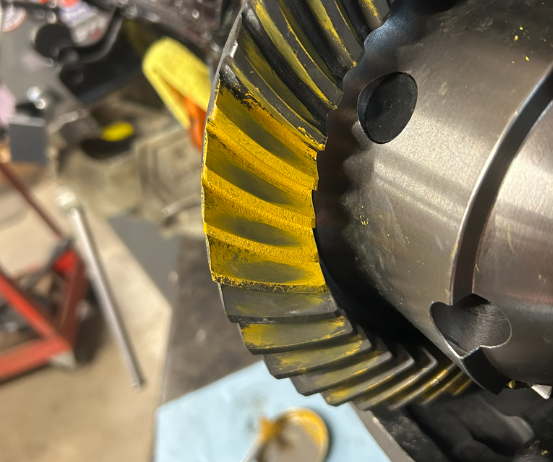

RESULTING PATTERN FROM ATTEMPT 3:
I now have what I believe to be a final setup based on the below measurements.
Pinion Depth: .045
Backlash: .009
Left Side Shims: OE Master Shim, ARB Master Shim, ARB Seal Housing, .022 Shim Pack (.012 + .006 +.004)
Carrier Preload: Set so the carrier needs to be installed with 6-8 good whacks of a dead blow.
Pinion Preload: Not at this point yet.

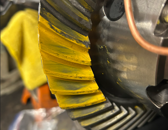

Looking to confirm the results here, and then I will move onto final assembly. I did manage to finally break the infamous copper line after about 20 or more successful installs. Project might be on hold for a bit until I get a new one, going to be placing the order tomorrow, but I will update this thread until the axle is complete. Not mad as now I have a setup one for life, but there has GOT to be a smarter way to connect that copper line to the seal housing.
Anyway, I guess my only question is how does it look? Happy to play around more with it if needed but I think this looks good. Also still no use of extra shims on the right side, but that's how it was stock so I guess that's fine.
Reactions: hosejockey61
View attachment 601500View attachment 601501
Pinion Depth: .045
Backlash: .009
I think you're there too. Fun process huh? 😎😁👍
Oh super fun process lol! In all seriousness though I find it fascinating how this all works and the feeling of being able to do it yourself is amazing.
As for what you mentioned in post #7 about the carrier shimming, I do still have the ARB Master Shim and the OEM Master Shim on the right side, I am just not using any additional thinner shims to build a pack on that side. I have swapped them all to the left side as outlined below...
Right Side Shims: OE Master Shim, ARB Master Shim, No Shim Pack.
I think this is okay because I am still using the ARB and OEM shim on the right?
Lastly I forgot to respond to the below from post #5...
I really really appreciate this. I am 100% self taught when it comes to mechanical work, with no professional training. I love doing this and I have found that being extremely organized and detail oriented can not only make your own life easier but also make the content more digestible and understandable for others as well.
I have also been working on a few documents for logging and tracking shim pack thickness, and measurements. I will share those here once completed. But I was thinking if you would like we could possibly work together to create a "how to" type guide to post here similar to this one but a bit easier to digest. You absolutely have more knowledge and experience than me on this, but I would love to help get all the thoughts into an easily readable forum post.
You're correct with your shims and good to go. As far as trying to one up the Billavista Gear Bible? If there's one thing I've learned in life, it's don't mess with the Bible!

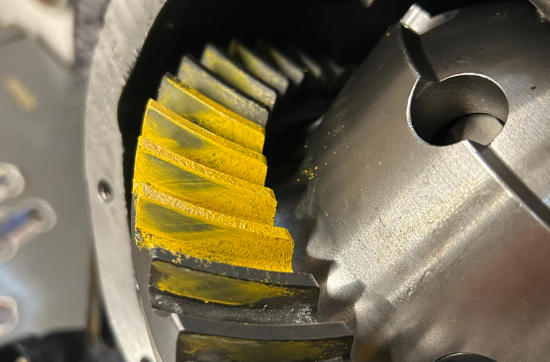

Alrighty, I was able to wrap up the final install of the locker today. Here's a breakdown of some of the final results.
THE NUMBERS:
Pinion Depth:
.013 Shims behind race + .032 Shims behind Bearing = .045"
Backlash
: .008" on 3 spots on the ring gear.
Pinion Preload: ~15-20 in/lbs, set by .060 Shim Pack.
Left Carrier Shims: OE Master Shim, ARB Master Shim, ARB Seal Housing, .022 Shim Pack (.012 + .006 +.004)
Right Carrier Shims: OE Master Shim, ARB Master Shim, No Shim Pack.

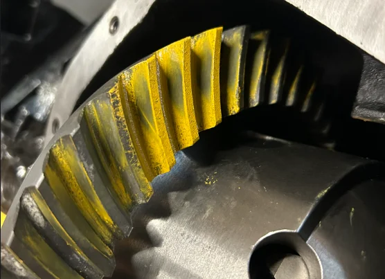

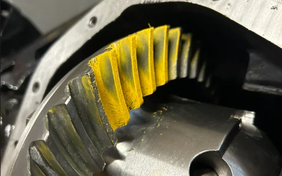

FINAL GEAR WEAR PATTERN:
Centered left to right & top to bottom, favoring the drive side of the tooth.

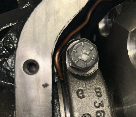

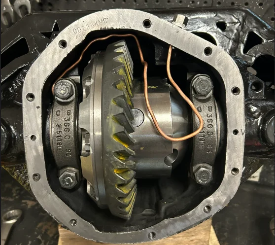

ROUTING OF COPPER LINE
A little wavy from having to work it so much, but line makes NO contact whatsoever with the bearing caps, housing, carrier, etc.
Note: It has already been explained how fragile this copper line can be. Let me take this time to reiterate... THE COPPER LINE IS EXTREMELY FRAGILE AND WILL BREAK / LEAK IF EXTREME CAUTION IS NOT USED. I was lucky enough to have ARB warranty the one I broke, I used much more caution with the new one and it installed safely.

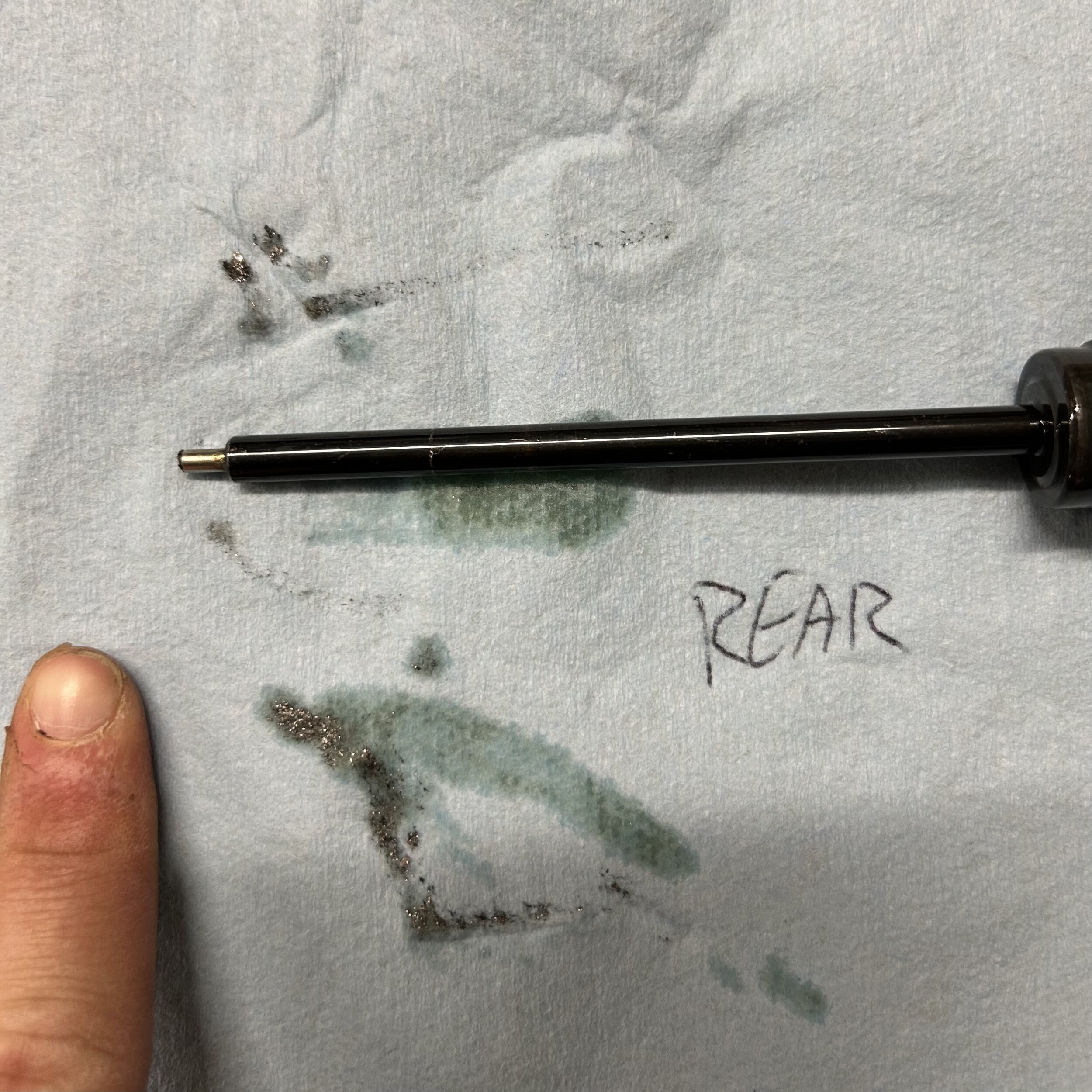

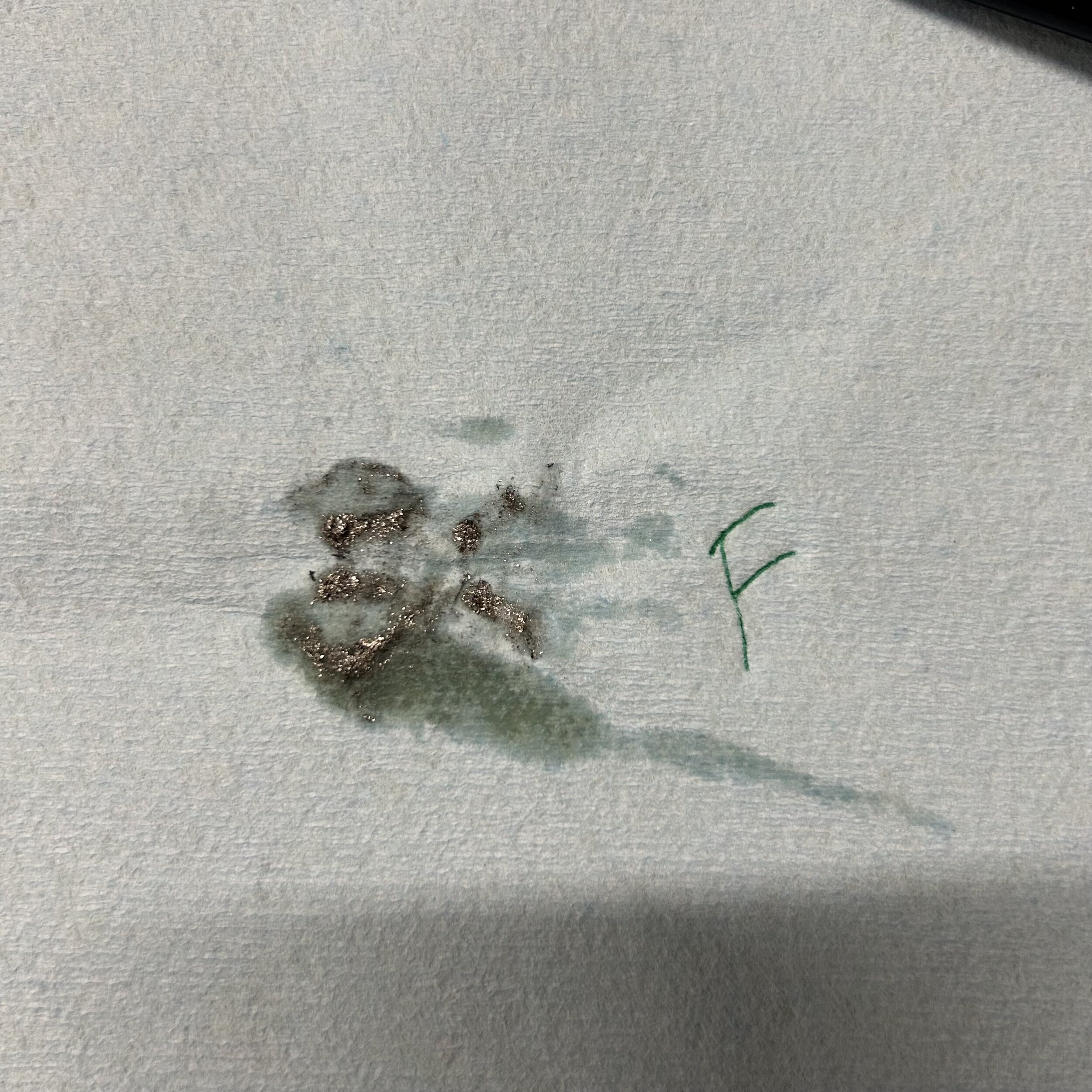

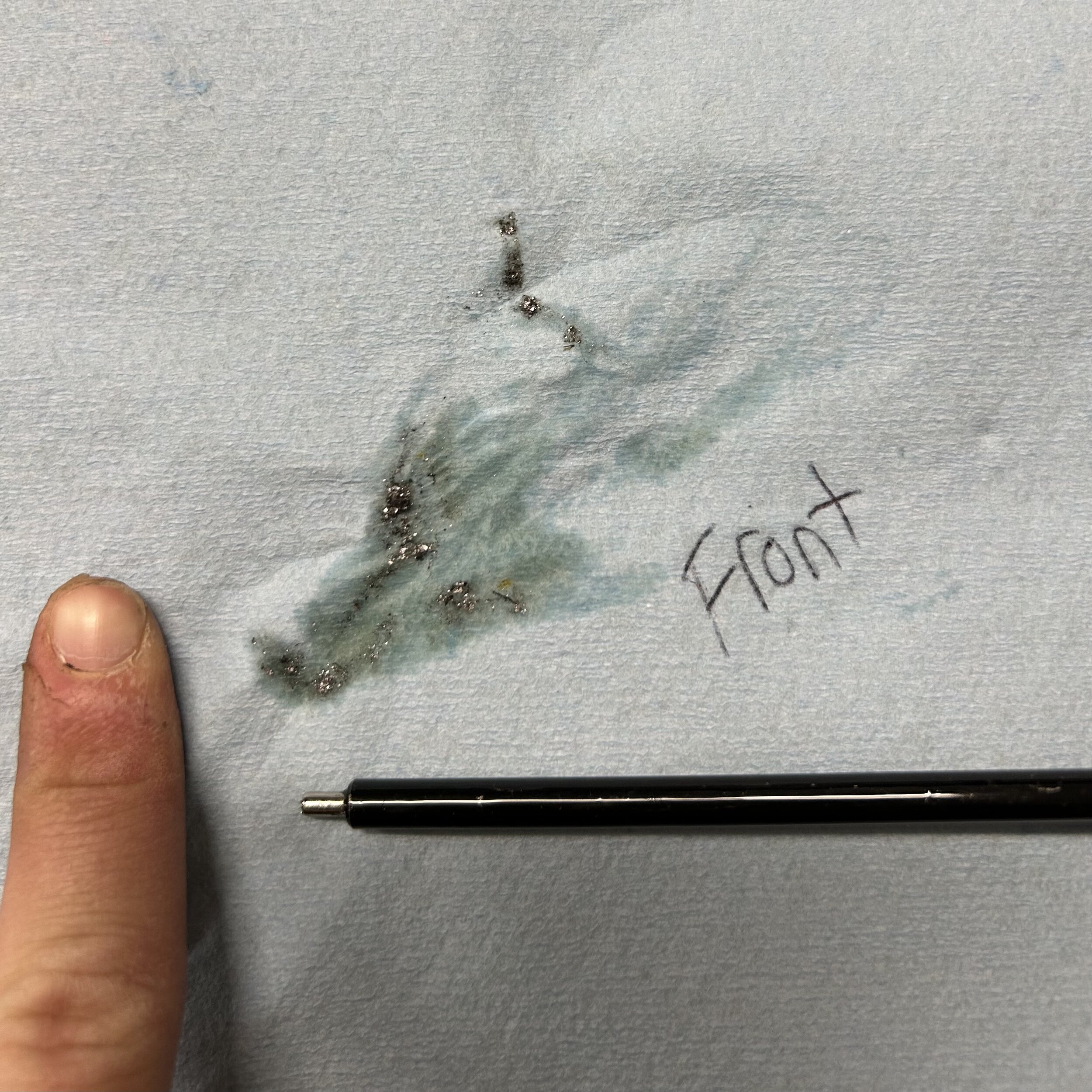

Oil Condition:
I first did a very short 5 mile test drive. Below is what was on the magnetic Diff Dipstick. Mostly glitter with some small chunks visible.
I then did a longer 10 mile drive. Below is what was on the magnetic Diff Dipstick. Now all glitter with no chunks.
I assume this is normal as part of the break in? Also the results appear to be the same front and rear, and there was less contamination after the second, longer drive. All I did up front was take apart and inspect the factory carrier and reinstall with the same hardware (wear items and seals were replaced). The rear was the full ARB Locker install detailed in this thread. This makes me worry a bit less. My plan is to continue to drive the Jeep and check the dipsticks. Then change the diff fluid at 2,500 miles or less like ARB states to do. Let me know what you think.
Glitter is normal, chunks not so much but that doesn't mean there is an issue. Those look small and no other problems after it, so I wouldn't worry to much about it. It could be perspective on my part zooming in on it and it looks bigger than what it is. I wouldn't worry though.
Yeah I would definitely classify this as glitter rather than chunks. The largest was probably about 1/16” long with the rest being 1/32” or smaller.
I’m thinking I’ll run this as is for about 1,000 miles, drain and pull the bearing caps to ensure everything looks good. Then refill and change again at 2,500 like ARB states. During all of this I’ll keep pulling the filler frequently to ensure no large chunks are forming.
