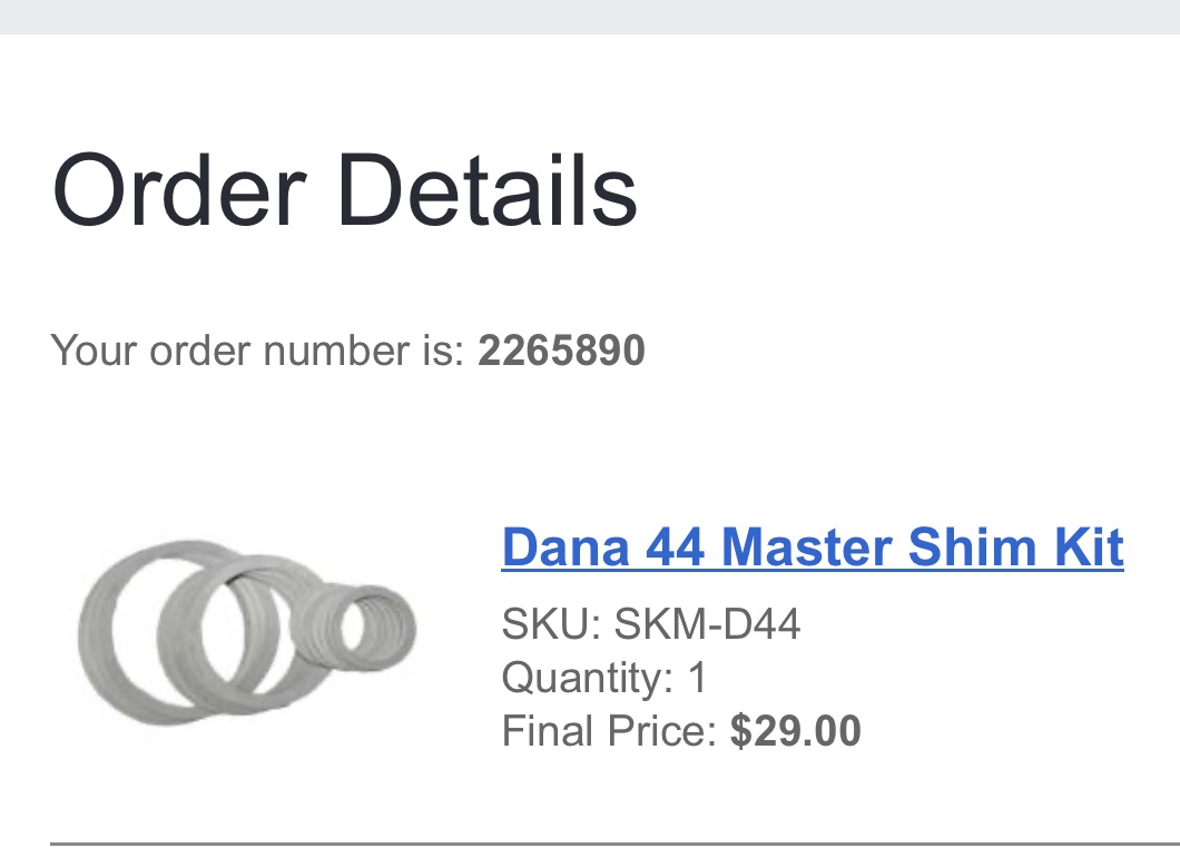

I got one from east coast gear, seems like a pretty good variety, I can measure and see if any specific thicknesses if looking for anything in particular
Crown package was a bust. I got 5 pinion race depth shims, all the same thickness and 5 pinion preload shims, all the same thickness. But I also got about 10 pinion bearing shims, but I didn't open the package. Shipping it back and trying a OEM Spicer kit.
I opened up the one I got from East Coast gear, it has a good variety of pinion race shims, all the way down to .001, probably 20 total of various thickness, a bunch of pinion preload shims also. The shims it had for carrier are not the right ones for a rubicon locker though, they are the smaller shims that would go on carrier before pressing bearings.
This is the part if helps you out.
Thanks for all the replies. I've gotten the ECG and the Spicer kits and ready for install. I'll report back if I have other issues.
