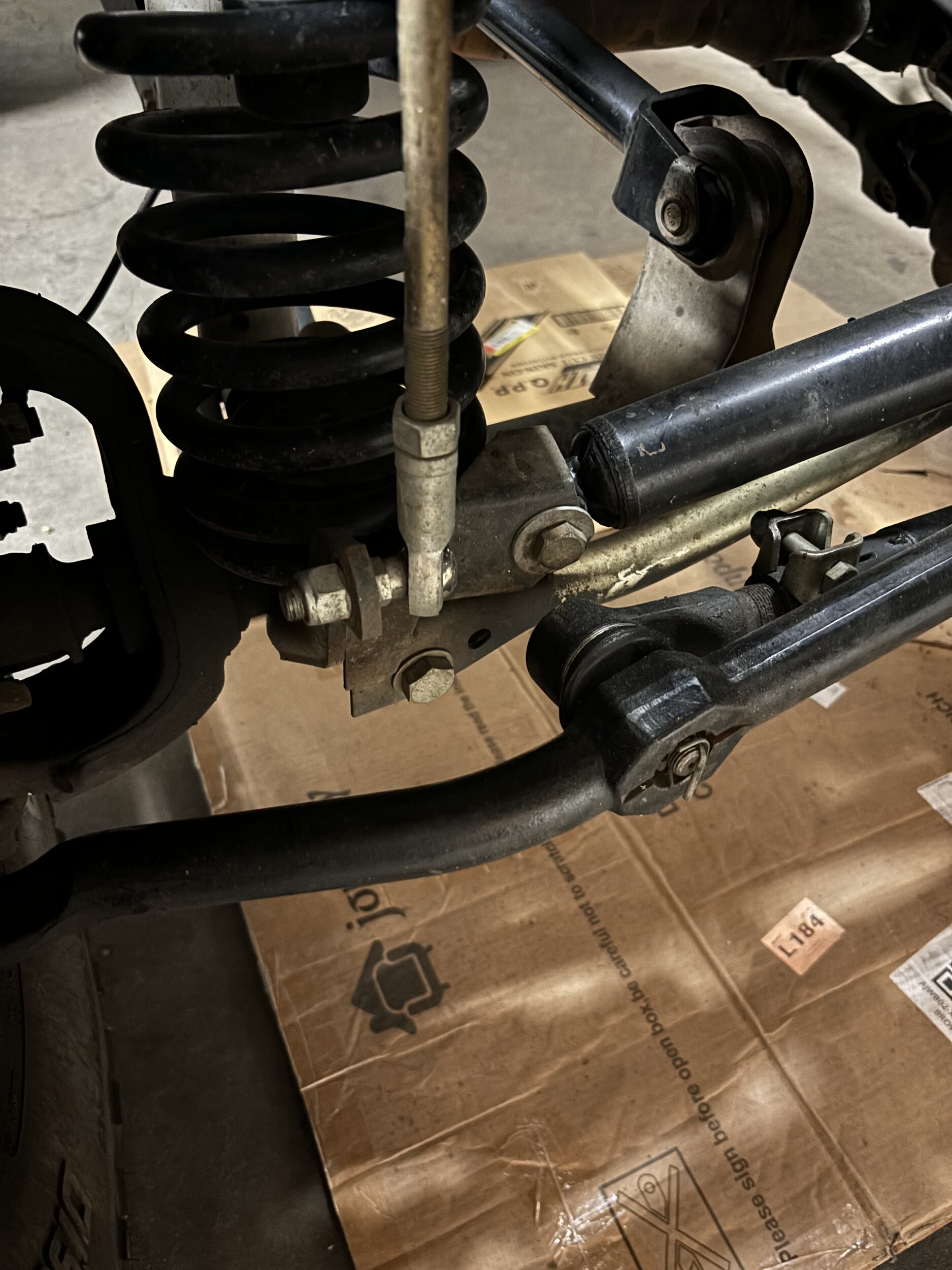

Currie Currectlync problems
The drag link only installs one way. The tie rod is a straight link and can go on any way you can imagine. The clamps typically get pointed down to avoid clearance issues with other things.
To add, the grease fittings are specific. The one in the cap goes to the left knuckle. The one that is in the body goes to the draglink.
