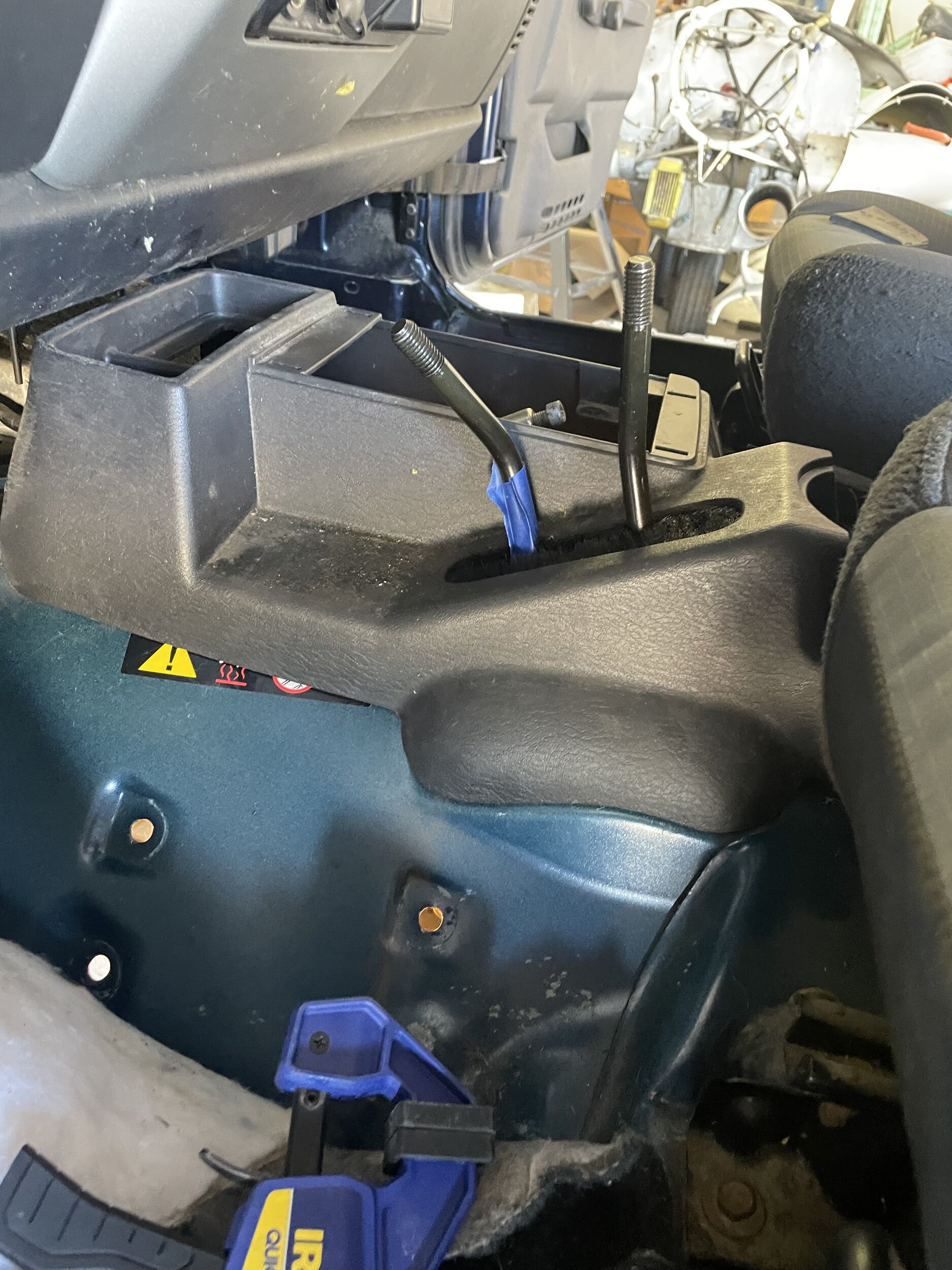

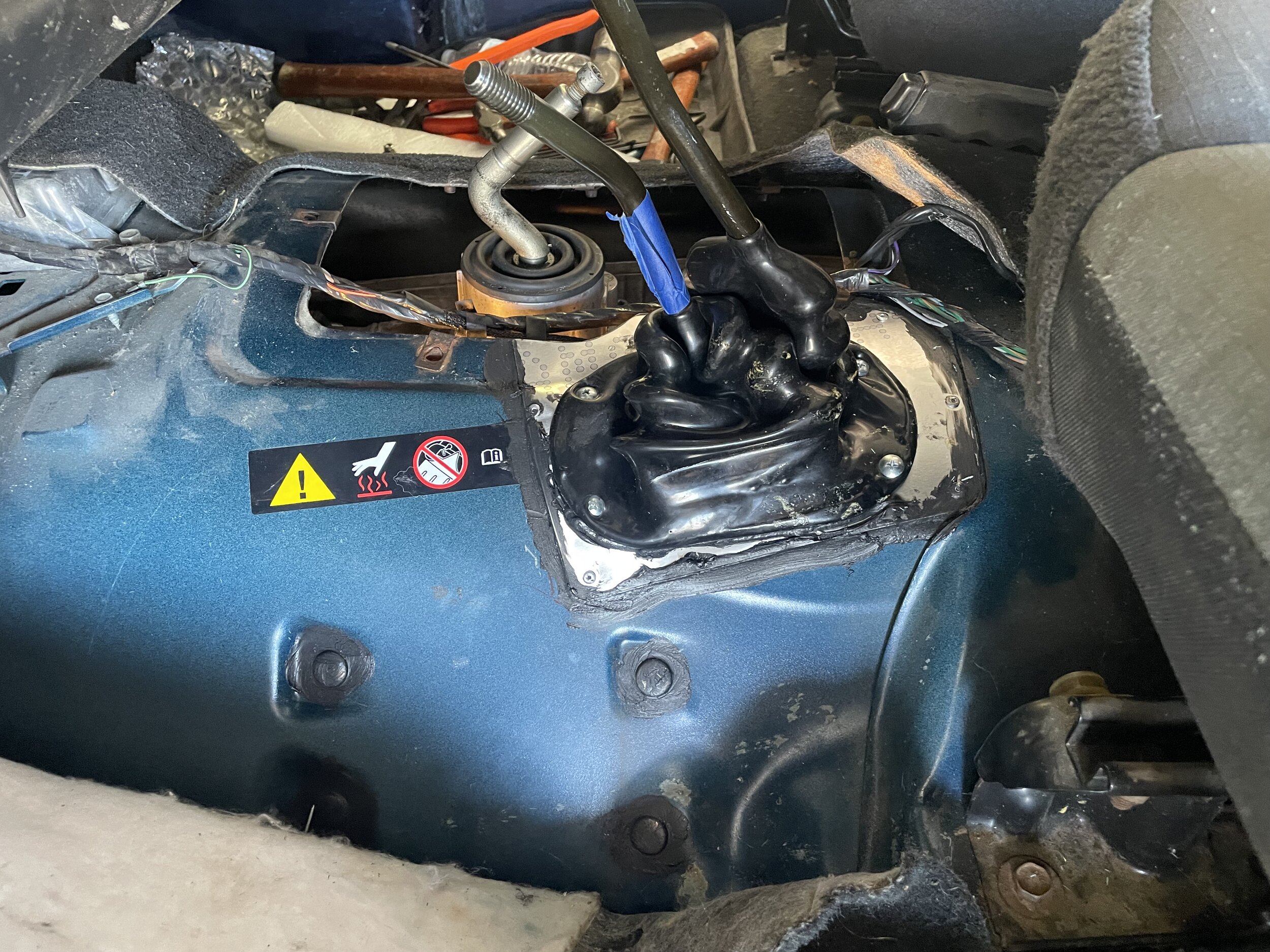

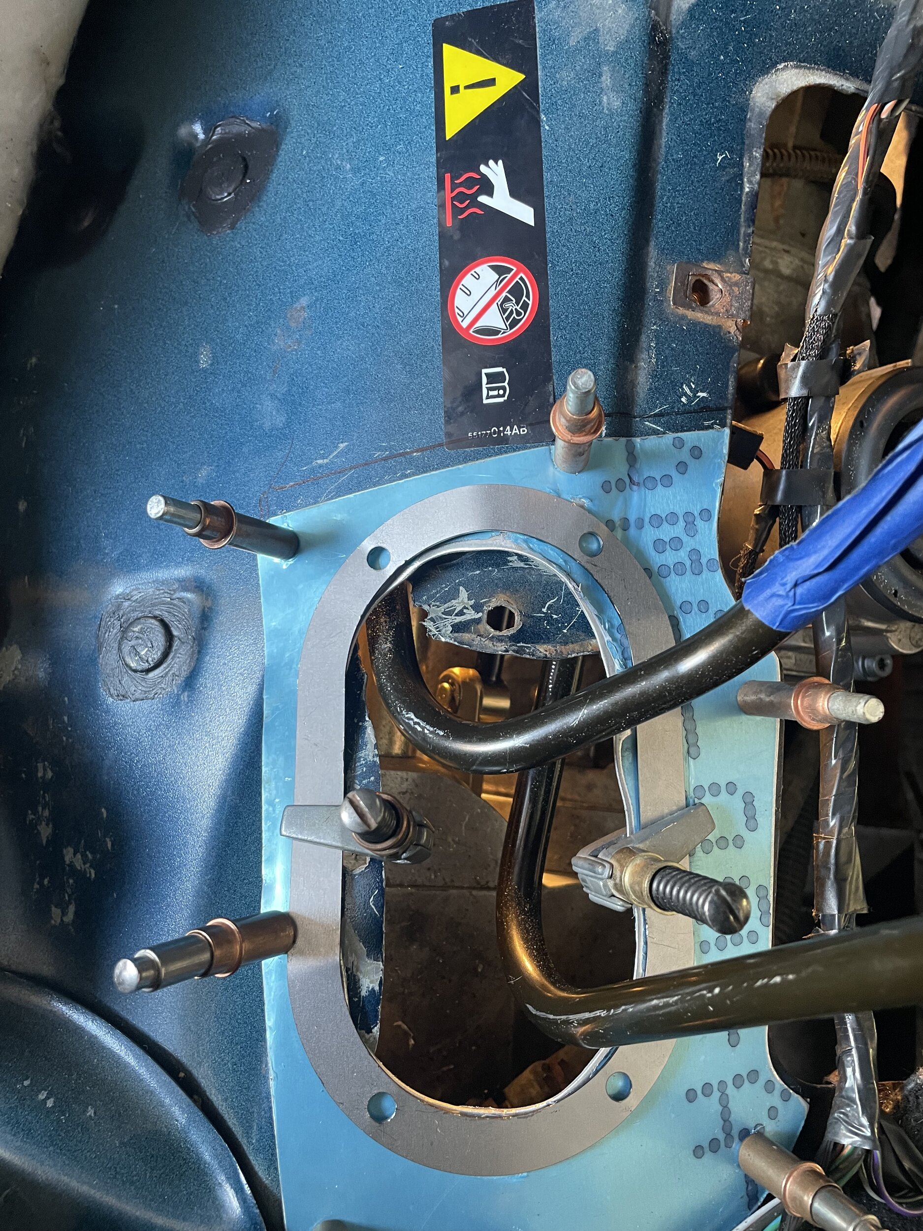

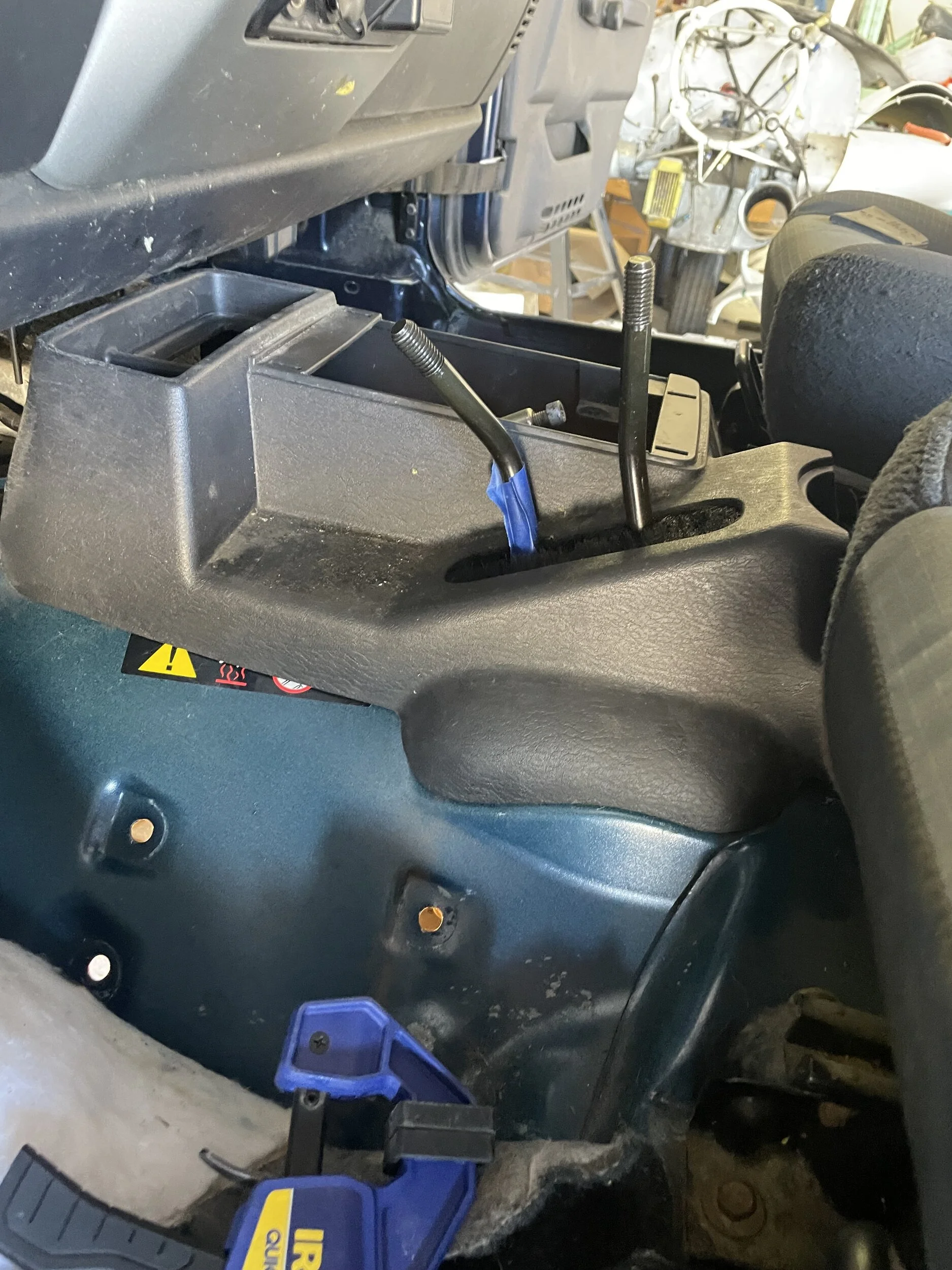

So I got the 3.8 2 speed I bought used installed, and I am installing twin stick. Does anyone know how long to cut the dom tube? I called advanced and the basically said just stat cutting till it works? WTH? It’s not like this hasn’t been done before…
