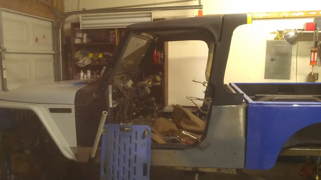

this is what the cab should look like, two-part hard top:
with the addition of a little space in the back for the dog and 1 gearbox.
