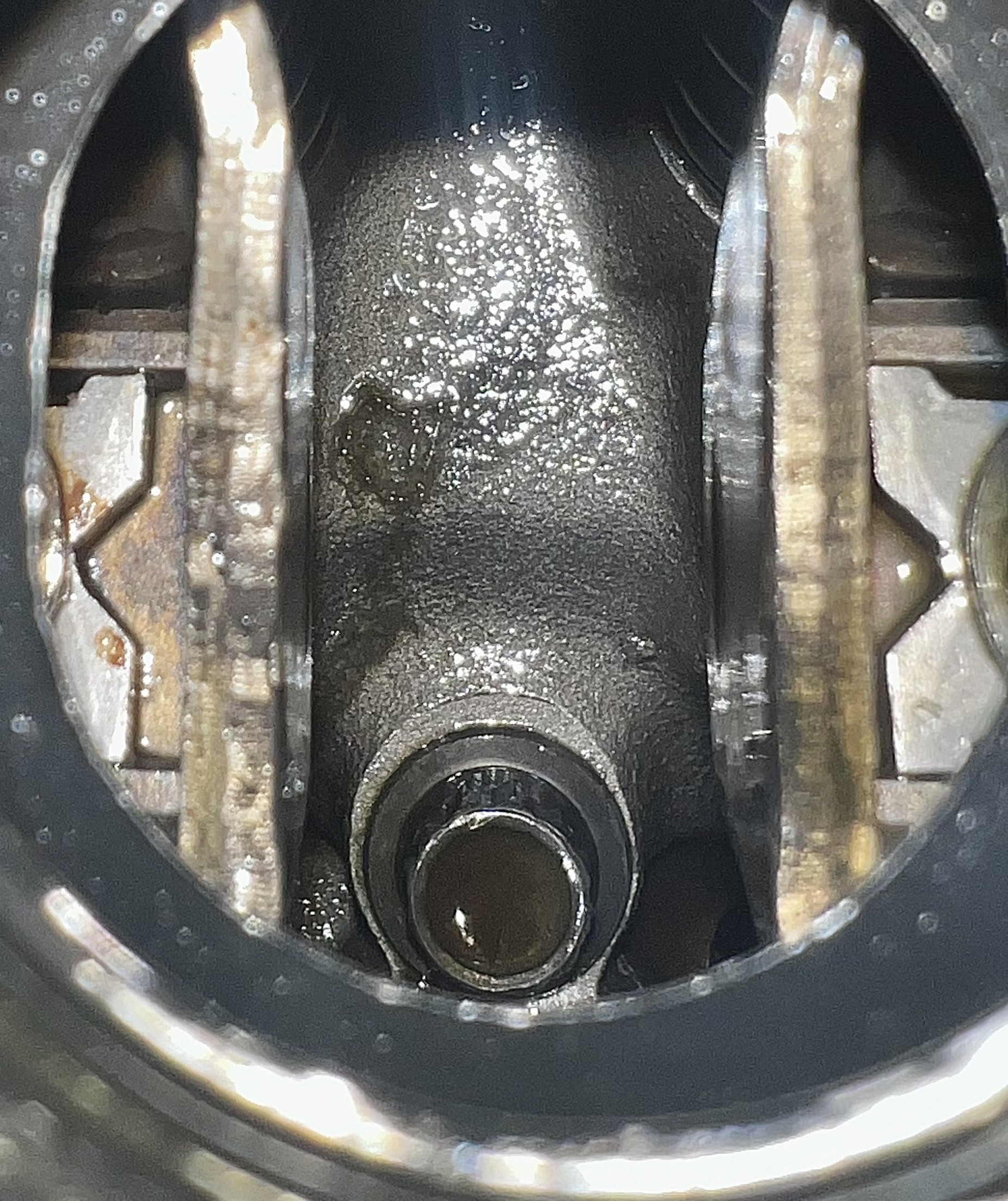

B1Toad TJ Addict Supporting Member Joined Jan 15, 2023 Messages 2,883 Location Arizona Jan 21, 2024 #21 Wipe it clean then pressurize the cooling system for a while and see if anything appears. (use a lint free cloth) Reactions: Rickyd, ColoJeep and JeepGirl1013

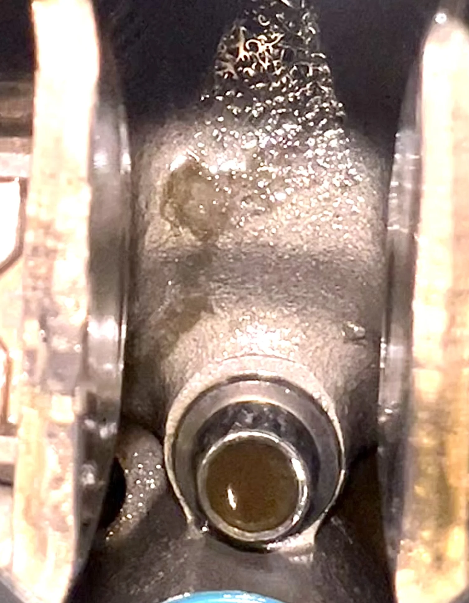

JeepGirl1013 TJ Enthusiast Original poster Supporting Member Joined Jan 12, 2024 Messages 161 Location Missouri Jan 21, 2024 #22 JeepGirl1013 said: Thank yo View attachment 493387 Tried to zoom in and enhance the details a bit Click to expand... One more for good measure
