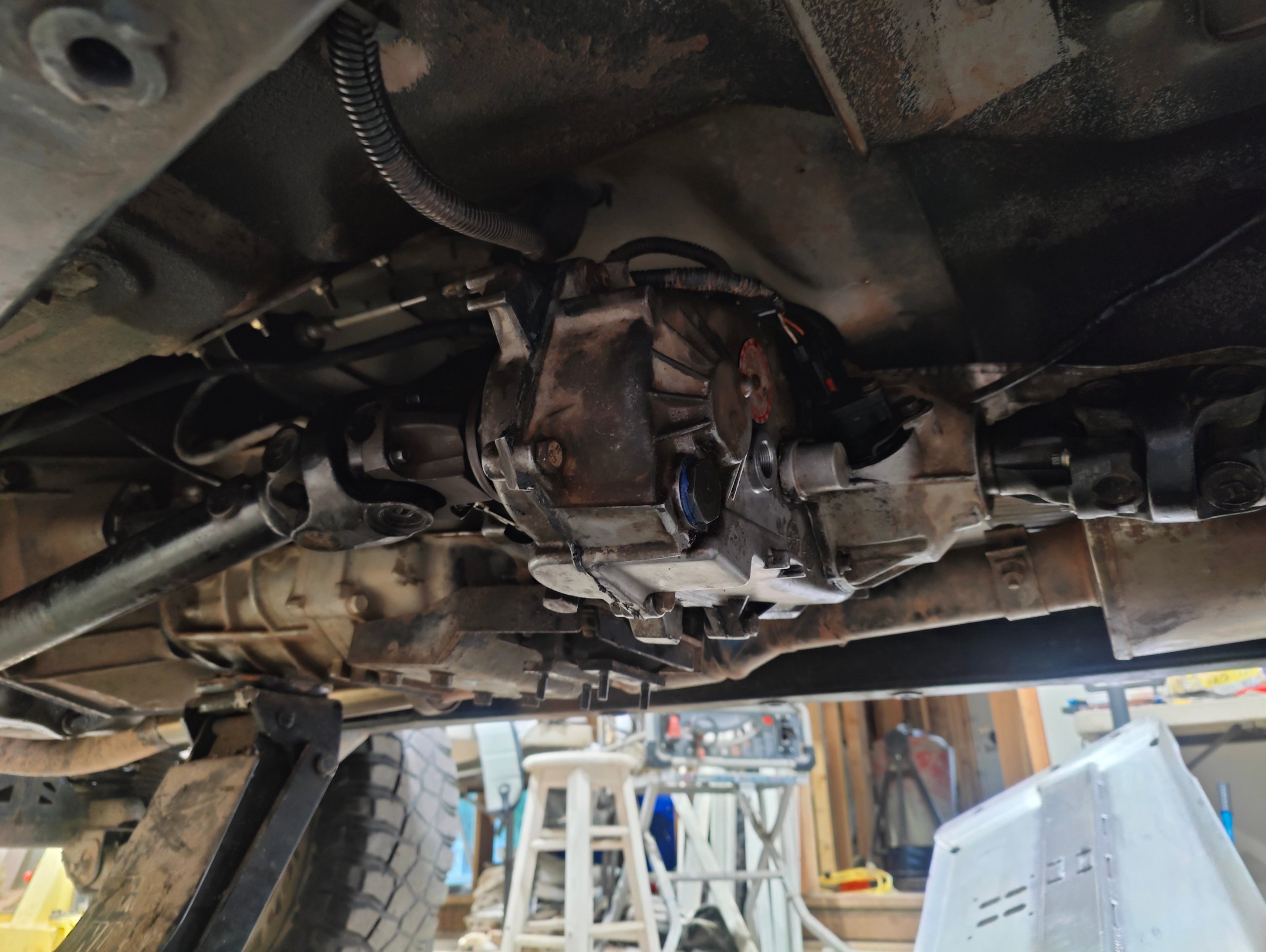

Ok...been a long couple of days.

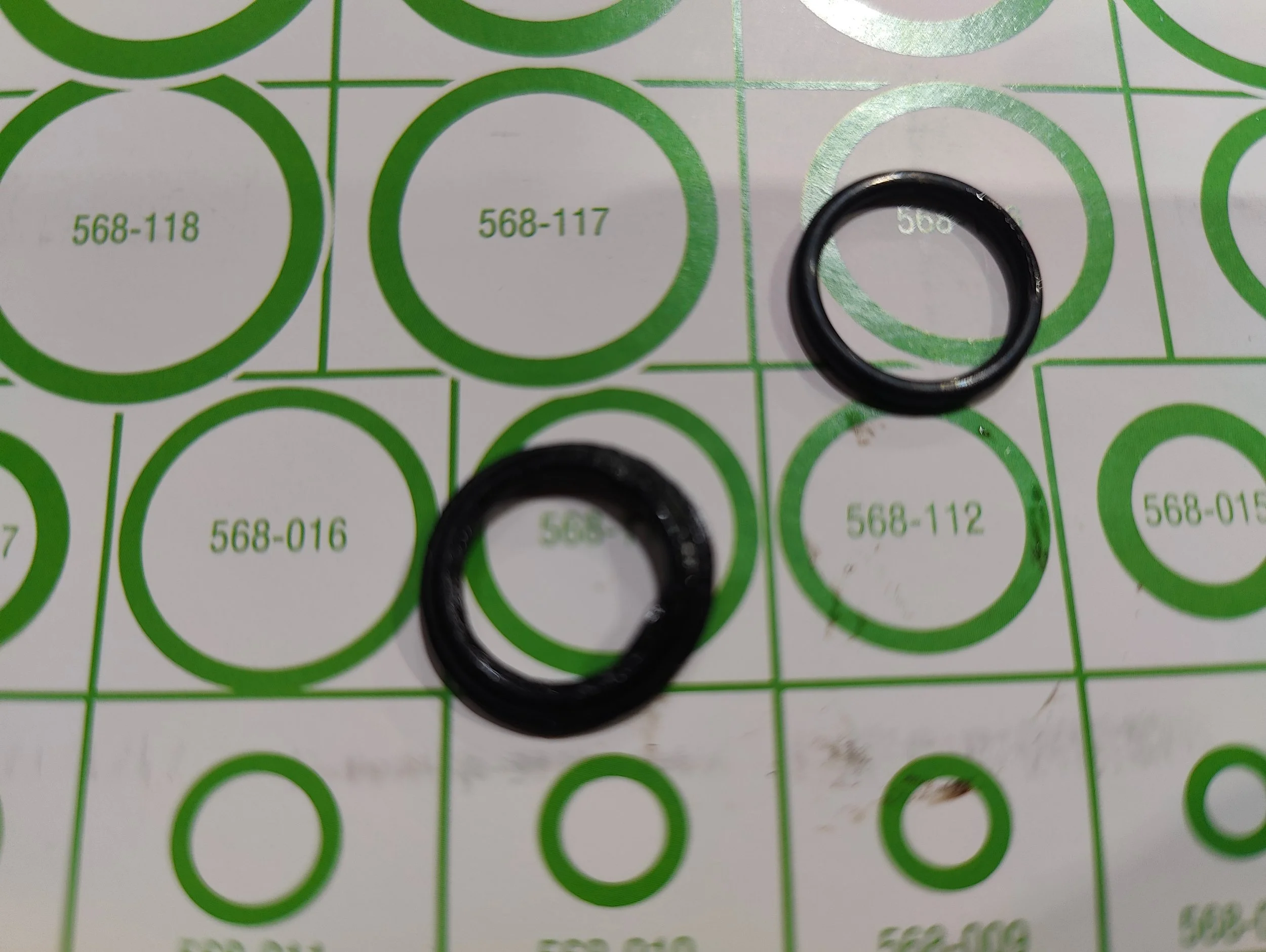

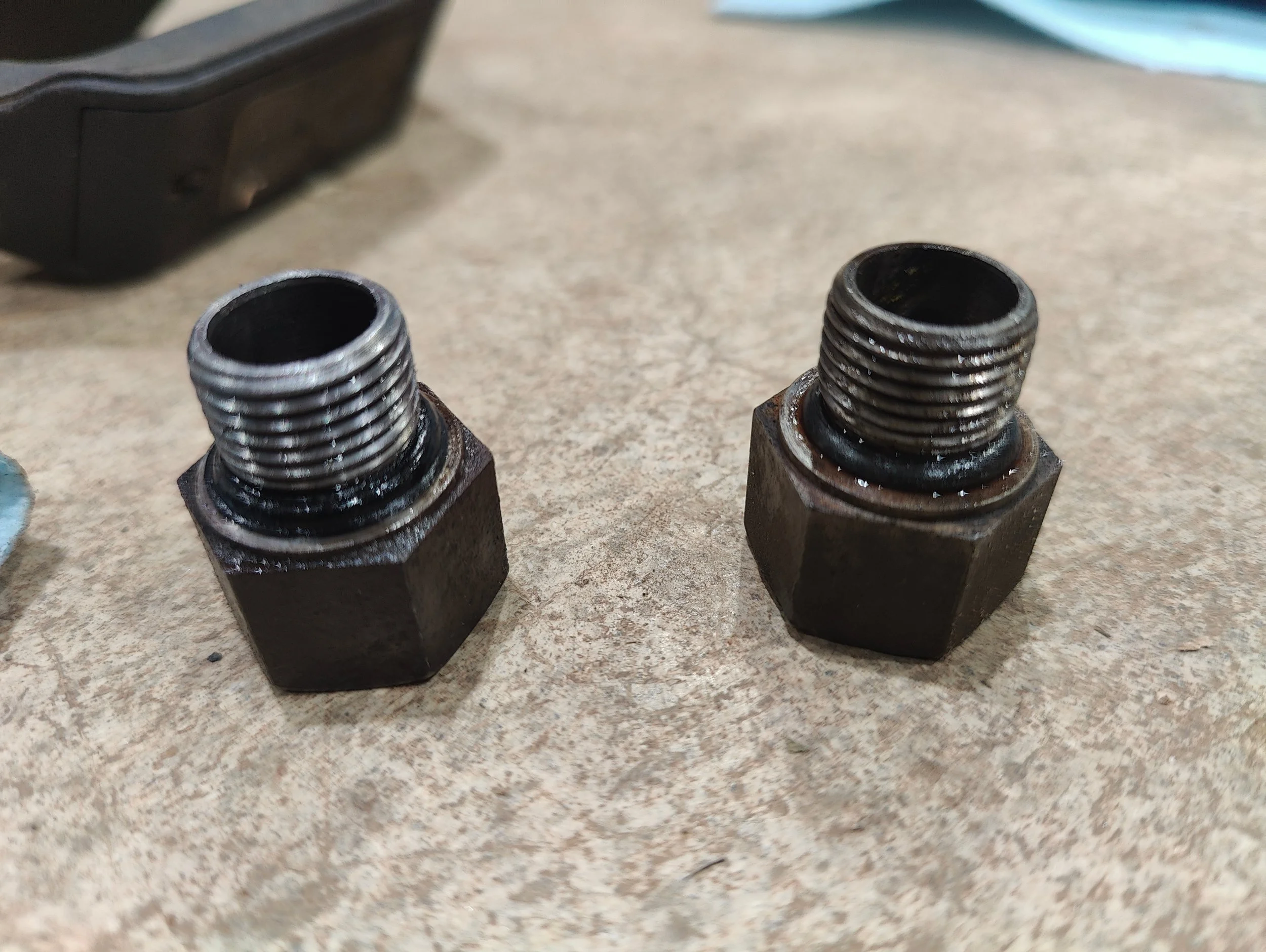

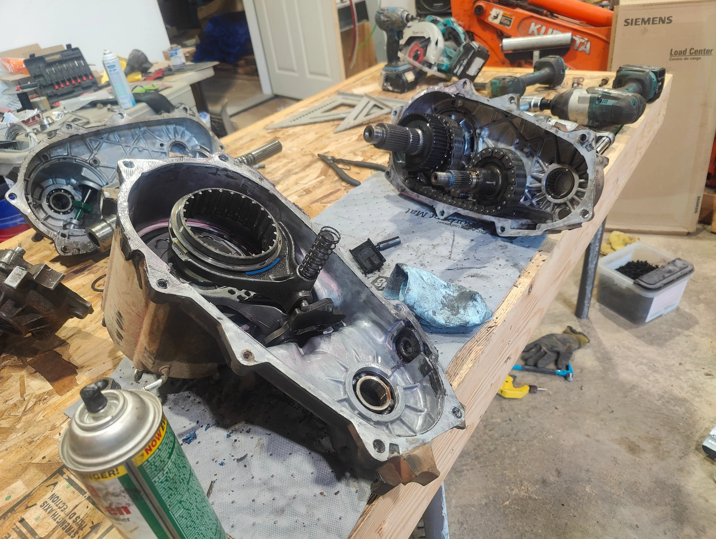

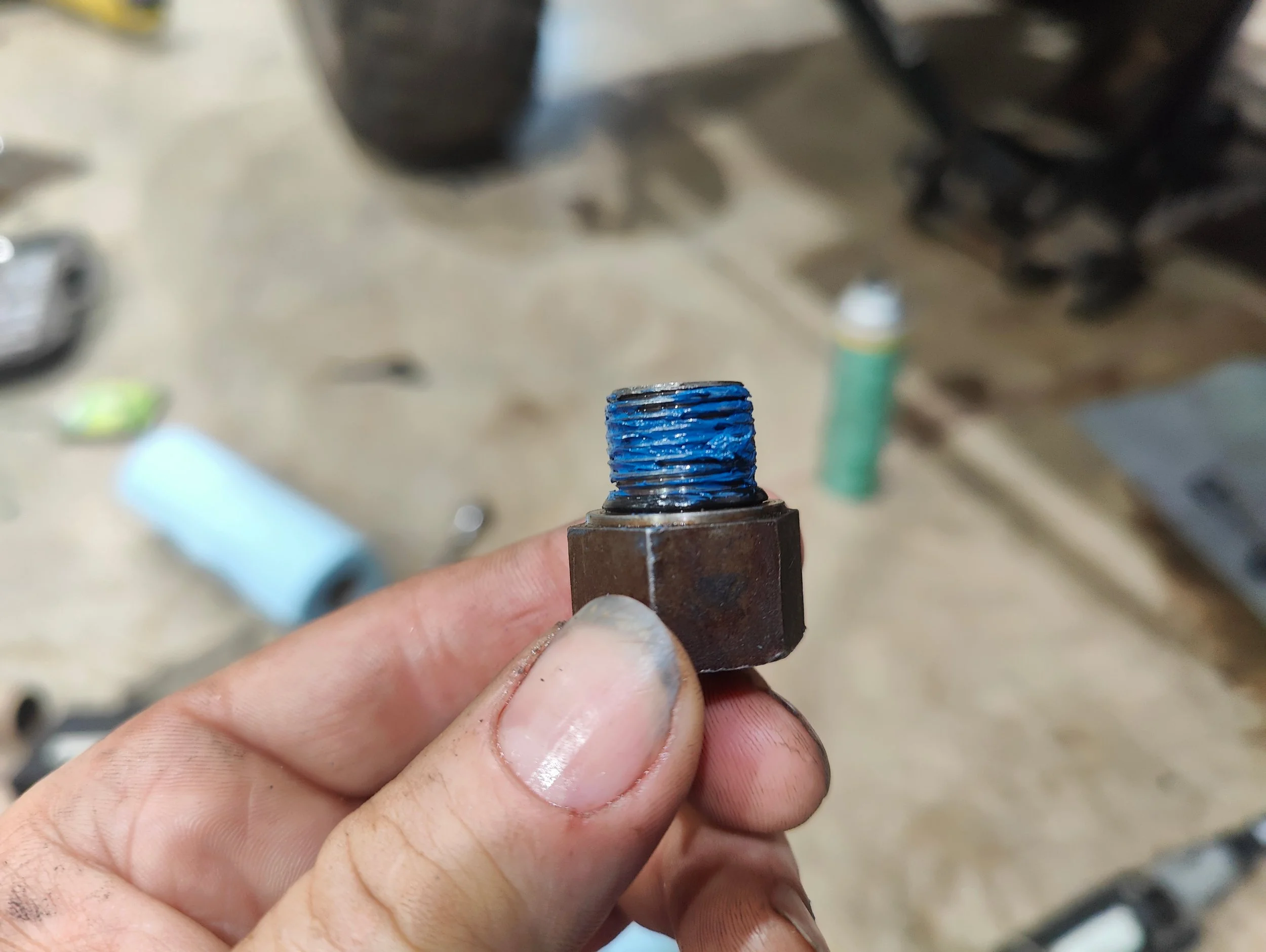

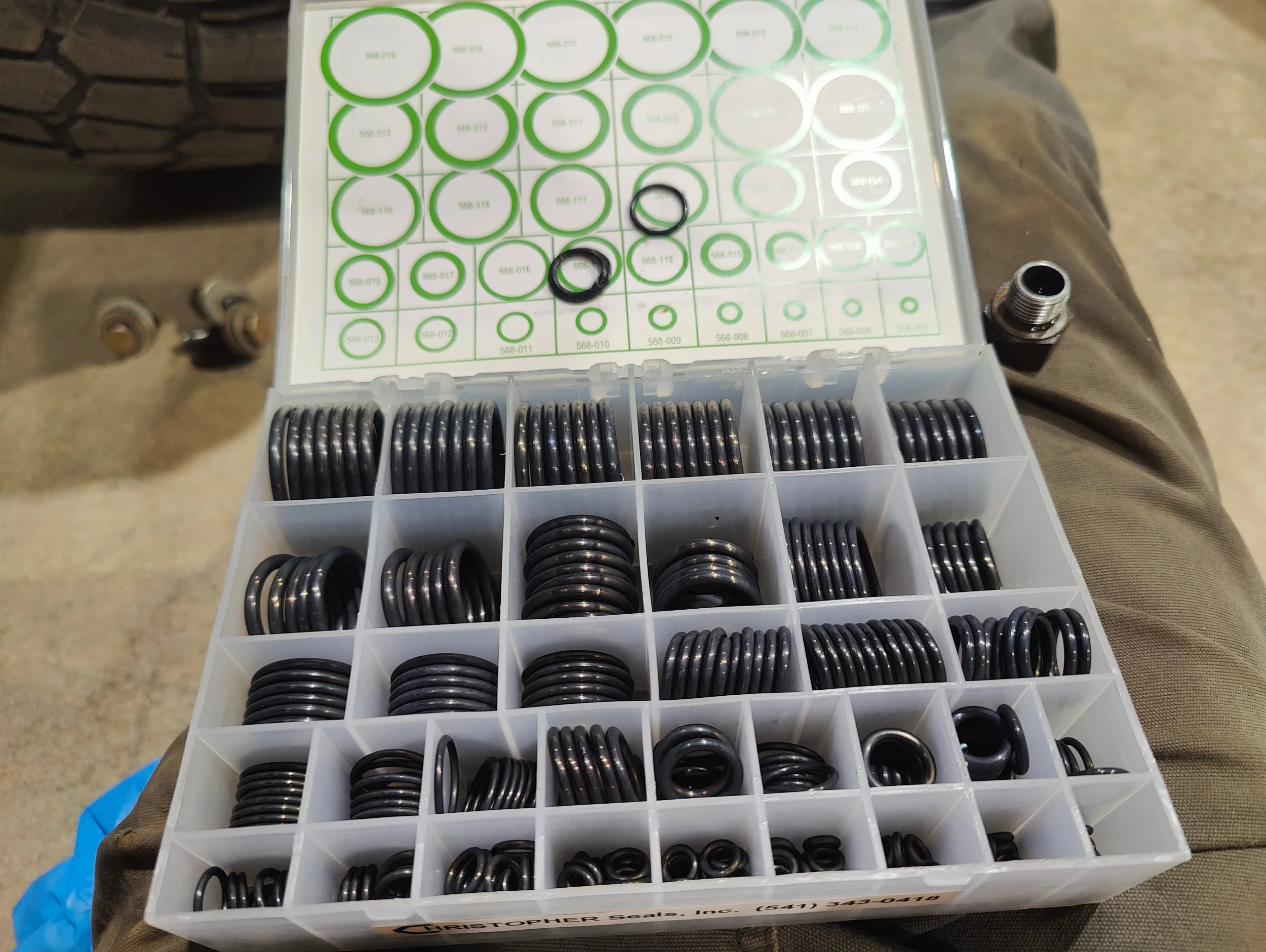

Pulled the skid, drained the case and tried a different skinnier o-ring. Fail. Still leaking. Tried the plan B transfer case plug w/original o-ring. Fail. Doped up the plug with RTV and didn't let it cure enough...also fail.

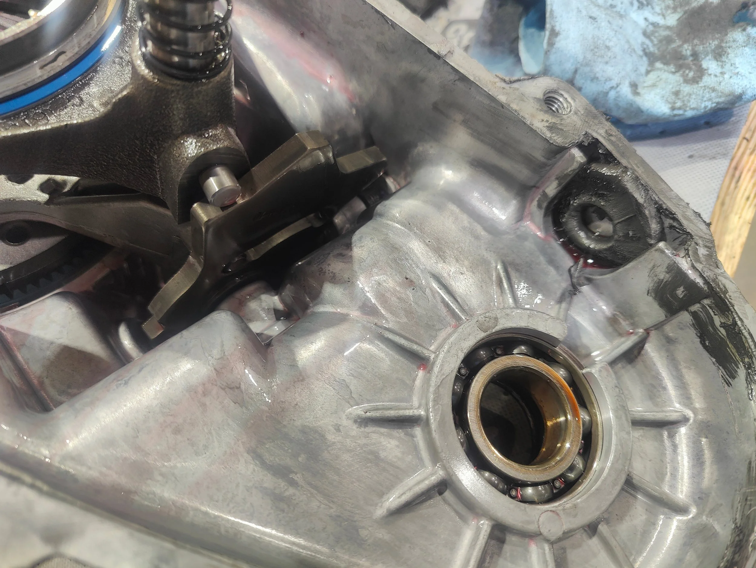

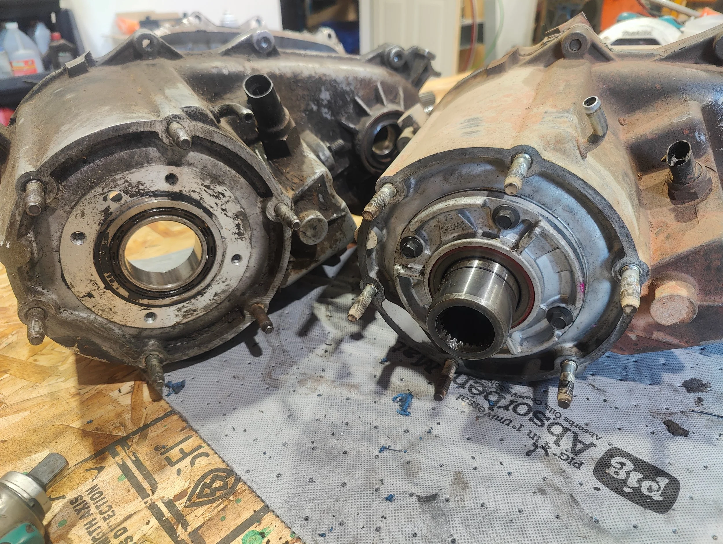

Pulled apart the plan B case. Looks to be a 92/93 casing. Front snout is completely different but the bolt holes line up with my parts.
Pulled my transfer case. Pulled it apart. Absolutely zero signs of a case crack inside. Worst thing I saw was my oil pump inlet screen clogged up with the plastic chunks of a failed speedo gear swap.
Completely at a loss here. No smoking gun.
Here's the plan. Going to put everything back together with Right Stuff. And hope after 16 attempts to get this to stop leaking it just does.

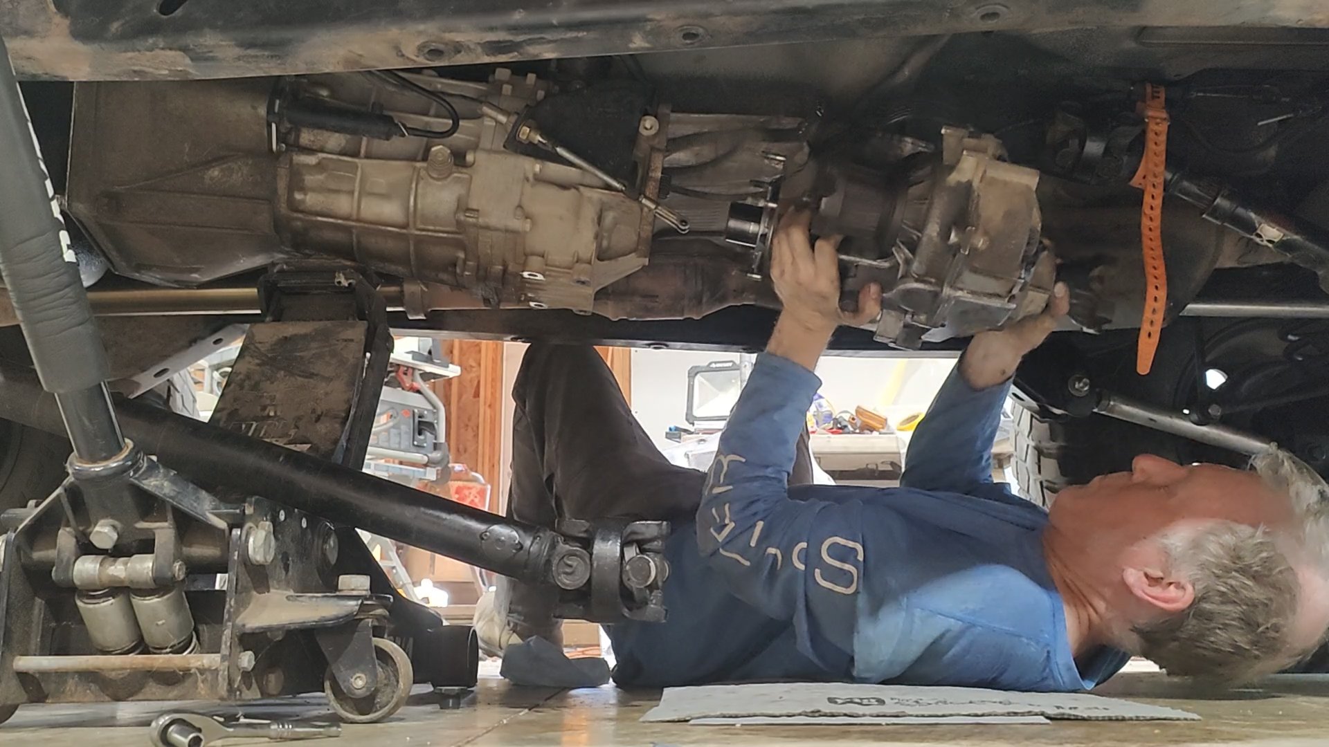

Got the case glued back together and back in the Jeep. Going to wait until tomorrow to fill it.
I leave Thursday morning for a six hour drive north and a weekend of wheeling. As long as I didn't make it worse I'll be fine even if I'm taping pig mats to the skid and carrying a gallon of ATF.

It's now primarily leaking from the detent spring holder...and I've tried two o-rings and blue RTV that sat for 20 minutes and didn't work...no surprise.
Case got split last night and glued together with Right Stuff. So did the detent screw...plan B screw with OEM o-ring. I'm 99 percent postive I don't have a cracked case.
