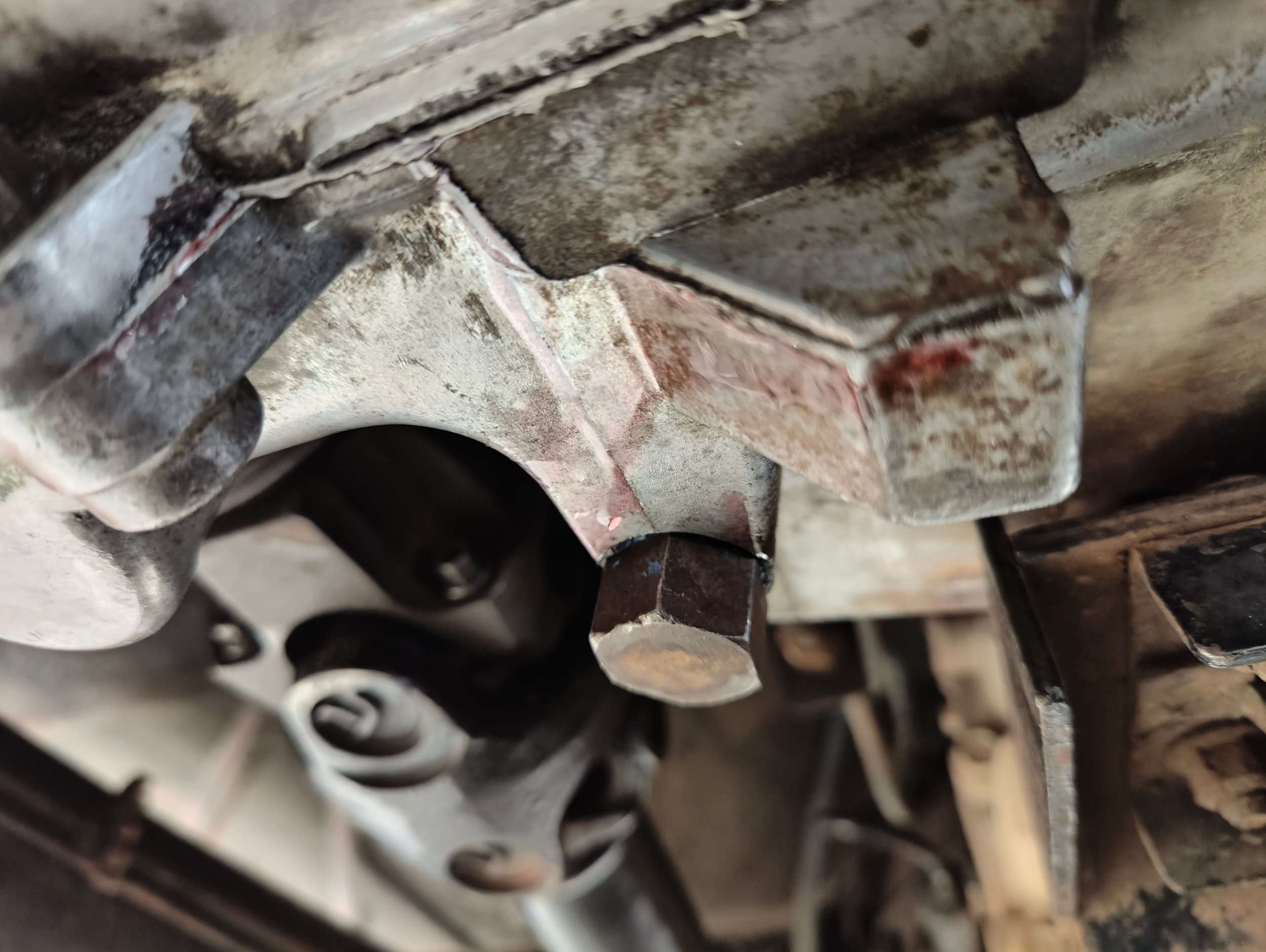

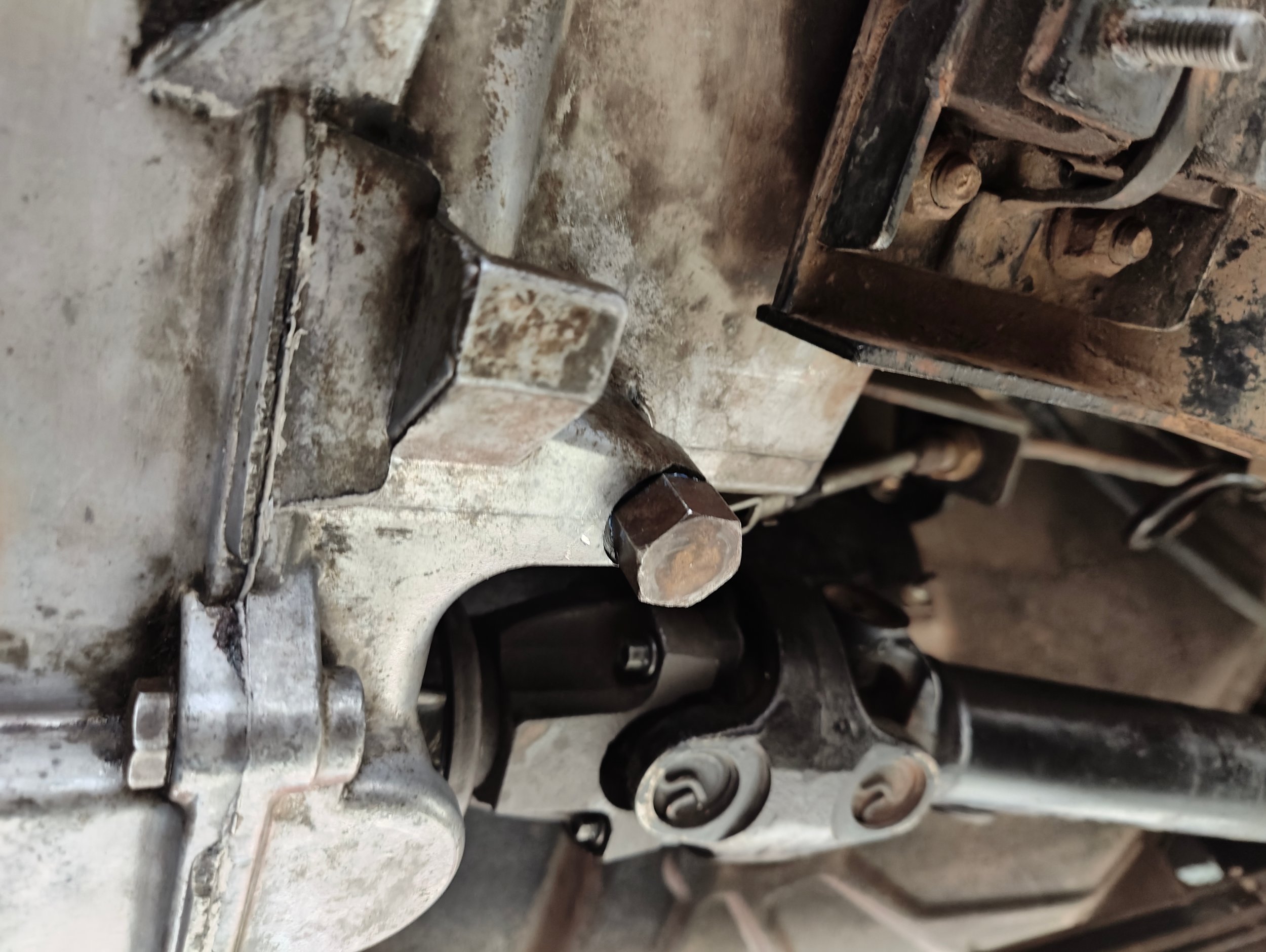

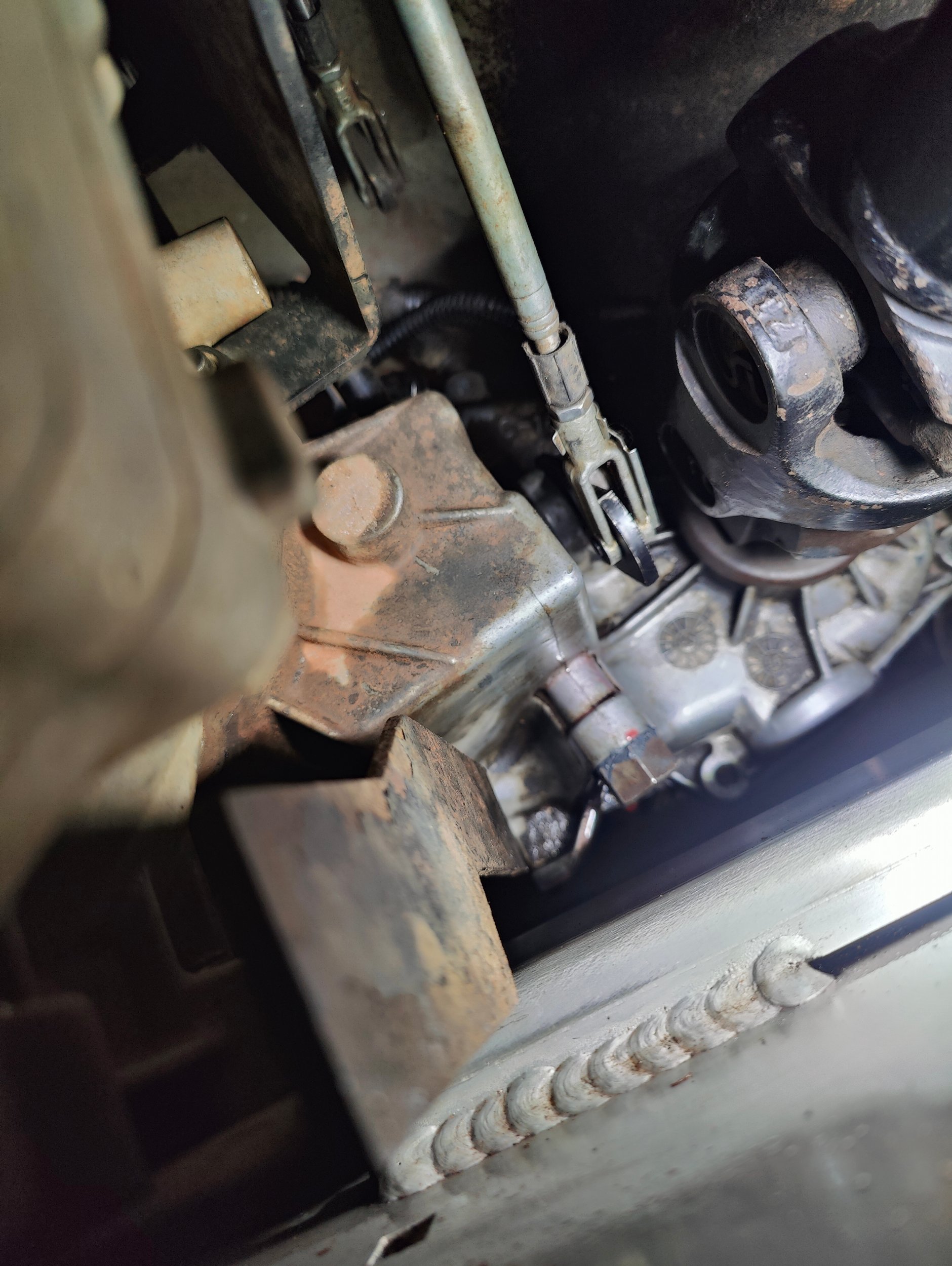

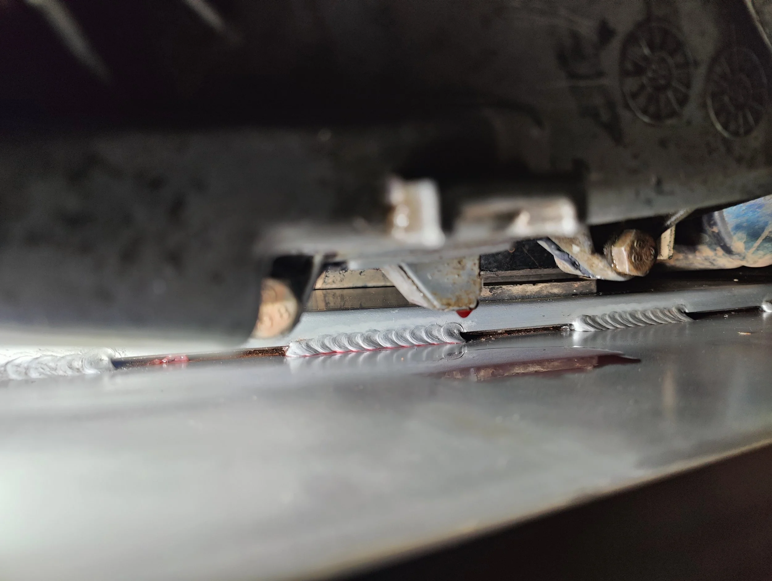

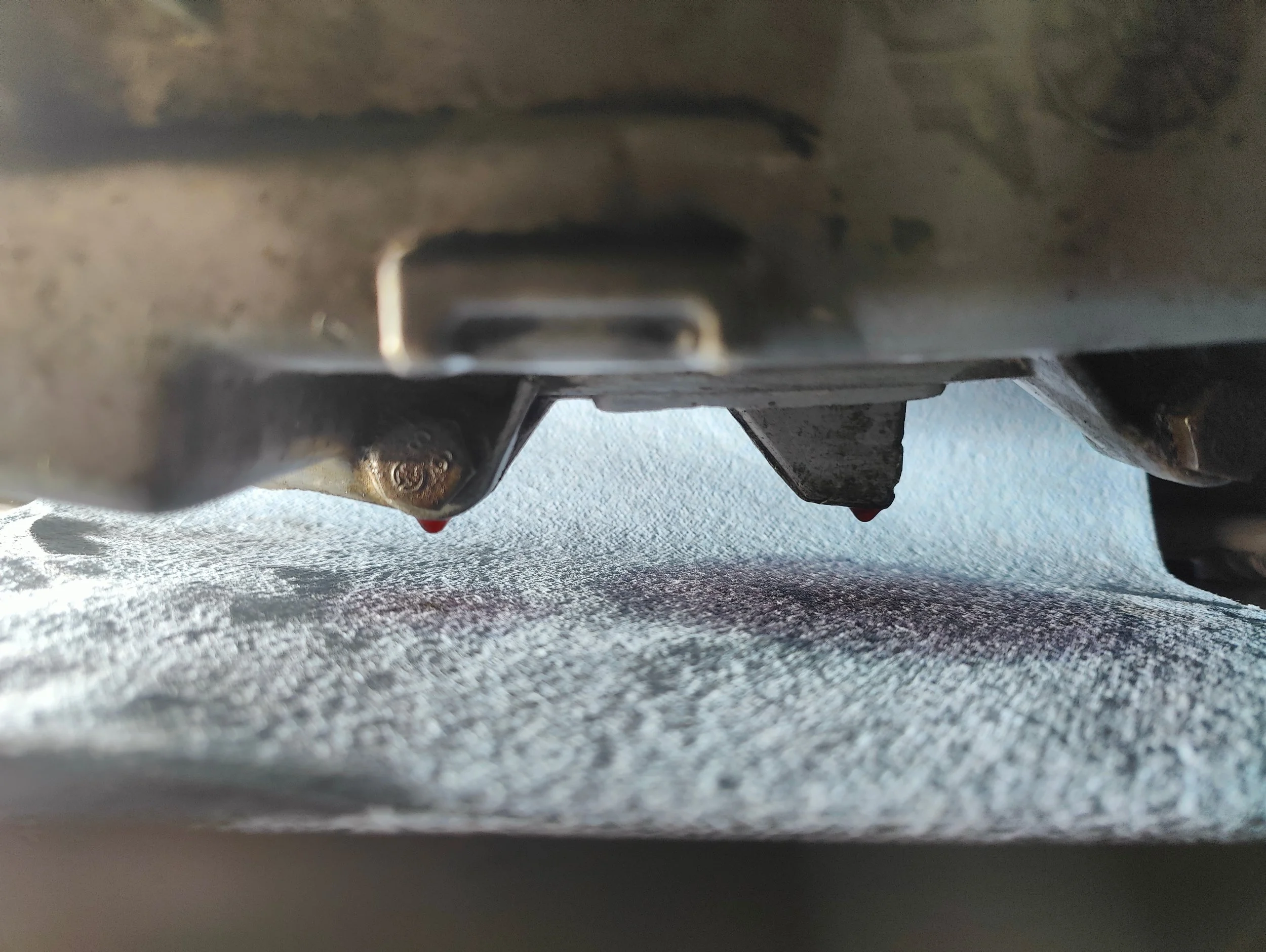

Still leaking. Done with this case in it's entirety.
Should be good enough for the weekend.
Anybody ever use power steering stop leak in a transfer case?
It's got to be a cracked front case.
View attachment 629168View attachment 629169
-Mac
The adding of Stop Leak usually swells O rings and applies a coating of sort inside.
I would be worried whether this would obstruct the fine screening for the pump pickup.

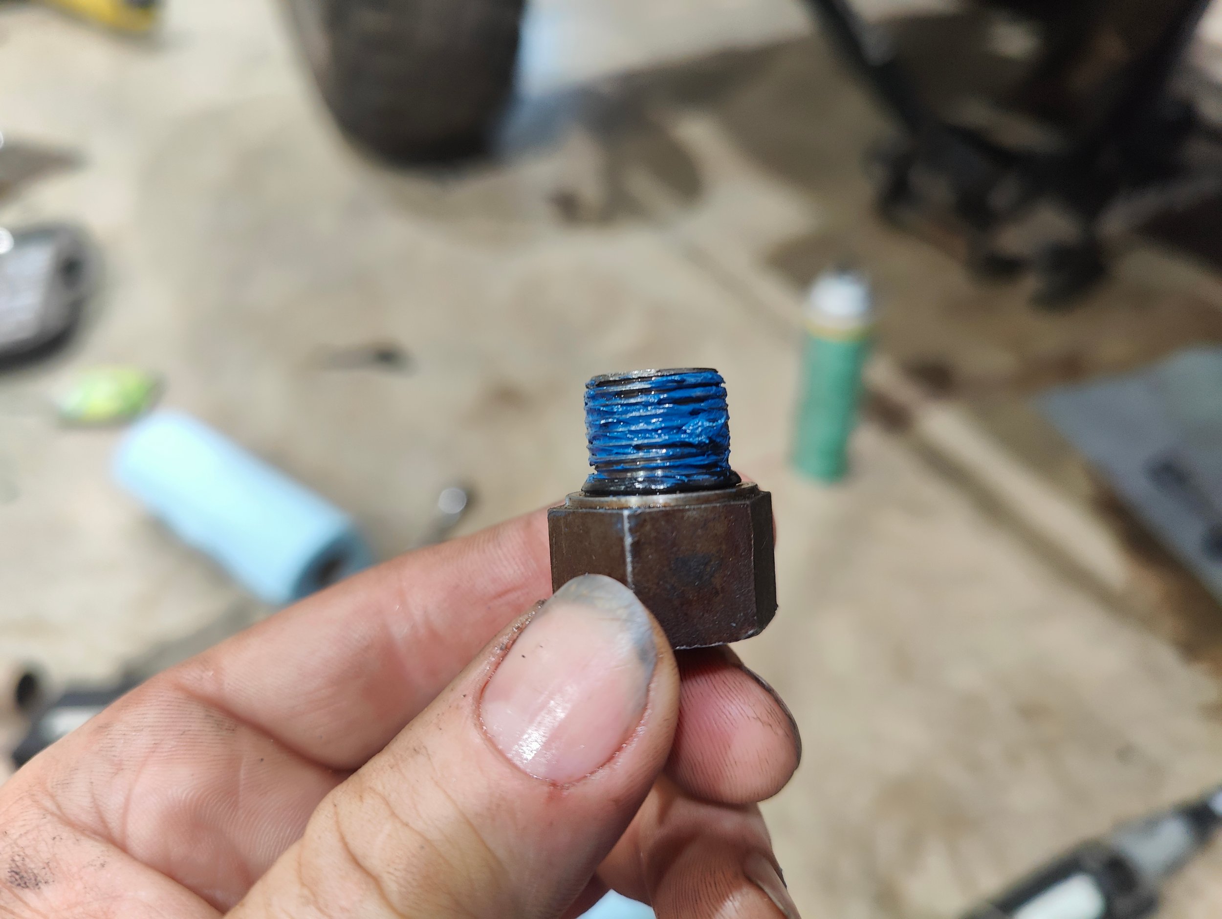

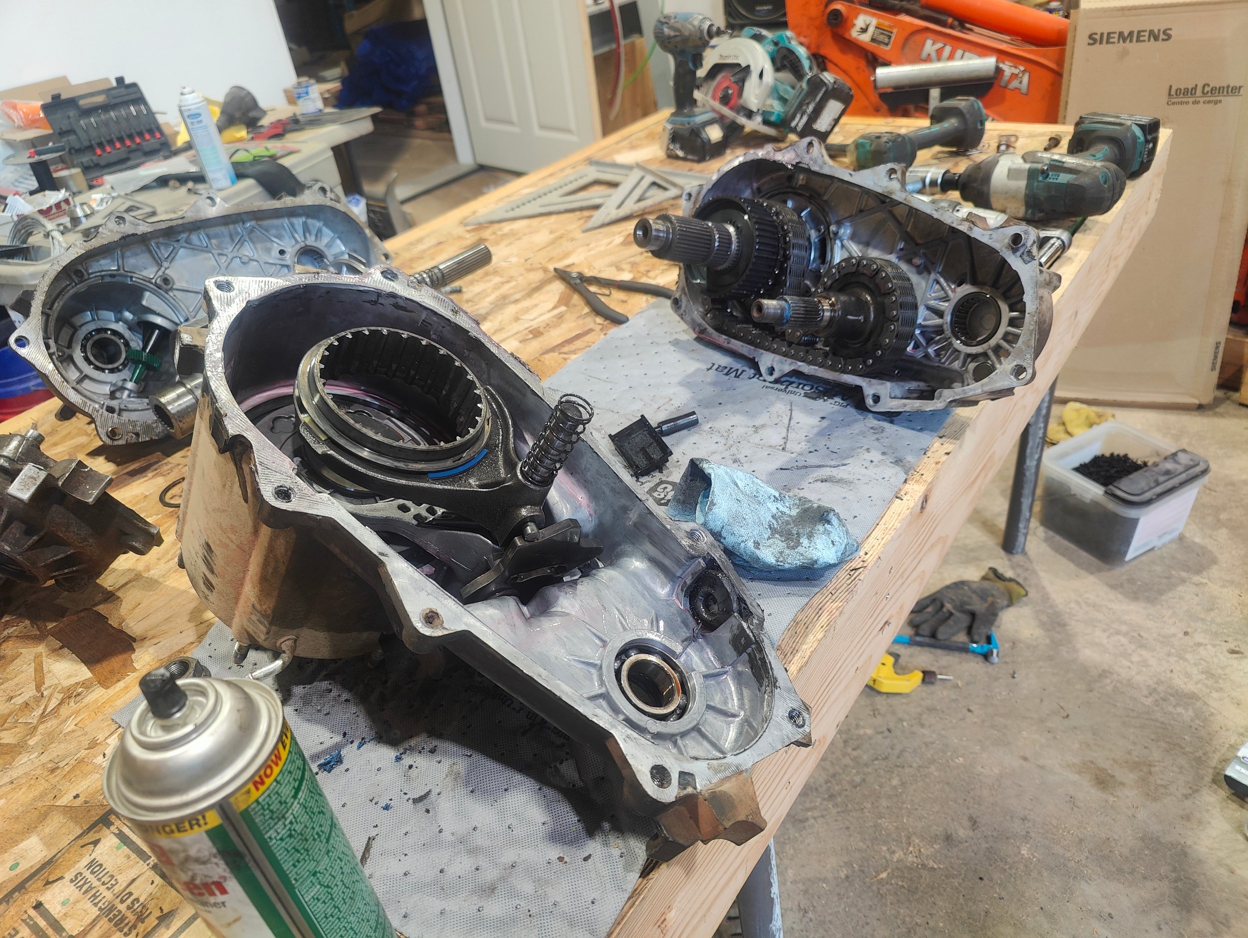

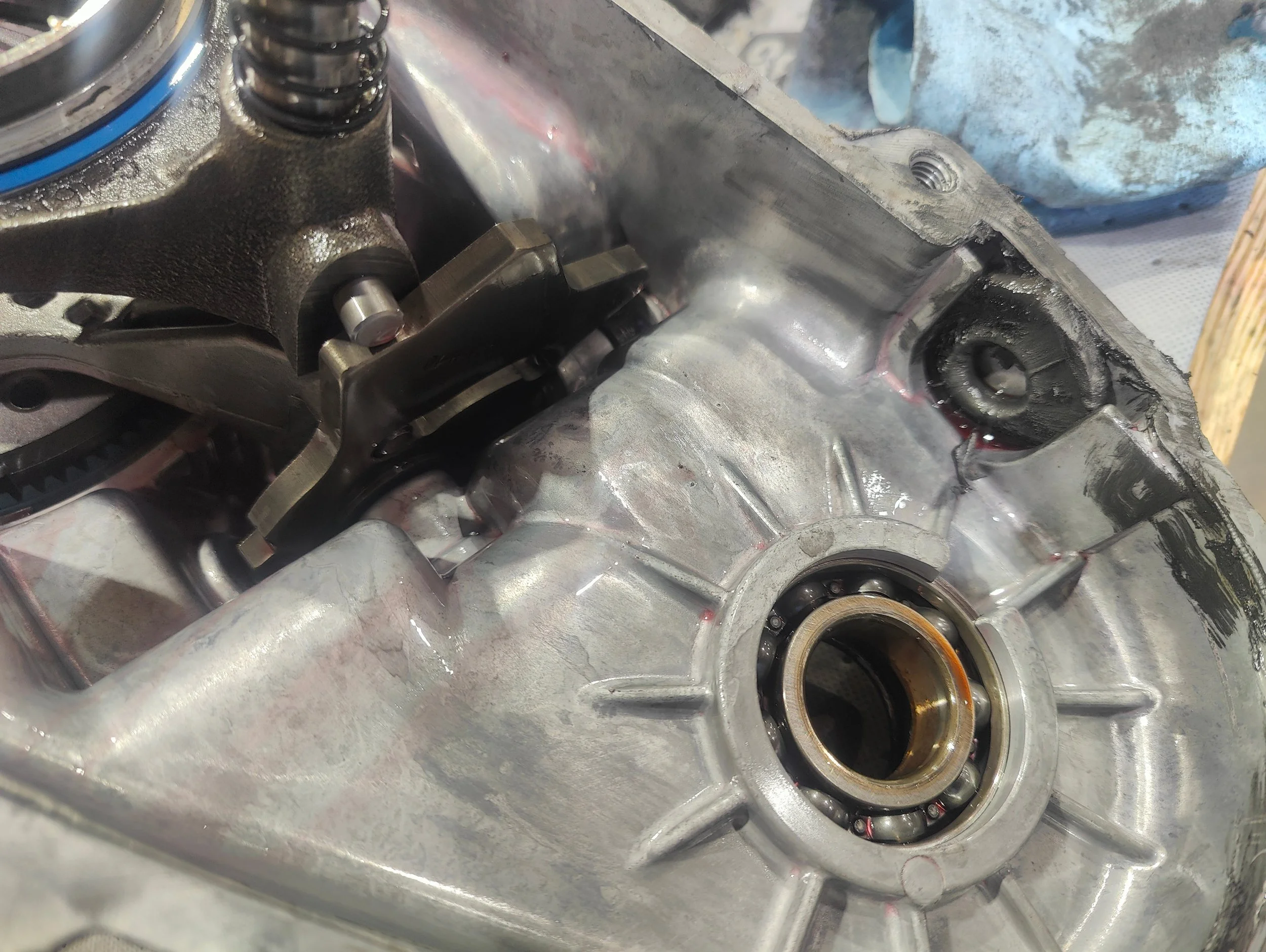

Ok...been a long couple of days.

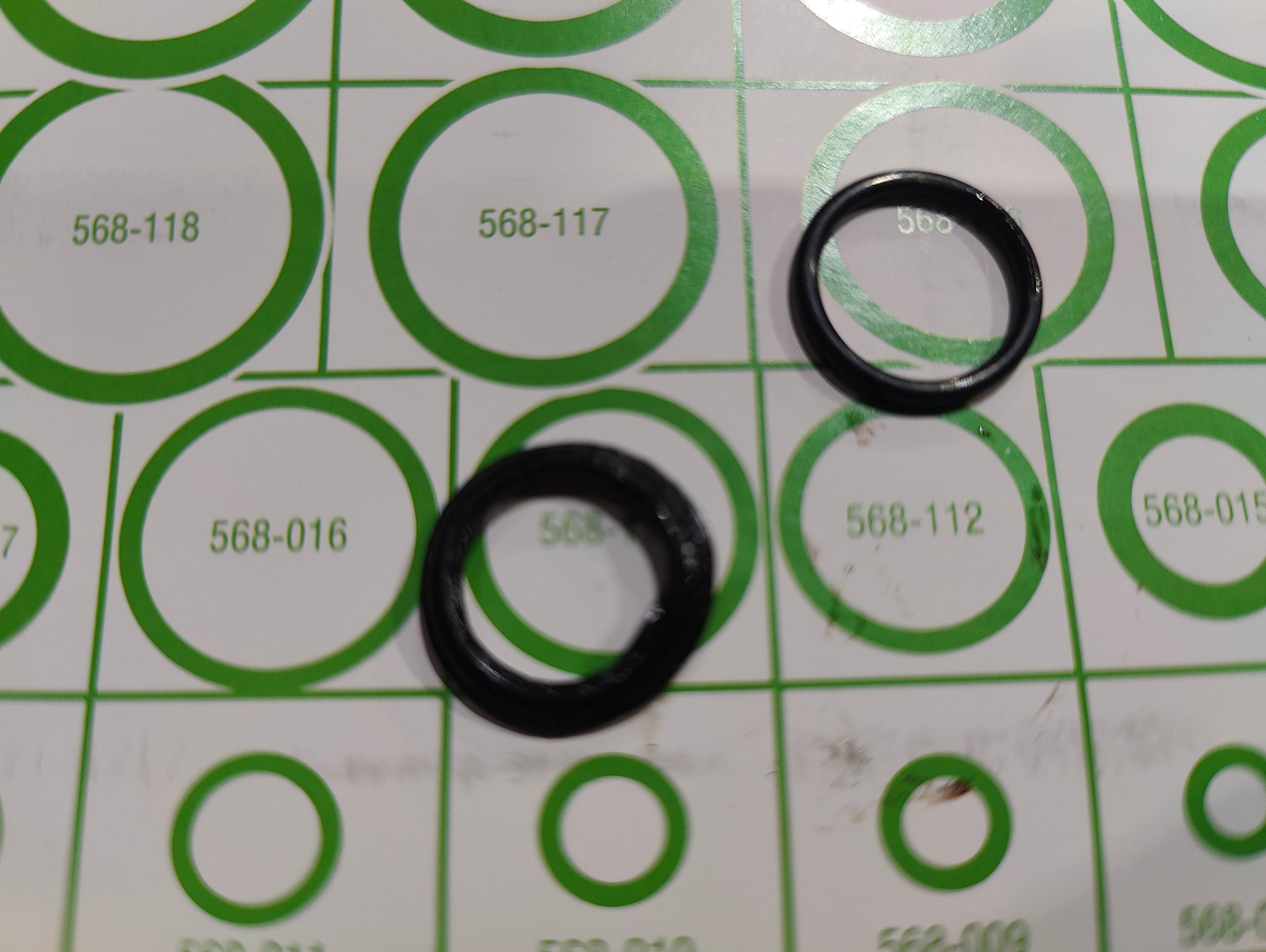

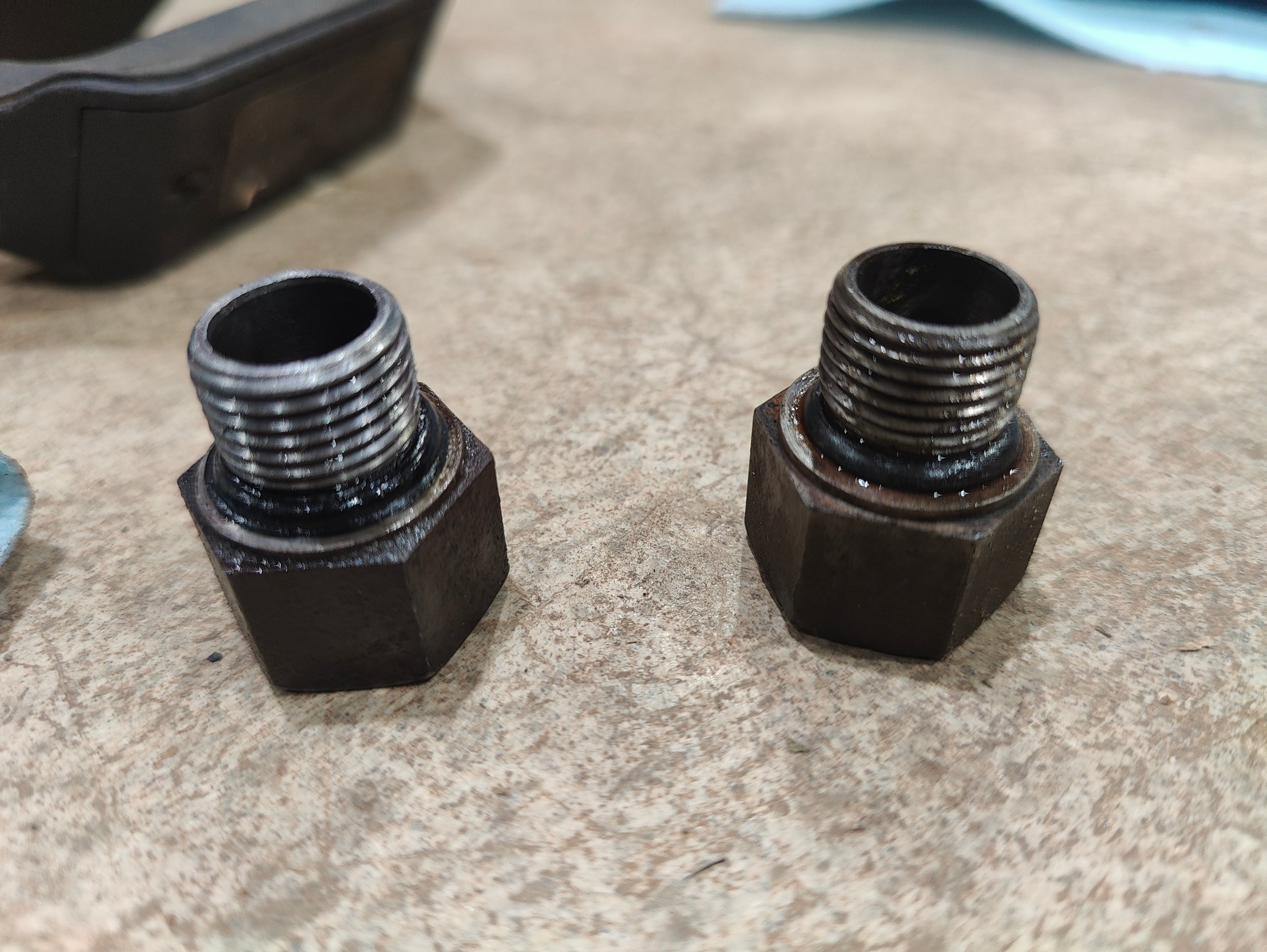

Pulled the skid, drained the case and tried a different skinnier o-ring. Fail. Still leaking. Tried the plan B transfer case plug w/original o-ring. Fail. Doped up the plug with RTV and didn't let it cure enough...also fail.

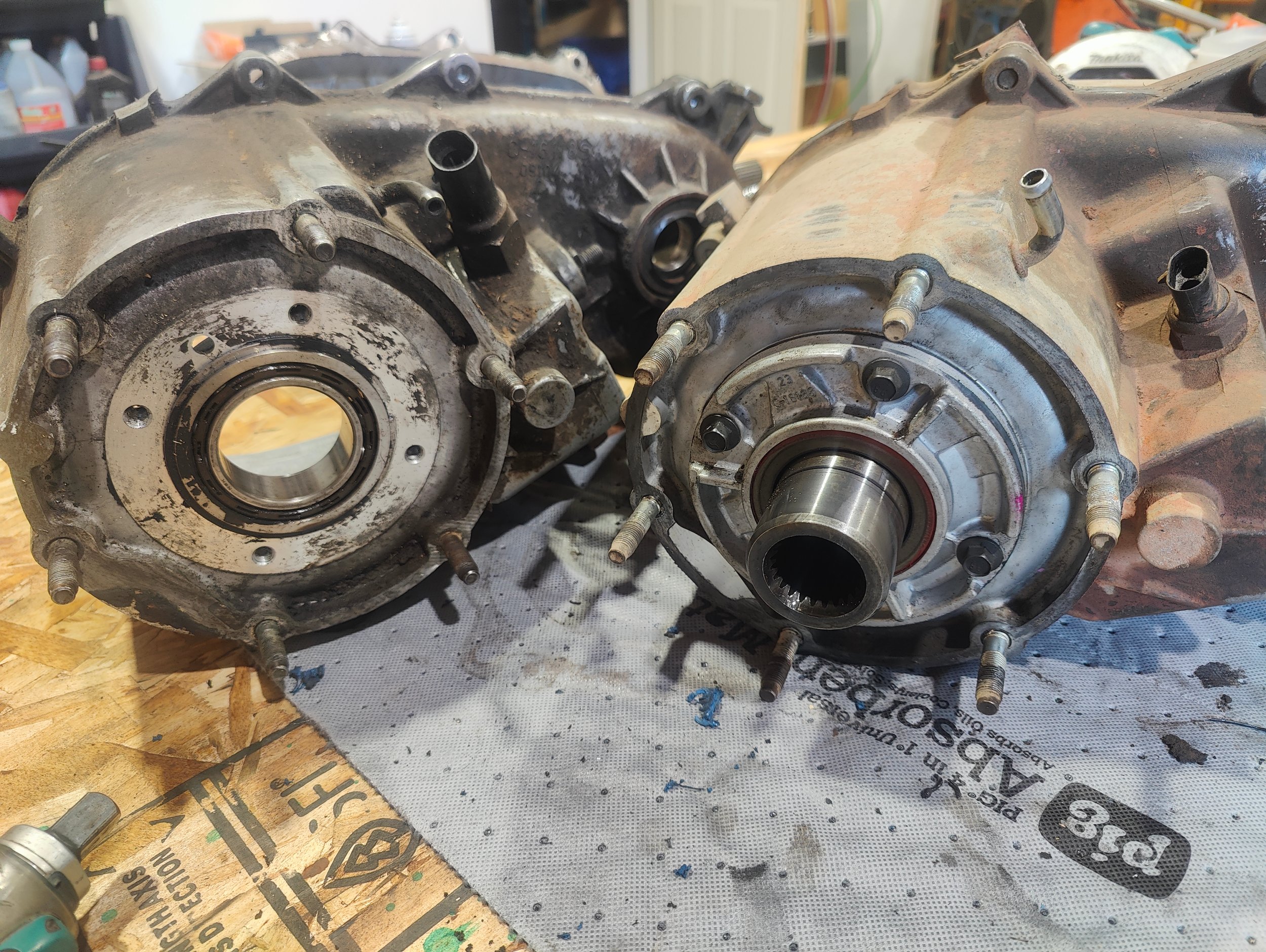

Pulled apart the plan B case. Looks to be a 92/93 casing. Front snout is completely different but the bolt holes line up with my parts.
Pulled my transfer case. Pulled it apart. Absolutely zero signs of a case crack inside. Worst thing I saw was my oil pump inlet screen clogged up with the plastic chunks of a failed speedo gear swap.
Completely at a loss here. No smoking gun.
Here's the plan. Going to put everything back together with Right Stuff. And hope after 16 attempts to get this to stop leaking it just does.
View attachment 628976View attachment 628979View attachment 628981View attachment 628982View attachment 628983View attachment 628984View attachment 628985View attachment 628986View attachment 628987View attachment 628988View attachment 628989View attachment 628990
-Mac
I don't know if I'm late to the party but the planetary gears are cut differently starting around 95? Be careful to keep the sun ring and planetary together respectively. Aside from any bearing differences. As to you last Pic it sure looks like a Crack. Can you pressurize the case and spray soapy water on that potential crack?
Drove ~500 miles up to Washington and back. Clipped pig mats under the transfer case and added 1/2 to 3/4 quart of ATF, and changed out the soaked pig mat and wiped up stuff that sprayed off the front driveshaft.
Fill plug was ungodly hot.
Made it to our campground just outside Yakima, WA Thursday night. Made camp, spent the night...swapped out the soaked pig mat, etc etc in the morning.
We drove 50 hard miles that day...40 was pretty rough...4-5 level trail, tons of dust... almost all in 4 low first gear. Checked the pig mat twice during the day and again when we got back to camp around 8 pm.
Dry. Not a single leak. Pulled the fill plug and ATF came out... slightly overfull as I had left it. What the hell?

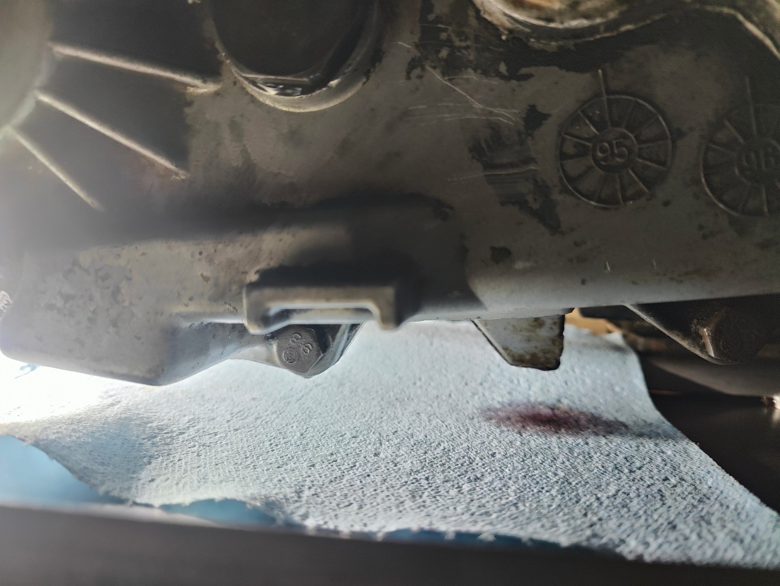

Drove all the way home today. Didn't check the level when filling up. Pig mat soaked. ATF dripping on the shop floor.
Took the IR gun to the case...most of it was 200, but the center and tail shaft were 220 to 230 degrees.
As an aside I checked the cat...200 before, 380 after...90 degrees on the aluminum skid underneath. When wheeling I left a 3L water bladder on the passenger floor and took a warm shower when we got back to camp...going to get a shower bag and do that more often.
So, no clue what's going on. Going to let things cool off and pull it again tomorrow and see if I can use this 92/93 front case half to replace the front. Also going to replace the front yoke...maybe it's out of round and distorting the seal.

Sounds like the pumps not working and the case is cracked, but your symptoms are pretty weird and still questions remaining.
