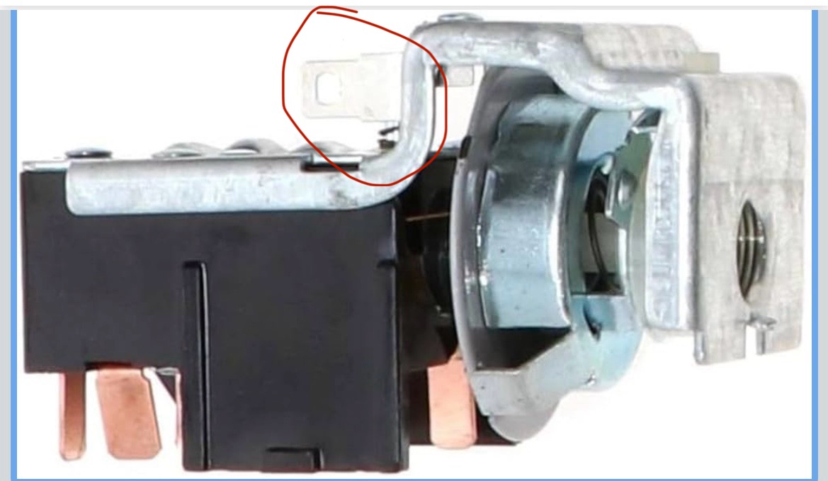

Can't remember where single black wire near light switch plugs in!
carmangary
Aug 19, 2020
52
North Carolina
I replaced my dash wiring harness today. Near the light switch connector is a single black wire with a connector on it. I cannot find the place to plug this in. I remember disconnecting this when I removed the old harness but I can't find the connector now. It is somewhere in the steering column/light switch area. If someone know, PLEASE help! Thanks in advance.
I think it goes on the switch itself. Circled in red. Just replaced mine few months ago and there was a single black wire that went on it. My is a 97.
