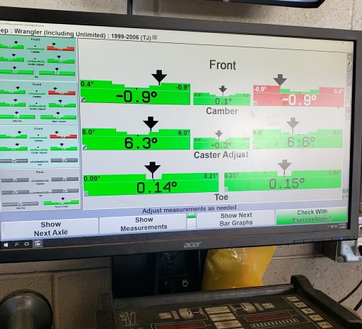

Finally, what is your current caster angle?
Did they adjust the caster at all. Looks like you may have cam bolts on the lowers maybe? Do you have a before and after print out?
I’m thinking caster was changed
The drop bracket for track bar is now welded so that’s going to stay. I can try to get a different pitman arm with less drop! Any suggestions as to which one to get? Website? Links? Also the caster is …..

Your 6.3-6 caster angle is fine, that much caster would cause very stable steering.
Exactly (!) what is your current tire pressure?
The readings I see on the alignment read out do show 6.3-6 caster angle which would be fine, IF that's really what his TJ has.
Looking at the camber read out both of those tires are leaning in 3/8 of an inch or maybe more.
-0.9 degrees
X .017 inch per 1 degree
X 25 the distance I used between where the sidewalls of the 35 inch tire bulges out
= -.3825 inches
To me if that read out is correct that TJ would have a problem that I'd call a rice burner stance.
