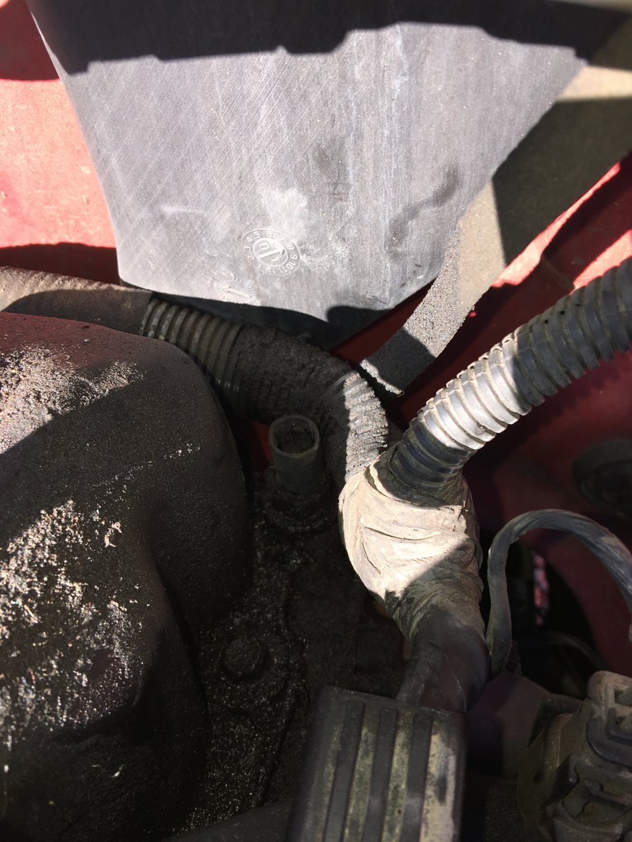

Don't assume the worst....; a little searching around the engine compartment may reveal the problem.
Check the wiring harness that provides communications between the PCM and the engine sensors. There is a split wire loom harness that goes around the back of the valve cover and is routed around a threaded head stud (right rear corner) which is known to come in contact with the threads and rub thru the plastic wire loom and wiring insulation causing electrical shorts to ground.
My solution to ensure this problem doesn't occur; was to slide a spark plug boot over the threaded stud.
