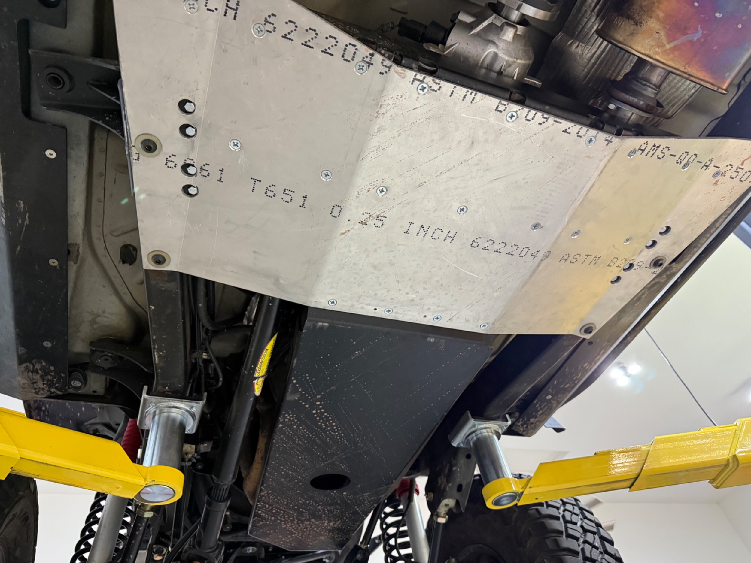

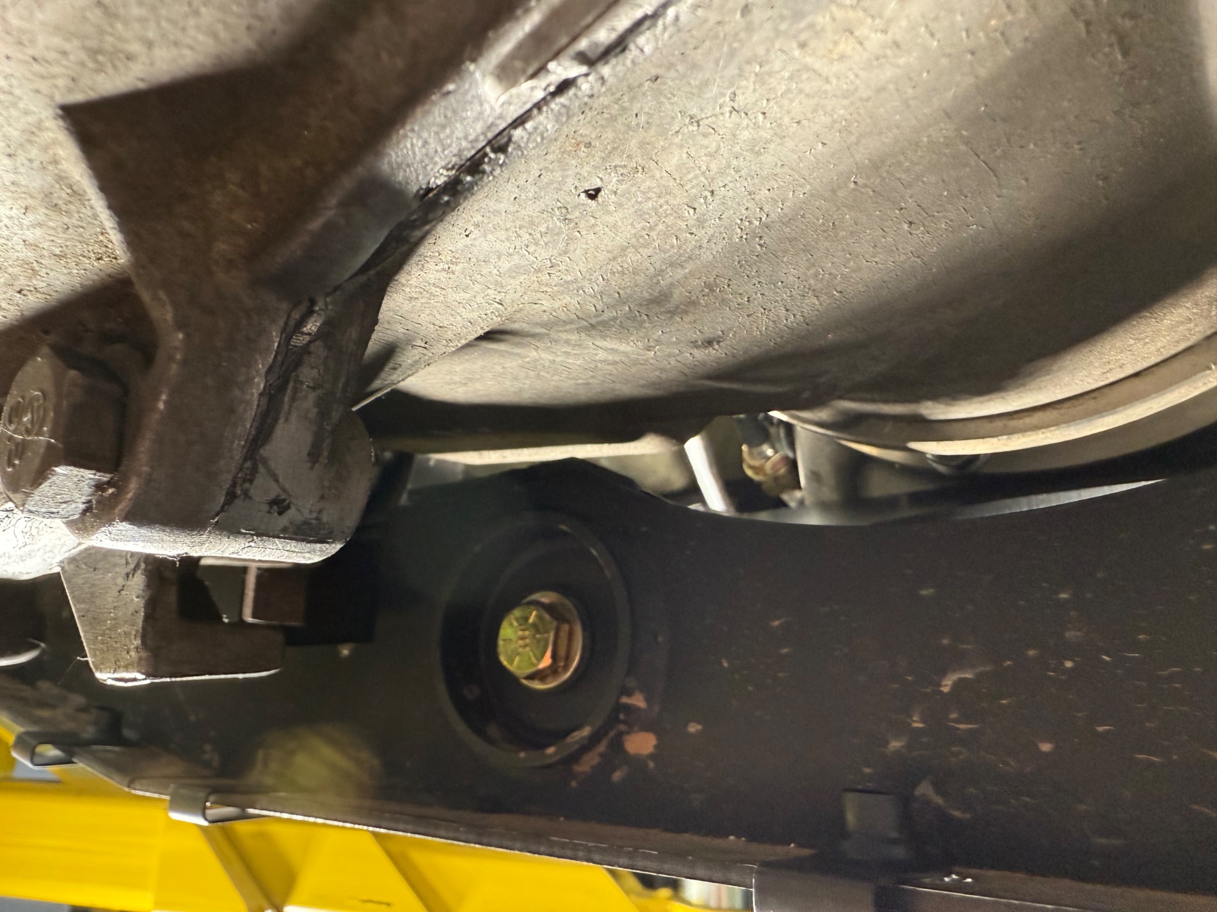

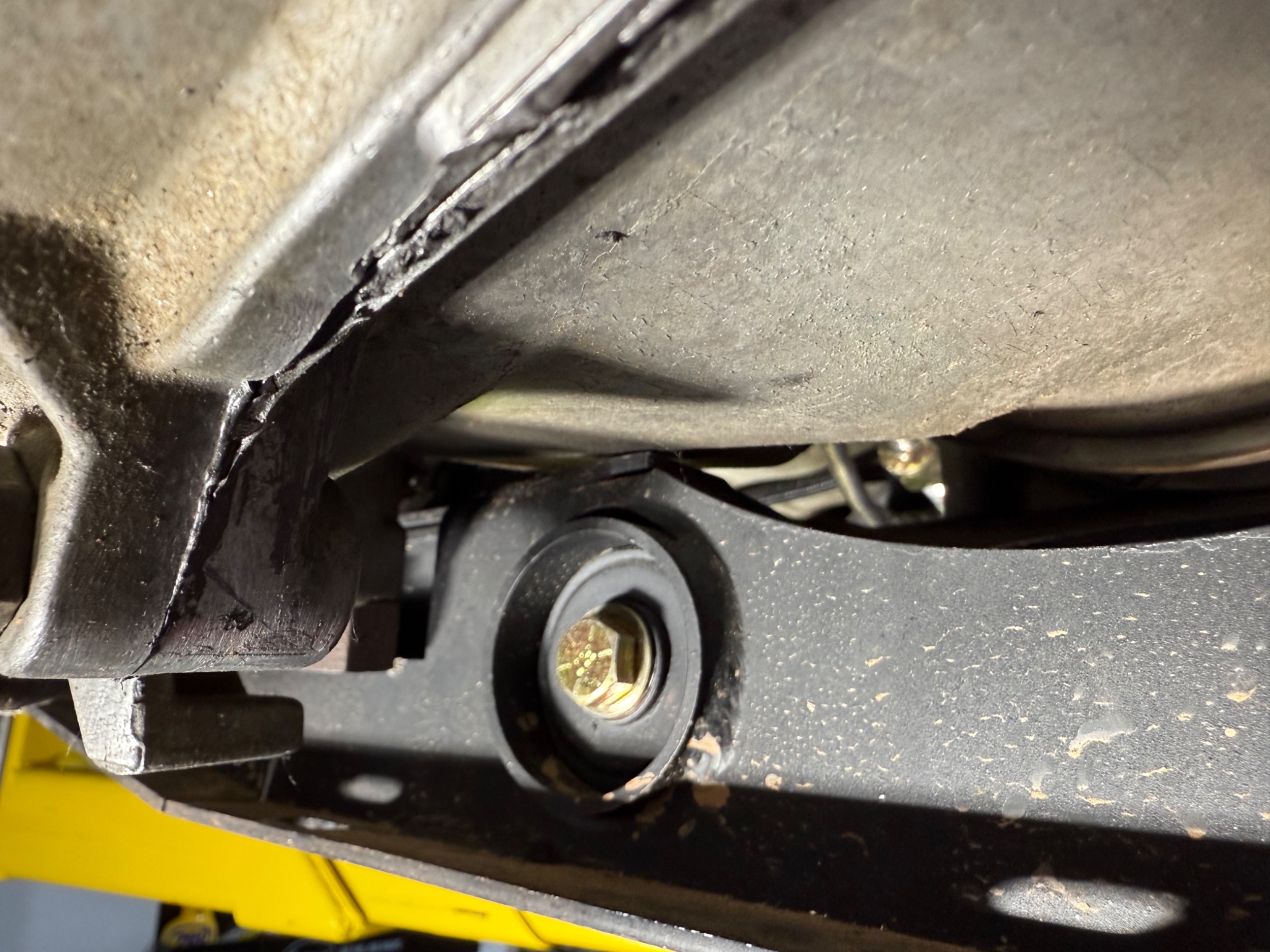

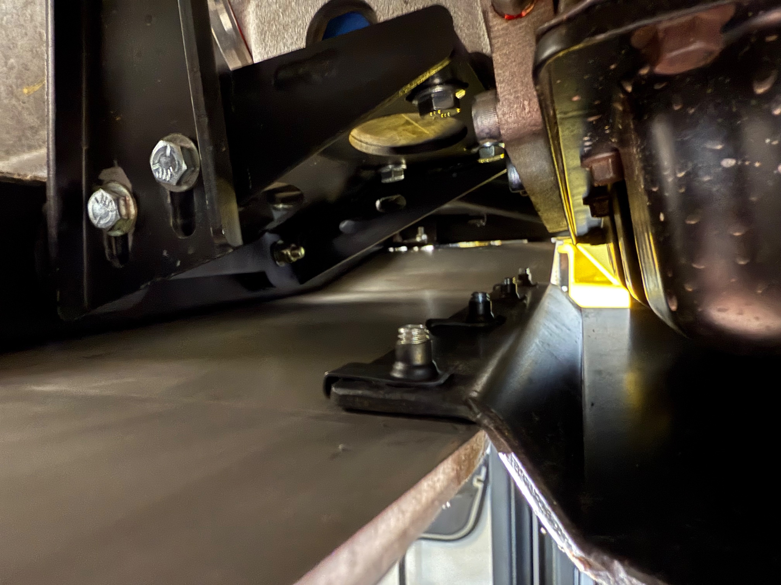

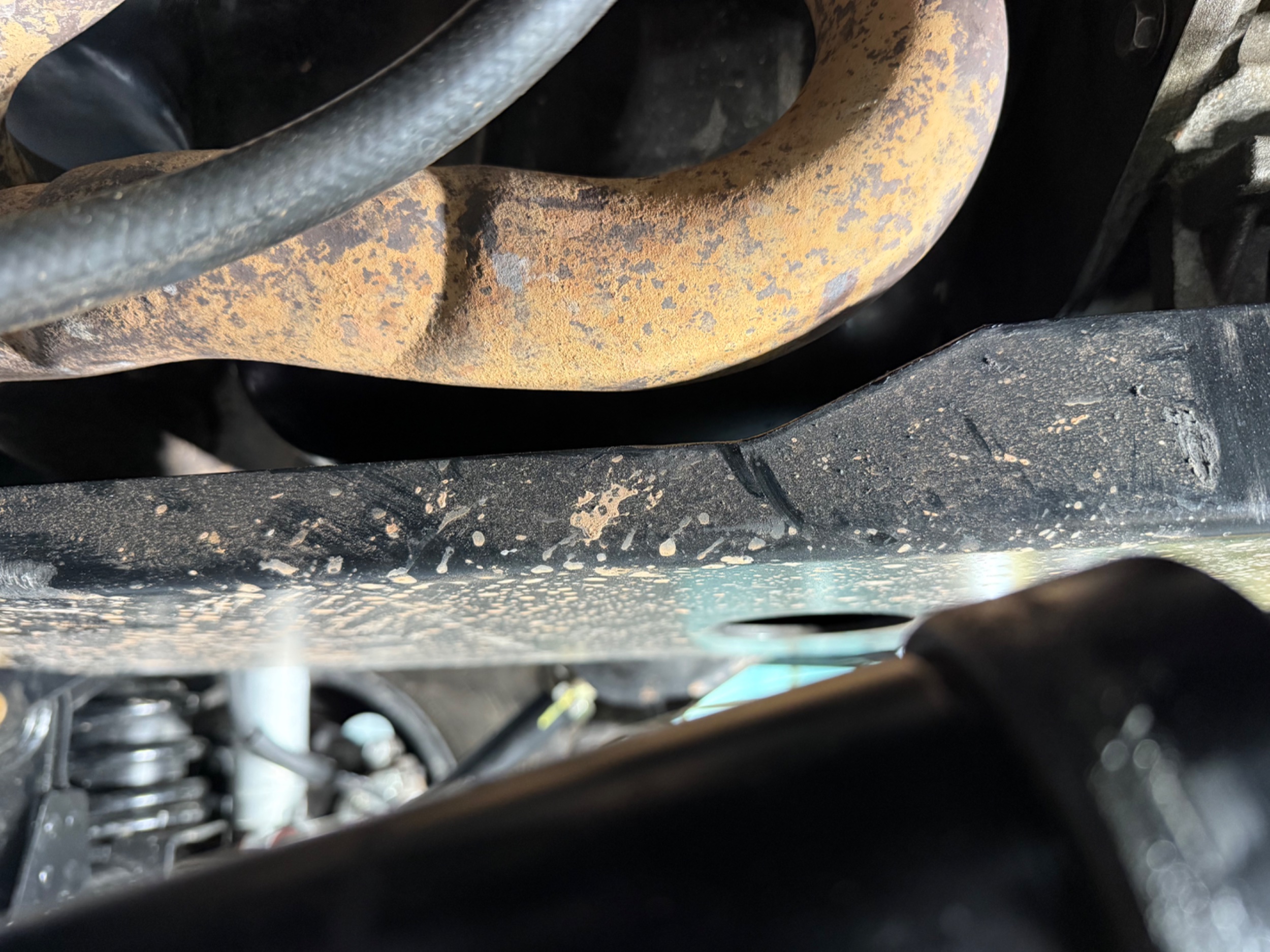

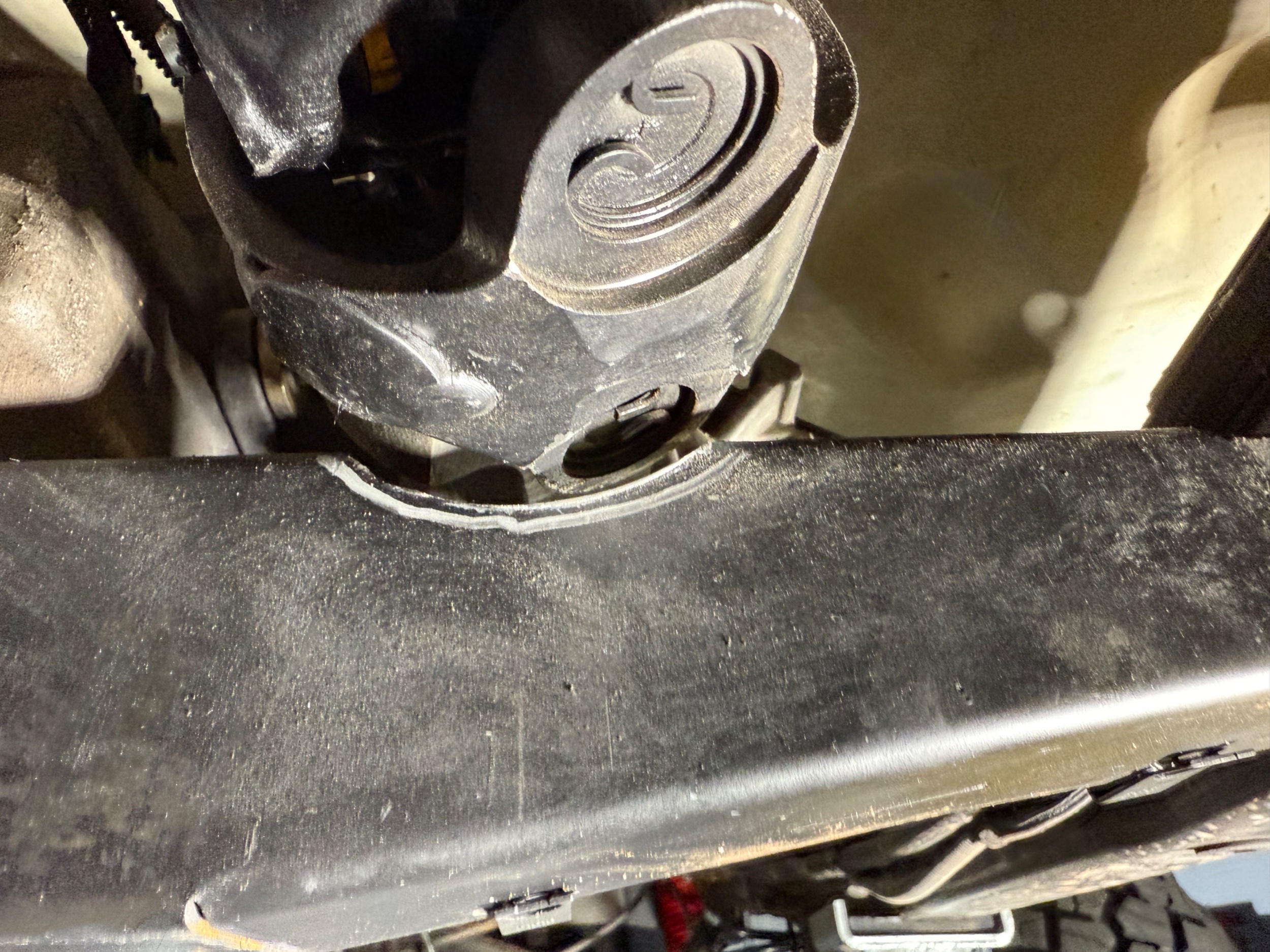

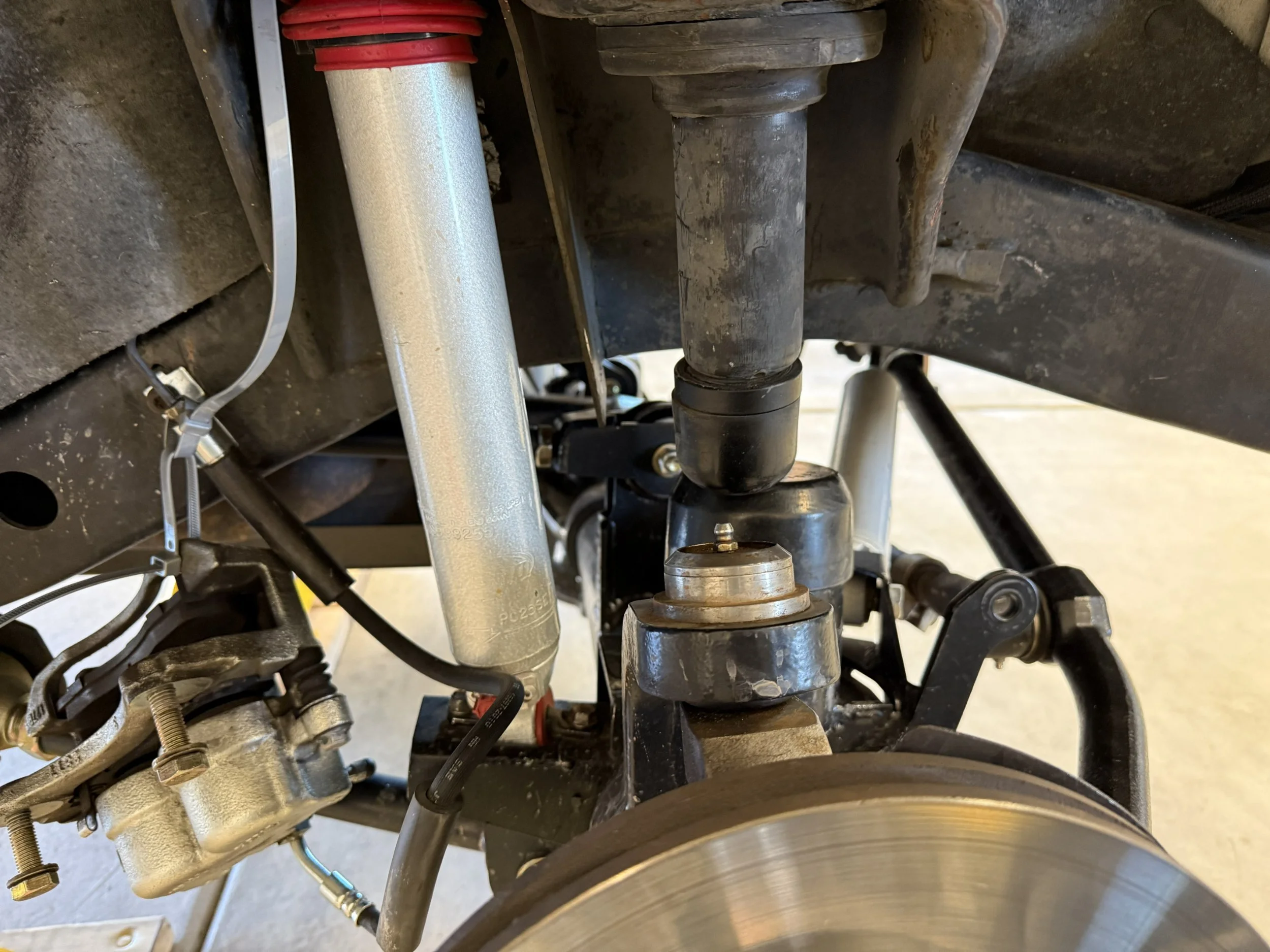

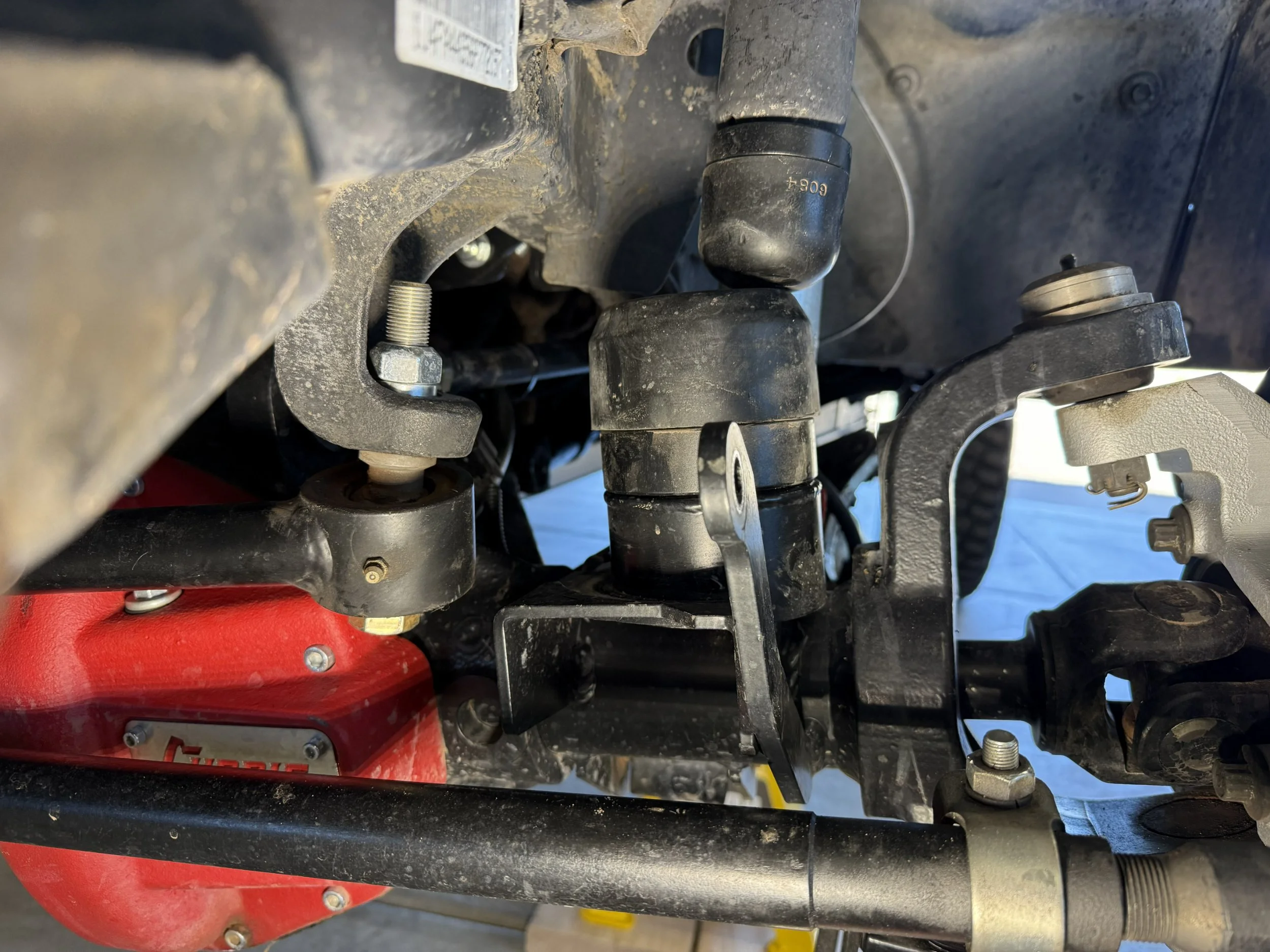

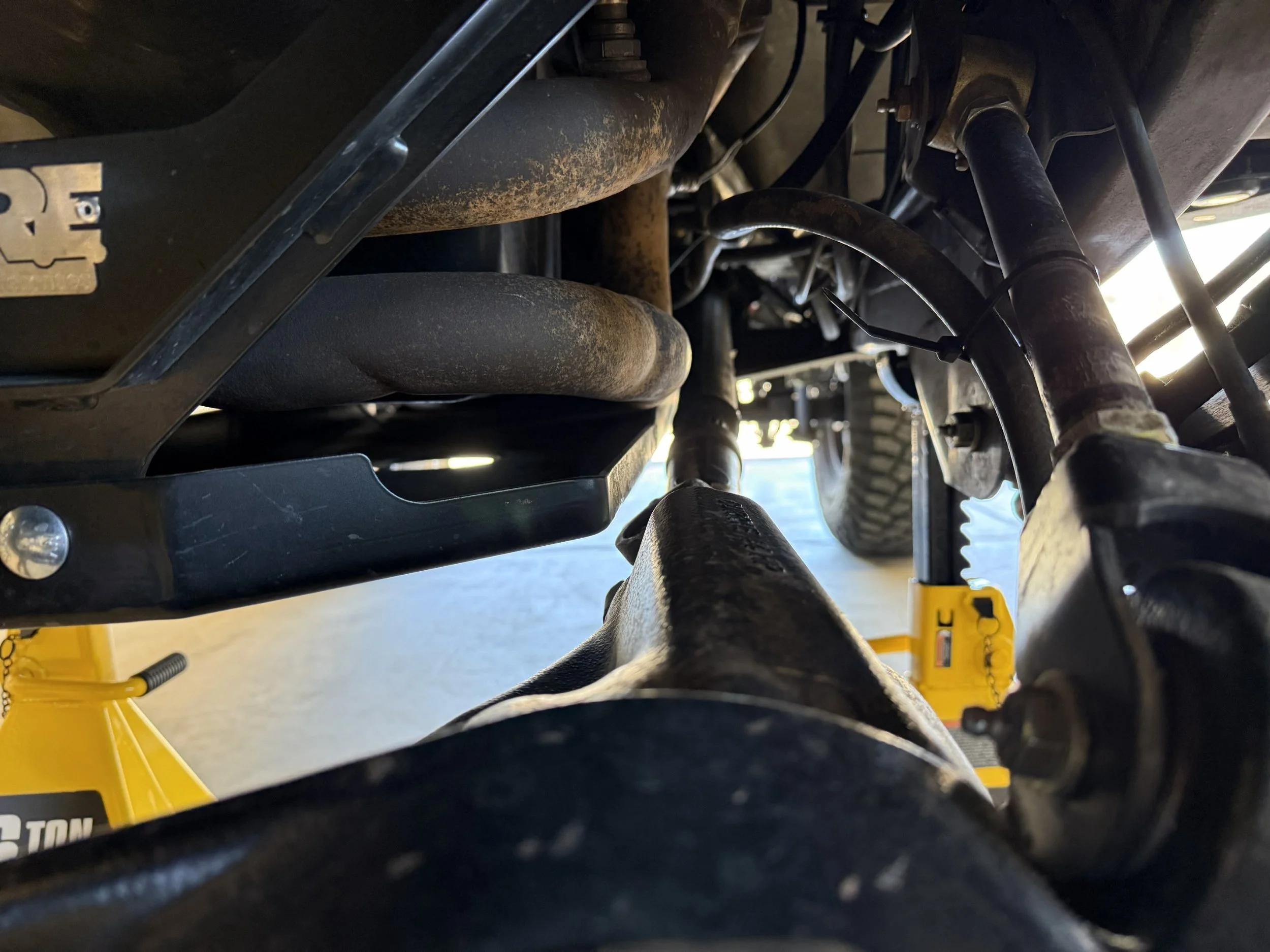

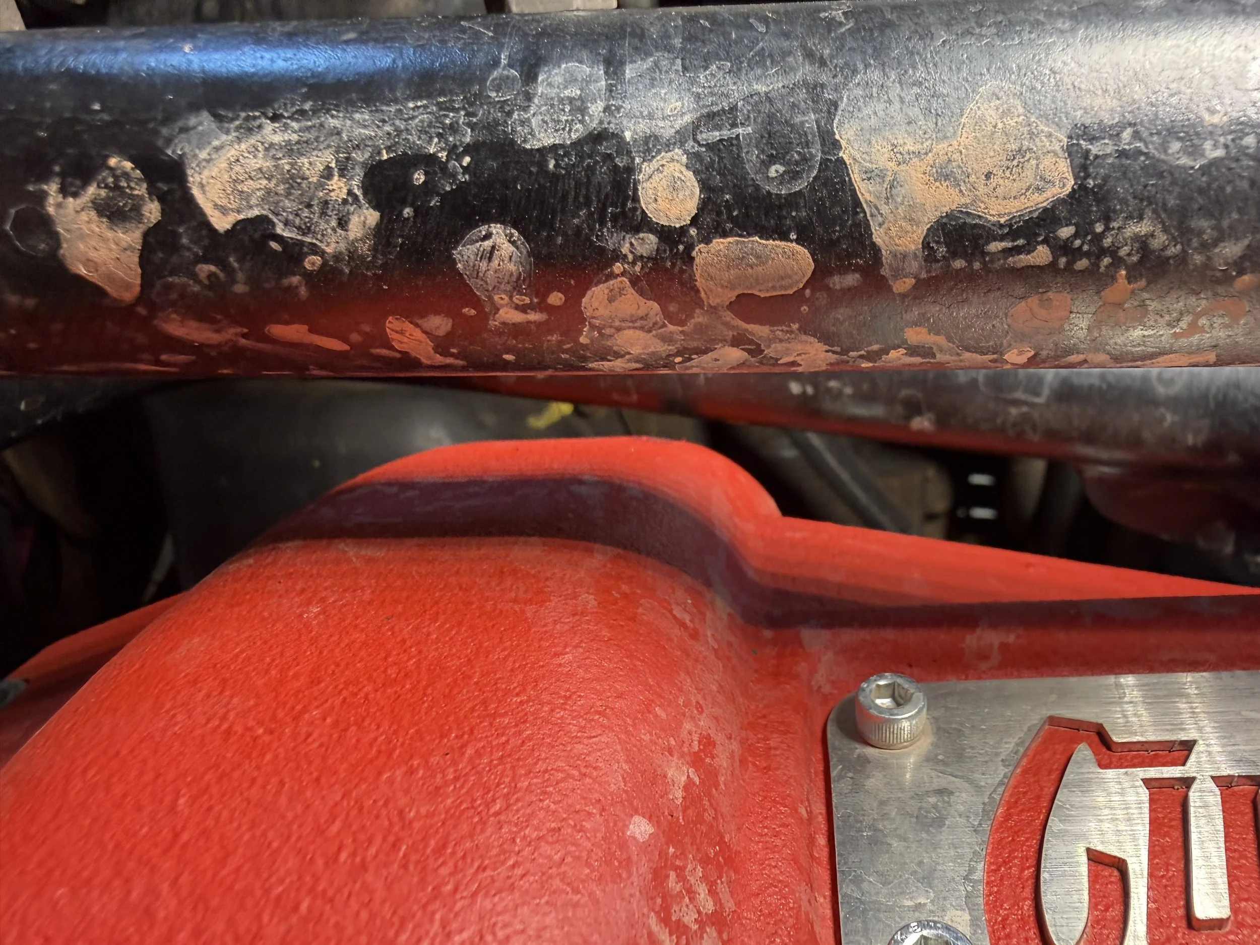

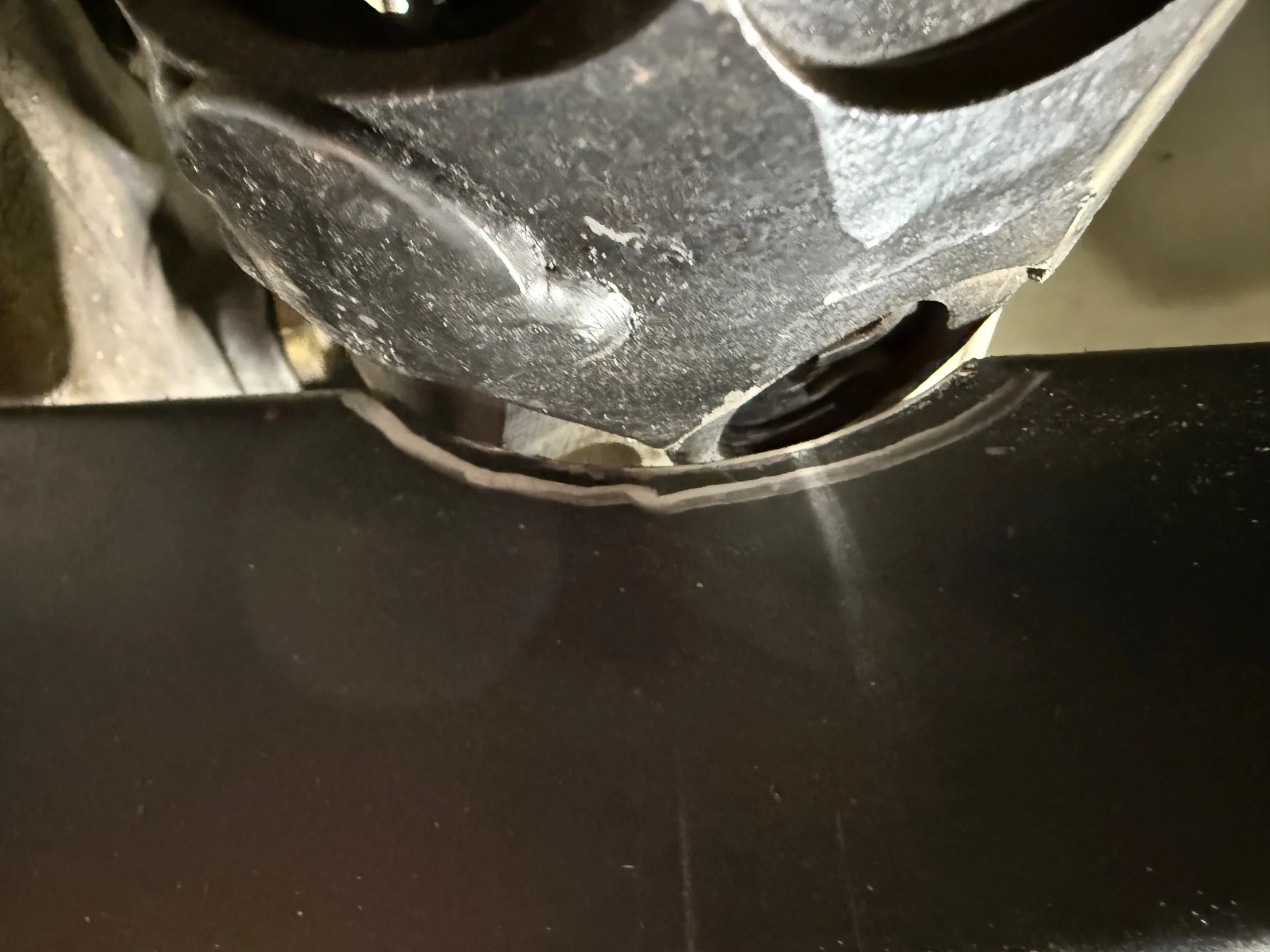

Back to the post Moab fixes, today I addressed the clearance issues with the Savvy UA. I notice less clearance for the front driveshaft, SYE and exhaust after the trip vs the post mod condition. In keeping with the them of my rig in Moab, the damn transmission mount bolts had backed off!
This caused the crossmember to rotate and cause my clearance issues.
The front driveshaft was rubbing on crossmember:

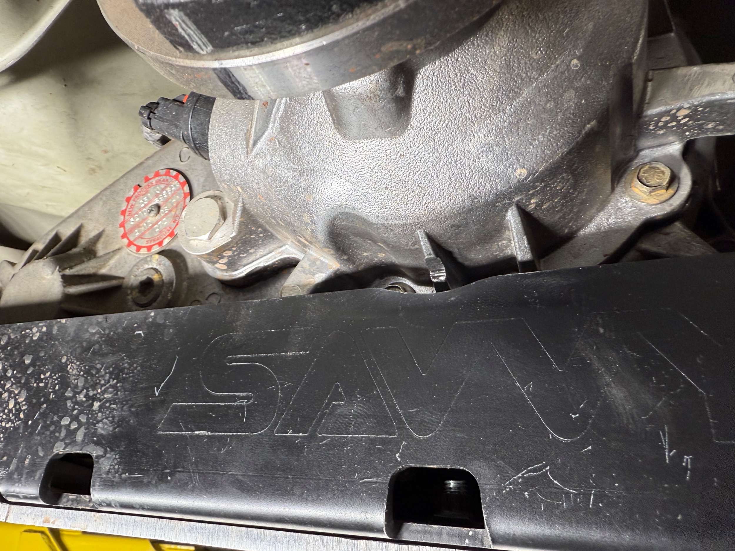

Contact between TC body and crossmember:

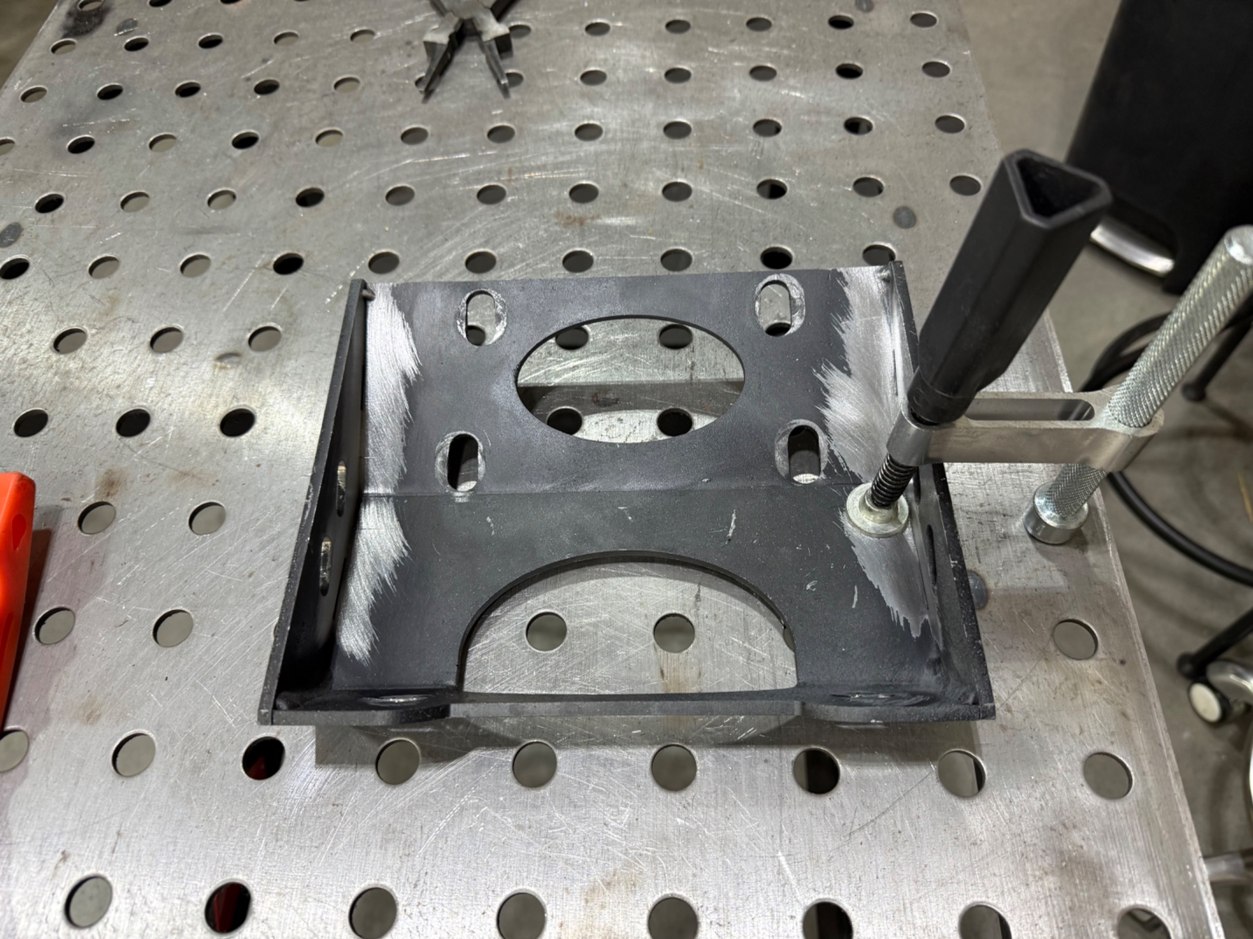

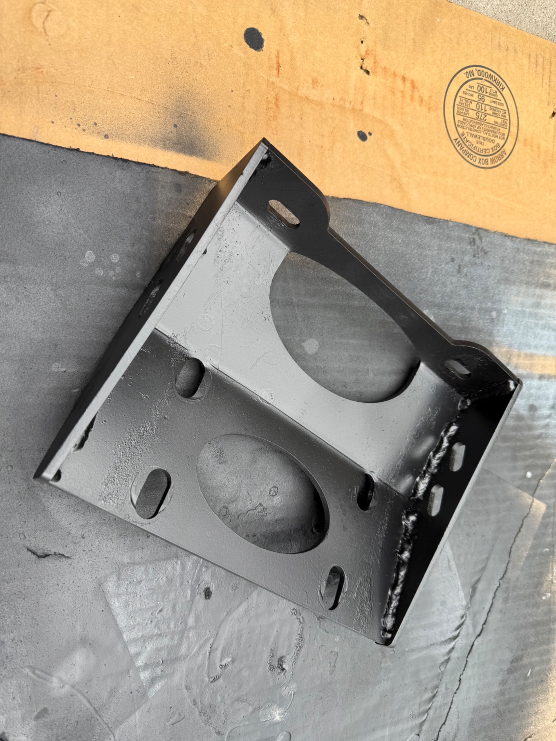

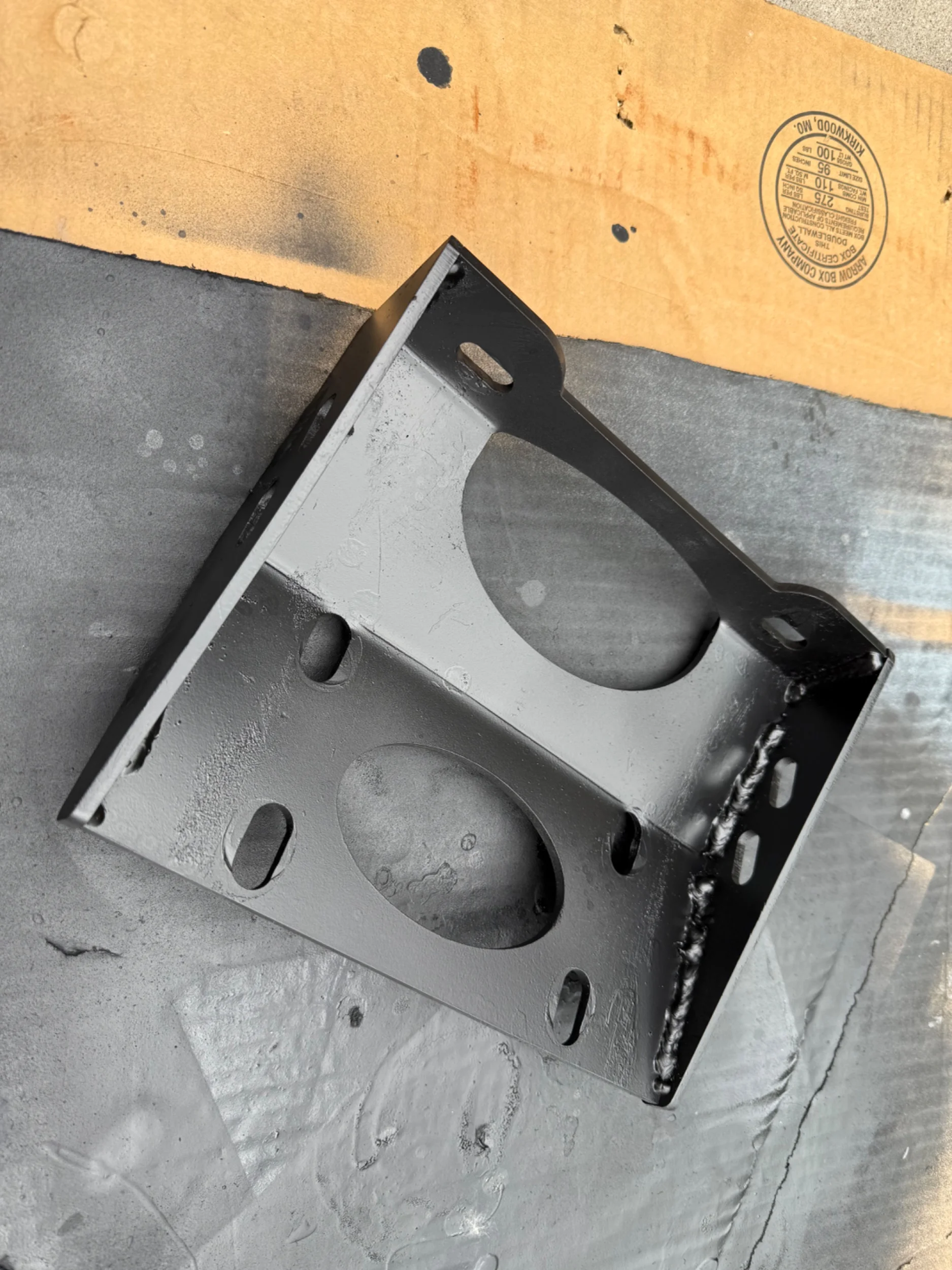

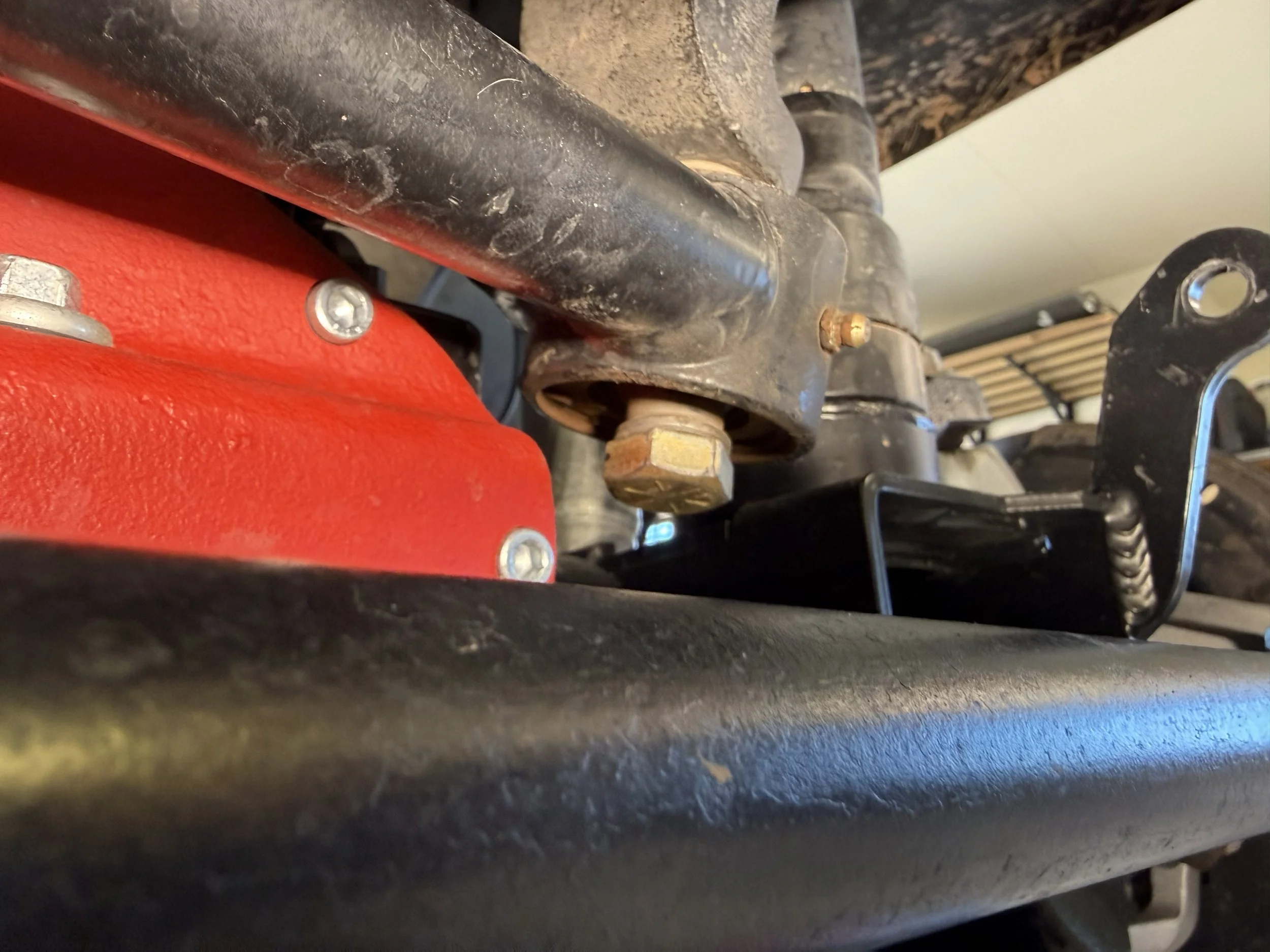

While in there, I added some weld to the Savvy mount bracket. Sorry missed the pics of the unpainted booger welds:

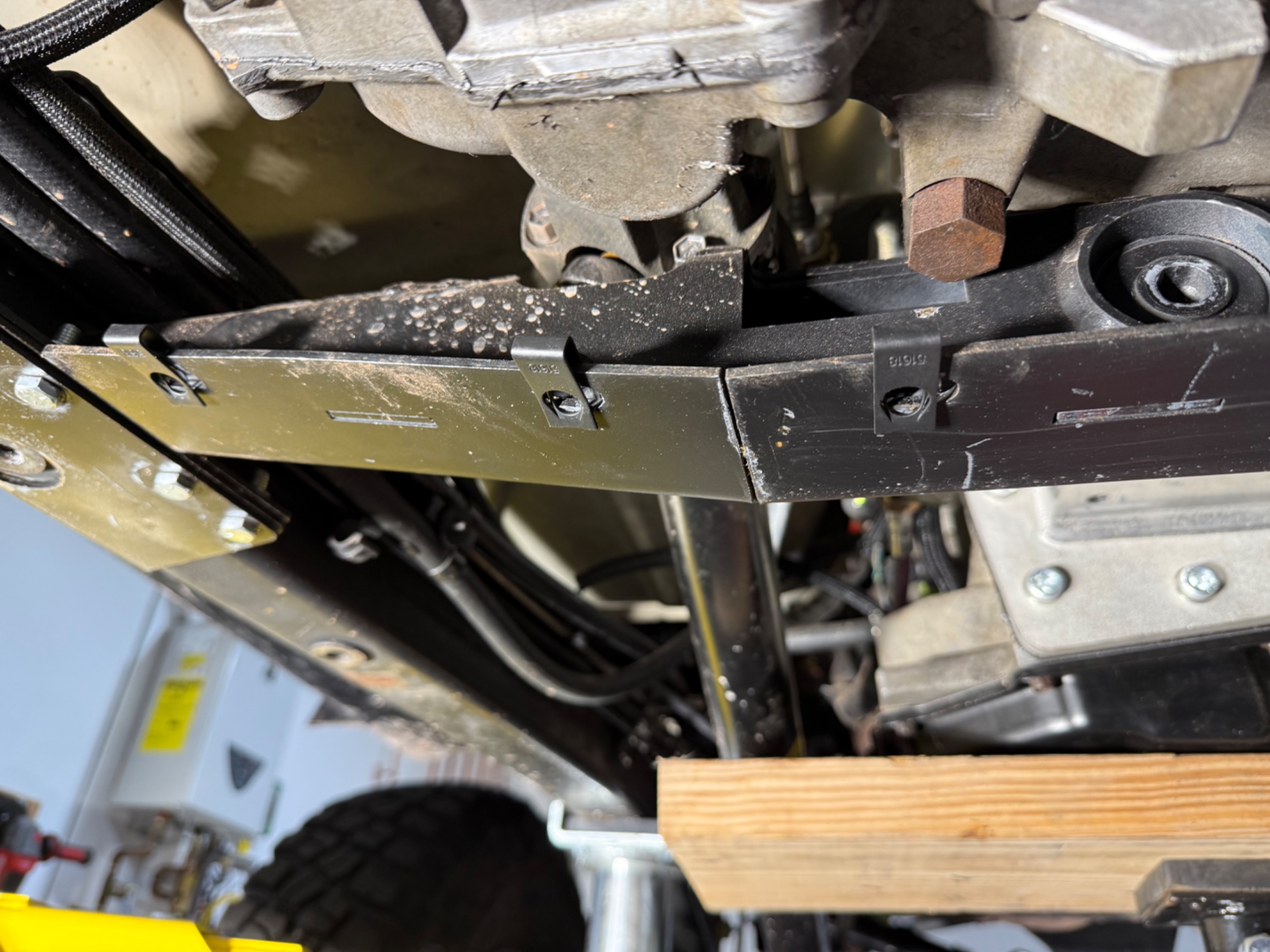

Also while in there installed clip nuts on the crossmember:
After reinstalling bracket tight using plenty of thread locker, clearance is fine on the driveshaft and the TC:

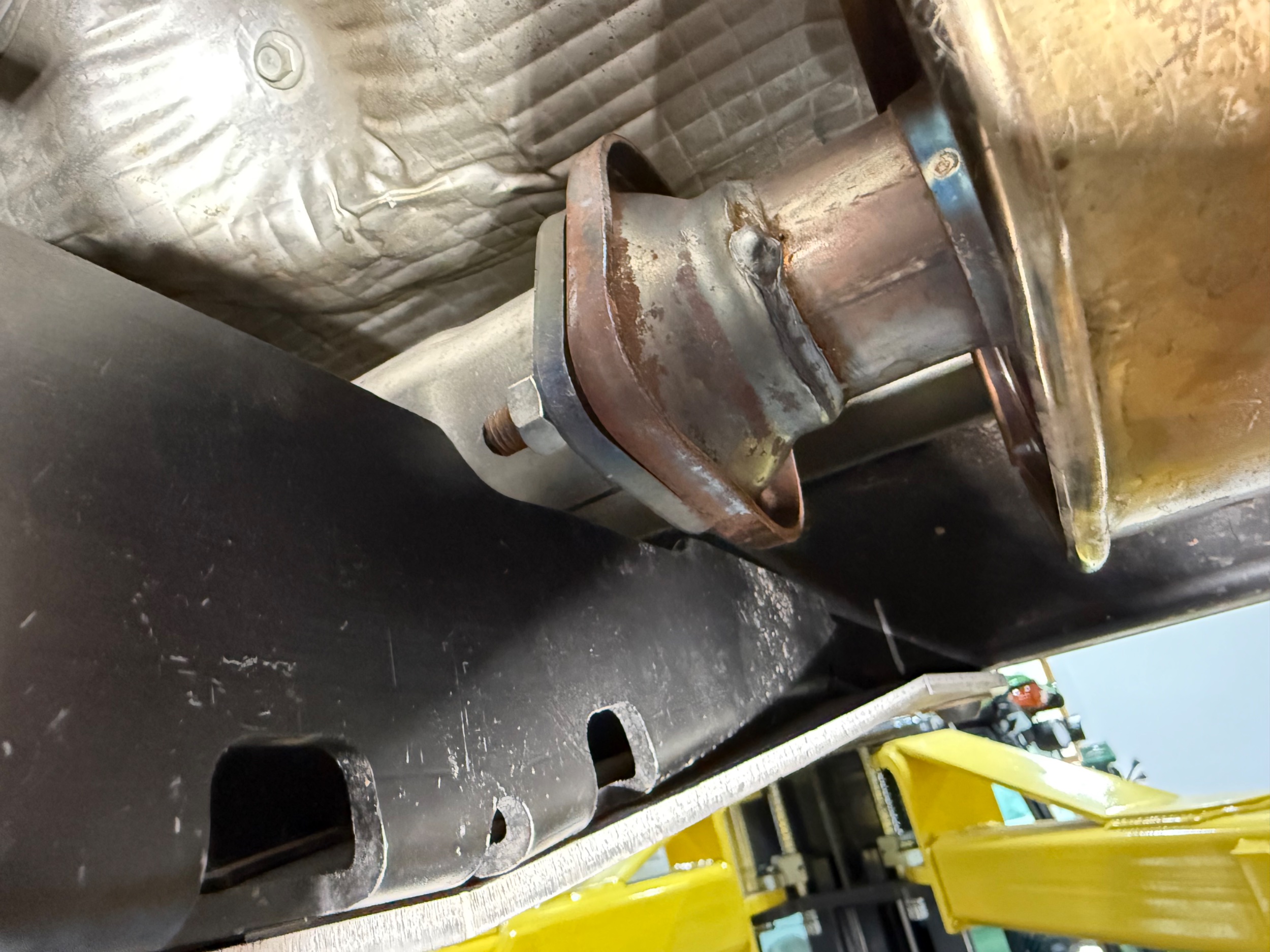

I clearanced the aft stiffener where it had been in contact with the SYE, and gave it a bit more room around the exhaust:
Clip nuts at the joint between the TC and engine skids makes instead the engine skid much easier:
I removed some material on the engine skid at the exhaust where it had been very close:
All done:
