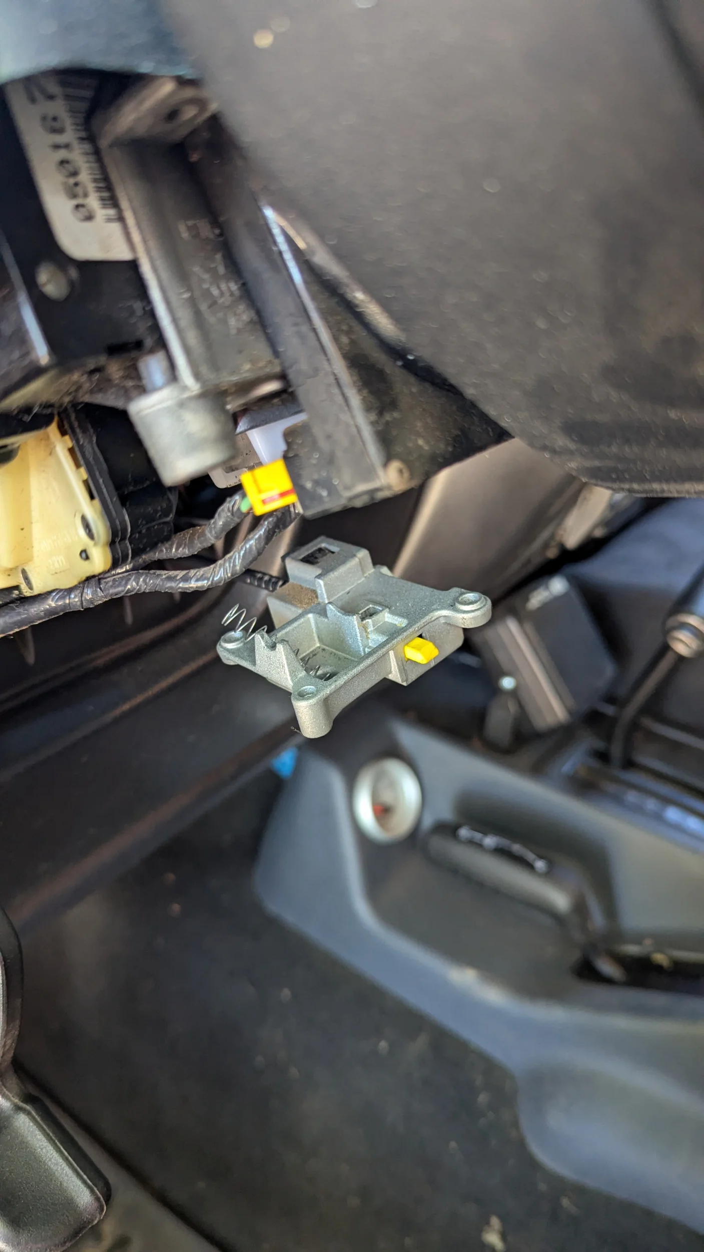

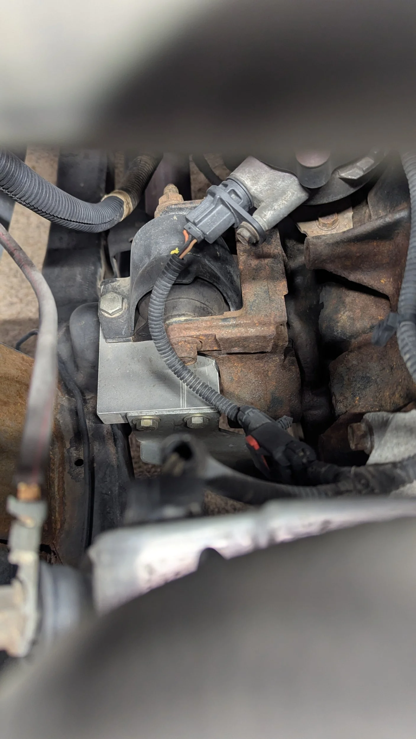

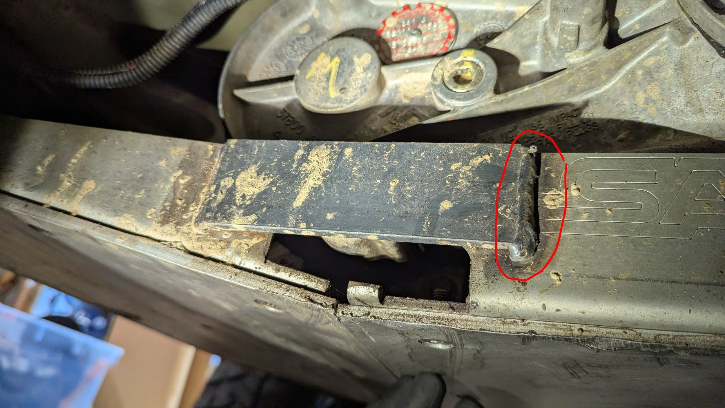

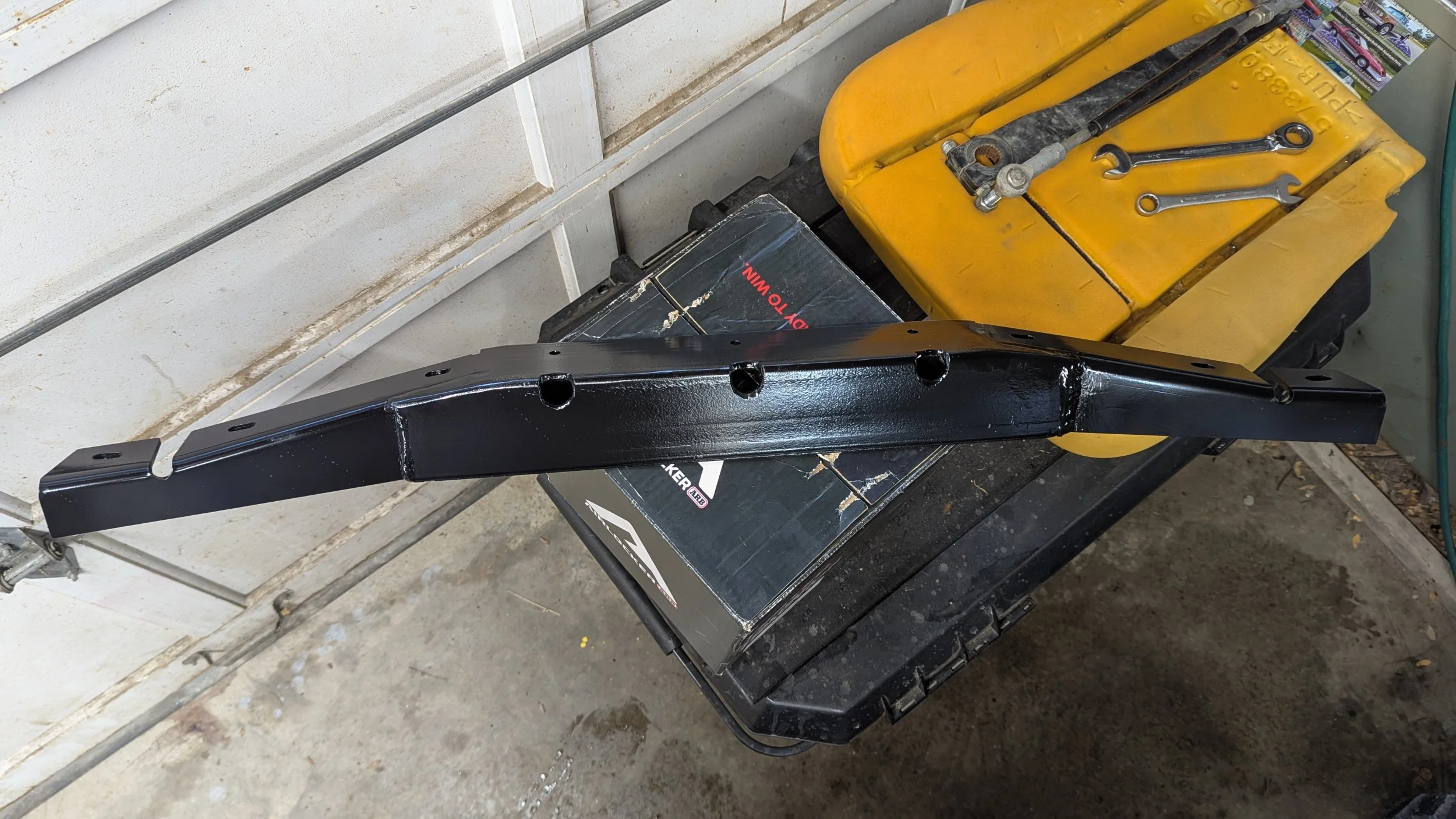

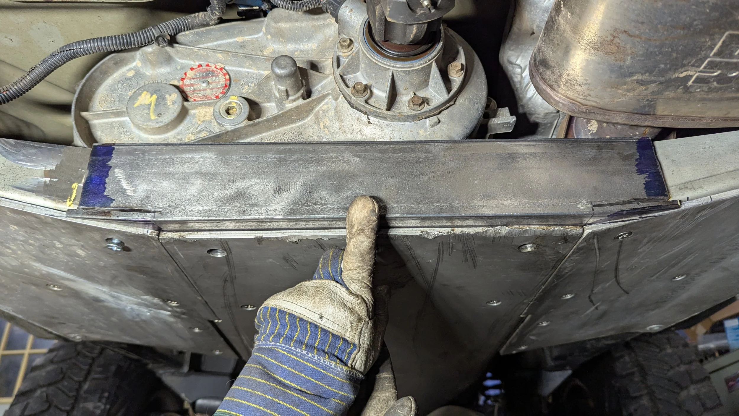

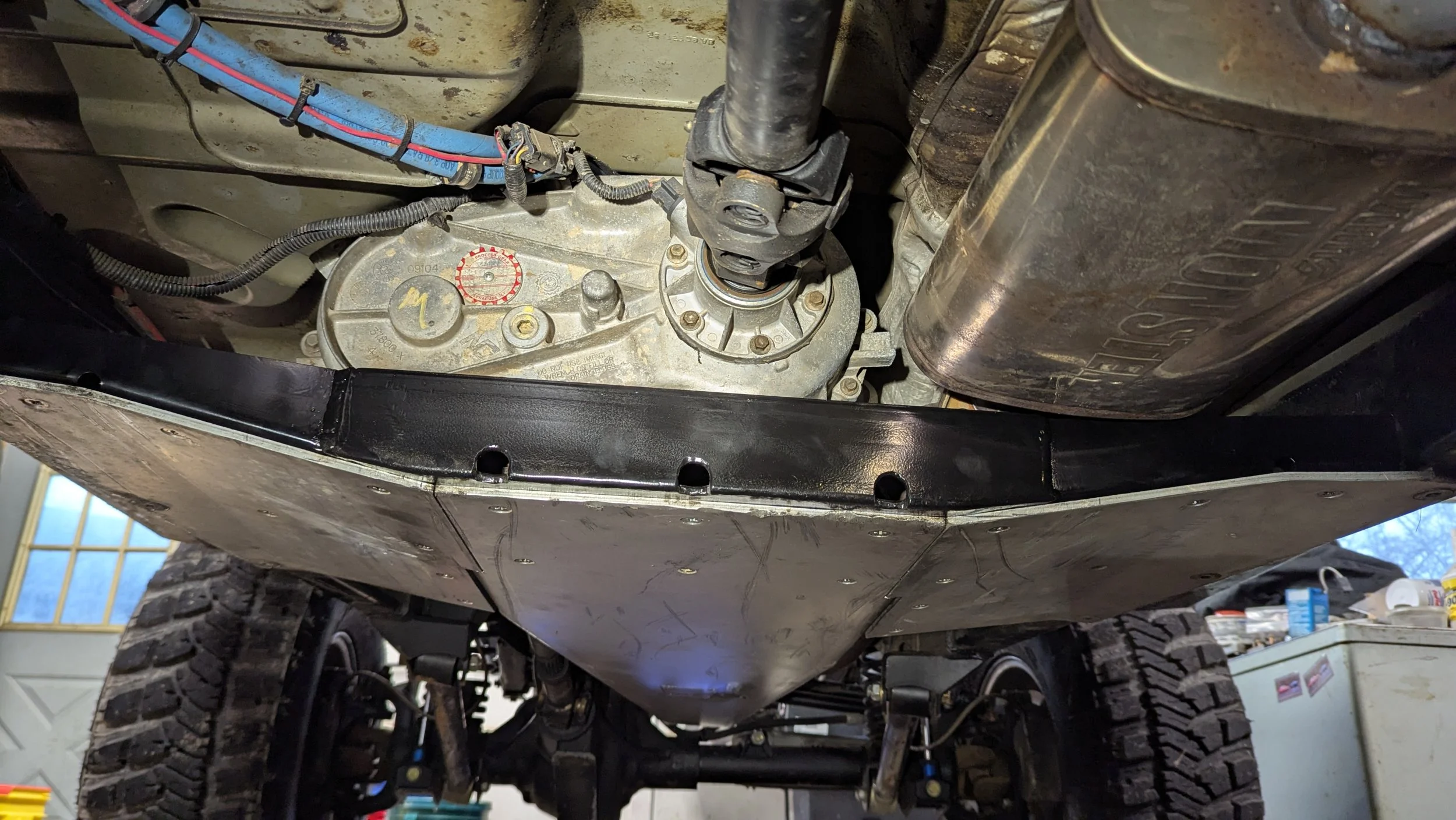

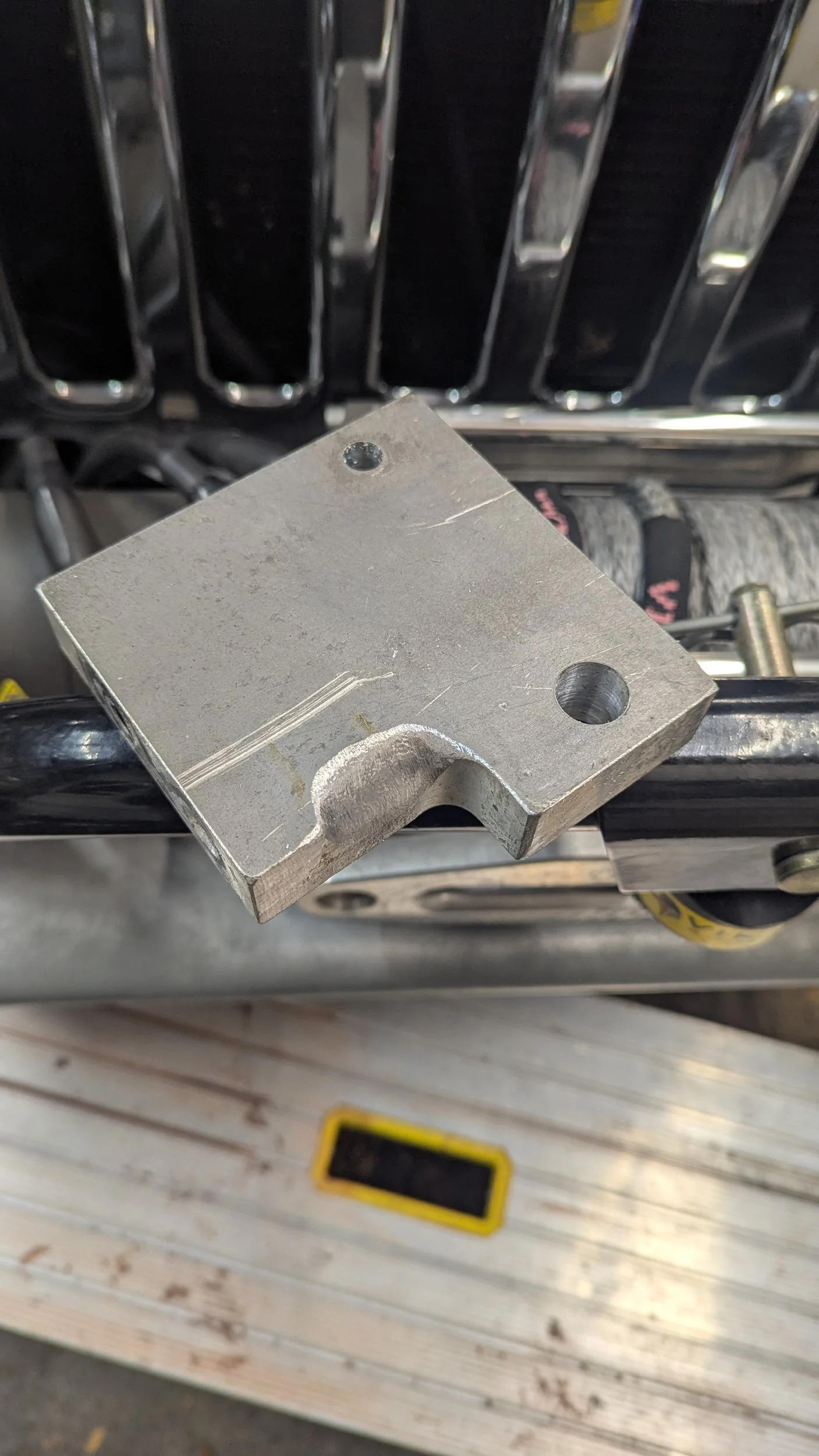

Gorgeous support bracket..
Thanks. The first time around was very much "An angle on the back is better than nothing" and the second was "I have this piece of scrap that will be better than it was". Extra height would help make it lighter, but I think this is about the best I'm going to get with the current constraints.

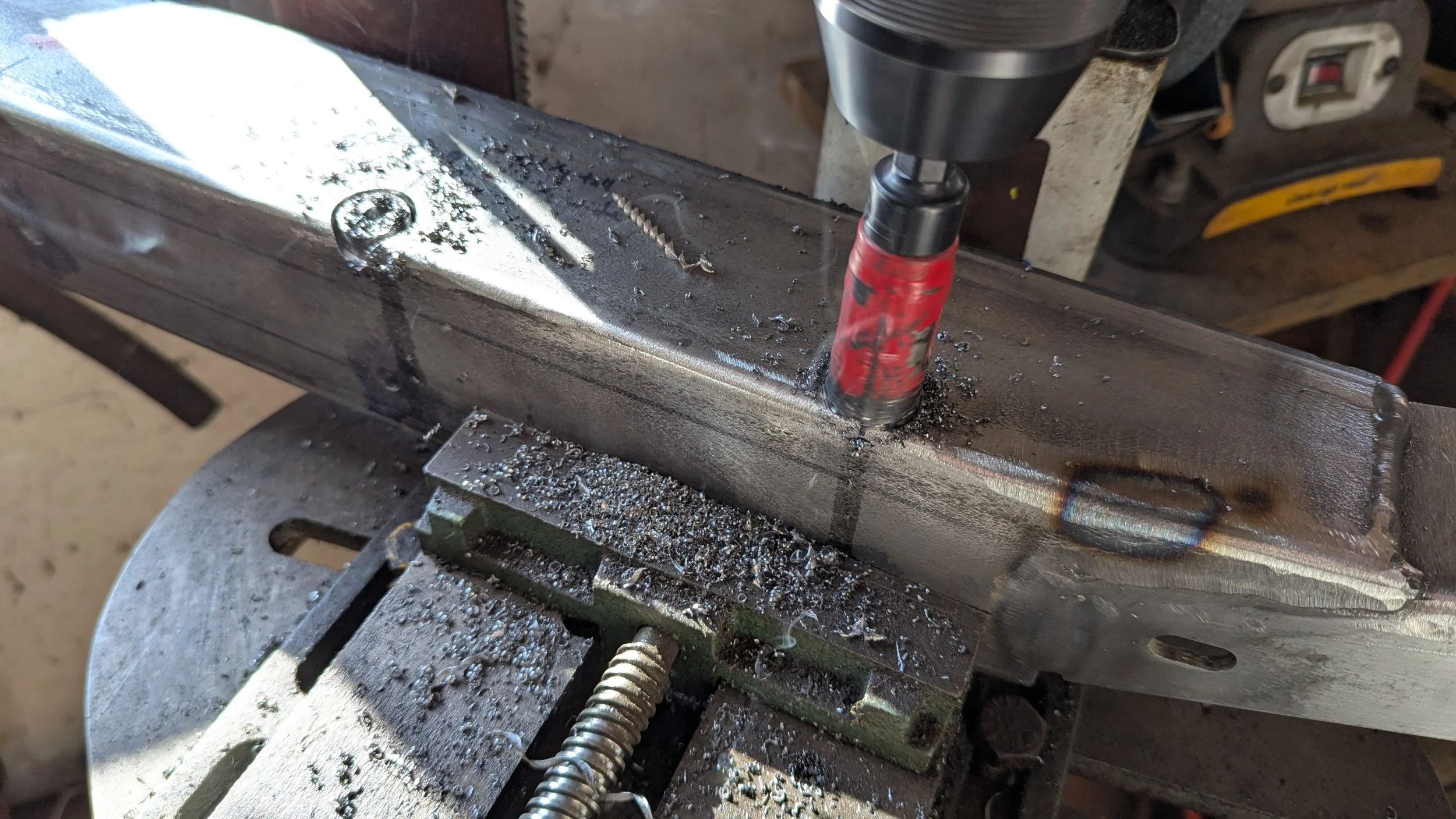

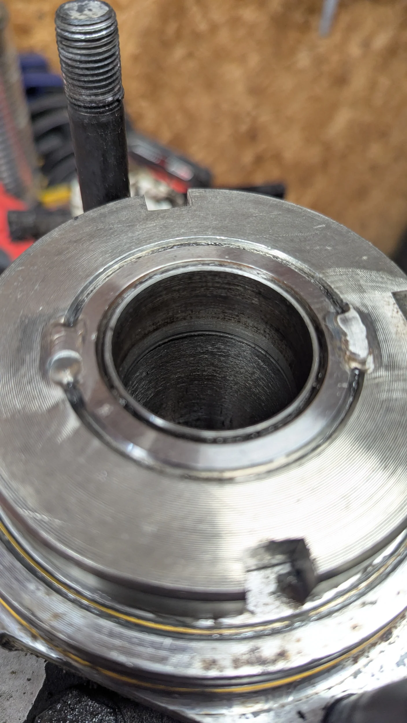

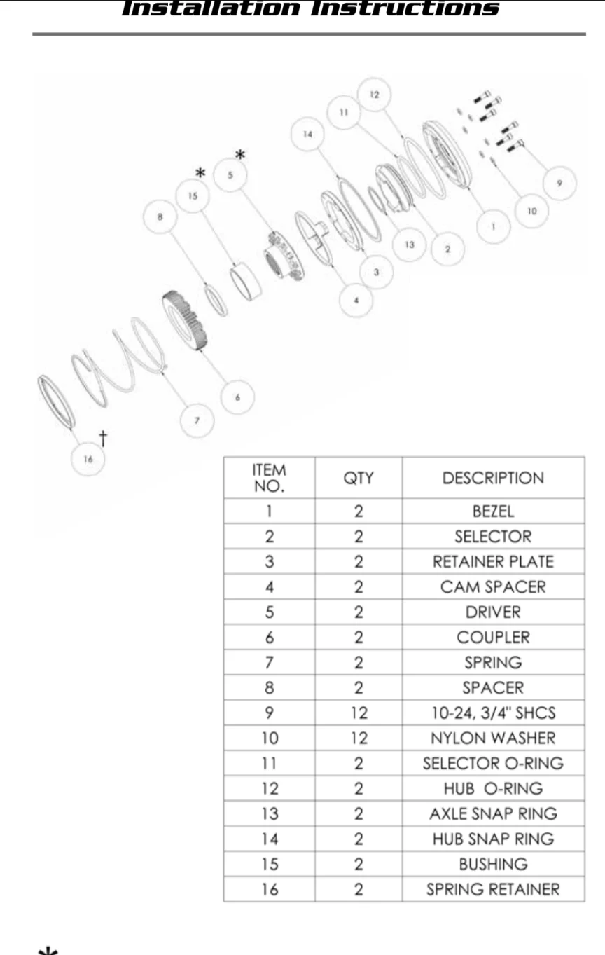

Started working on the Atlas. Based on Blaine's recommendation elsewhere I countersunk the last two fasteners on the bottom cover. They are through holes, so I put a set screw in each holes to keep shavings out of the case.
Thanks for the set screw idea. Simple and highly effective.
