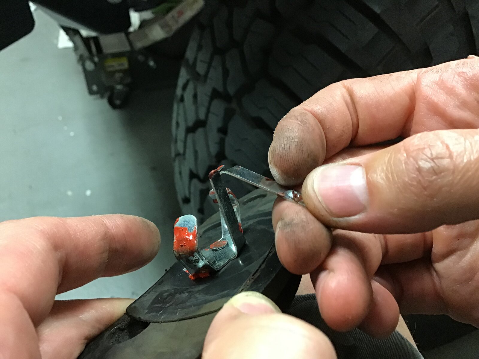

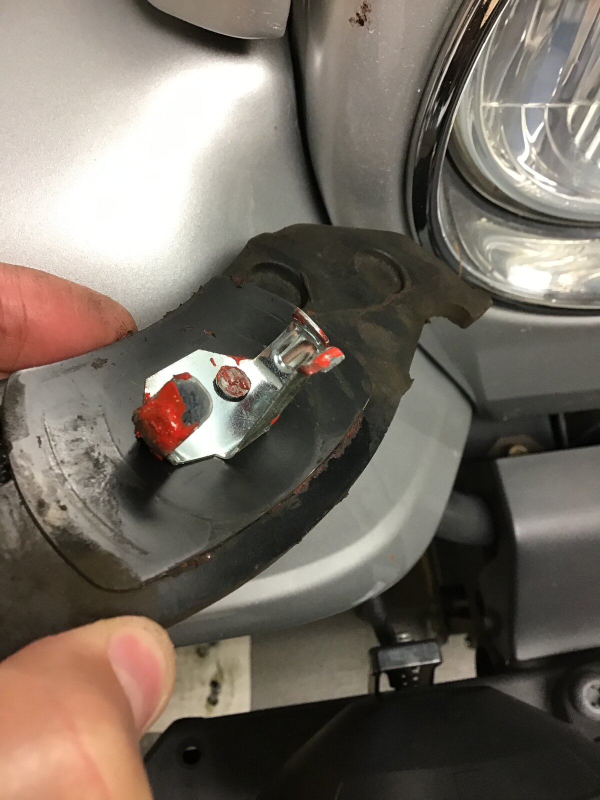

Hello everyone first post here. I was active on another wrangler forum but it looks like this one is more active nowadays so I thought I’d ask here too. Removed my front pads to lube squeaky brakes and in wiping off the red brake squeal stuff (I’m using brake grease now) the top spring holder on one of the shoes broke off. Barely touched it and it broke so it was hanging on by a thread. See pic. Is it okay to install this pad without that top spring? Is that spring there just to hold it in the piston during install or is it also crucial for brake operation? Thanks so much for your help!

If you kept the receipt, get another set. That's a defect. I'd use it if it still fits tight in the caliper piston and doesn't move around.
I wouldn't risk it.

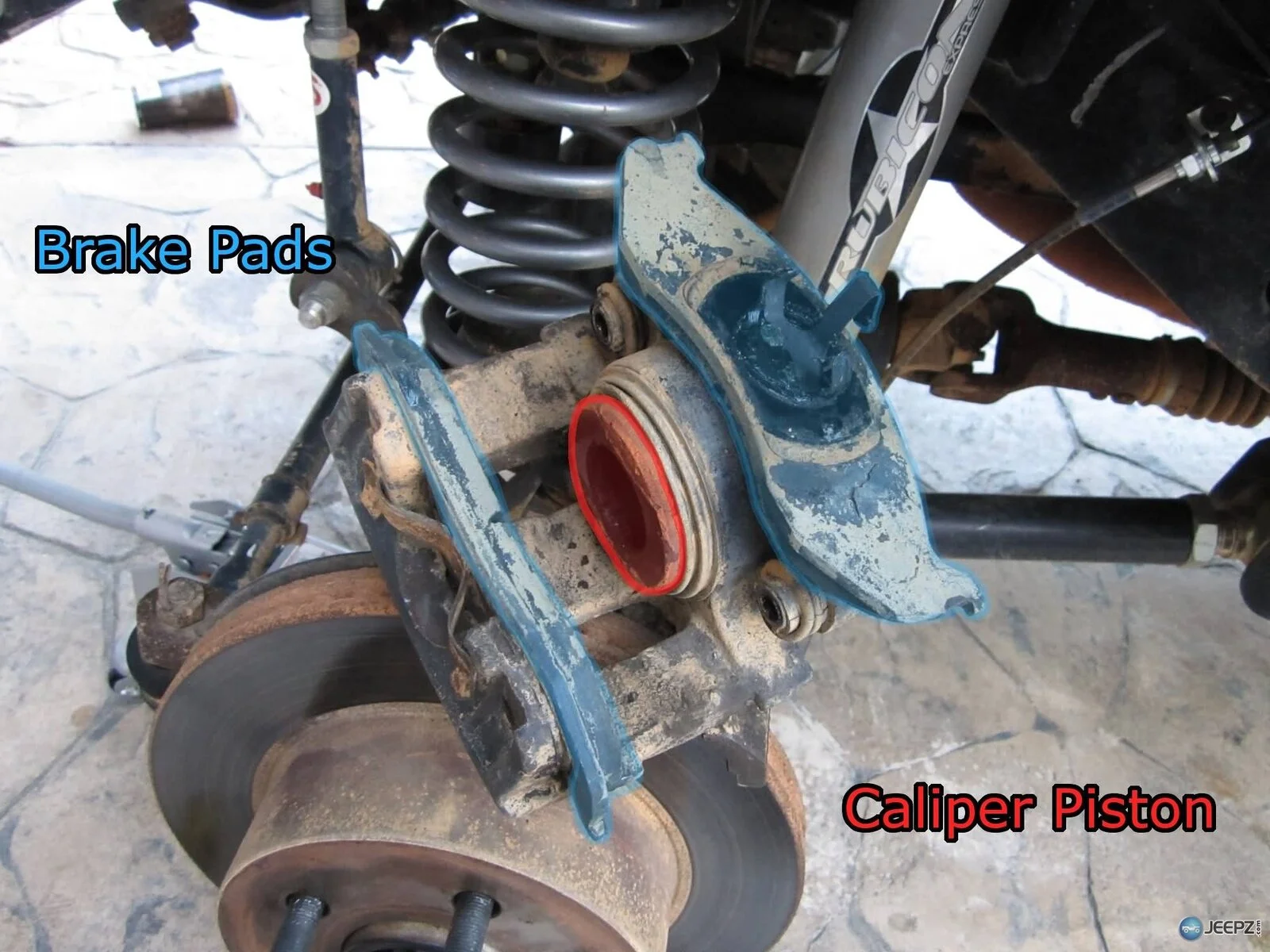

Yeah it keeps the pad and piston together, probably to keep it from rattling around or some other noises.
If my pads were fairly new I'd be putting it back on to find out how much noise it helped to stop. The answer to that would determine whether the wife needed them changed this coming weekend or not.
Thanks for the replies. I ordered some new pads from Blaine but won’t have time to install them and do the break in for a week or so. Need to use the Jeep meantime. If anybody thinks it’s unsafe please let me know. Seems like the spring probably wasn’t doing much considering how easily it popped off.
