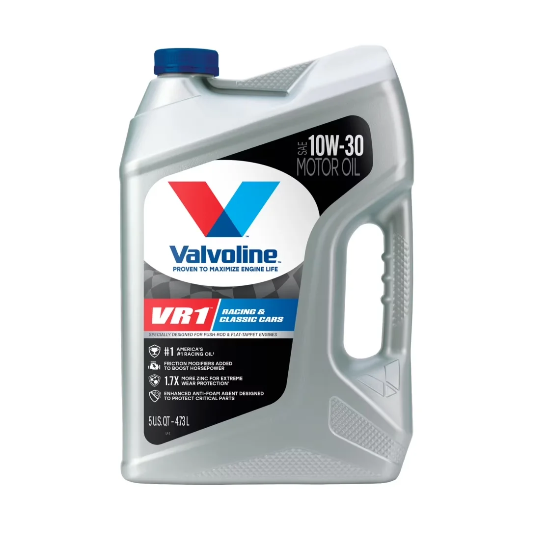

It has a good dose of ZDDP without going overboard. Non syn for his break in.
M1 recently introduced something similar, but it is way overpriced and full syn.

Driven conventional break-in or VR1 conventional are both good options for high-zinc break-in oil. Not a fan of ZDDP additive.
FWIW, I've been running Havoline conventional 10W30 since initial break-in of my stroker - it has higher zinc content then Penz, Castrol, etc., but less than break-in oil and can run a typical 3-5K mile oil change interval. Break-in oils are not made to last more that 500-1000 miles.
