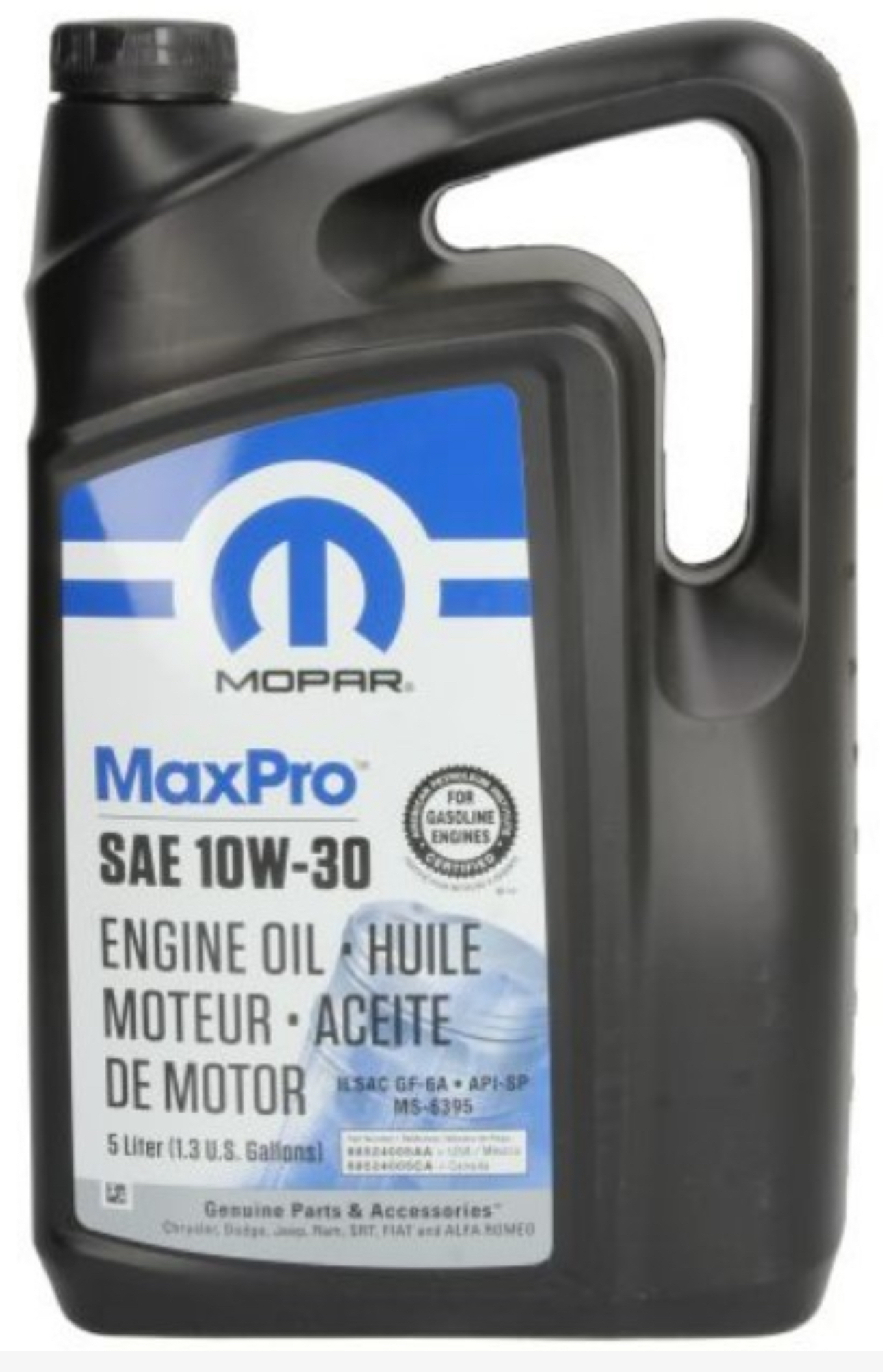

At the moment I run Castrol EDGE 5w30 full synthetic.
I can’t get everything to guys can get in the US.
I can get Mopar Here. But only 5w30 and 10w30
Other brands like Valvoline, castrol, motul, liqui-moly, mobil, mannoil I can get here in 10w40.
So please shoot! Let me know what the people think/use.

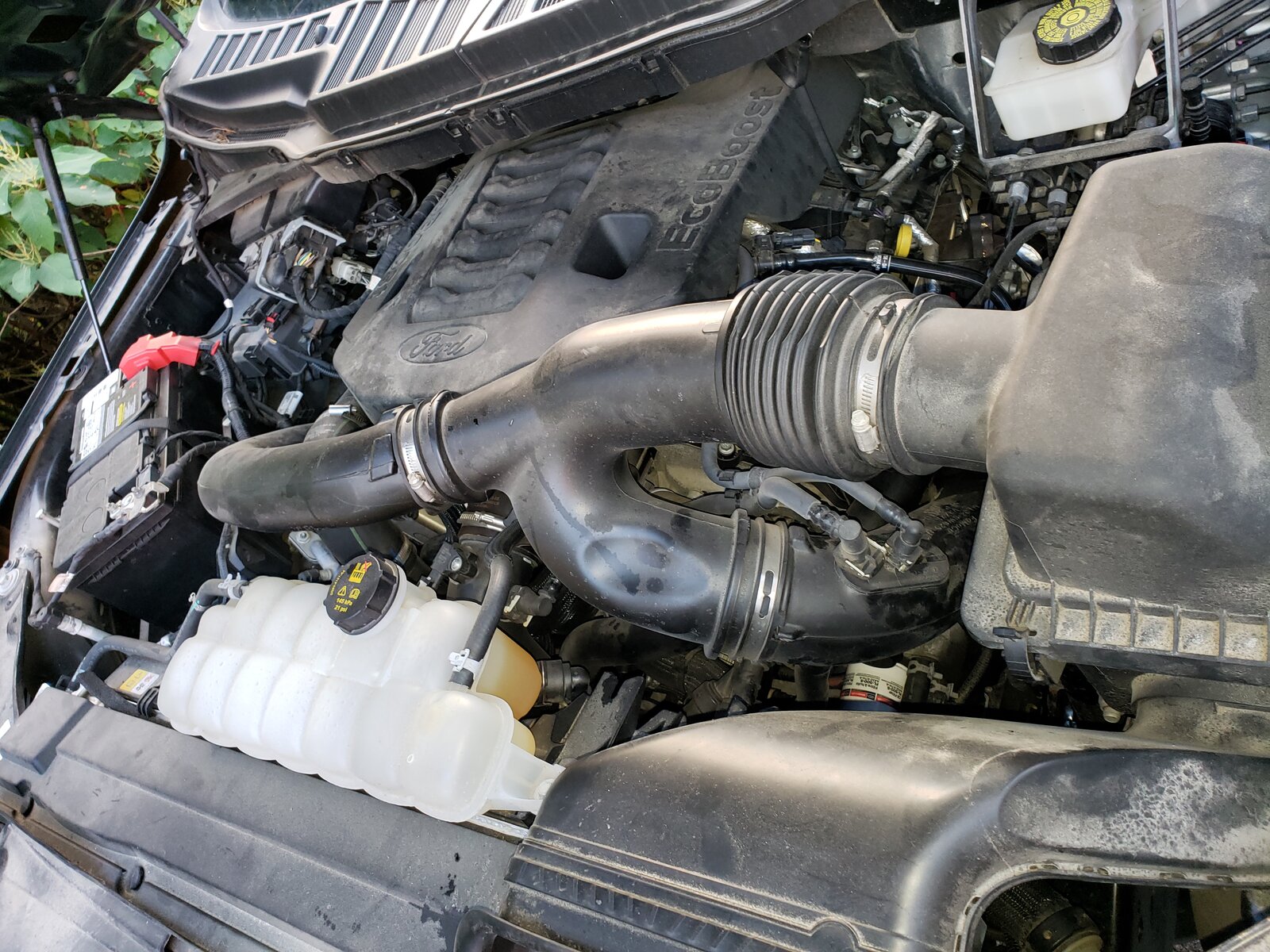

I know this works for the 4.0...no experience with the 2.4. And in cooler climates this ends up heating the oil to operating temperature...about 210. I did this mod with a Chrysler 300 oil cooler.

You don't need to run a higher viscosity oil. It's not really an extreme climate in the Algarve. The 10W30 should be good to any temp found on planet earth. The system is designed around a 30 viscosity when warmed up to the operating temp of 90-100C or so. I wouldn't waste money on the Mopar stuff. The 2.4 is a modern DOHC engine and will do well with any quality synthetic. The only downside to 10W40 is slightly higher wear. It is an old engine at this time and likely wouldn't speed or slow it's demise if there is an issue brewing.
The TJ forum isn't as familiar with that engine as it was only used in a few years near the end of production on a model that wasn't as popular to hold onto but I know oil leaks are one of it's known issues, primarily at the valve cover. There are some comments out there about noise at higher engine temps being a warning sign.

But if you tell me that 10w30 is good enough. I will try that next oil change.
