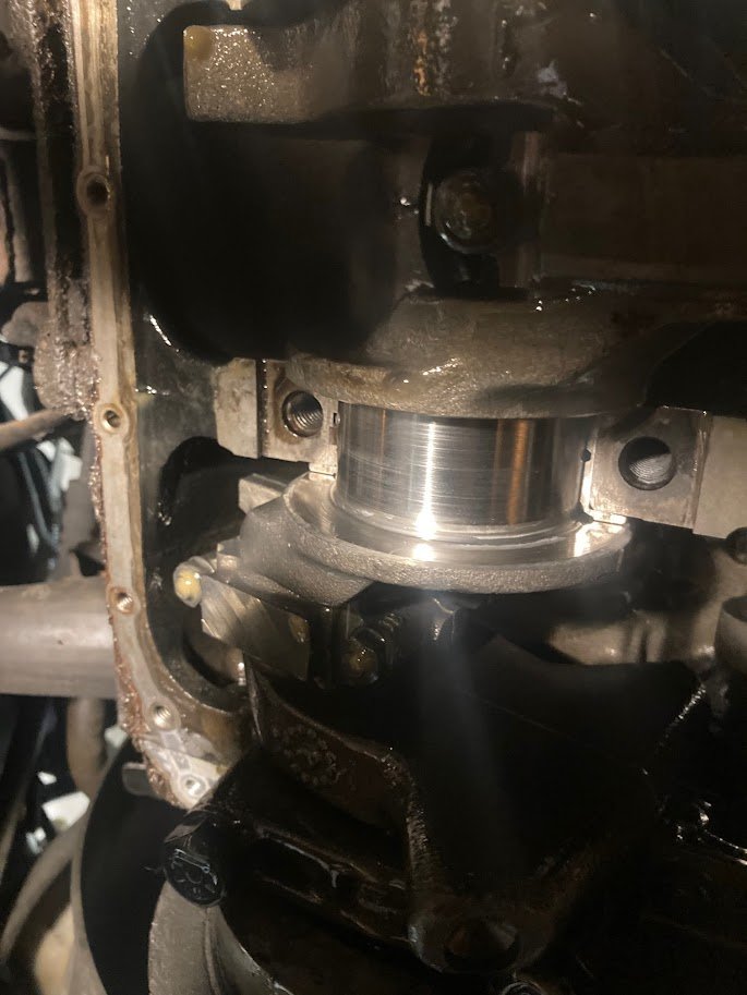

The main bearings don't look too good, but not like they're about to break.

Why not roll in crank and main bearings? Sure you're gambling on the cam and cam bearings but you'll buy some time for a couple hundred bucks.
-Mac
Oh yeah, I forgot to add that I already have new bearings (tri metal) as well as new connecting rod bearings. I can't really afford to change the engine shaft, if you wrote about that, for various reasons that are irrelevant here.
So I'm going to replace all available bearings, unfortunately I have to do it myself lying under the car.
