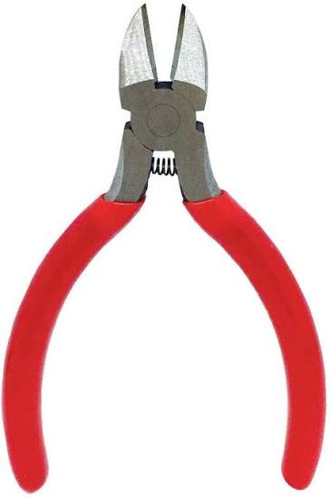

Just go find a Subaru and pick up a pair of dikes
I used a pair for a couple pieces but couldn't get the positioned to really cut out the bulk of it. I think a little saw would be the ticket. Obviously , I shouldn't have to cut a shroud again, but if it can happen to me, it can happen to someone else. Or if it can happen to one piece, it can happen to another.
