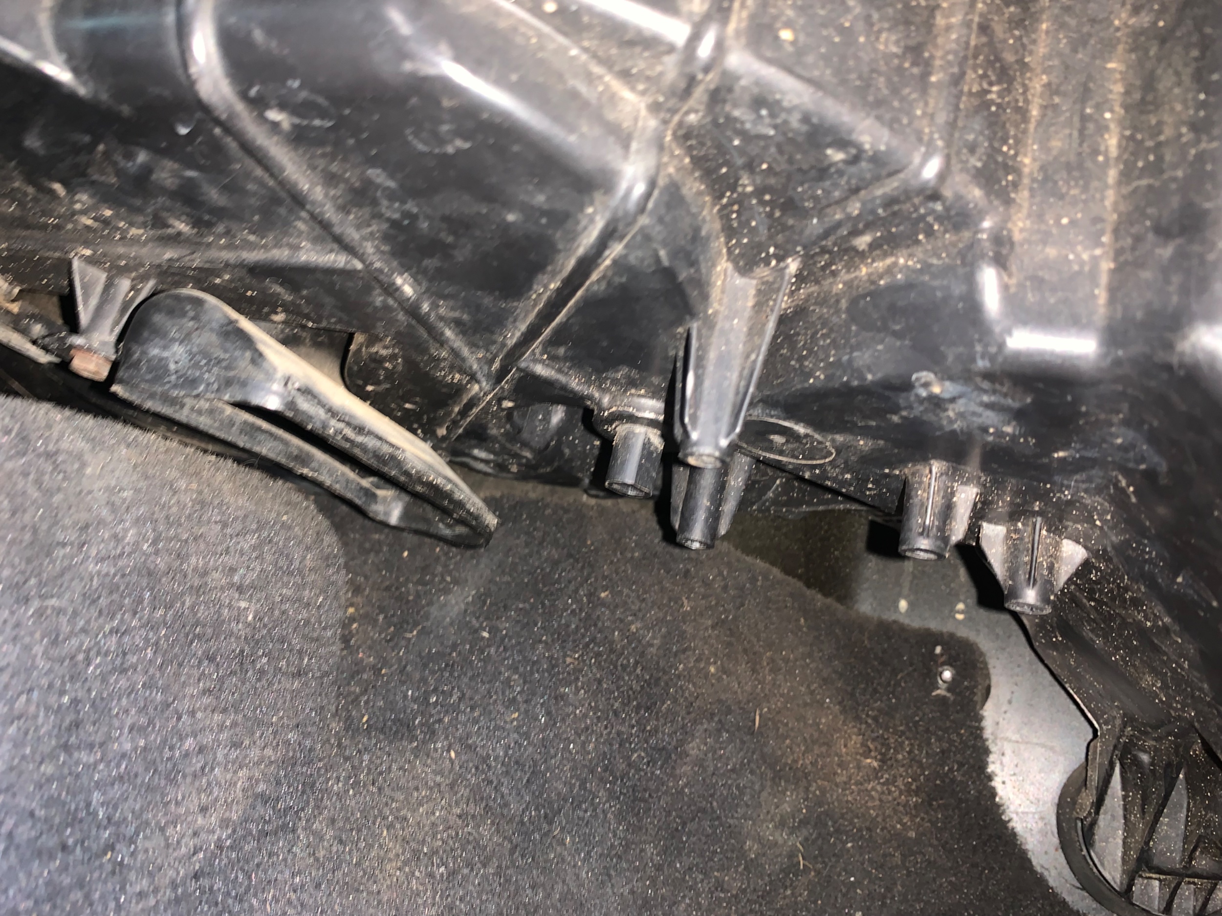

New to the forum. New to Jeeps. I have an 03 and can’t seem to find the location of the blend door actuator. Can anyone please help

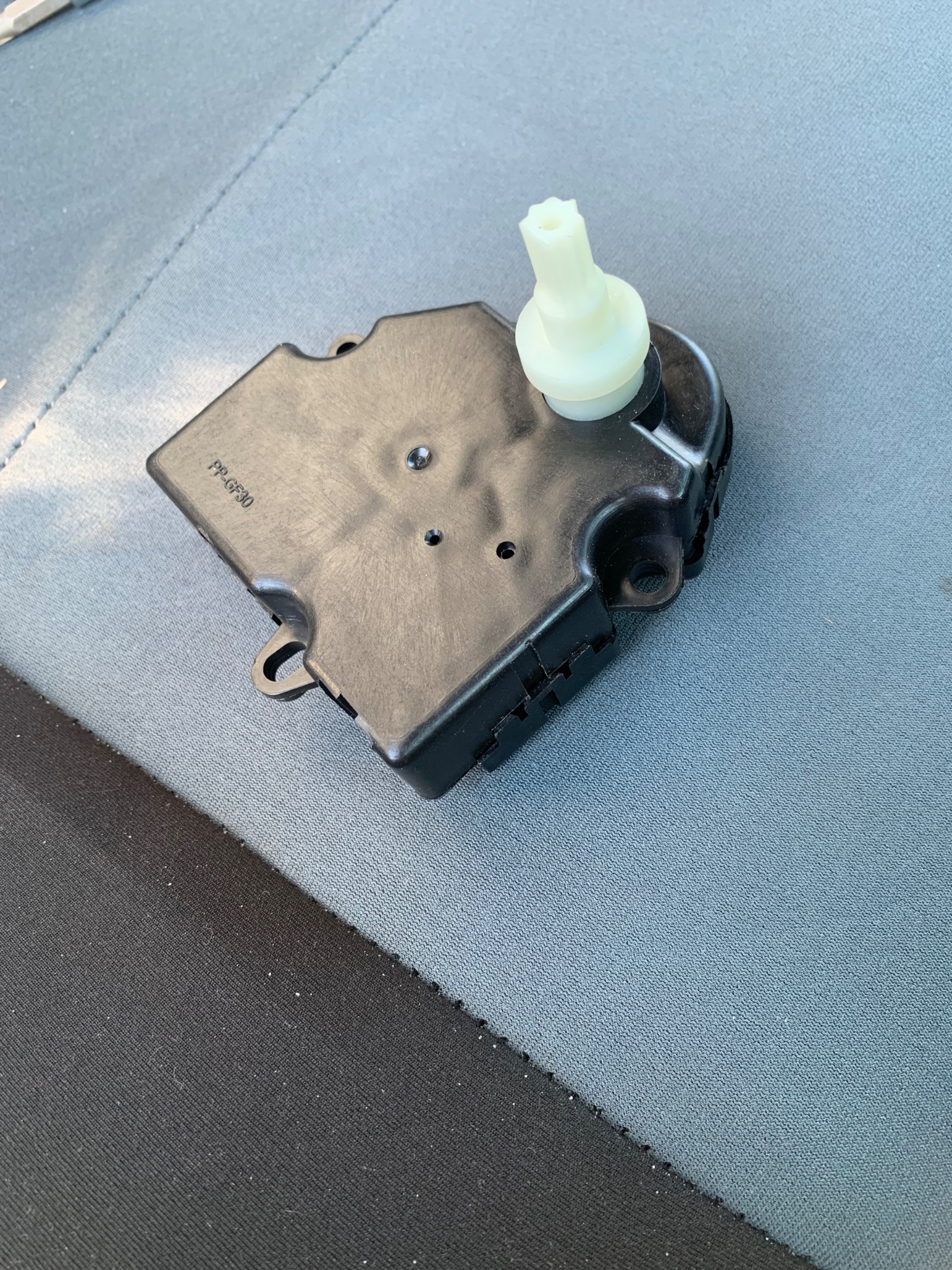

In the center of your pic you have a shaft with a flat either side. I expect that's the same as the base of the white shaft that's in your new actuator.
Thank you for the response. It seem a previous owner took it out and never replaced it. Just found the wiring harness for it. Now to figure out how to get it back in
