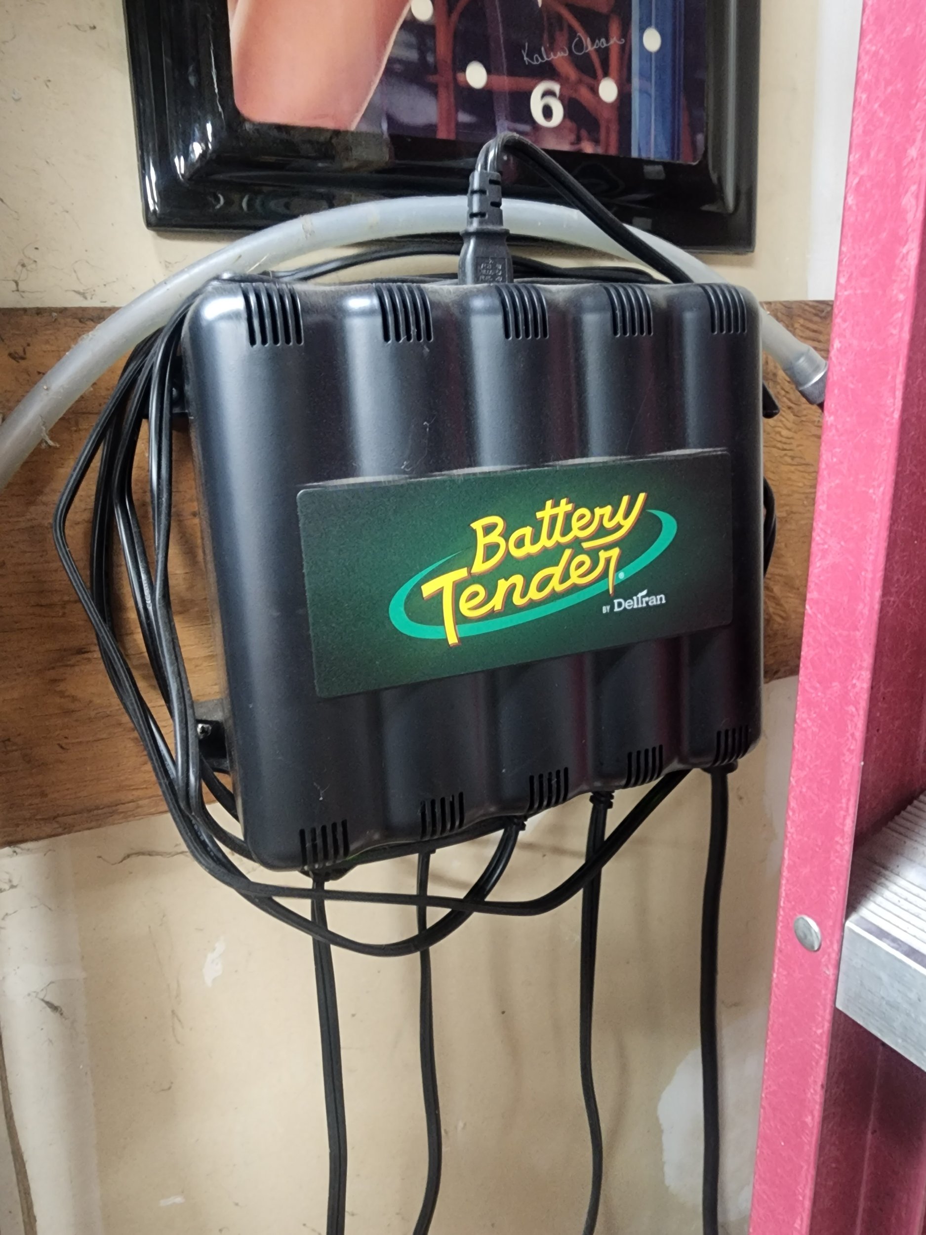

Mine is hooked to a maintainer whenever it isn't being driven.

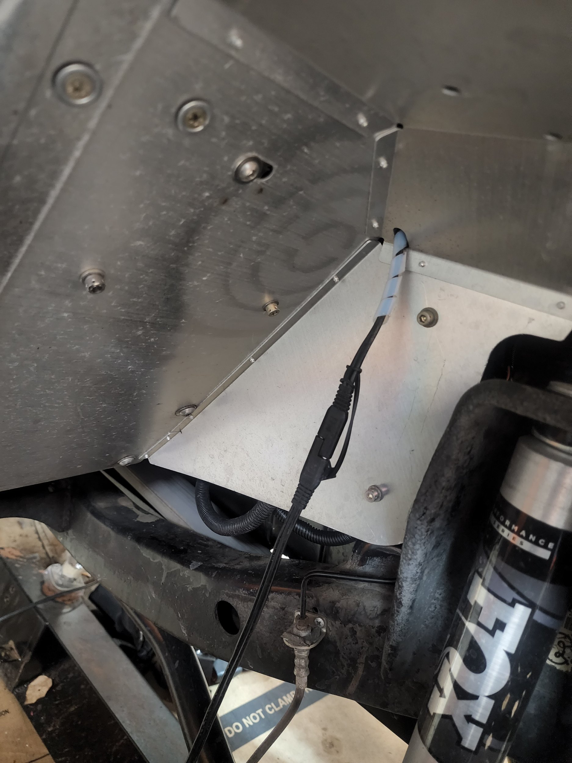

Edit: Using this and the second pic is where I plug it in.

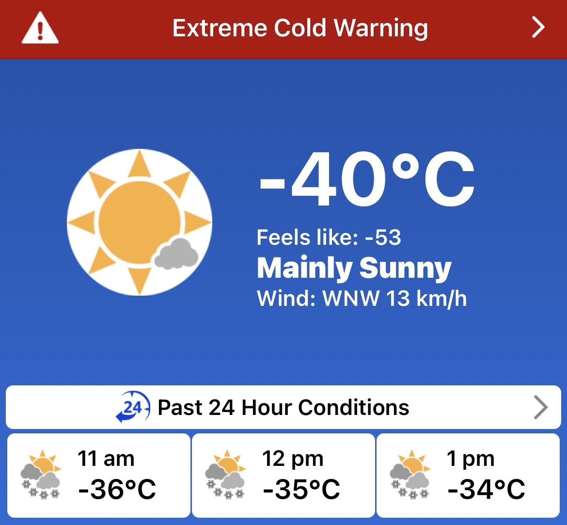

O - M - G
-13F ??? I say MOVE ............... !!!
