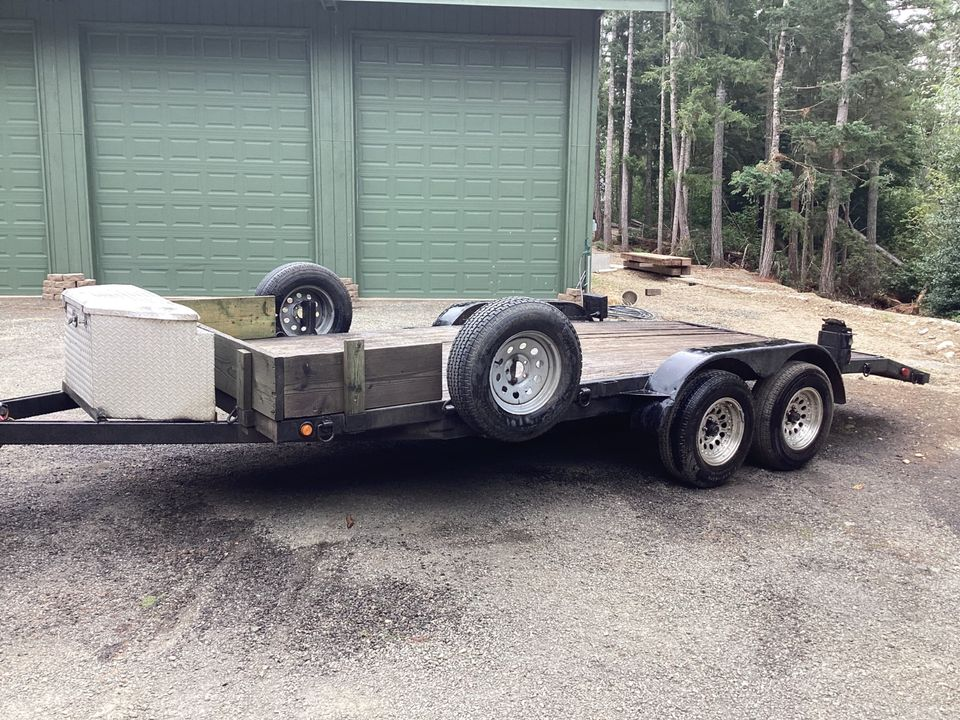

My friend has a trailer like this except the entire thing tilts instead of a portion.
He actually told me to avoid them he says they're a pain in the ass, he says he has to use 2 hi lifts to get it to be where he needs it. Do these have some kind of powered tilt motion?
There are some that are powered but if the lift cylinder is working like it's supposed to then it'll tilt fine. They are more expensive and more expensive to maintain too.
But I'm done messing with ramps.

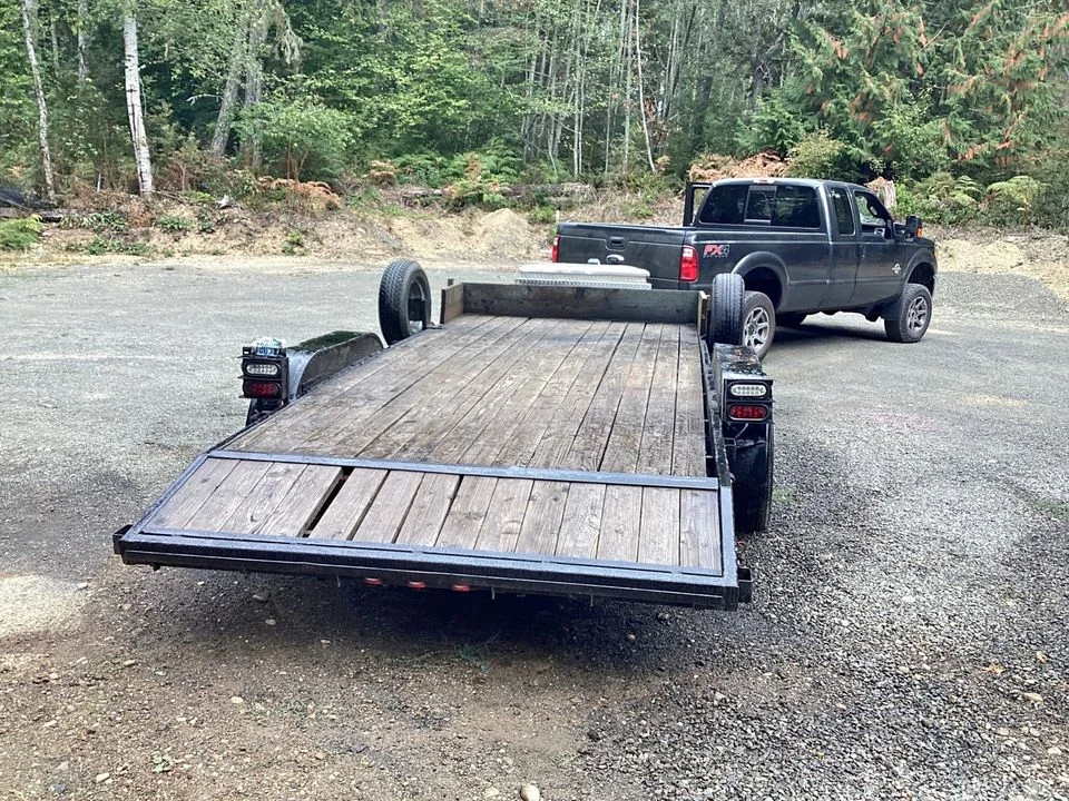

See how the back of the trailer is turned down? I can drive up on my trailer without my ramps most of the time. This isn't my trailer but shows what dovetailed looks like really good.

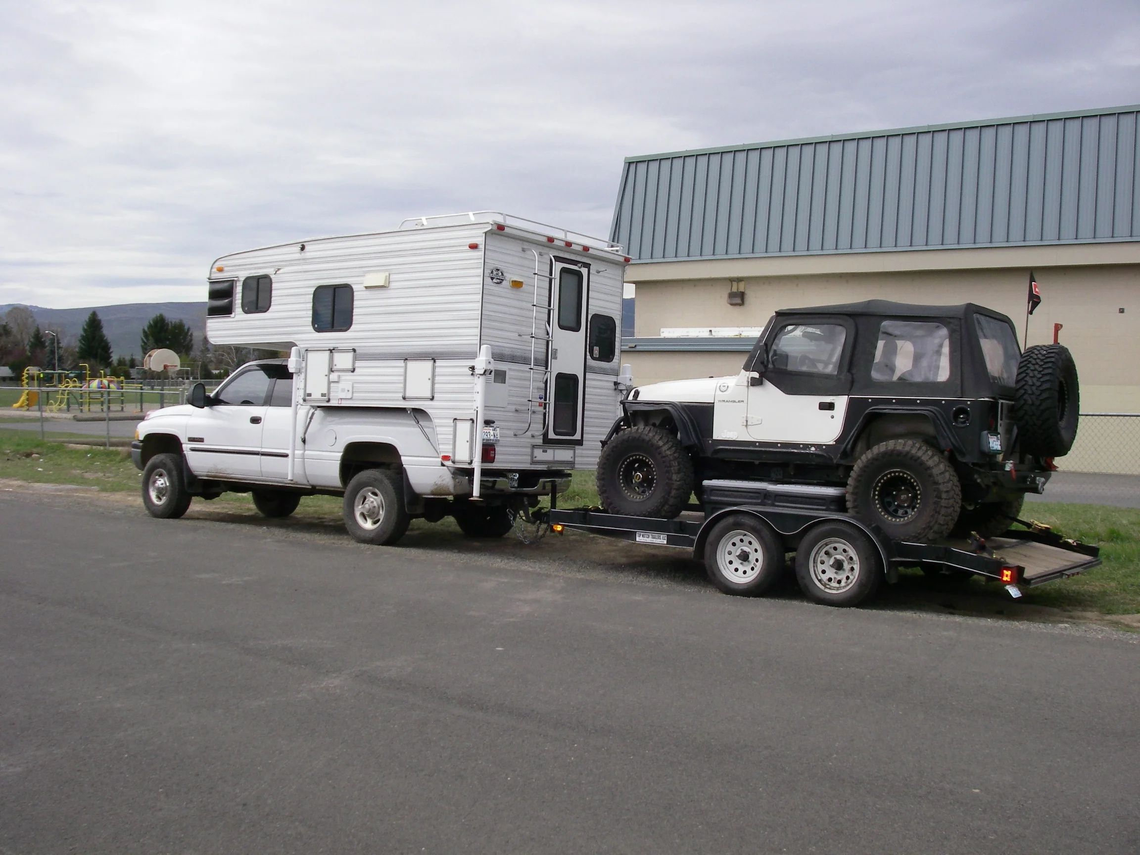

Here is my trailer. See how the back is turned down? It drags but like you it was my first ever trailer and so I didn't know any better.
Mine was dovetailed and I drug it a couple times. Without a tilt or really long ramps it would have been hard to load my car on it.
