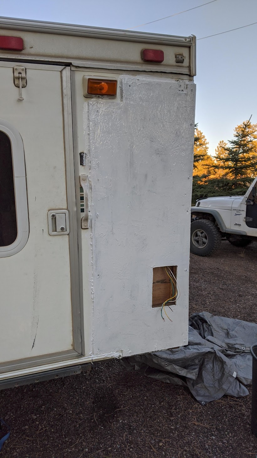

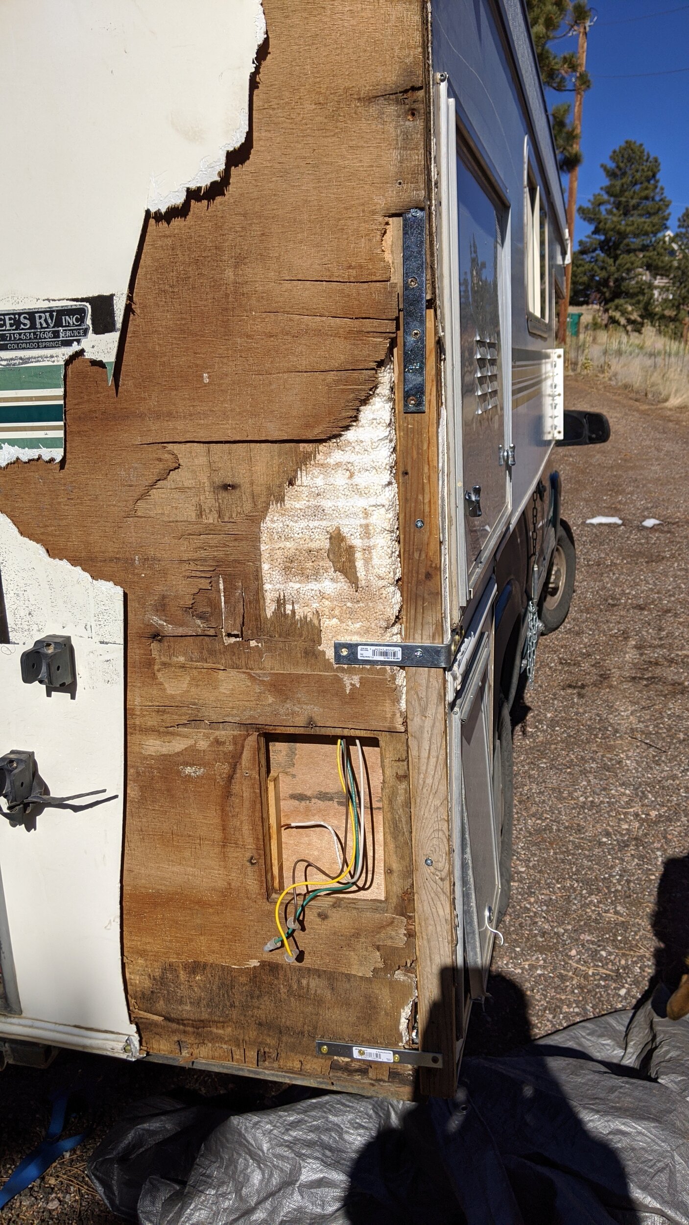

Rebraced the corner with a 2x1 (I think)
Got some plywood cut and painted it with flex seal, and you can't even tell anything happened!!
The crackhead special!! But whatever, if it keeps water out I'm happy. I'm just going to get jacks like wildman posted where I can fit them under the steel brace on the bottom back corner. I'm not really trusting that repair to hold a jack, lol.

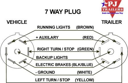

Now I want to figure out why the taillight doesn't seem to be working. Anyone have any tips on how to troubleshoot what is wrong there? I'm used to decent wiring diagrams for cars where manufacturers made 100s of thousands of them... I don't think there is the same kind of documentation for this.
Nice job. Who cares what it looks like as long as it works..
Just make sure you have the camper balanced on those jacks real well.
Did you verify your ground? Just run a continuity test from the plug to the taillight wiring for power and the ground.
Yep! Maybe I need to start buying stickers...
YES so I've learned, balance is everything for removal and placing it on the truck :LOL:
I wasn't sure where to start, honestly. Would it be correct to assume I'd be checking for continuity all the way back to the battery? Like one probe on the end of the wire and the other on the pos or neg battery terminal?
No start at the camper plug that goes into you plugin in the bed or to the 7 way plug on the back.
Vehicle is your truck & trailer is your camper.
Go from the plug to the wires at the light.
Okay I see! That makes sense. I'll try that.
IIRC the reverse lights do work on the driver side and not the passenger side... so that'd probably point to a problem in "- GROUND" or "+ AUXILLARY", right?
Reactions: reddvltj
Just to back up for a minute.
The battery on the camper is to run your lights & heater & anything else that is 12V.
The Aux most times is for charging your battery.
There is a seperate power in the connector for turn signal and reverse. Aux is unrelated. So if turn signal and reverse don't work... it's probably the ground to connector somehow..?
Reactions: reddvltj
Yes most times it's a ground issue. Like working on a Corvette or other fiberglass body rig. You can't just ground to the body or frame. So for some reason there always seems to be more ground problems with these types of rigs.
